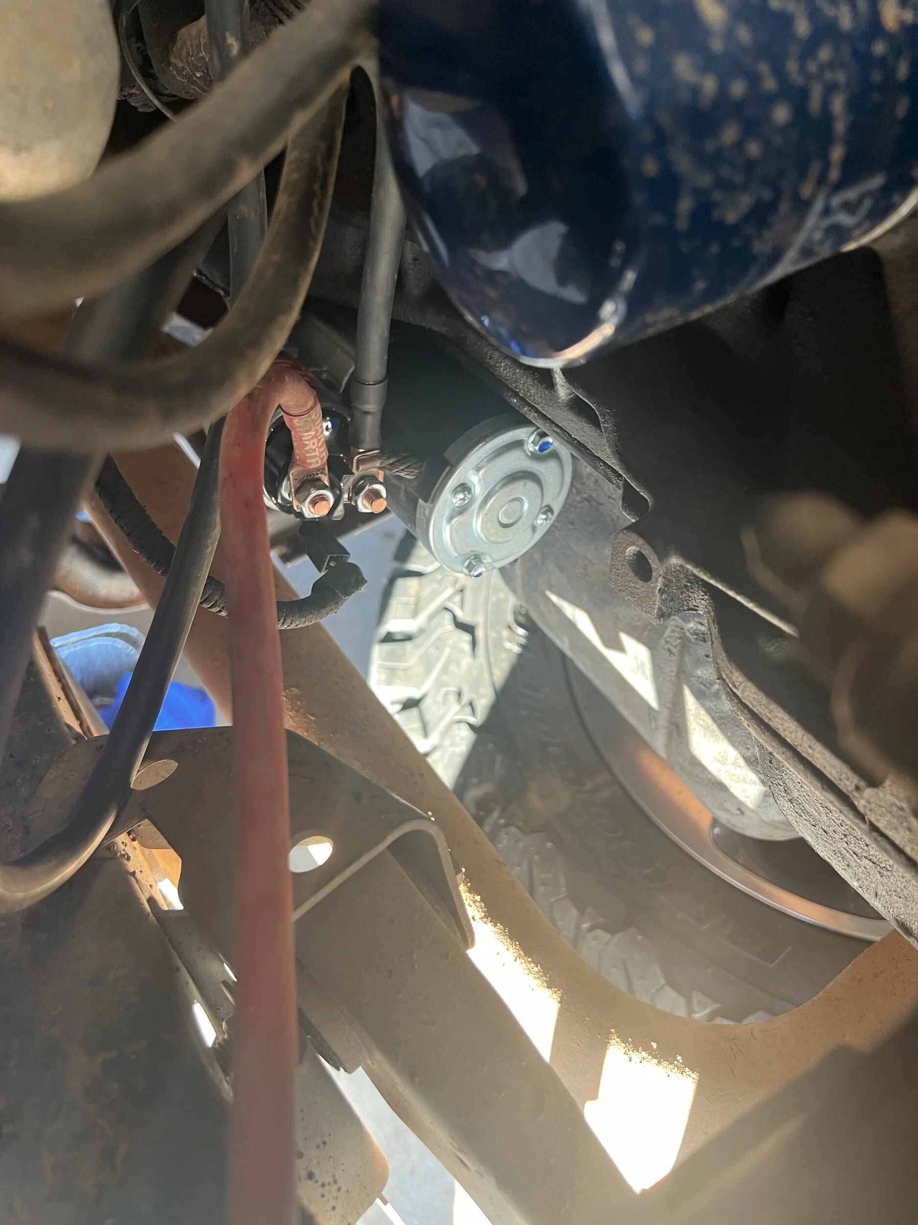

There is power to the starter from battery.
There is power to solenoid.
Solenoid engaged but no turn on a bench test so replaced starter.
Still no crank.

I pulled the starter relay, hit the brakes, put the key on run and connected the pins in the starter relay, sparks and solenoid clicked but no crank.

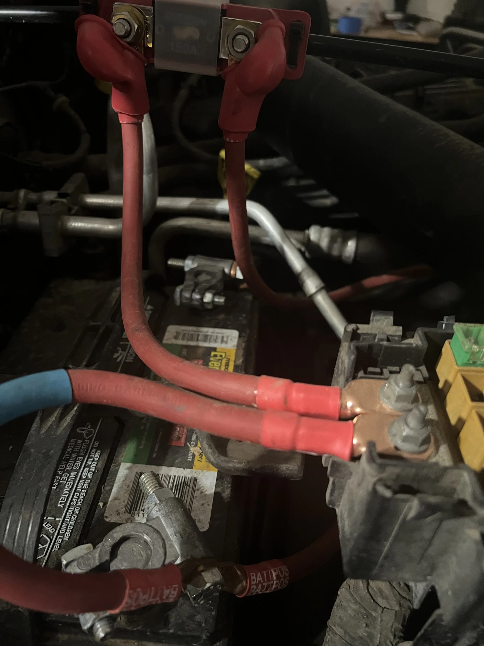

Update: I have jeepcables 5 cable replacement less than a year old and battery is less than a year old with 11.8v on multimeter.
