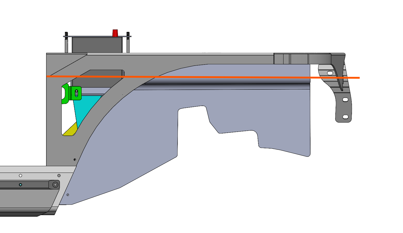

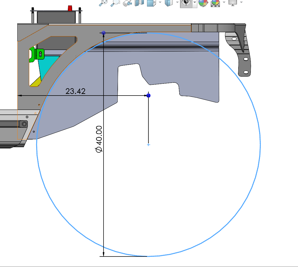

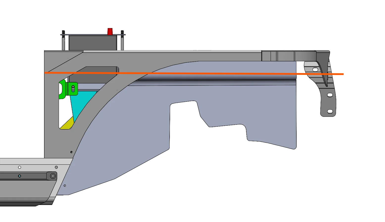

I think this is what your asking for, I may be misunderstanding the question. The red line would be the top of your OE fender. If you are running 40s then I would assume you are running full width or wider axles. This should make it harder to contact the inner fenders, when turned to full lock you also have the radius of the tire falling away from the inner fender.
"I'm finding that even with a 1.5"-2" forward stretch, 40's still hit the inner fenders" @sierradmax Please post a pic if you have it or show where you are seeing interference with 40s. I put a 40 inch circle with dims from tub to center line if that helps. Are you seeing contact at the bottom area close to the rocker?
This is of course not turned, just seemed easier to compare dims in this orientation.
With fodeez, the clearance issue becomes the rear of the inner fender at full stuff and full turn. I think that is what Sierra is referencing..
Contact from rear of tire when turning @ full stuff and more so @ full articulation. Perhaps this is why Savvy's fenders have more of a drastic cut.

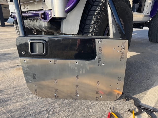

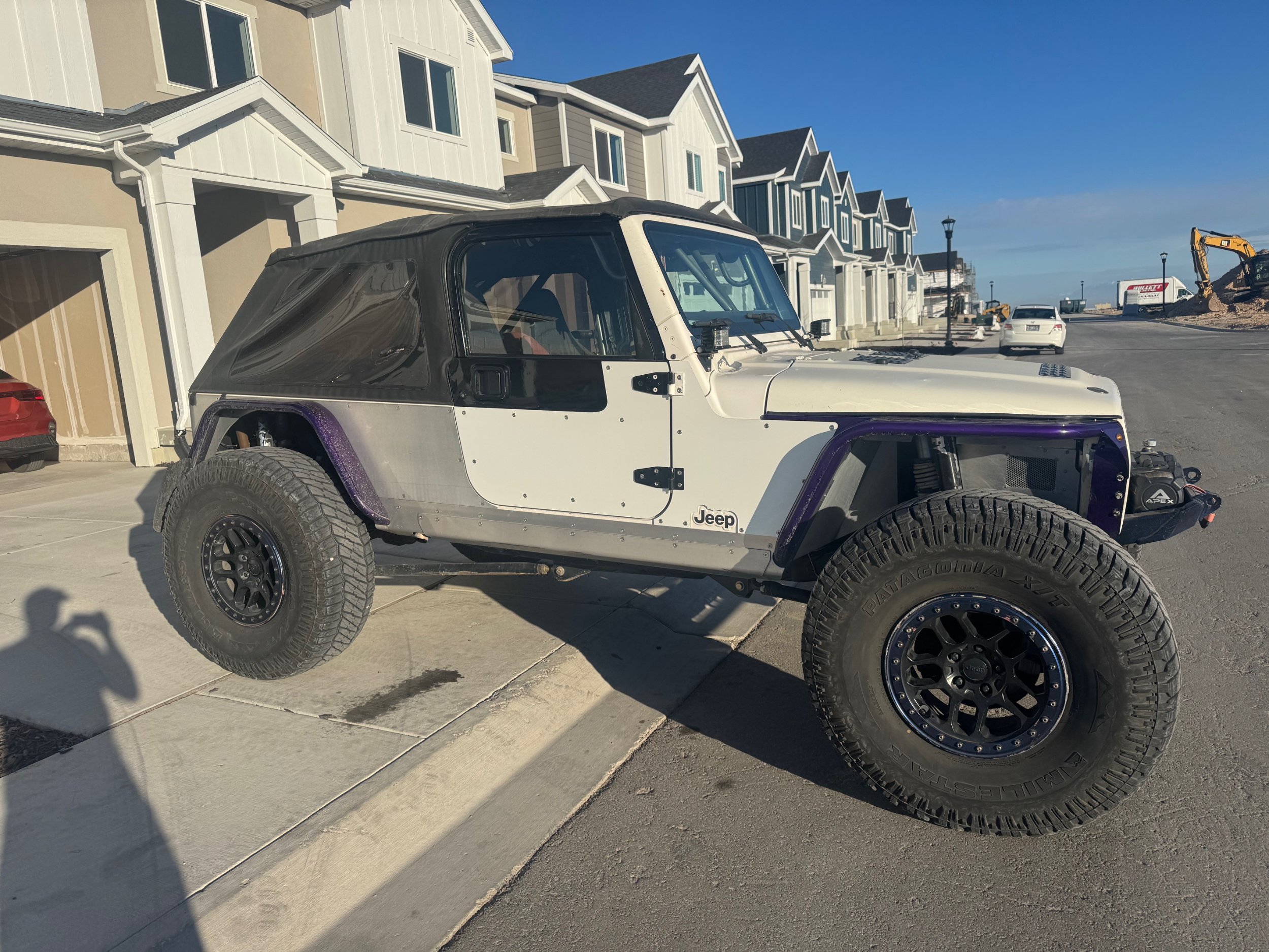

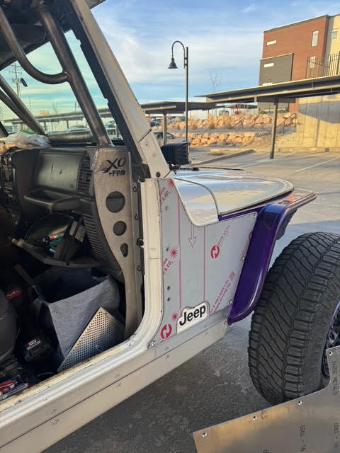

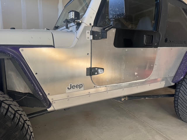

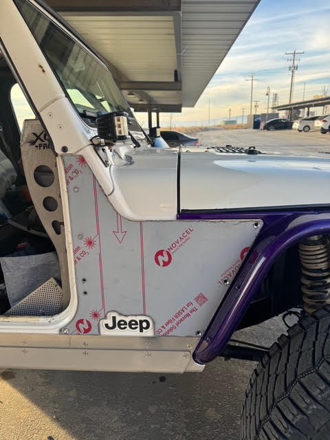

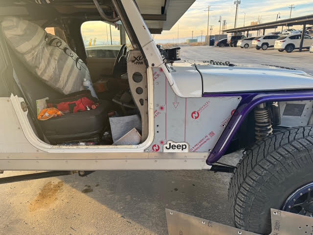

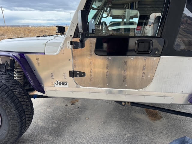

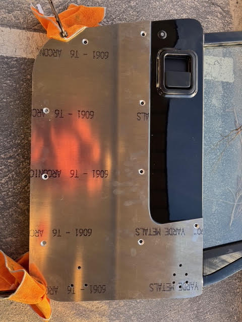

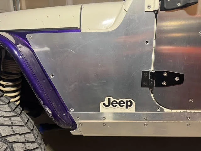

First draft/ set of the door skins and flak jackets test-fitted. Pretty damn sleek. I decided to try wrapping them in vinyl; it went OK, but I definitely have some things I’m going to try next time I break out the vinyl to do my corner armor. @Fluxor impresses once again. 🤙
First draft/ set of the door skins and flak jackets test-fitted. Pretty damn sleek. I decided to try wrapping them in vinyl; it went OK, but I definitely have some things I’m going to try next time I break out the vinyl to do my corner armor. @Fluxor impresses once again. 🤙View attachment 671264View attachment 671265View attachment 671266View attachment 671267View attachment 671268View attachment 671269View attachment 671270View attachment 671271View attachment 671272View attachment 671273View attachment 671274View attachment 671275

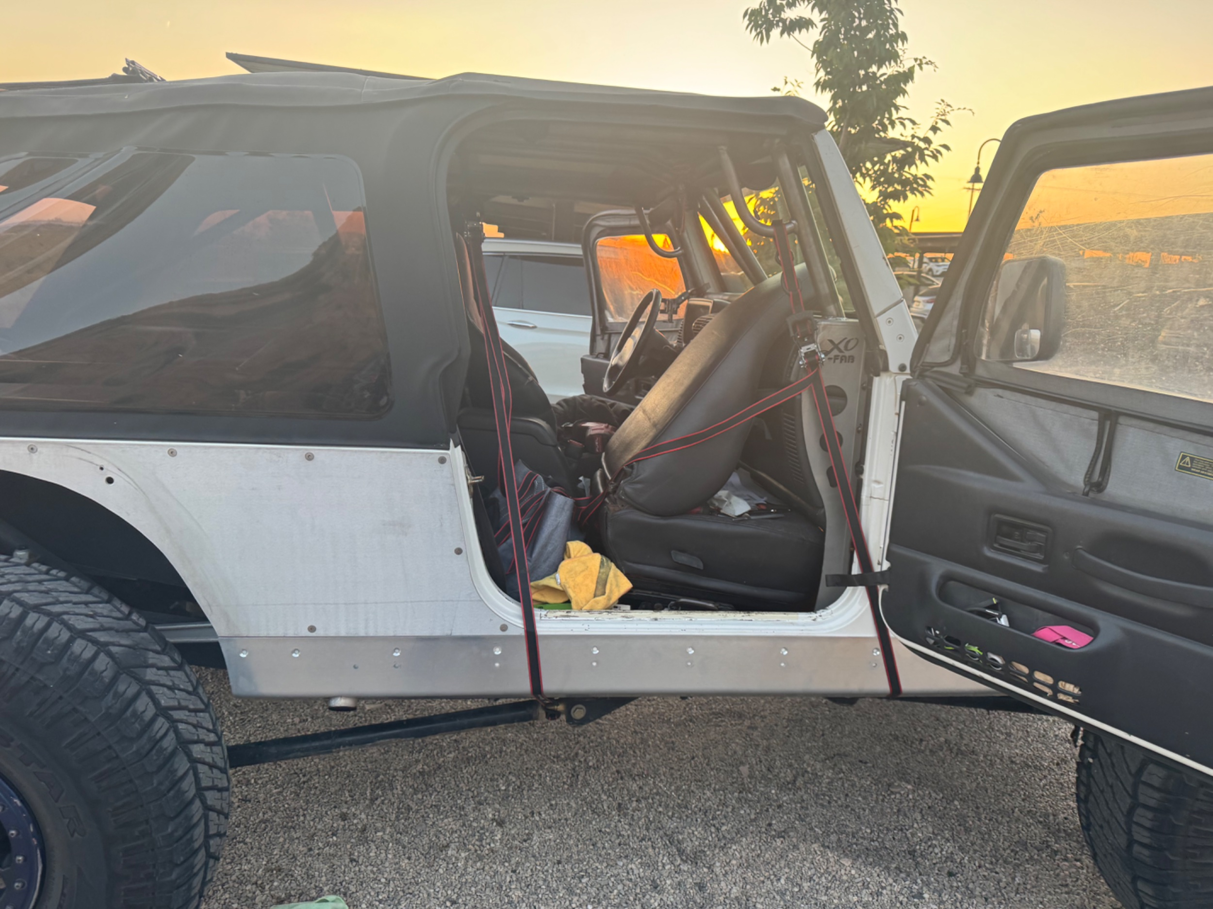

I kind of did the same thing. I used my corner armor to square up my TJ-6 stretch, so it was all kinds of wonky and needed some strong persuasion via a big ass hammer. However, I’ve found that using ratchet straps helps hold things as tight as possible in place.

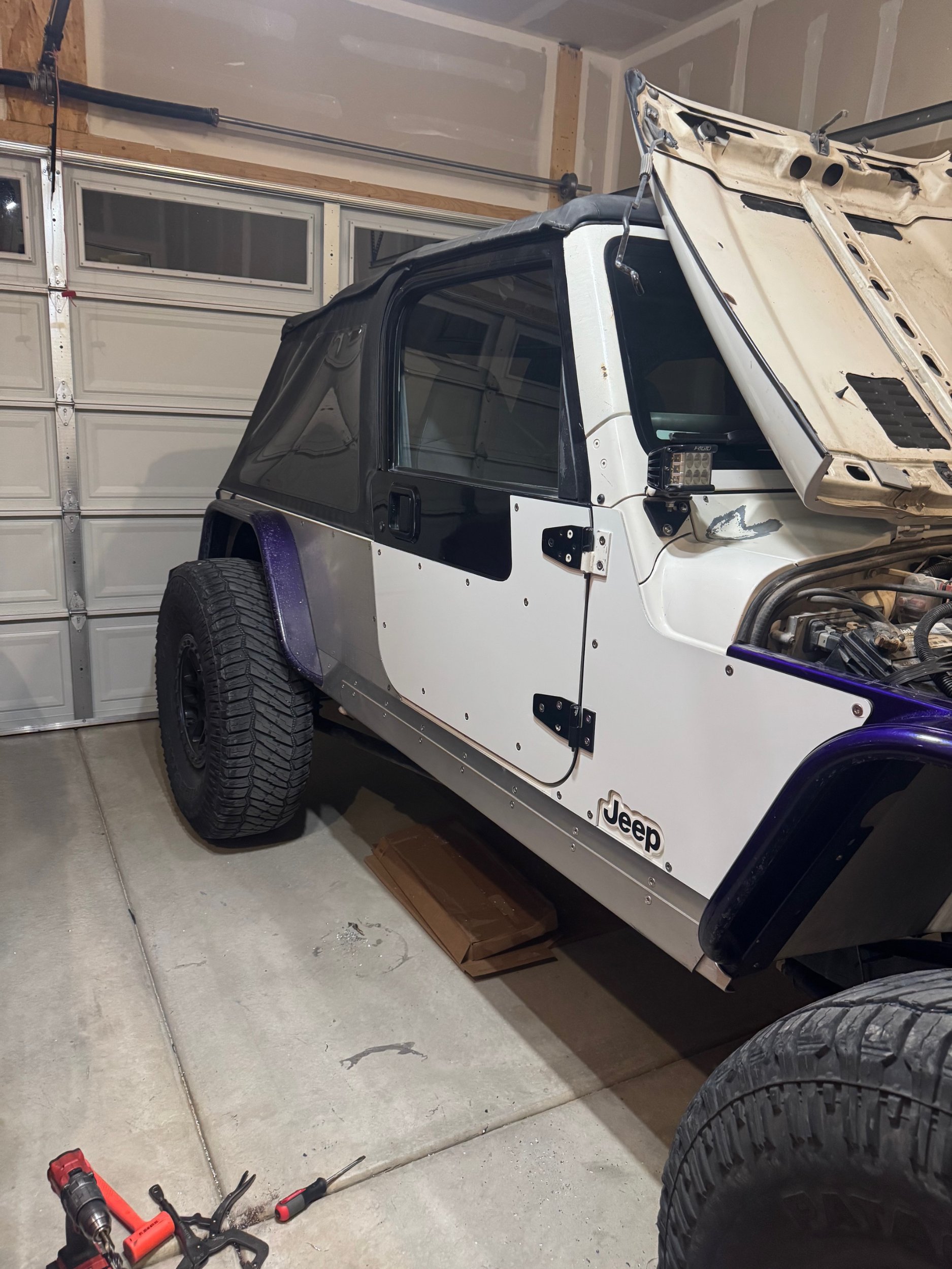

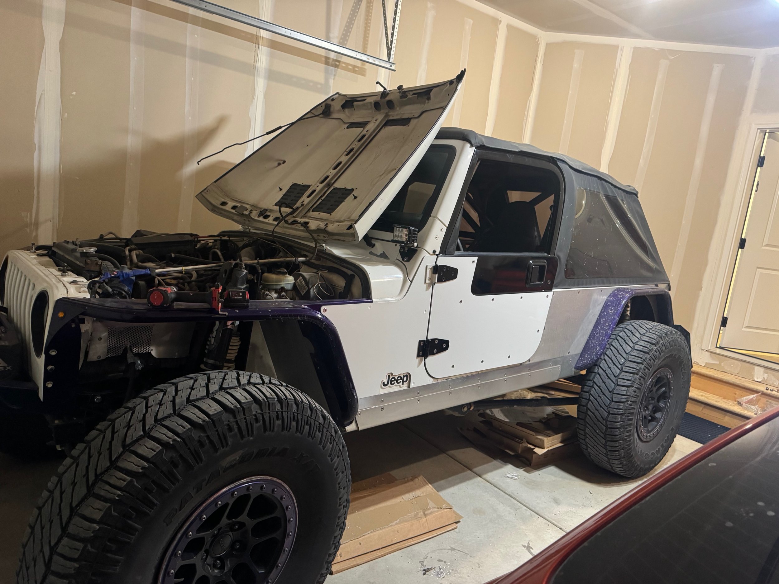

See pic below for more context; I wrapped them from the cage to the to the bottom links so they would apply pressure at the corner and force it into the panels. I did the same for the corner armor, but with the straps going the other direction to make sure the corner was as tight as possible. I also used a shit ton of clamps, but painter’s tape would have definitely helped.
