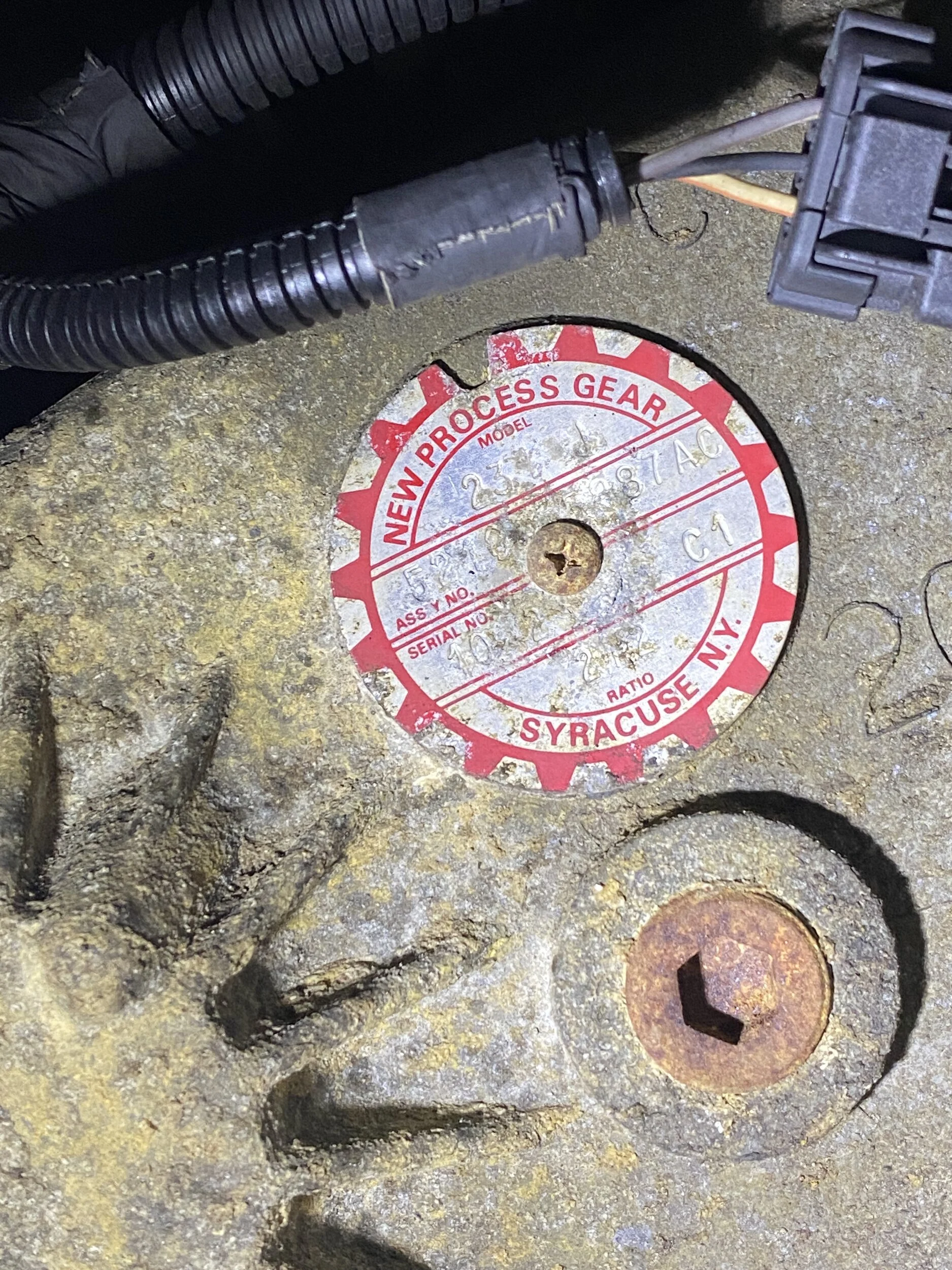

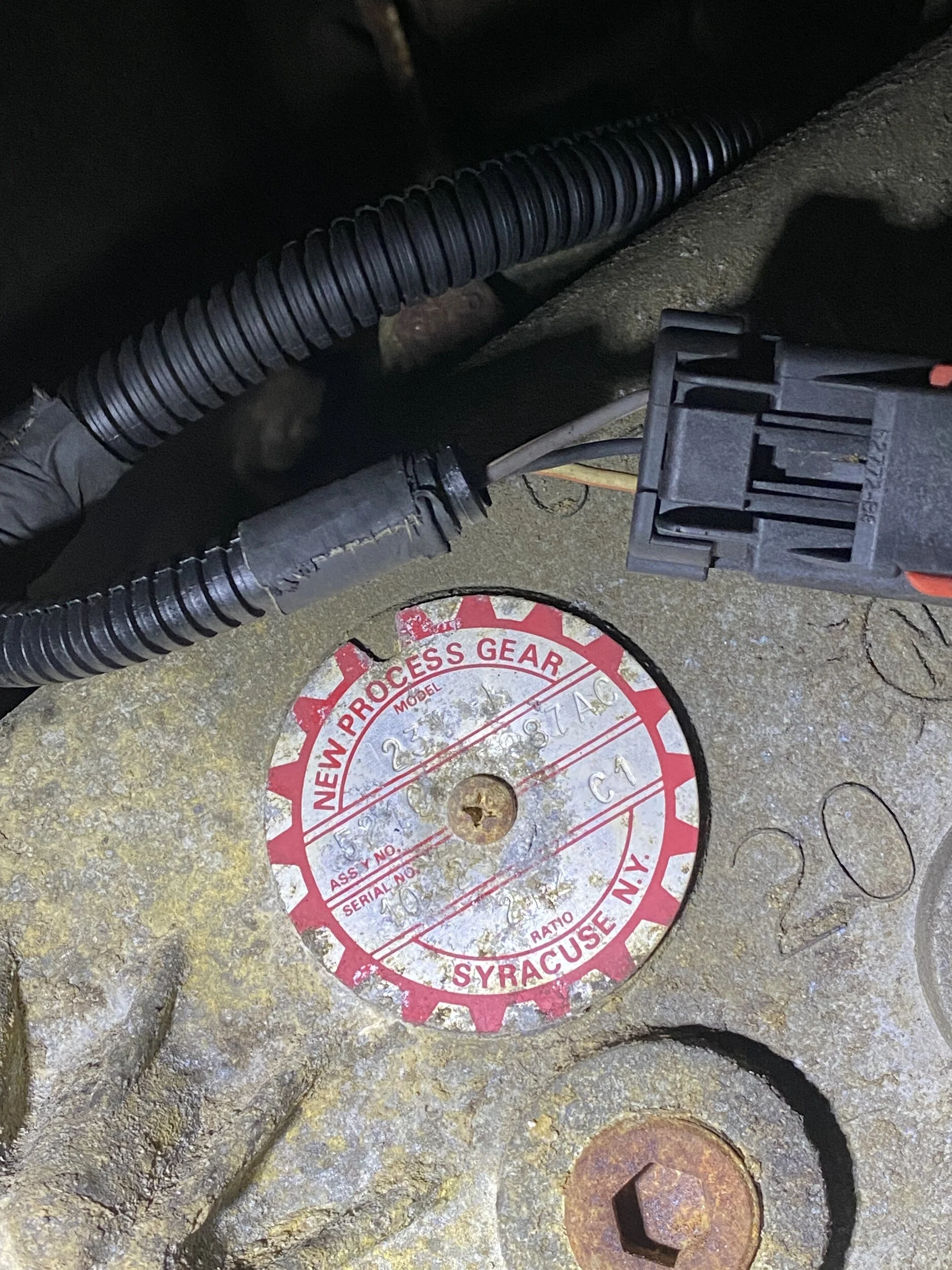

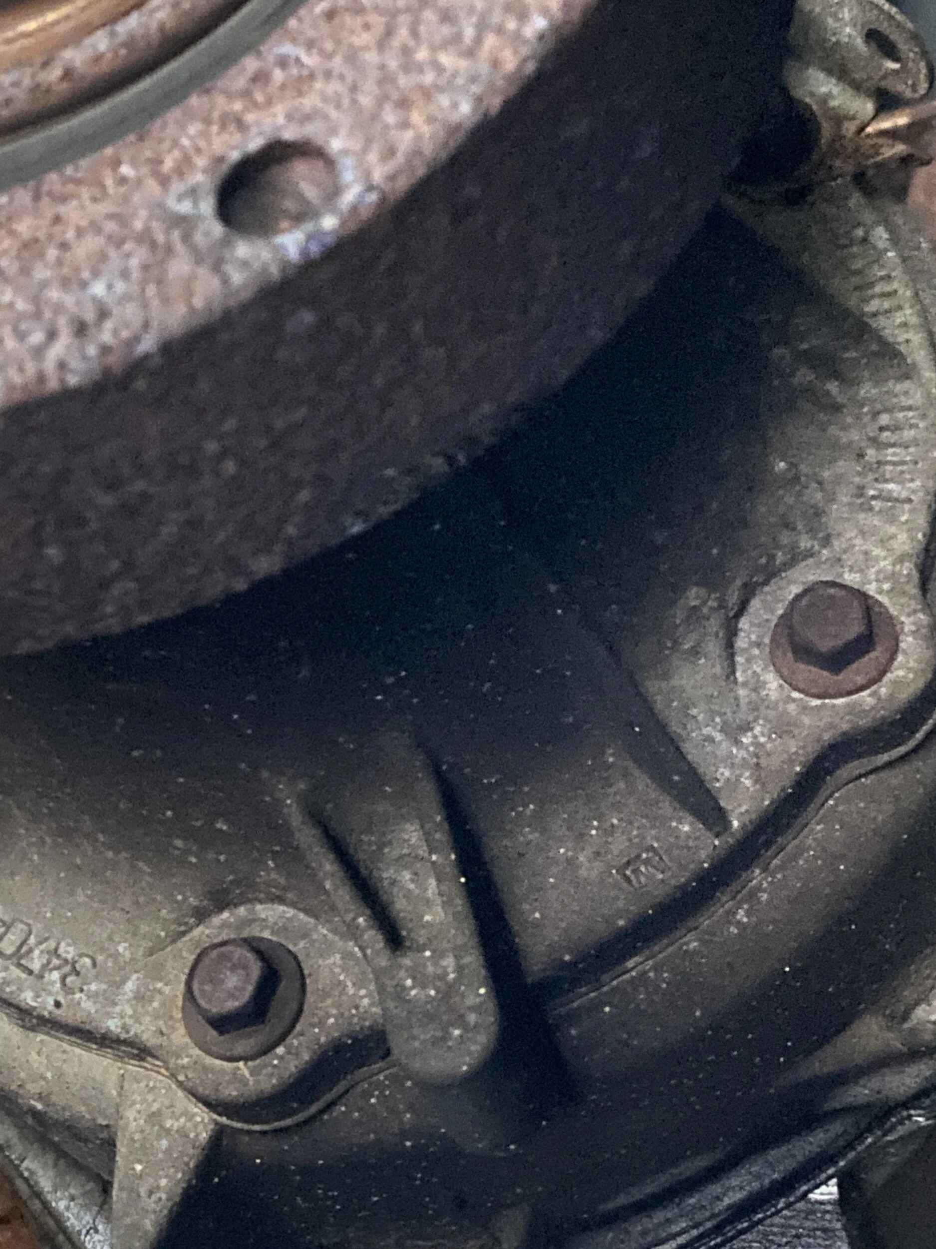

So I am replacing my wrecked 231J transfer case with a pre-owned one. I have been doing some research and whatnot about the parts, but I wanted to get some opinions before taking the plunge and buying. Having a hard time figuring out if my make/model/year has a 231J with a short input or long input shaft…or if that even matters. The seller claims that 231J short input shaft will fit all standard 97-06. It also fits 03-06 automatics (doesn’t affect me). They also claim some standard 97-04 used the long input shaft.
Honestly just need to know which version to purchase (or if the short input is interchangeable).
Figuring out which I need will help determine which rear drive shaft I need to purchase, as well as which rear yoke.
Thanks all
Rob

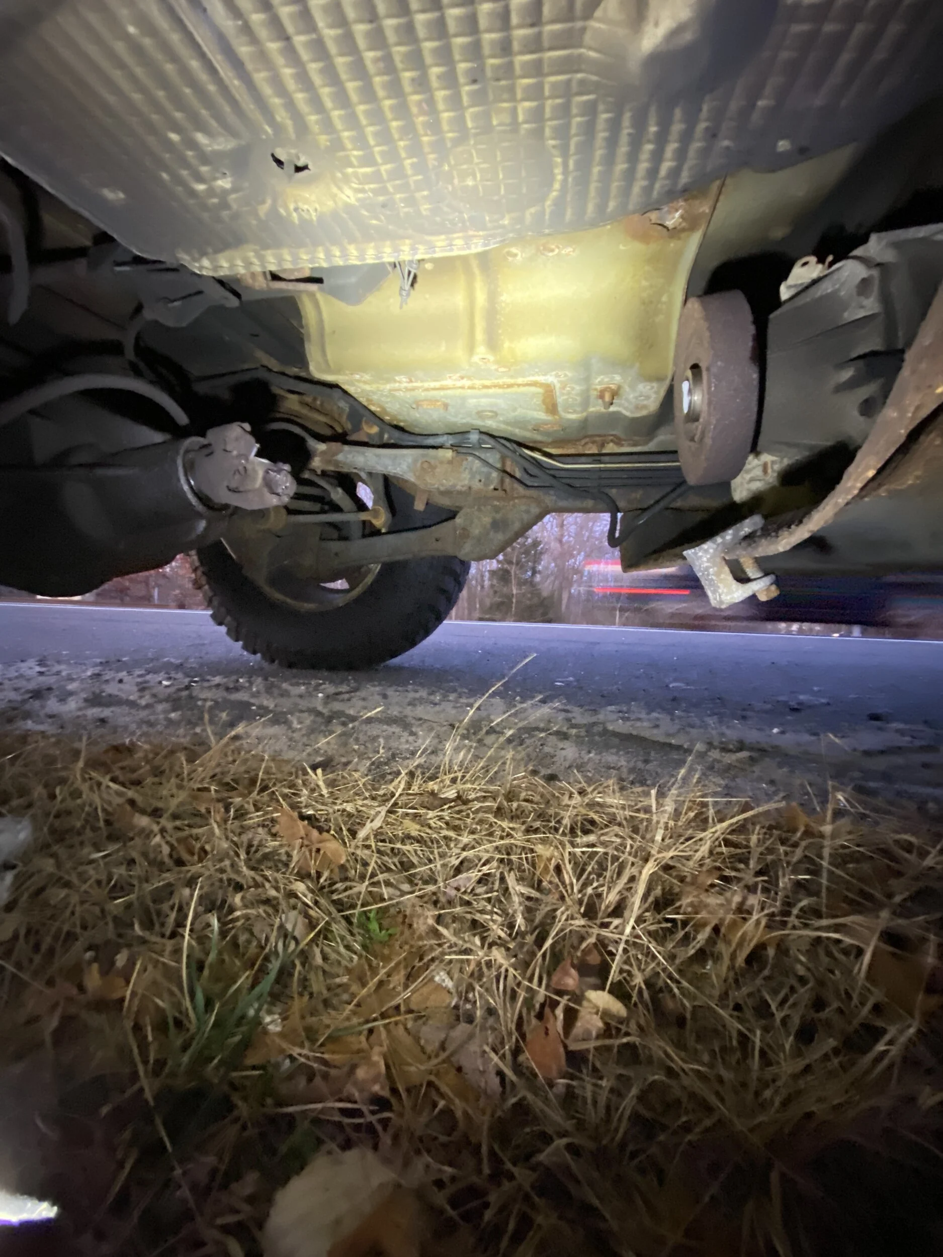

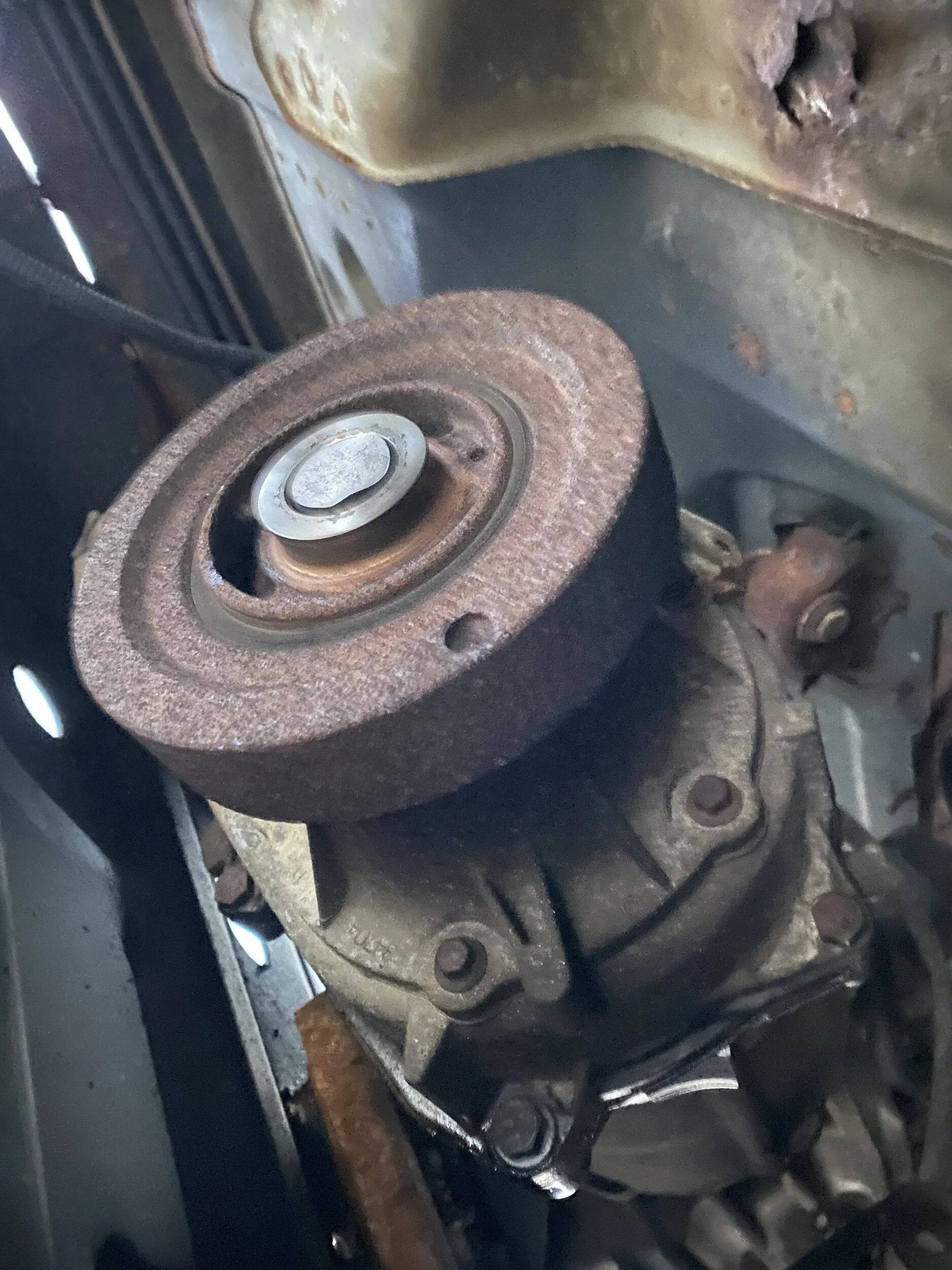

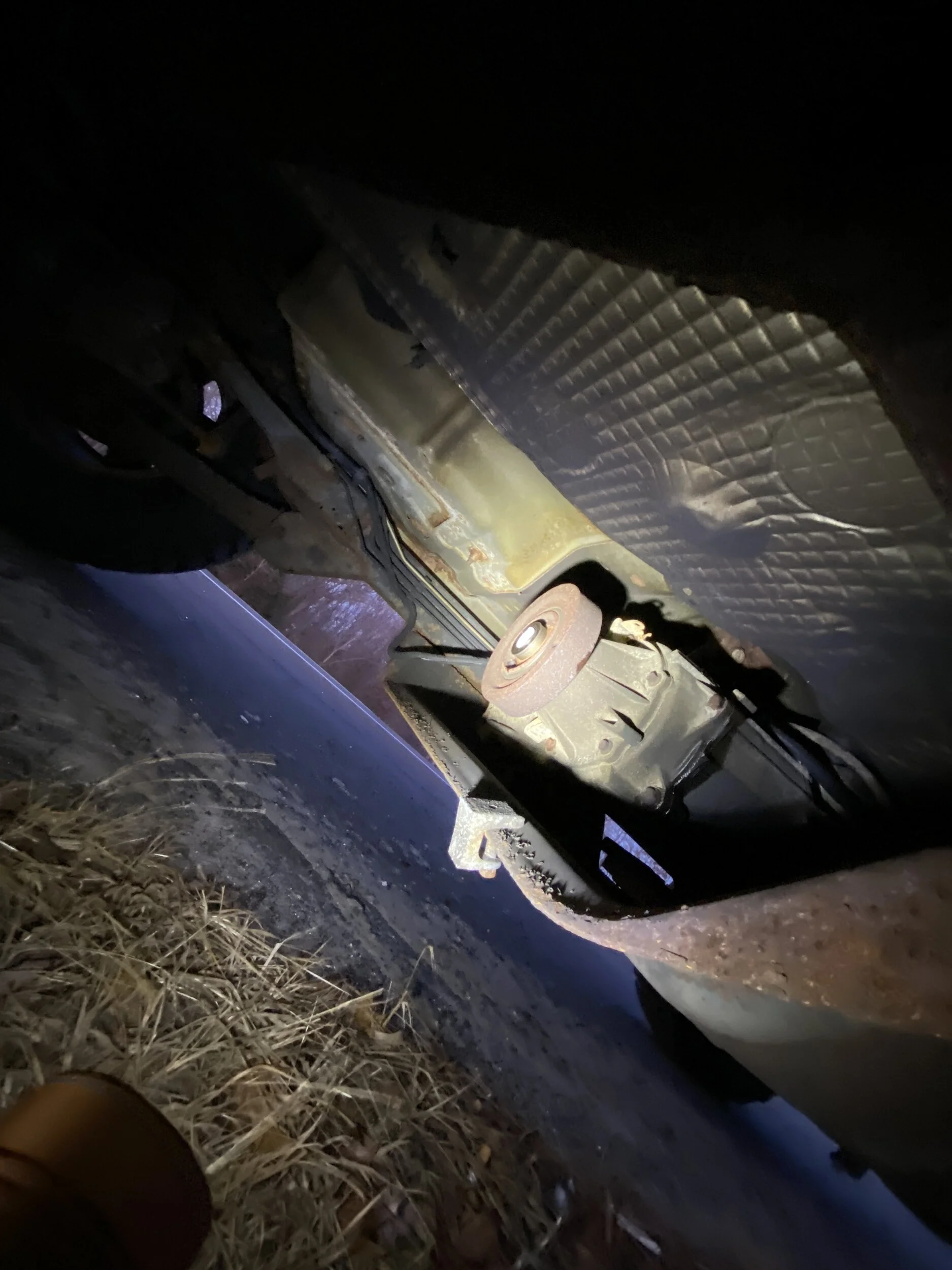

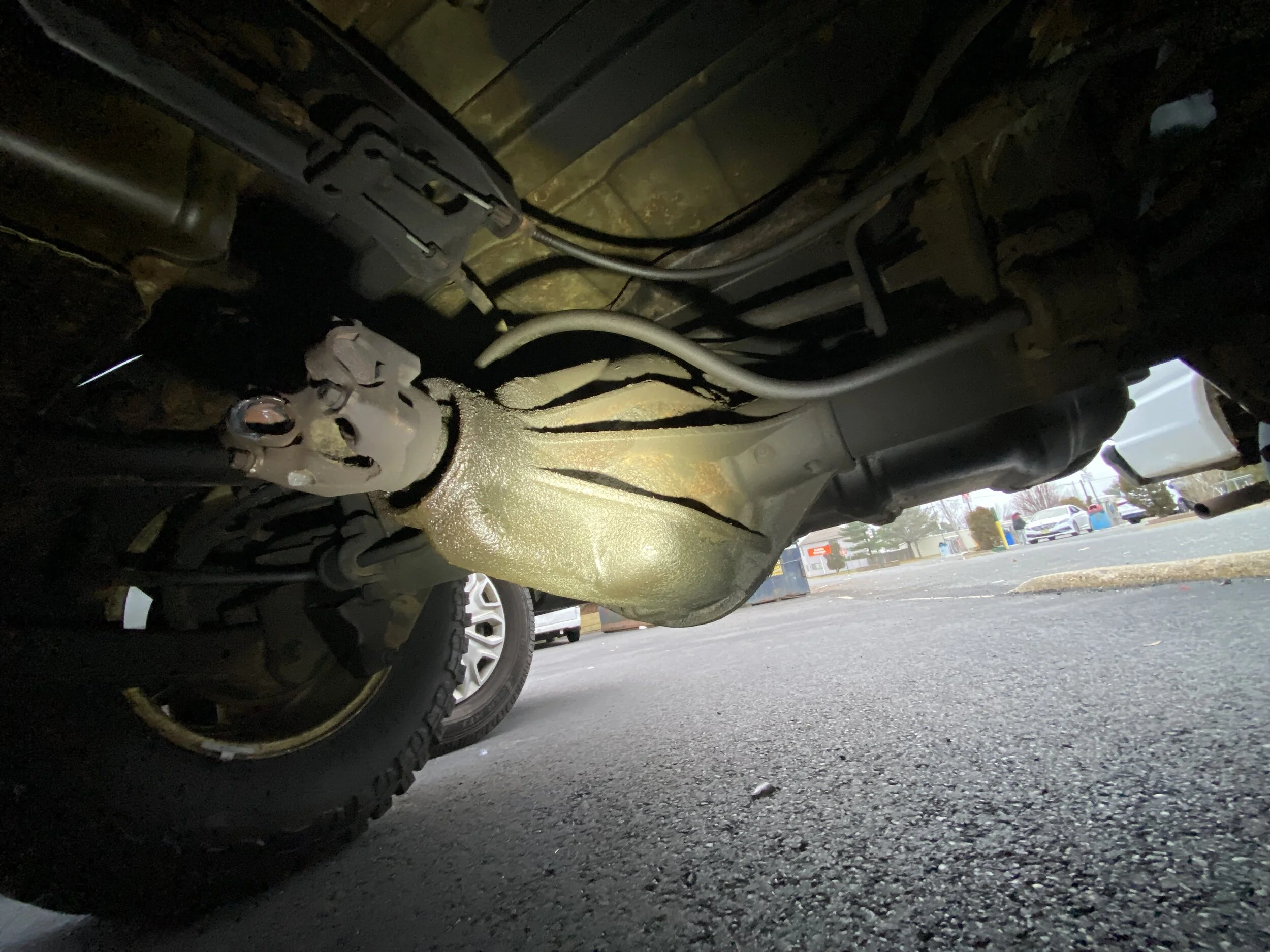

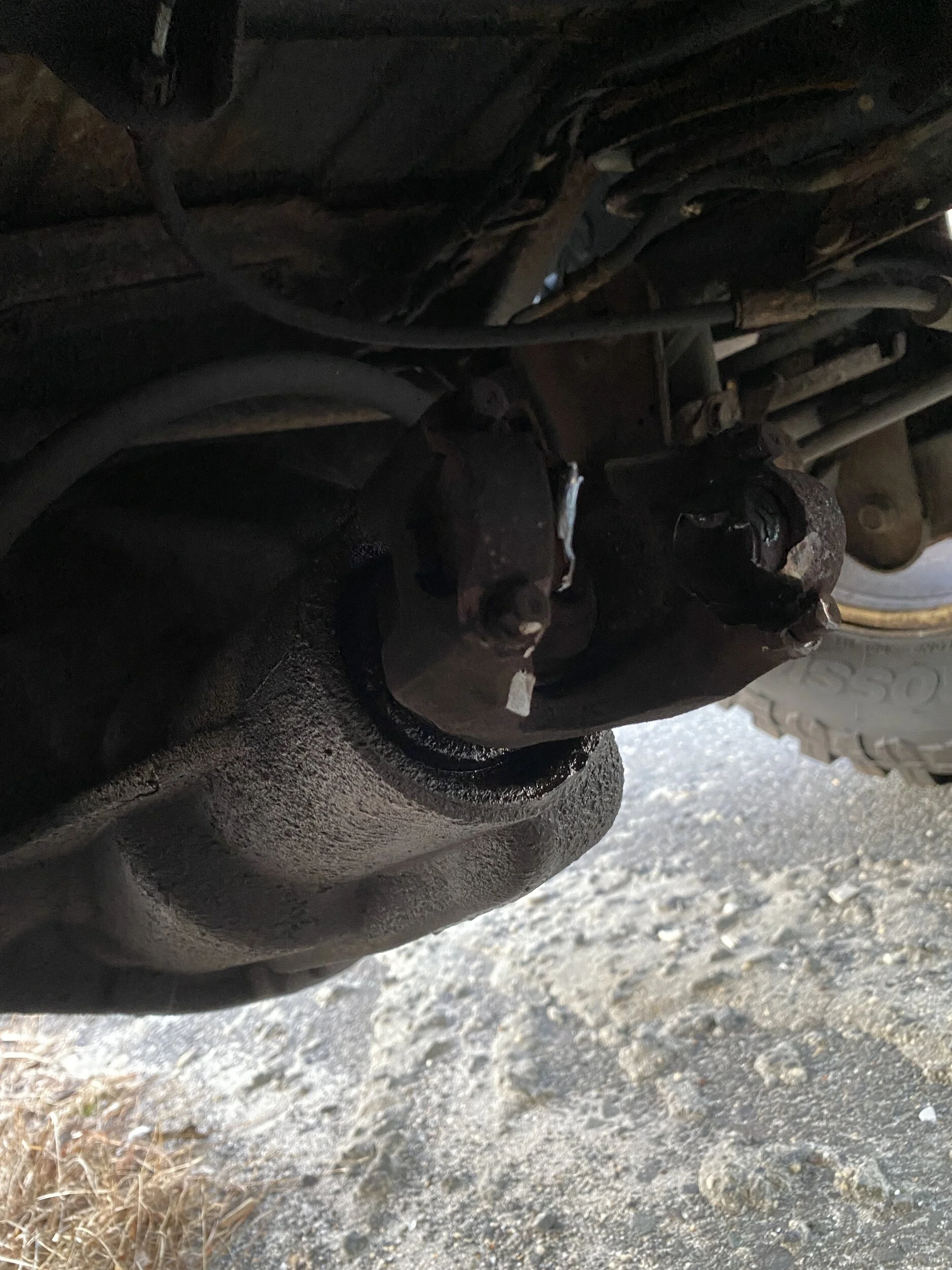

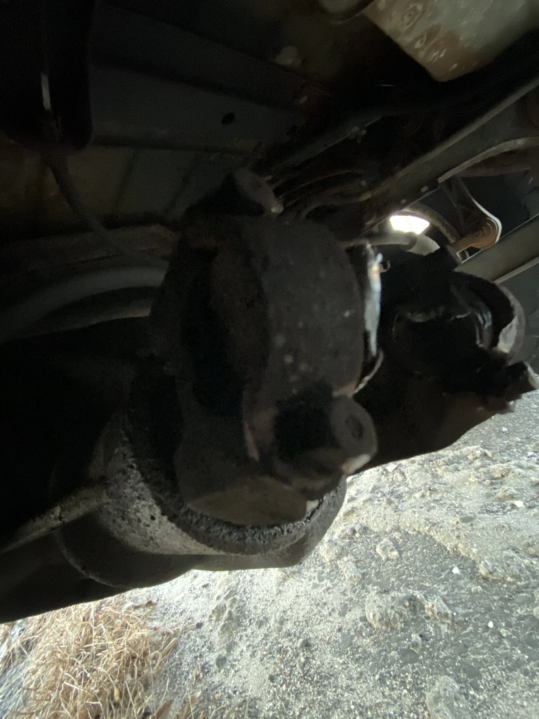

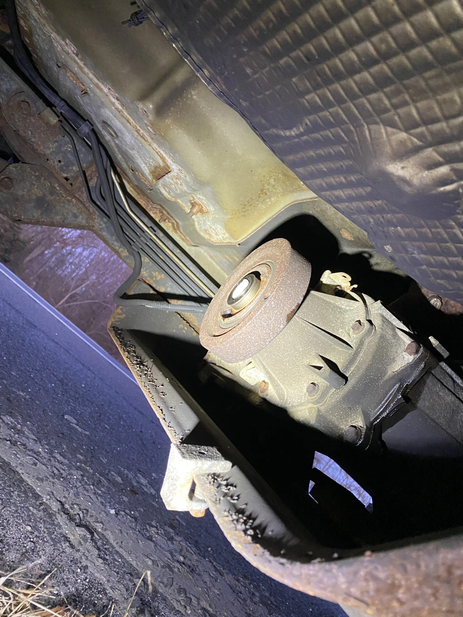

So what started this was when the Jeep crapped out on the highway. Ended up shearing off the output shaft on the transfer case, completely losing the rear drive shaft, and busting the u-joint at the yoke. After research I decided to just get a “lesser miles” transfer case and just replace the t-case, the driveshaft, and the yoke. All of my parts were stock, and I’m looking to replace with stock. The tricky part is just that there are several options of “stock”, so it’s harder to determine which parts I need. Thanks for the help.

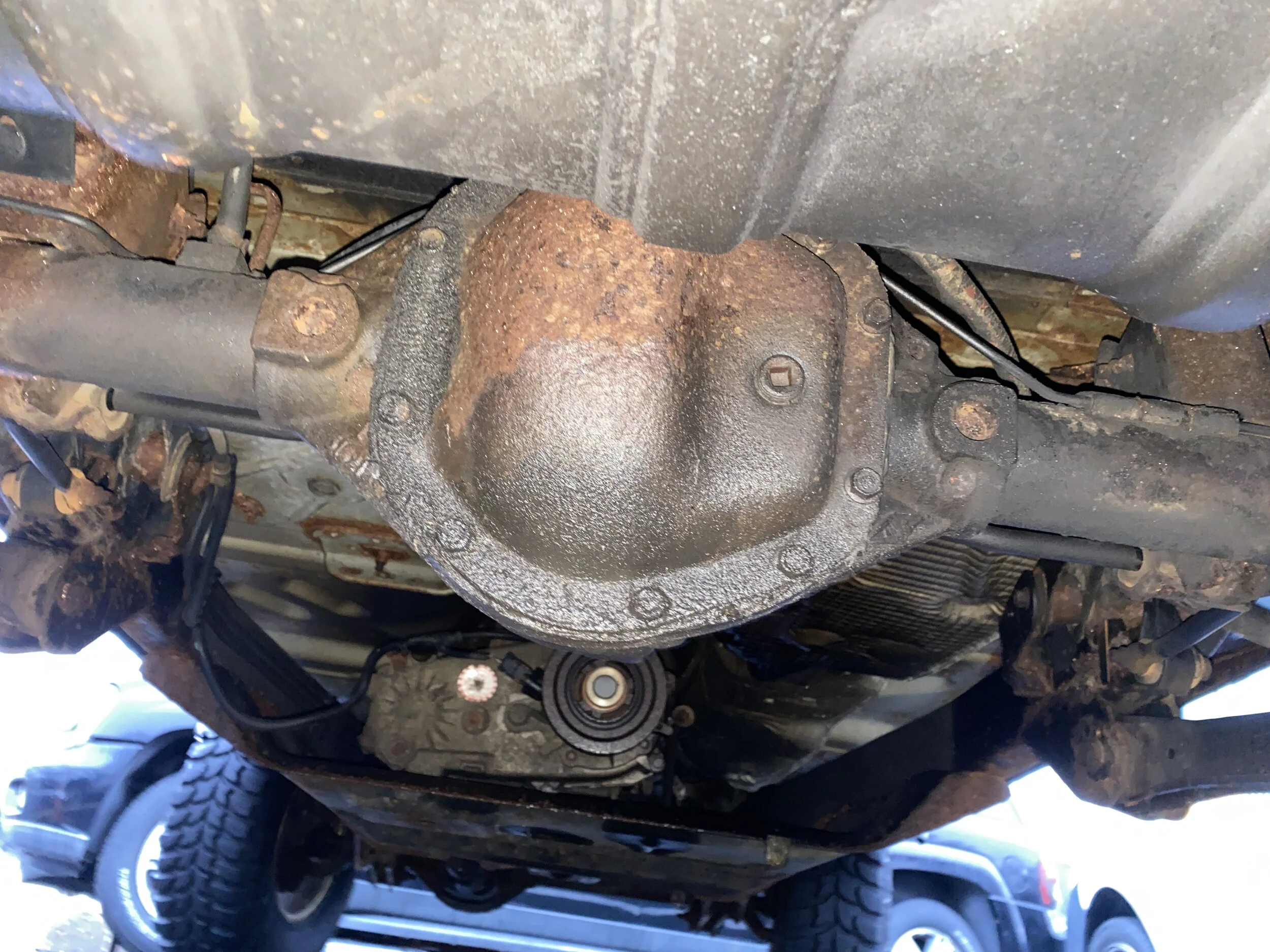

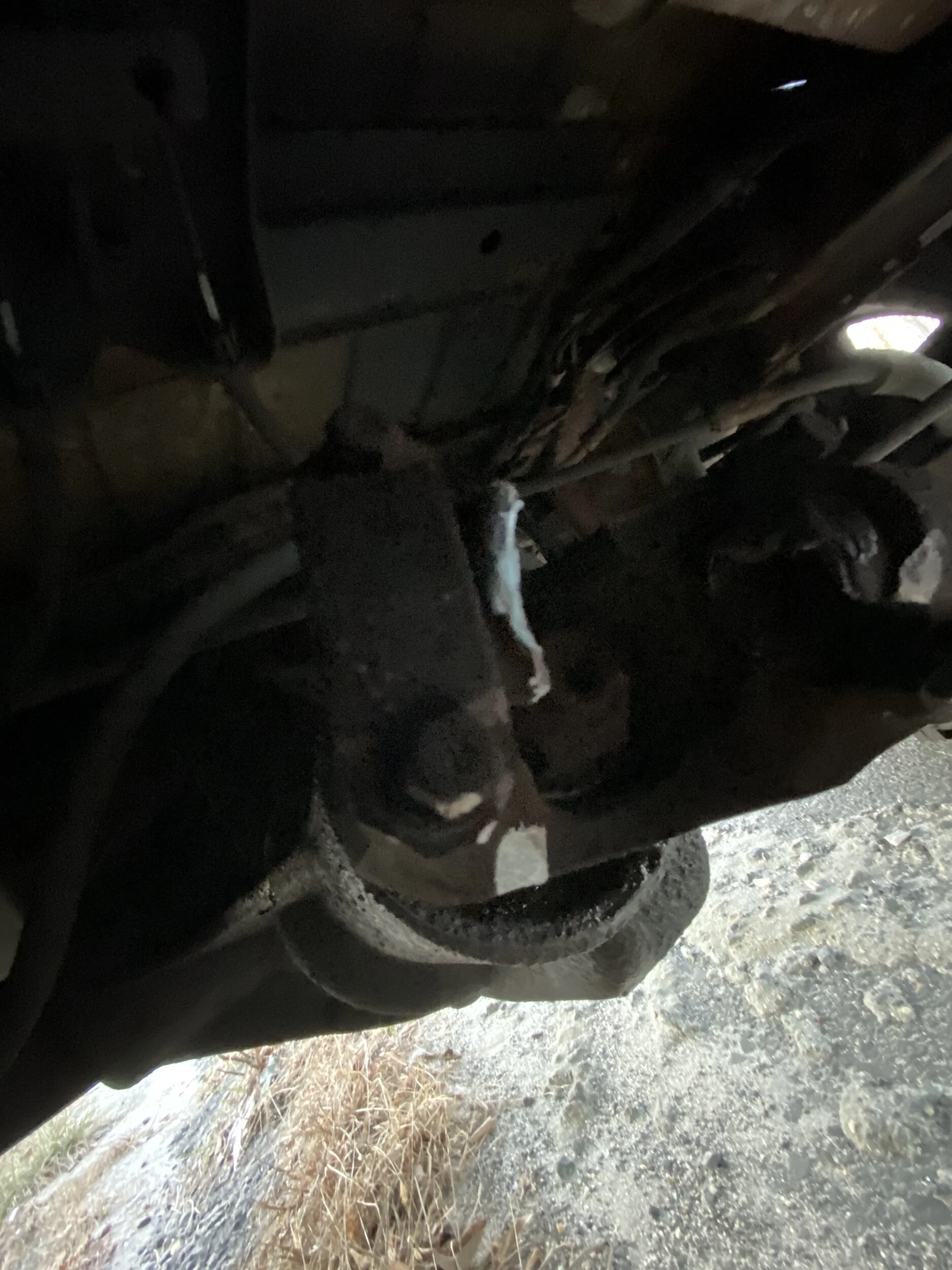

Bingo. A while back I started feeling some vibration while driving. I misdiagnosed it as a bad o2 sensor because I threw a CEL for a o2 sensor and misfire around the same time. I kid you not, the day after I change the o2 sensor, my rear driveshaft decides to liberate itself from the transfer case. Looking at the damage, and what was left of the transfer case and ujoint, my best guess is that the ujoint between the rear drive shaft to the rear diff failed (and the failing ujoint would explain the vibration I had been feeling). Looks like when the ujoint failed, the rear driveshaft spun around and snapped the rear output shaft from the transfer case.
So ultimately, I need to replace that rear output shaft coming from the transfer case (whether that’s going the “new used” transfer case route or by getting a new output shaft or by doing a SYE), plus a new rear driveshaft, plus a new ujoint yoke probably.
Just trying to figure out the most cost effective way of doing this.

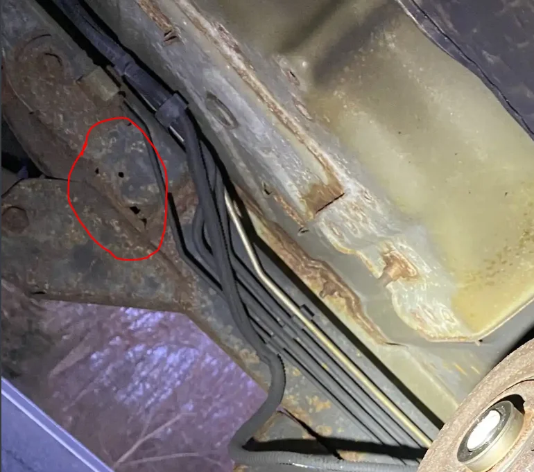

Is there a "witness mark" from where the driveshaft slammed into the underside of the tub after it broke free from the diff?
