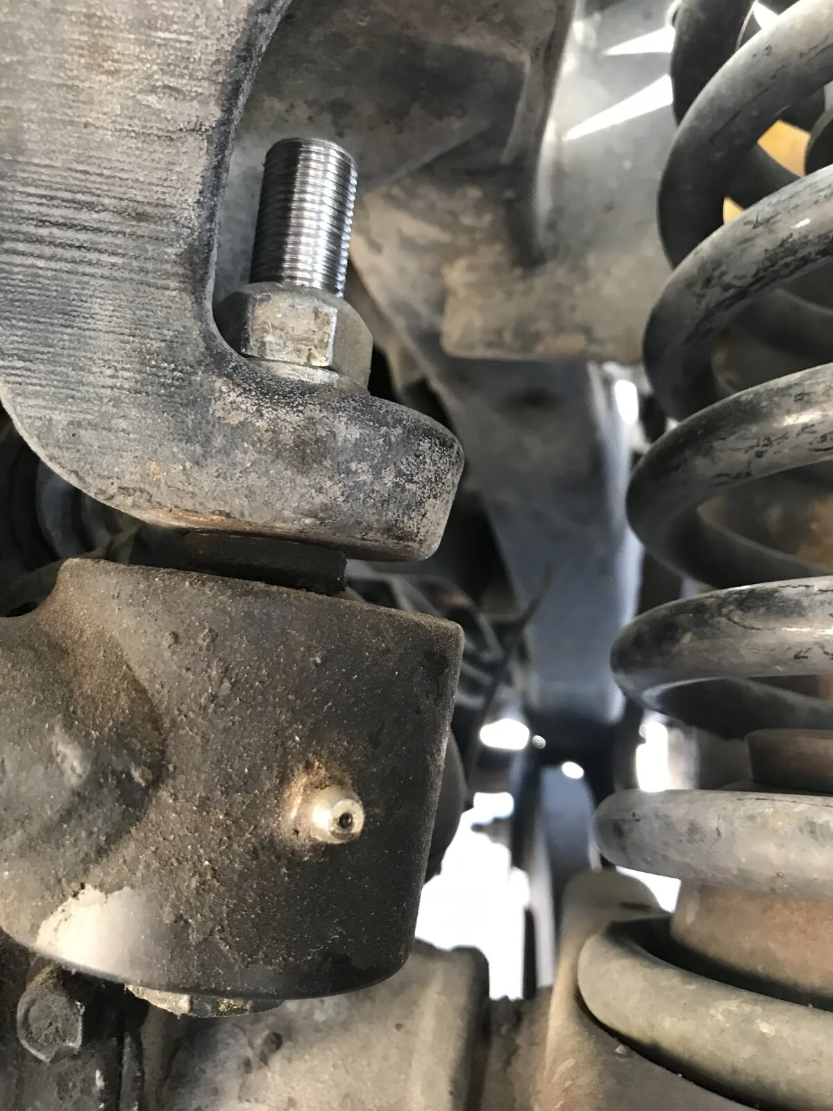

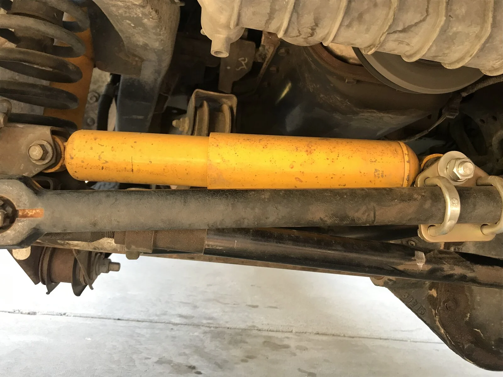

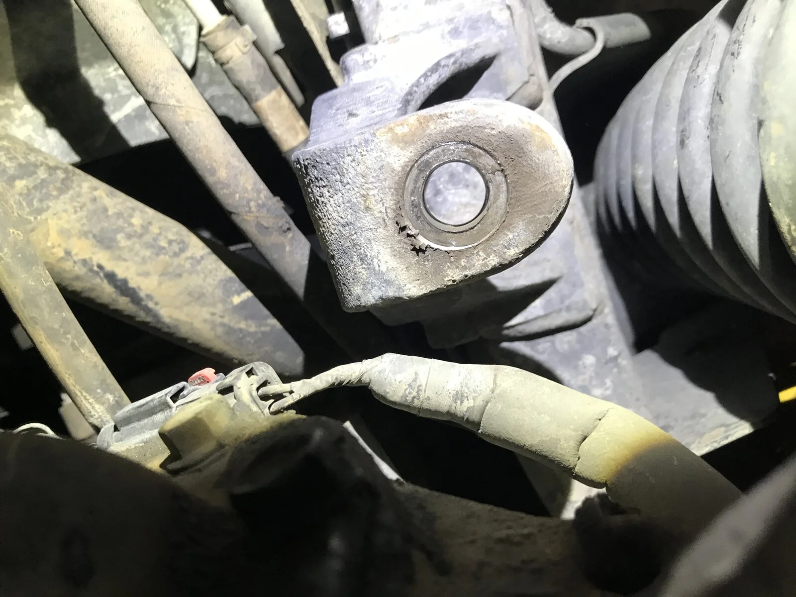

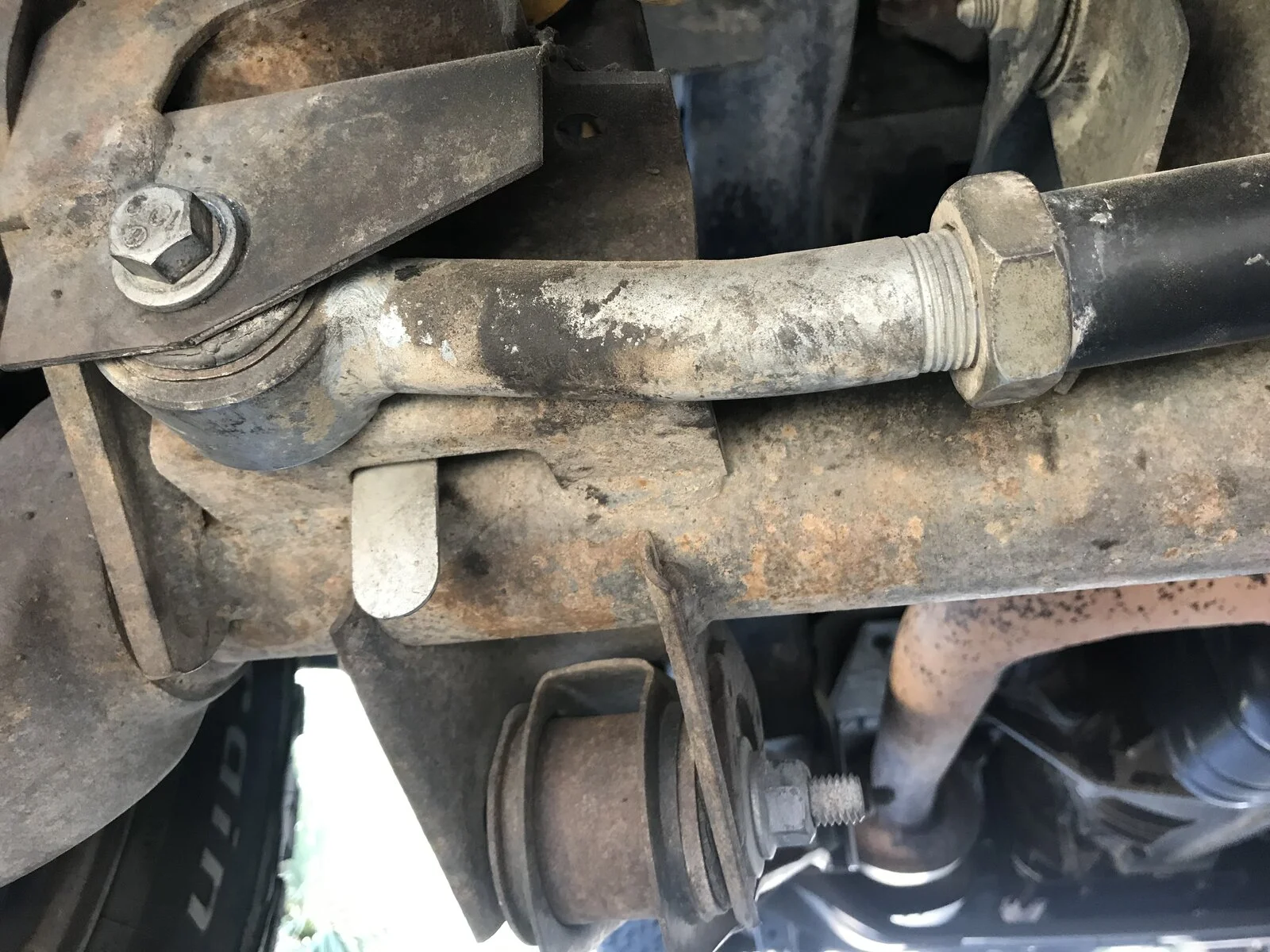

I have a 2005 LJ that I’ve owned for 7 years. It has what seems to be a 2” lift installed by the previous owner. Over the last couple years the steering has felt to get a little loose and i occasionally get death wobbles after going over a bump in the road traveling at 30ish MPH. The frequency of it happening has increased recently where I stopped driving it until I could address the problem.

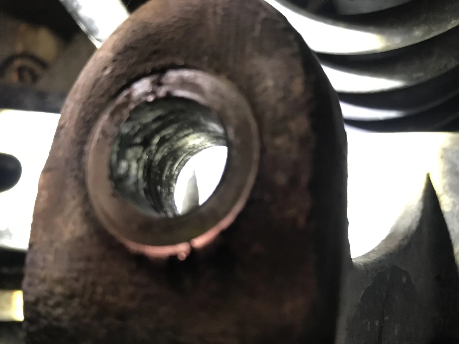

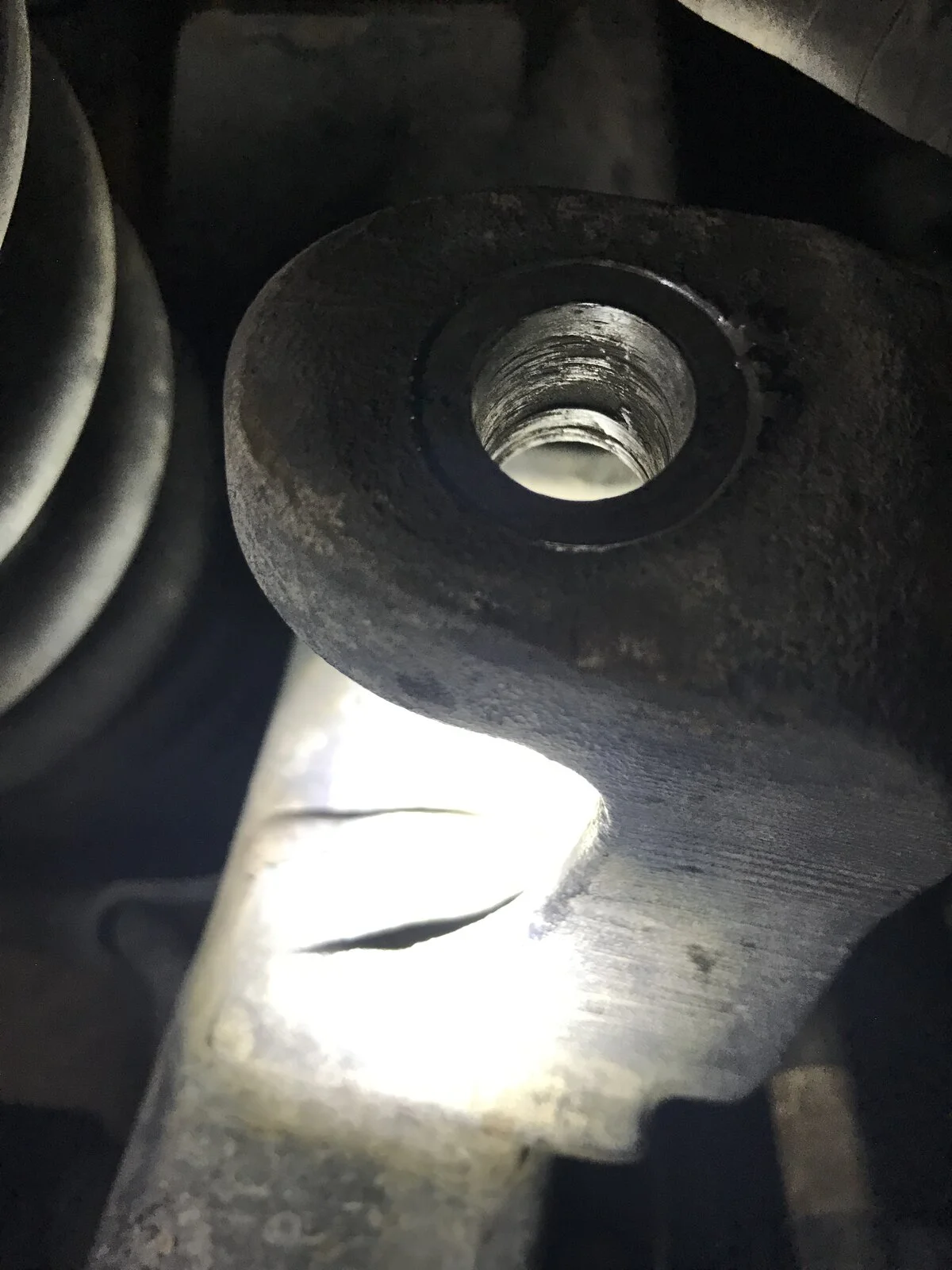

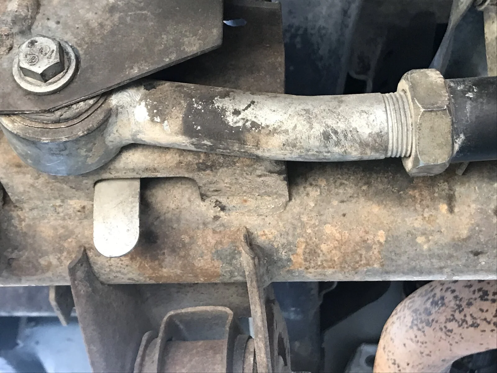

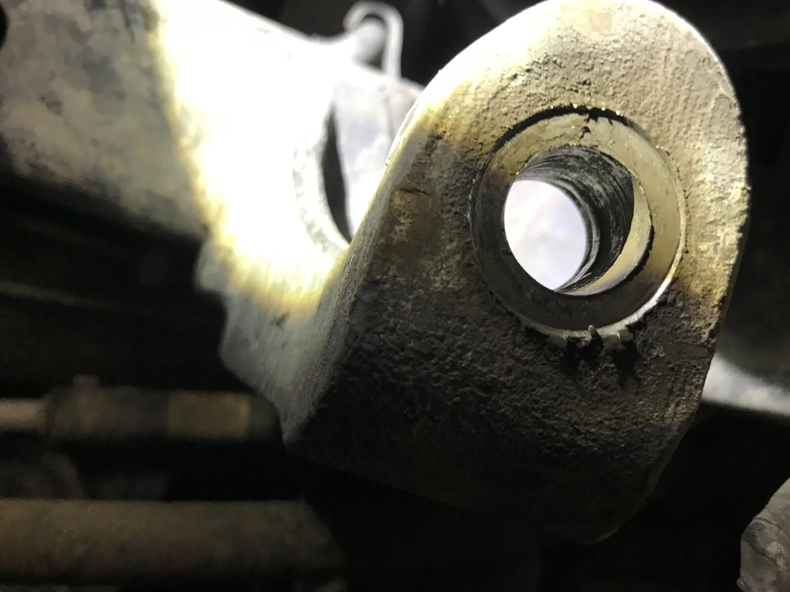

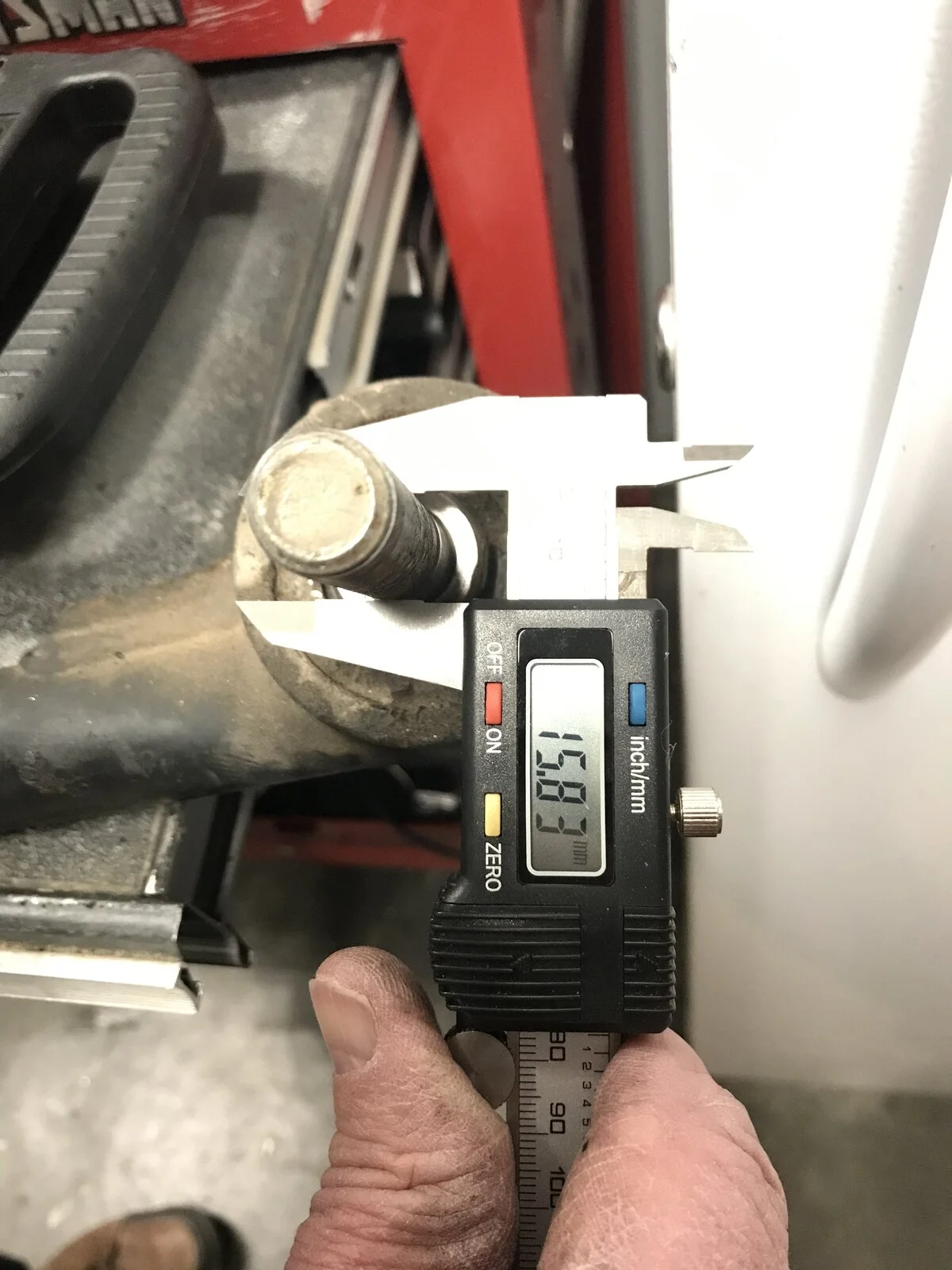

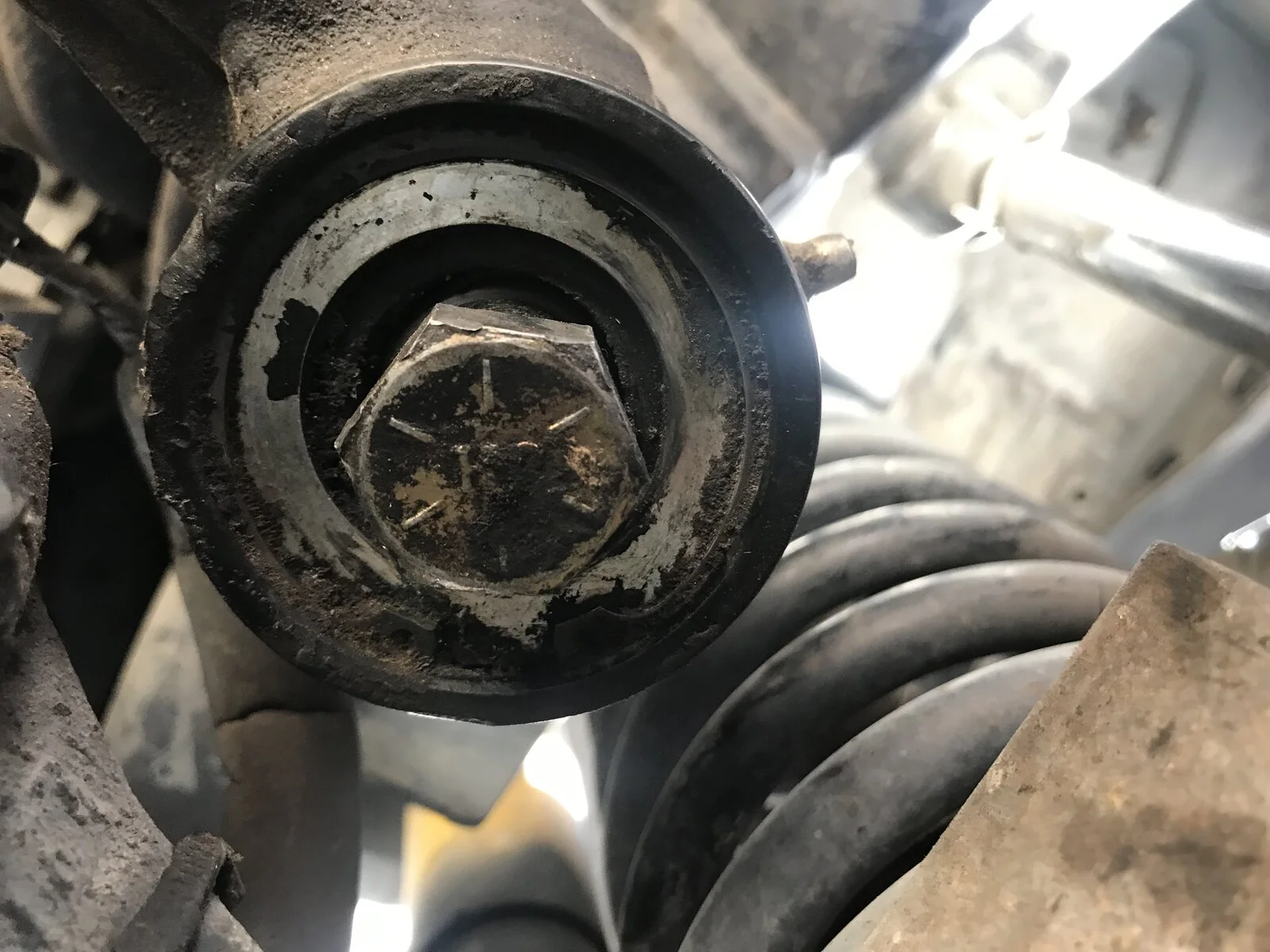

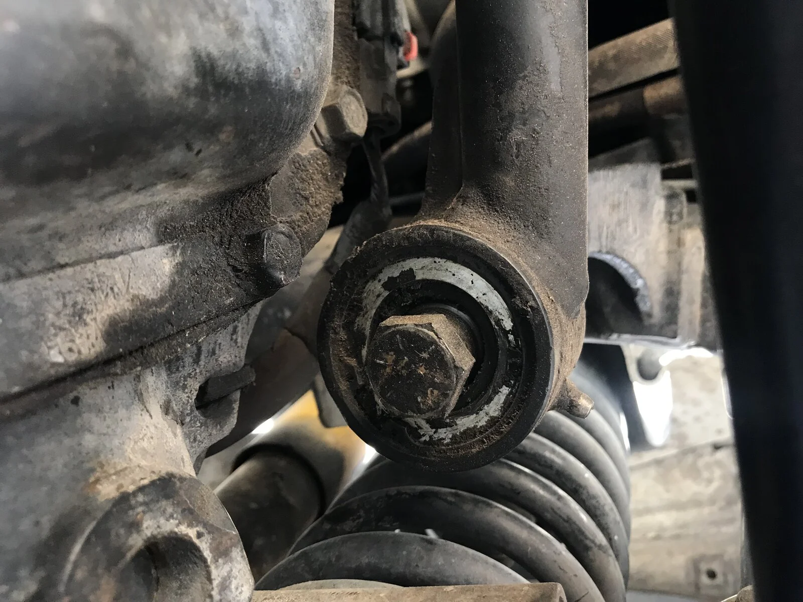

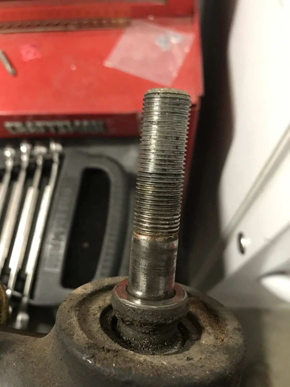

I replaced the track bar a while ago, and got a JKS adjustable track bar so I could swap that out. When I removed current Unit from the Jeep and got the 9\16 drill bit/hardware out to test fit, it slides into the slot with a lot of play. I measured the bolt that came Off the Jeep and it’s 15.8mm. I was under the impression that the track arm currently on the unit was stock. There also seems to be a bit of marring on the inside of the slot (photos attached) perhaps from previously being drilled out.
- Does anyone know of aftermarket track arms with hardware bigger than 9/16?
- Is my only option to have a shop cut the Frame Mount and create a new one? (I don‘t have welding experience)
- Does anybody have a shop recommendation for the Albuquerque area?
