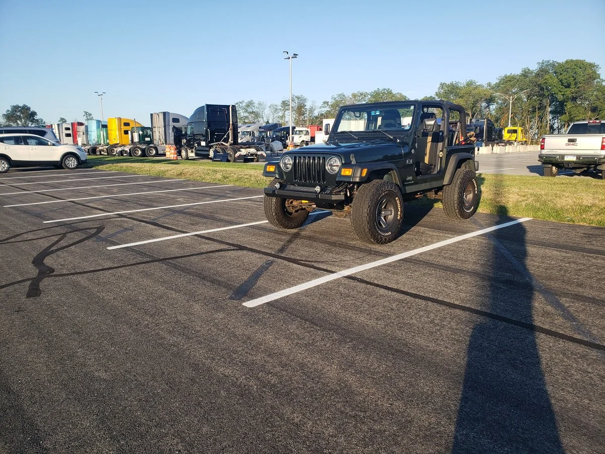

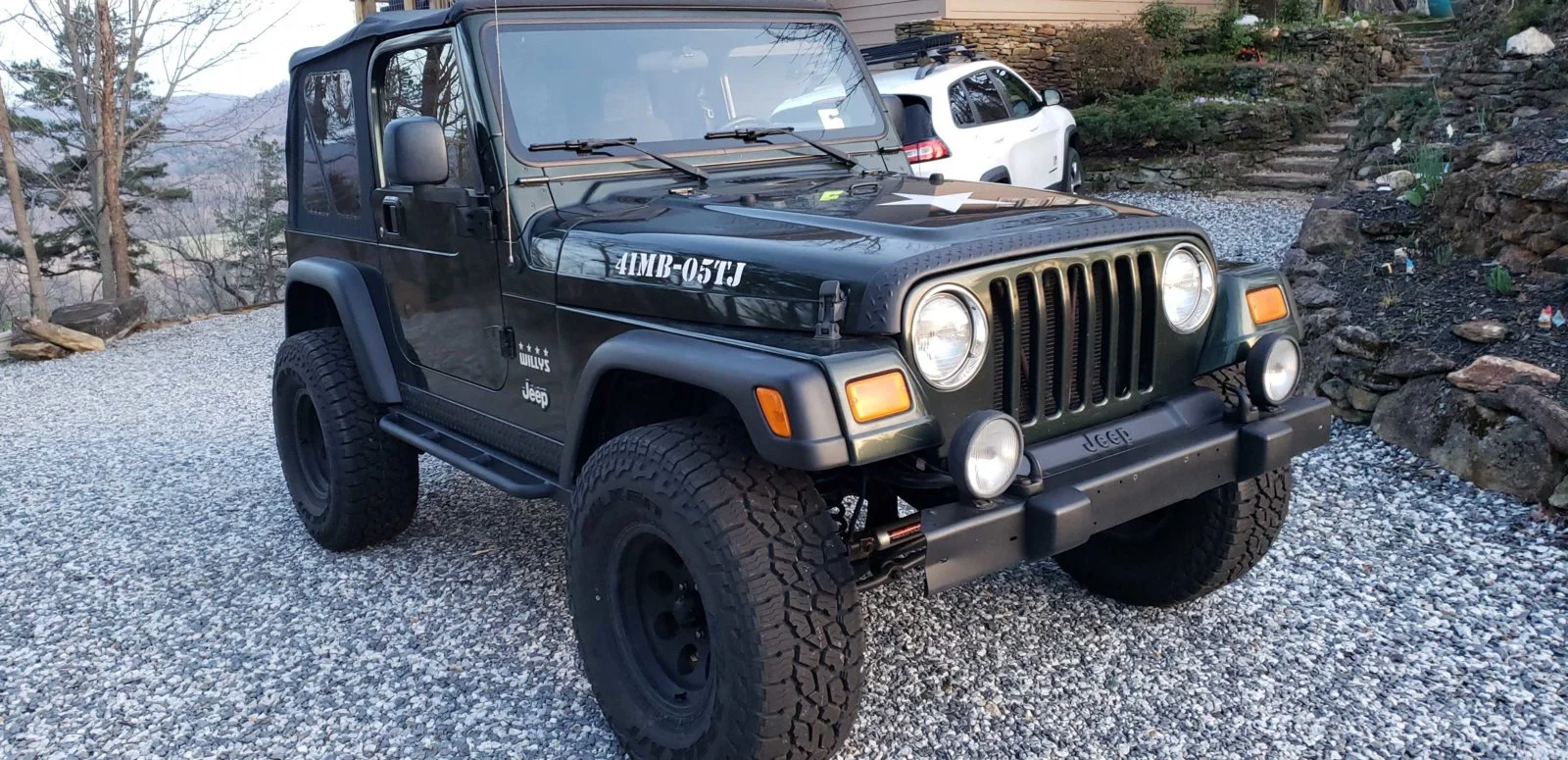

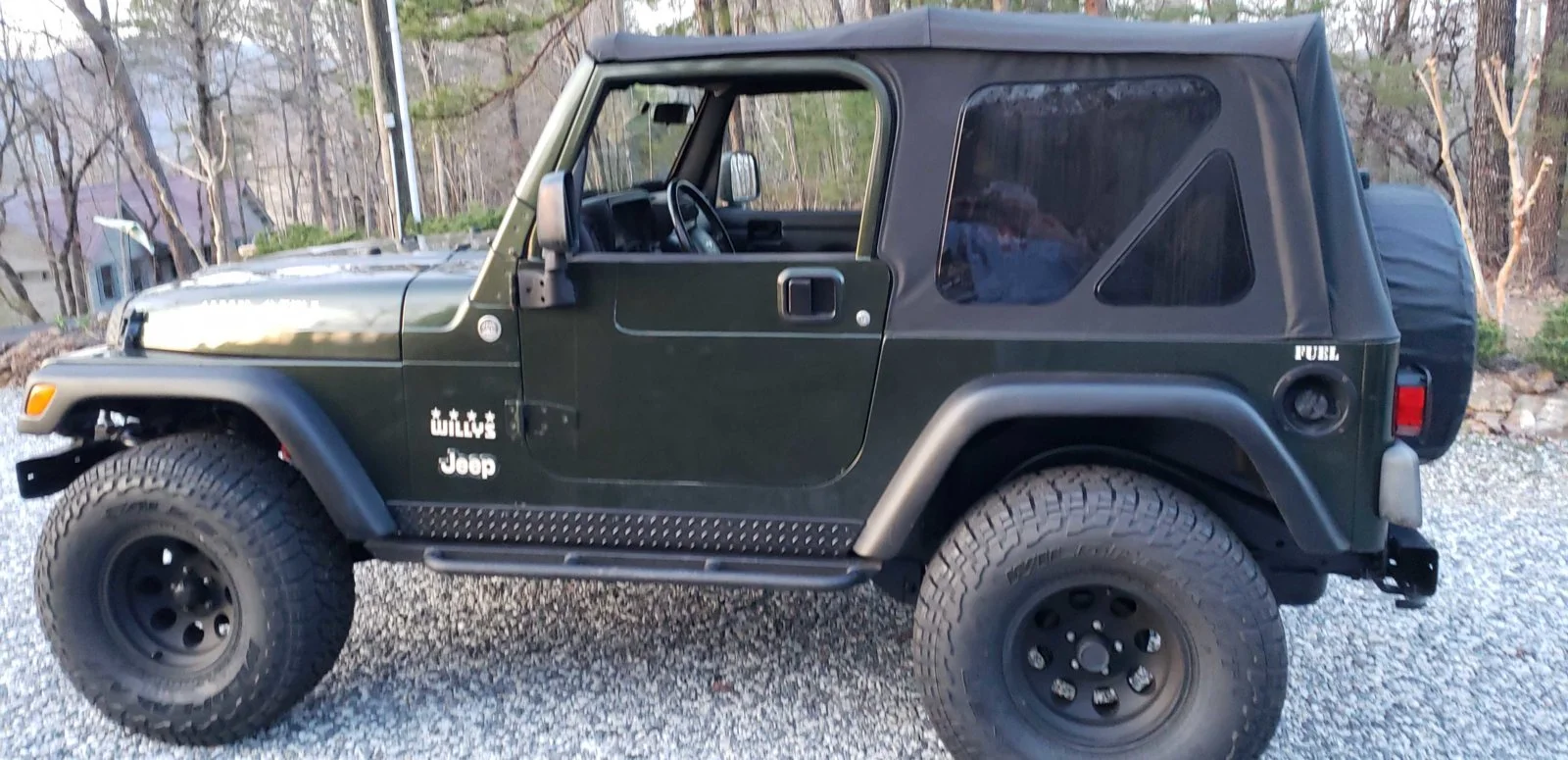

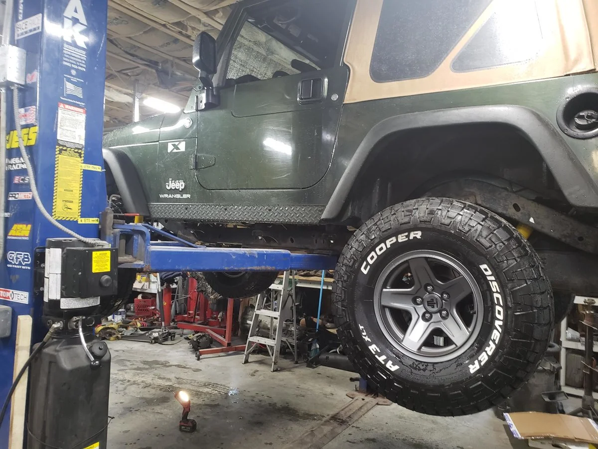

Around June this year I installed a DPG off-road kit to my wrangler, including a 2.5 inch OME suspension lift, 1.25 inch JKS body lift, JKS front and rear track bars and sway bar links and a Brown Dog Off-Road motor mount lift.
To overcome the issues of the Dana 35 in the rear, I swapped in chromoly 27-spline axle shafts (I know its not the best option but I'm on a budget)
I then put on 33 inch Cooper Discoverer AT3 xlts wrapped around some Mammoth wheels (the closest I could find to AEV TJ wheels)

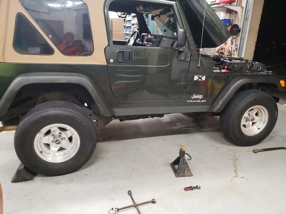

Shortly after that, my clutch went on a trip down to Cape Cod, leaving me stranded until I was able change it out at a close friends garage. I was very fortunate to have a friend with a lift nearby!
And its been smooth sailing since! I've now made many trips from home in CT to Maryland for my internship, as well as taken some trips into Virginia for trails.
