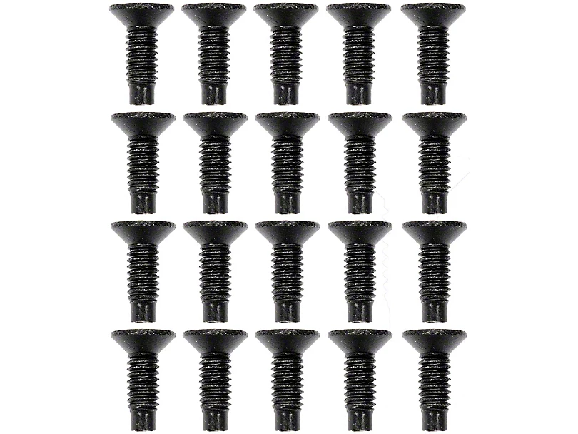

I've got these on the way for my half door hinges.
https://www.ebay.com/itm/2521448768...pid=5337789113&customid=&toolid=10001&mkevt=1
They claim these will work, if everything arrives on time I should know this weekend.
Quick update, I test fitted the replacement hinges on my half doors with these fasteners...
I'd say these are a win. They fit, don't feel cheap and can be had for a relatively decent price. I had also purchased a pack of mirror screws from the same vendor as I didn't realize the mirrors I purchased came with them. Turns out those screws (that came with the mirrors) were too long for some of the holes. I hadn't yet received the screws from the ebay vendor, but comparing them in length to the factory and aftermarket screws, they might just work. Shorter than the aftermarket screws and longer than the factory. Just occurred to me I didn't take a photo of the mirror screw comparison... 🙄

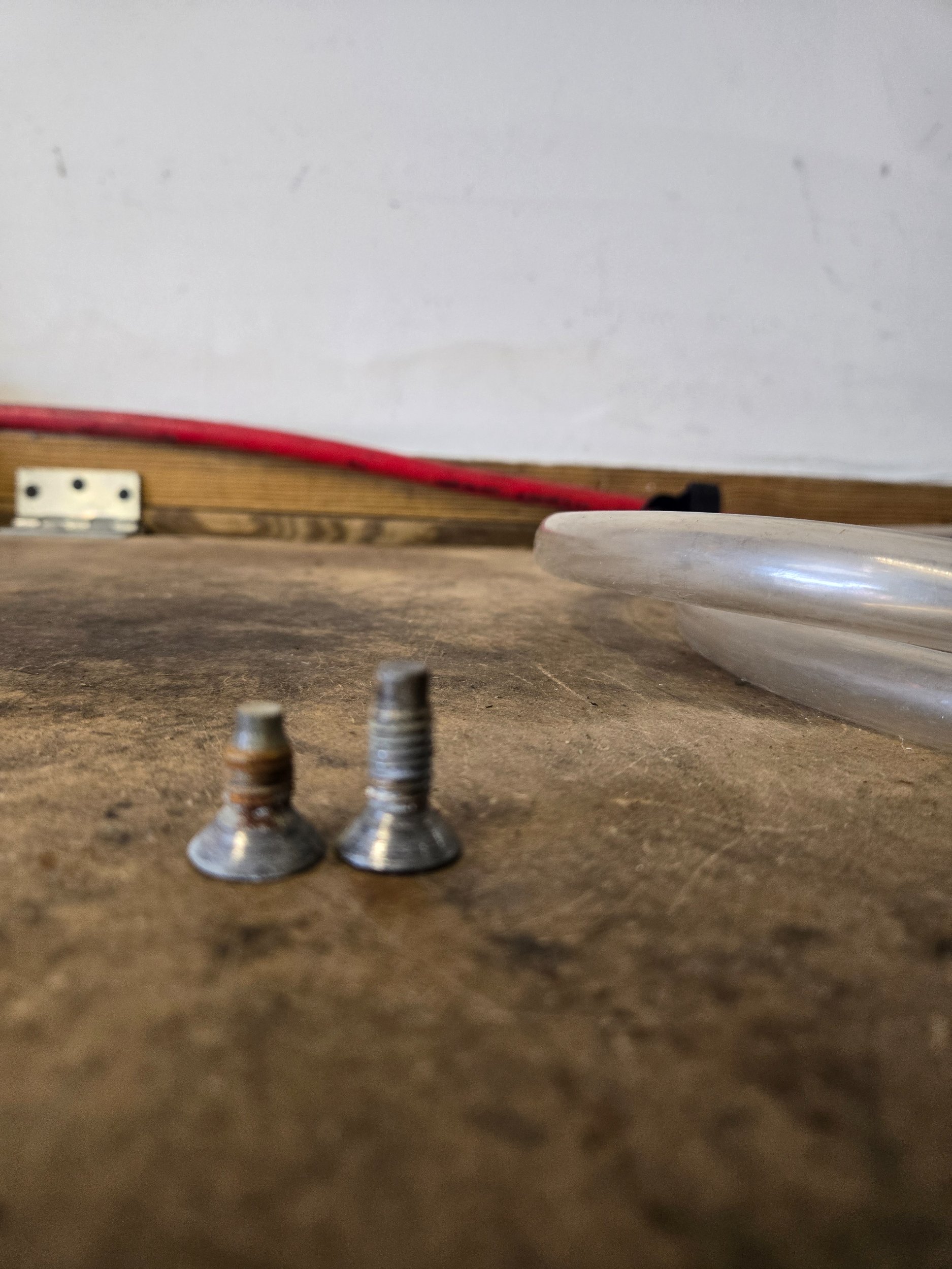

So these are the two size bolts on my 06 LJ that I just pulled out.
The longer bolt has 1/2" of thread, and goes into the body to the Jeep.
The shorter one has 5/16" of thread and goes into the door of the Jeep.
Both of them are "dog point", at about .240 diameter, (just under 1/4")
Note: I have full doors, not 1/2 doors.
This is what happens when I put the longer bolt into the door. It is bottomed out. You can see the torx on these bolts are a bit rusty. That's the reason for me wanting to swap them out...before they get worse. I got three of them out, and then snapped my T-40. At least I know now what I need to purchase.

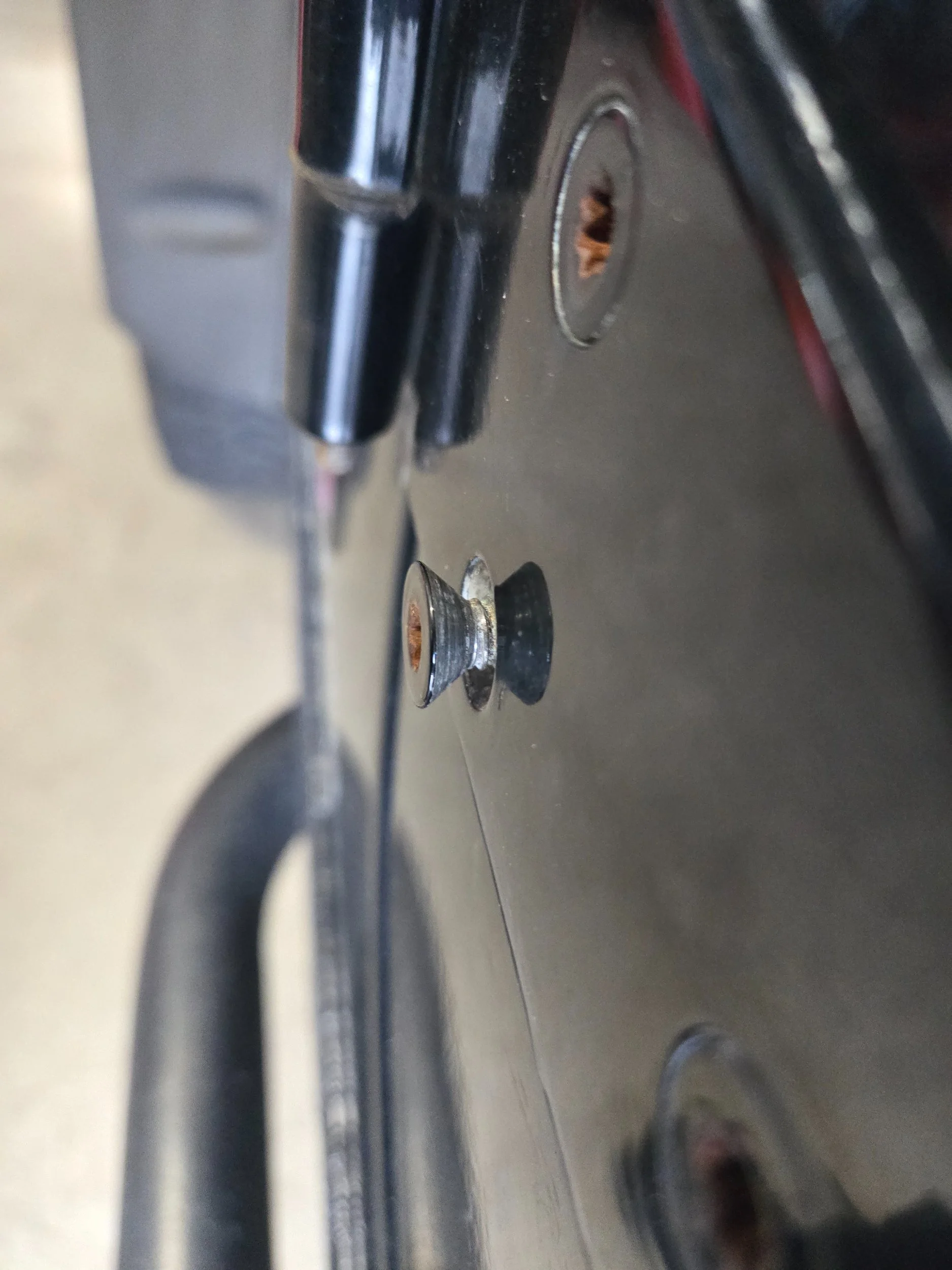

You can prevent that white corrosion in your pic by coating your screw with Tef-gel. It should also be standard procedure if using any stainless because of all of the various compositions with stainless.

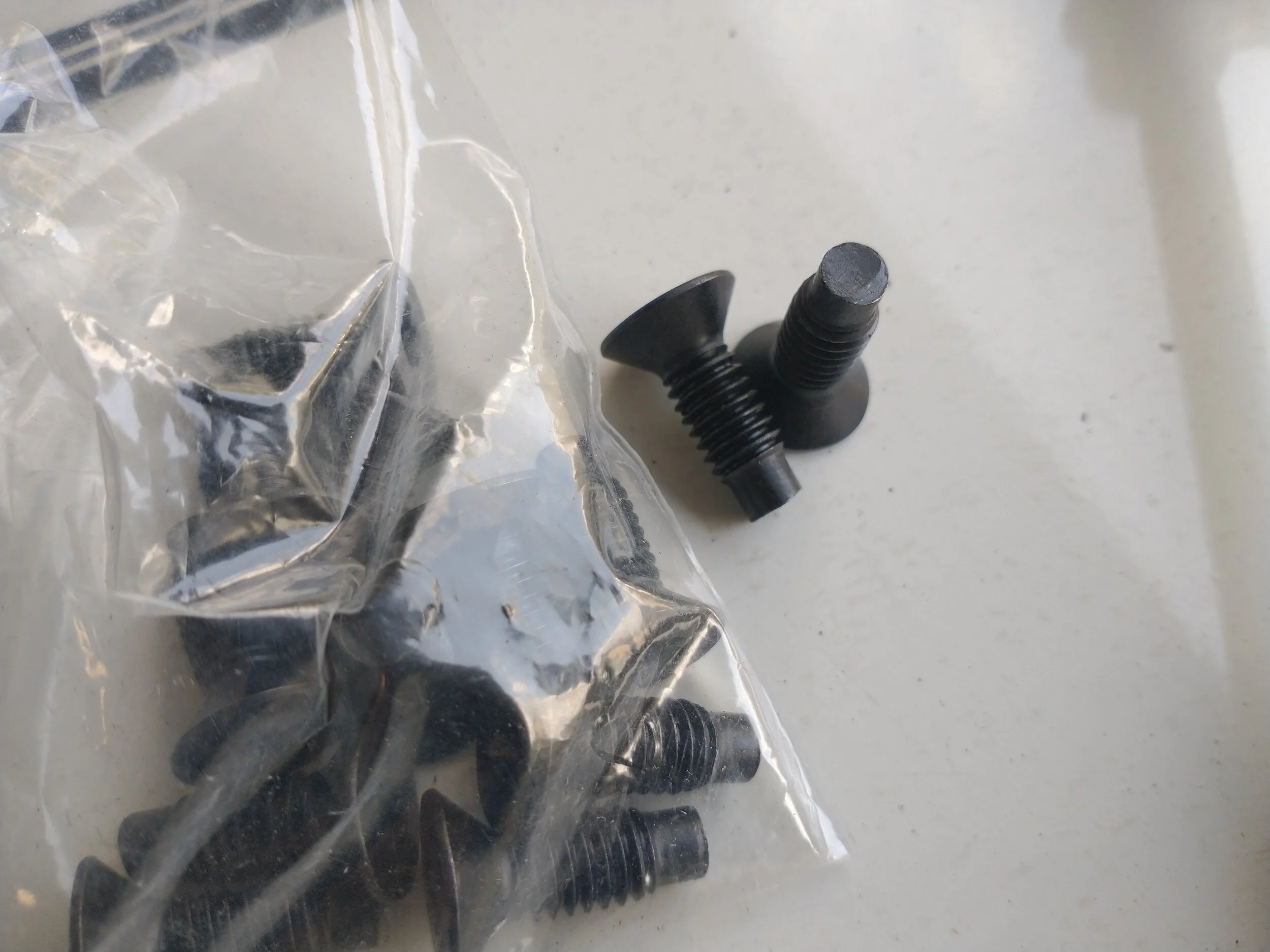

Well, Region Offroad tells me that they will provide these someday.
Meanwhile, I found these, and they are a perfect fit. Less than 50¢ each.
@Coadster32, in reply to your post above about other screws being too long, I should say that these are perhaps 0.75mm longer than OEM, but so far I have put two in without any trouble. The same link also offers a 12mm option.
