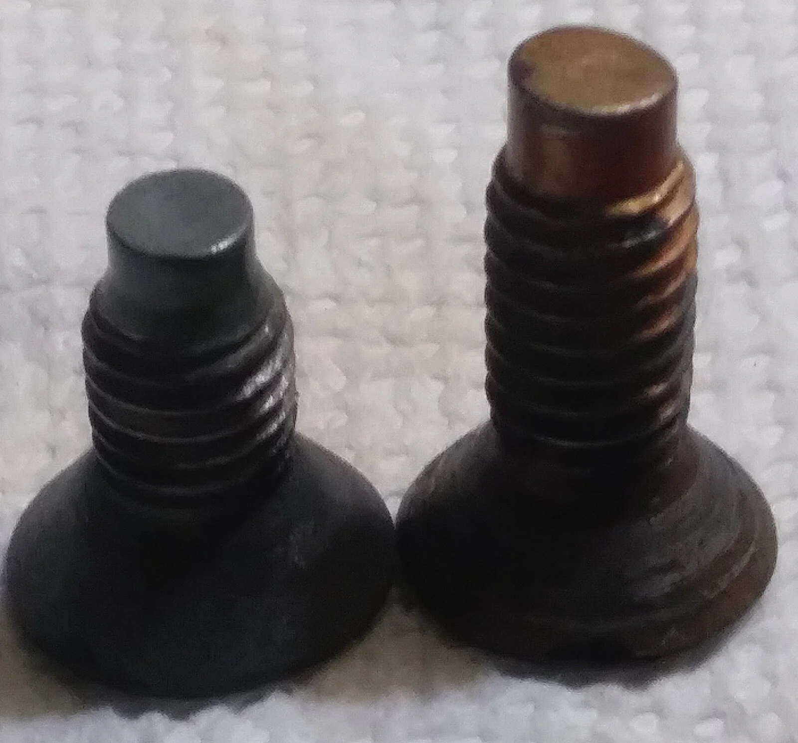

Does anyone know if or when they changed the door hinge bolts and to what size? I wanted to paint my half doors, and of course I stripped a few out. Dorman p/n 926-888 is listed for 87 to 95 and 97-04.
I'm not sure what years the doors are, as I got them used
87 to 95 would be a YJ. 97 to 04 is most of the TJ.
I think the YJ door would need some modification to the latch mechanism so you probably have the TJ door..
I'm looking for some of the recessed torx head bolts that hold the hinges on the door, can't find any local.

When I tried to order them, it says they don't fit my '06...I'm not even sure the doors are from an '06
Can you measure the thread and pitch off the ones you didn't strip?
I'm pretty sure they're "supposed" to be 5/16-18 but I tried the templates at a few stores and it seems like the best fit is the metric M8, I'm kinda confused now.
I Definetly have to re-tap 1 that I drilled out
my 2003 uses 5/16”.
I forgot I have a guy local that parts out early CJ's up to '06s, so I grabbed a few off him.
It looks like at least mine were changed at some point (his came from 2 different jeeps) mine is on the left, a bit shorter.
