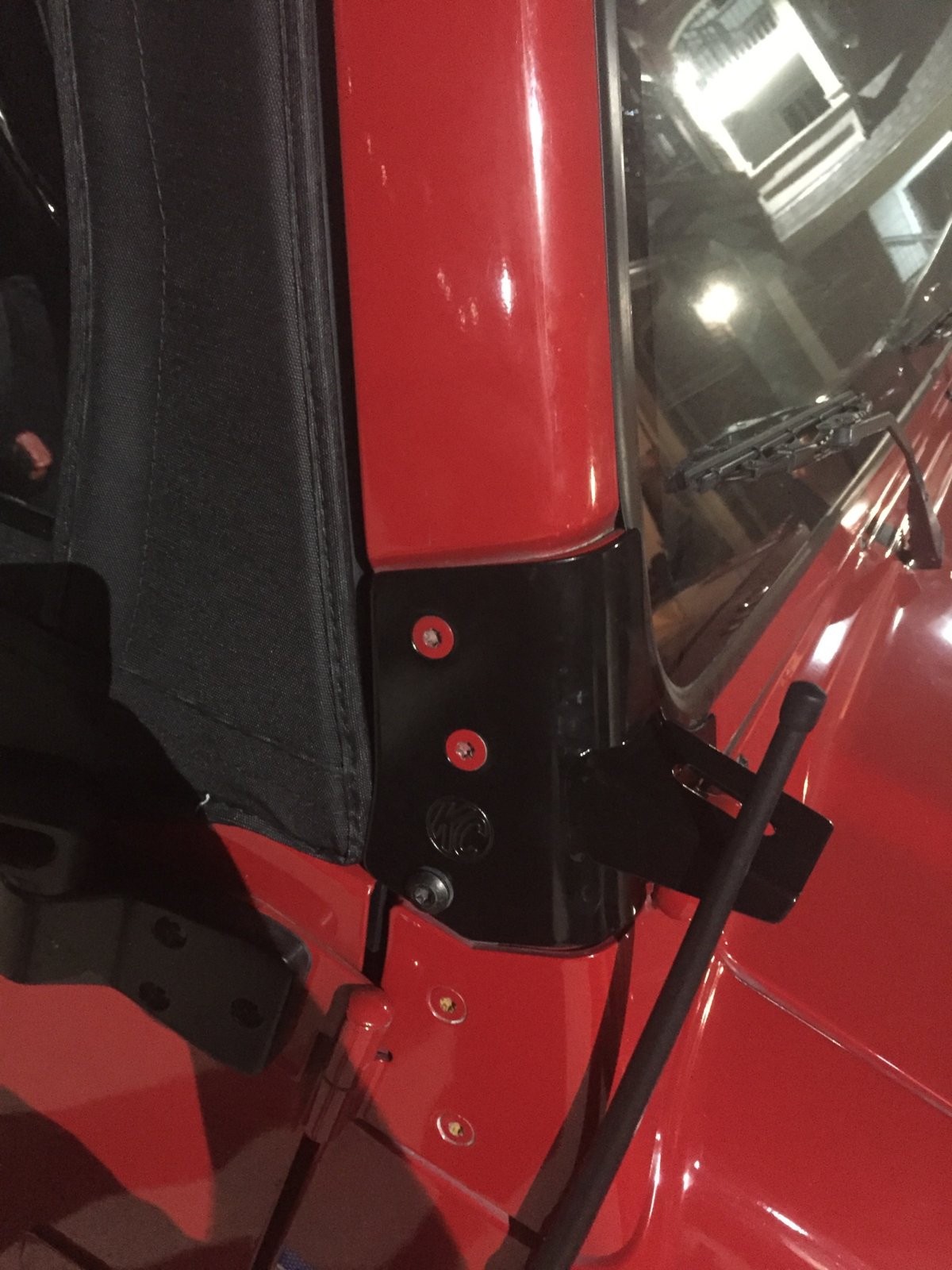

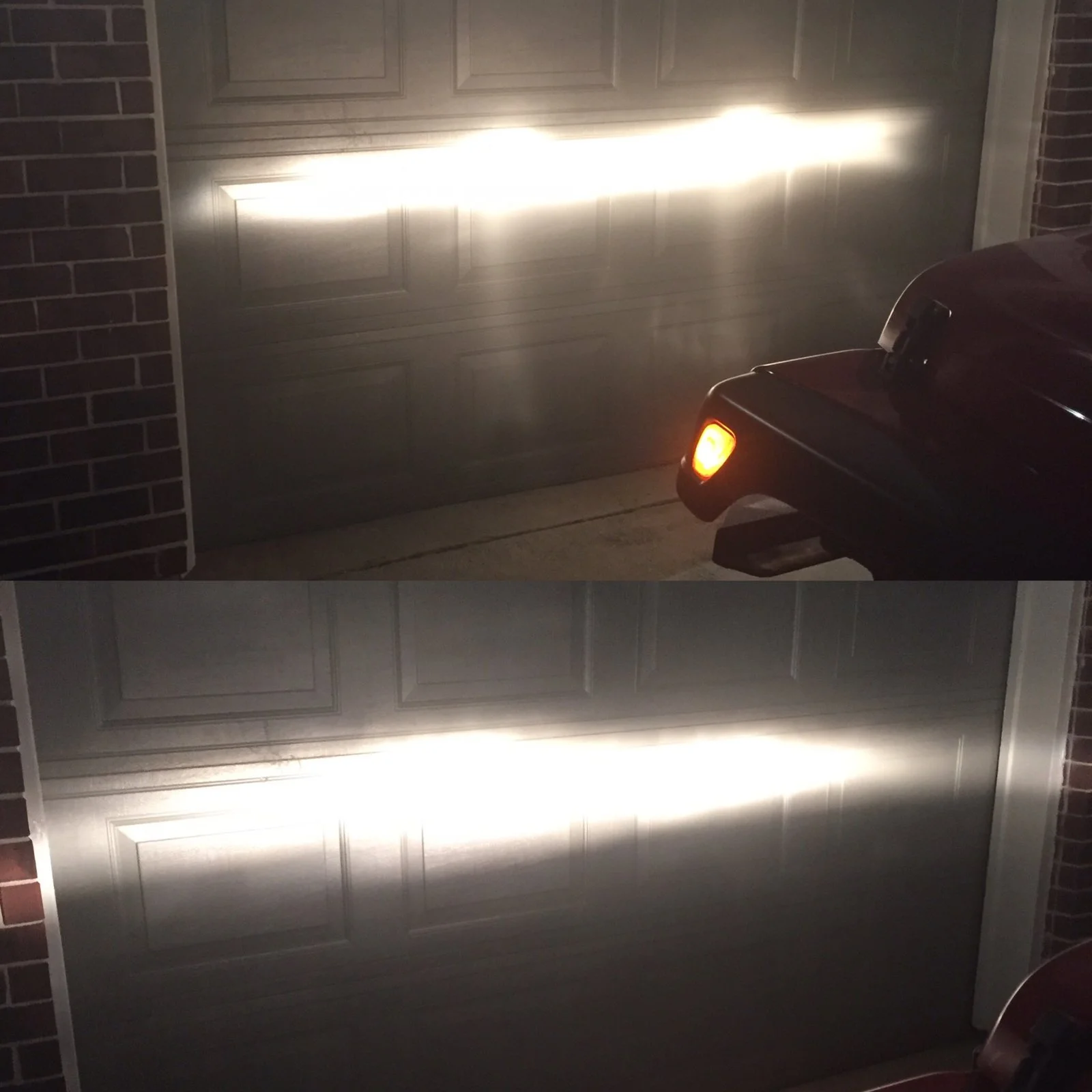

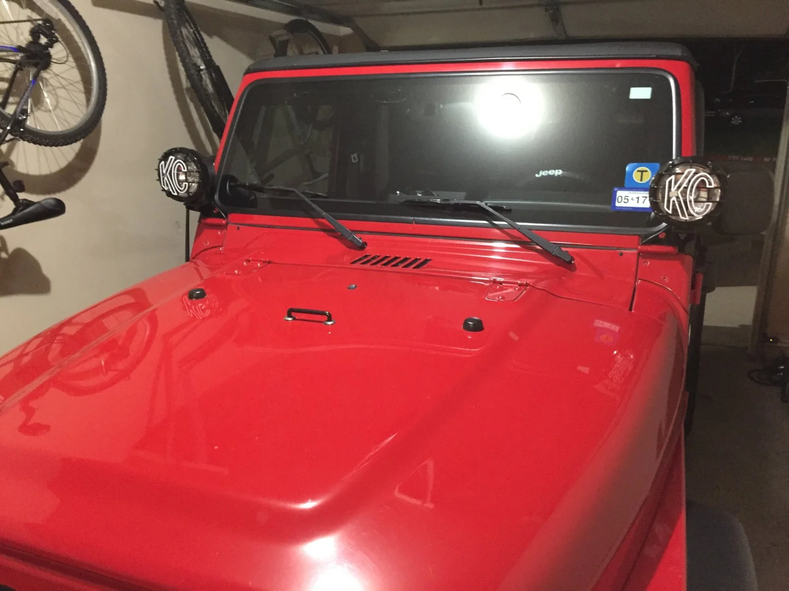

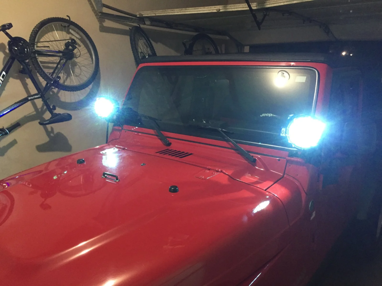

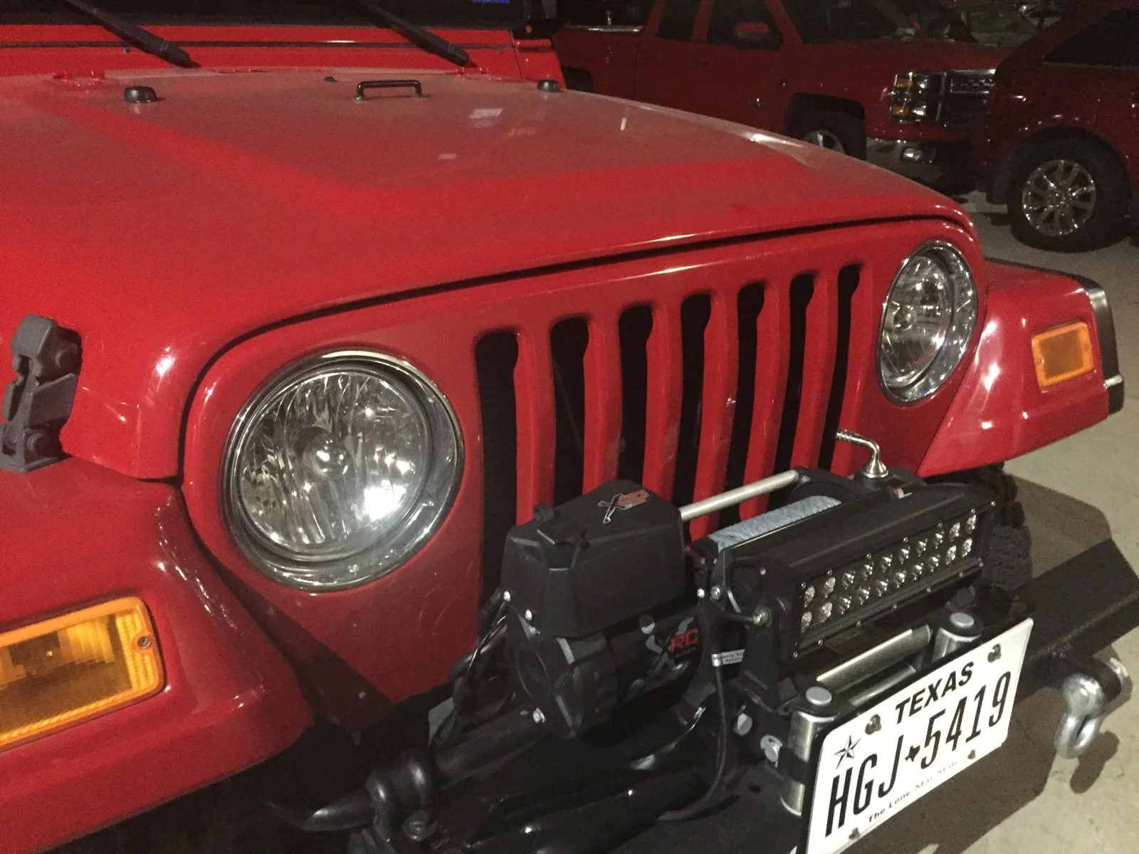

So in the meantime I went ahead and installed our JK headlight conversion and our KC windshield light brackets. I'd say it turned out well and I'm very pleased. The goal is to put the KC HID's off the Jeepster on the windshield of the LJ and to buy a cheaper set of halogen KC lights to go on the Jeepster. This way the LJ will have a fog pattern light bar on the front and 2 spot pattern HID's on the windshield. Pumped about the factory switch set up as well to have a nice clean install. We don't really take our Jeepster off road and it is more of a car show cruise around town kind of Jeep. Will be nice to have some street legal fog lights on the front bumper to keep things more visable with the sealed beam head lights.

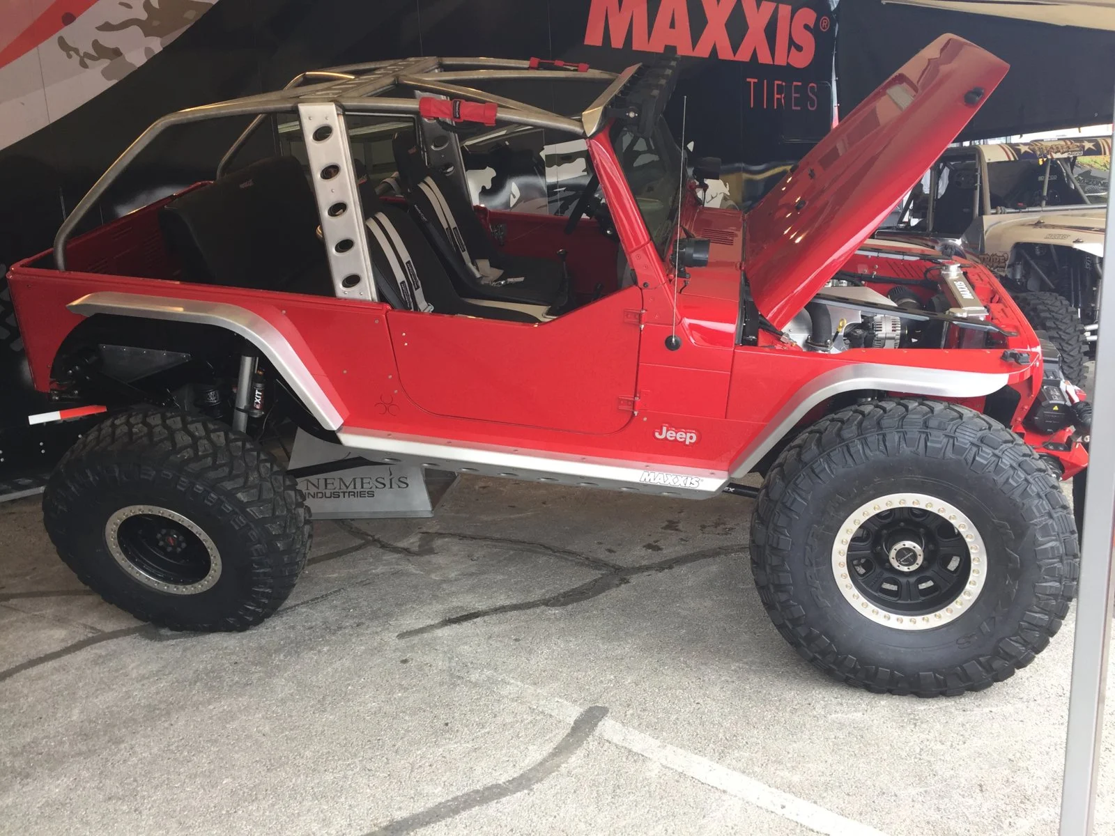

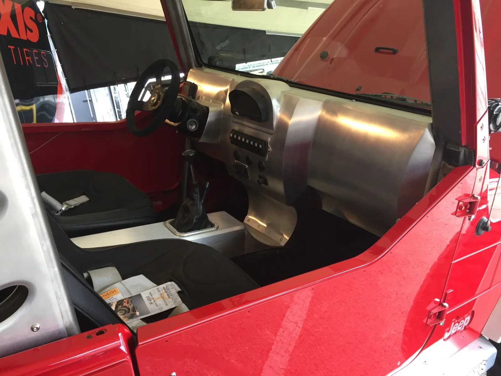

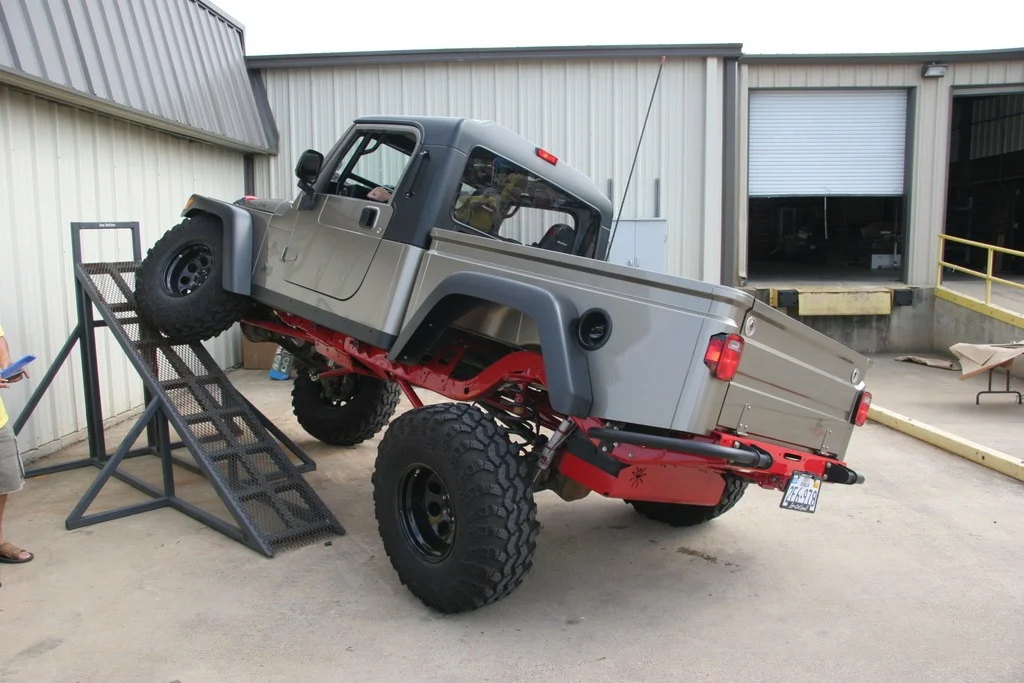

More updates to come once we get the steering all lined out and what we decide to do. Until then enjoy the pics. The white LJ and Brute are owned by the owner of Screamin Lizard out here in Dallas. He is a certified AEV dealer. A pic of the KC light brackets installed, headlight change against the garage door (top is before and bottom is after), and the finished product on the LJ.

The Smittybilt winches already have holes in the fairleads for the light mounts! We picked up our KC light bar at the Truck and Jeep fest convention last summer for $140. And it came with a switch and all the wiring needed. Super easy and simple install too!

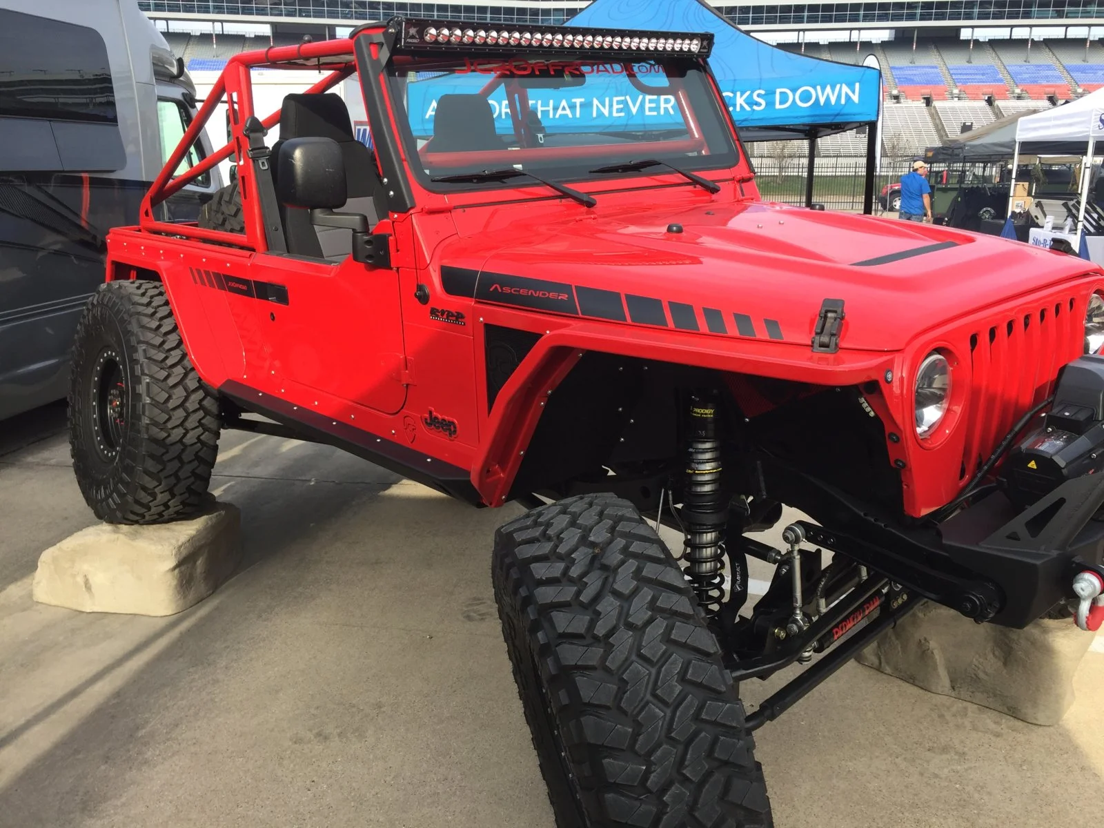

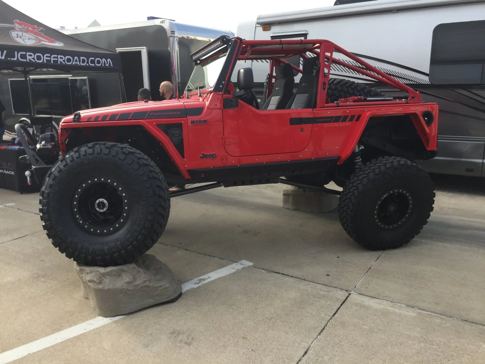

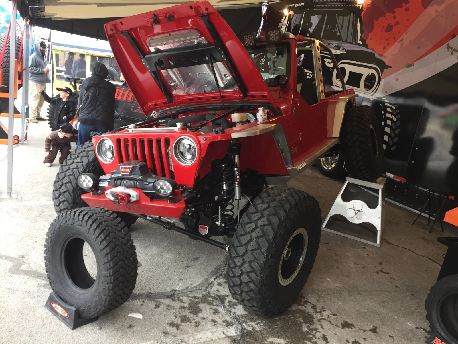

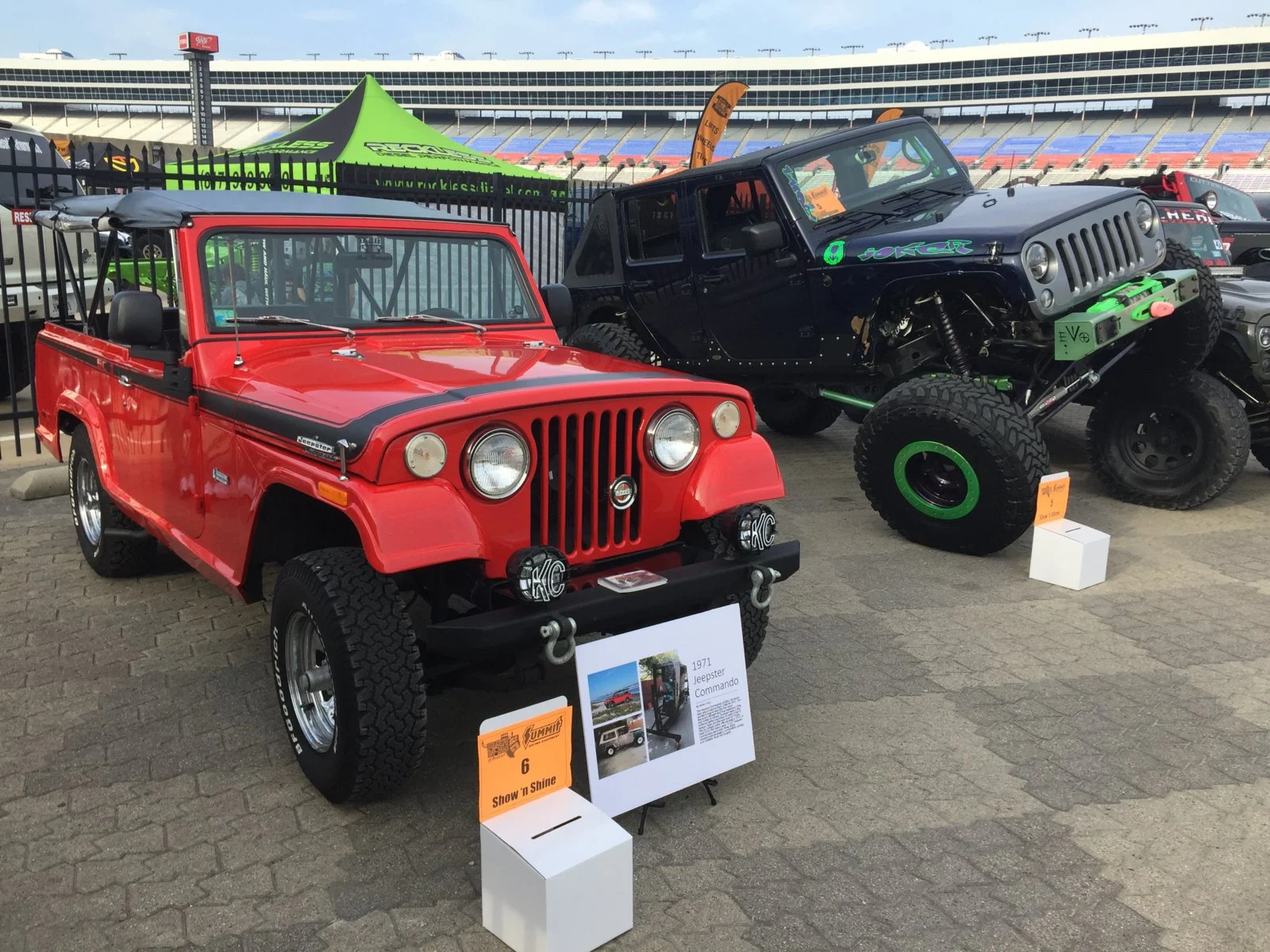

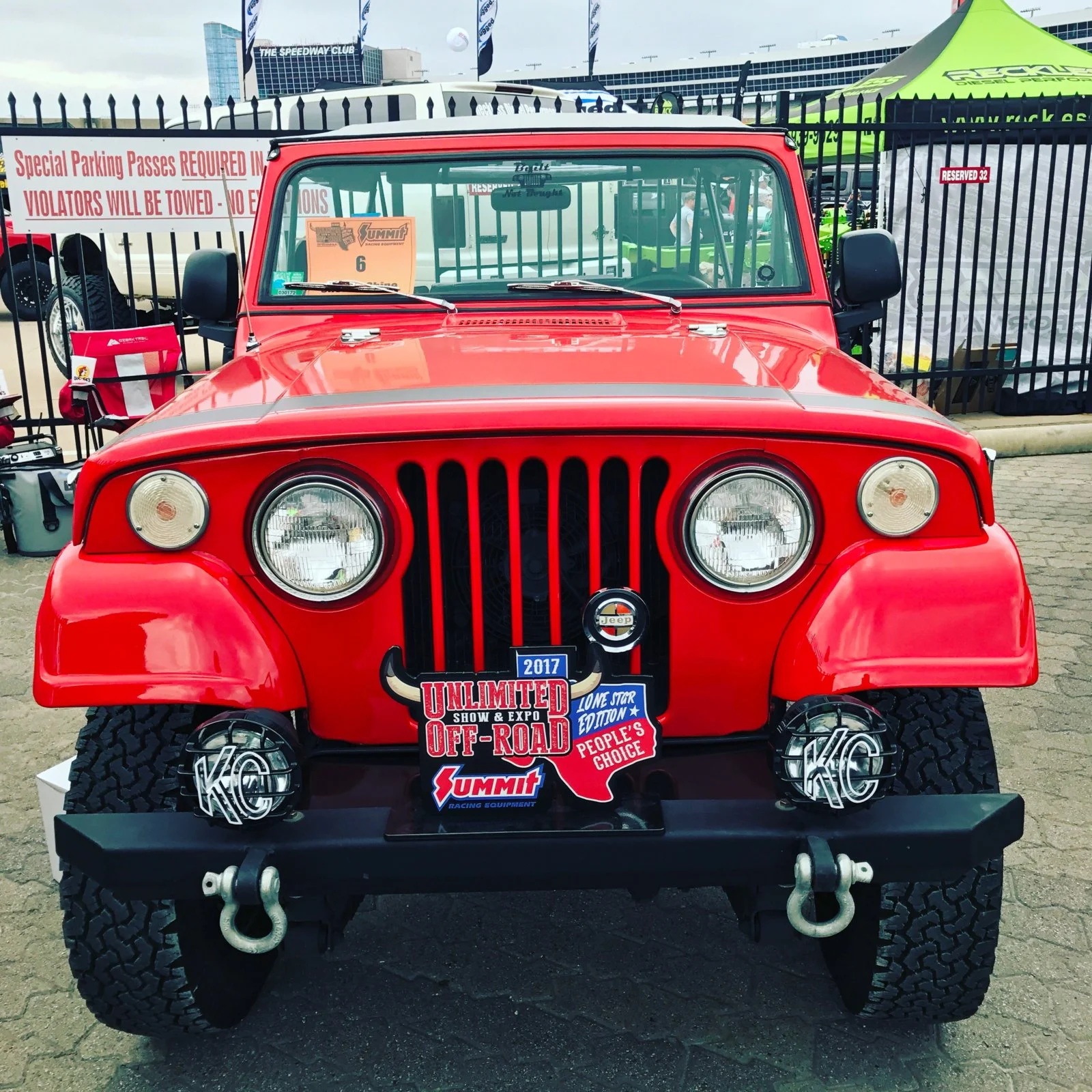

Had a great time at the Texas Motor Speedway offroad expo. On Saturday the Jeepster won 1st place in the people's choice category which came with $500 cash! I also won some KC lights (plan on putting the new halogen ones on the Jeepster since they don't get used much and moving the HID's to the LJ), a factor 55 ultra hook, and a $250 gift card to JCWhitney. Again it was an awesome weekend!
Since I already have the 1 inch body and 1 inch MML I want to continue to pursue doing the tummy tuck. I've seen some people on here saying an SYE kit will be needed and others say an LJ won't need one since it has a longer driveshaft. Chris, what are your thoughts? 2 inch suspension and 1 inch body on an LJ. If I need one I will invest in the SYE and a new Adams drive shaft. I will also save for the Rokmen or the Teraflex skid plate for the transfer case. If not I'll just get the skid plate for the transfer case and the gas tank skid that raises the gas tank up an inch-inch and a half.

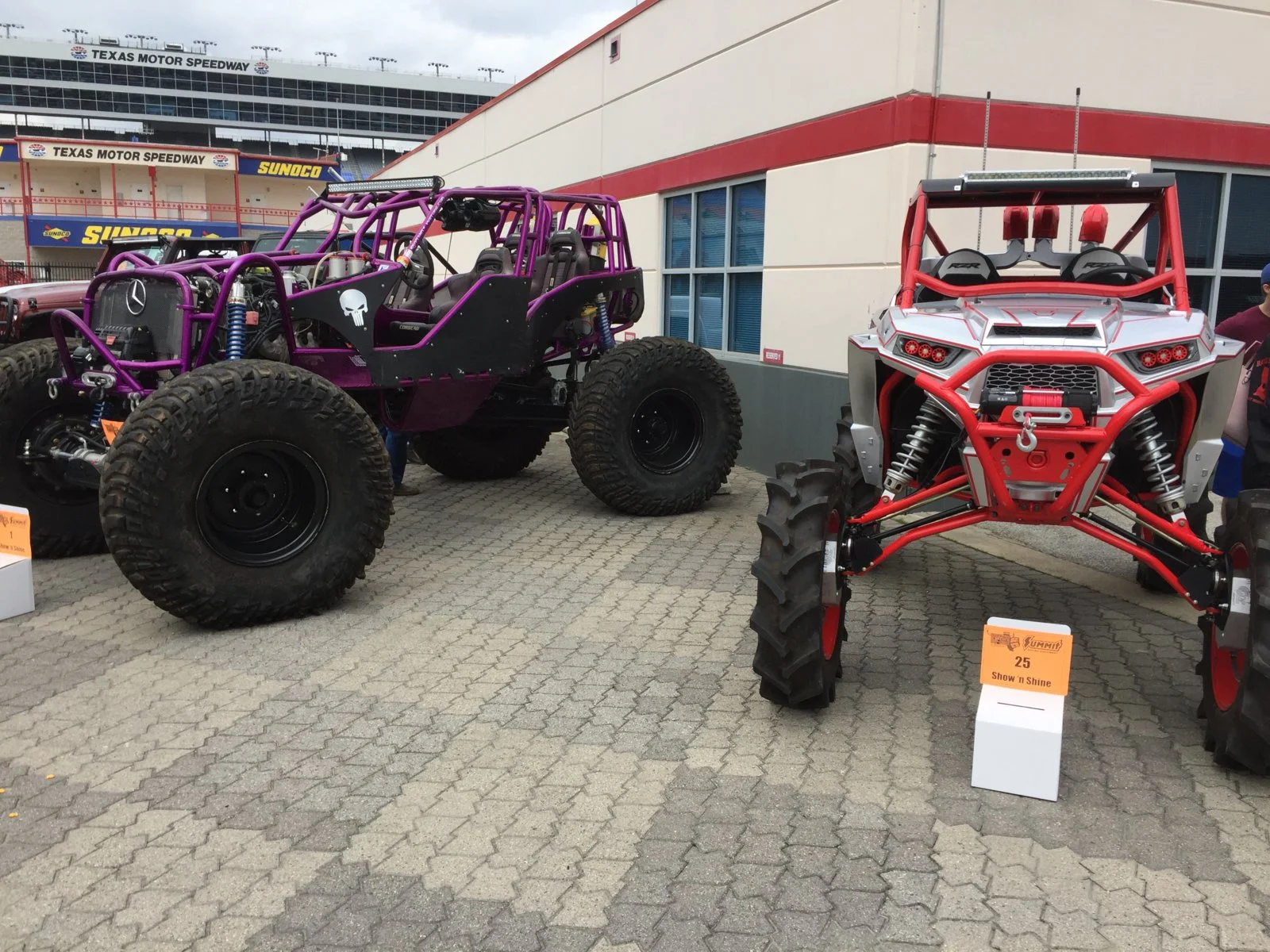

I guess you could say I have real first world problems. Enjoy the photos from the expo below!
Sweet man!!! And you won $500? Can't complain about that, how awesome.

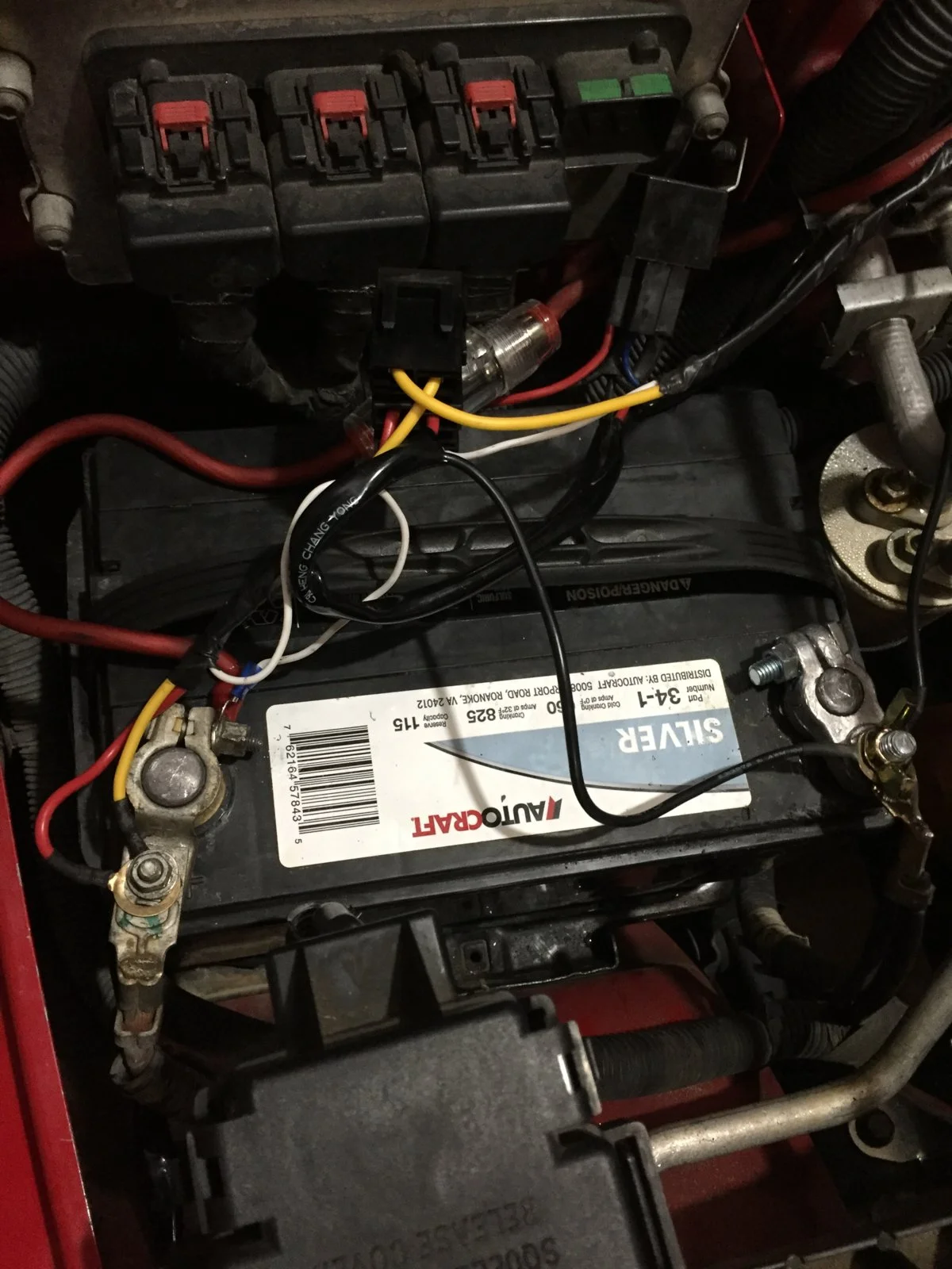

Well today I went ahead and installed the lights on the windshield. Really happy how clean they came out. Wiring wasn't to bad... except I can't get the switch light to come on when I turn the lights on.. I've tried just about everything I can think of. I think I'm just electrical illiterate lol.

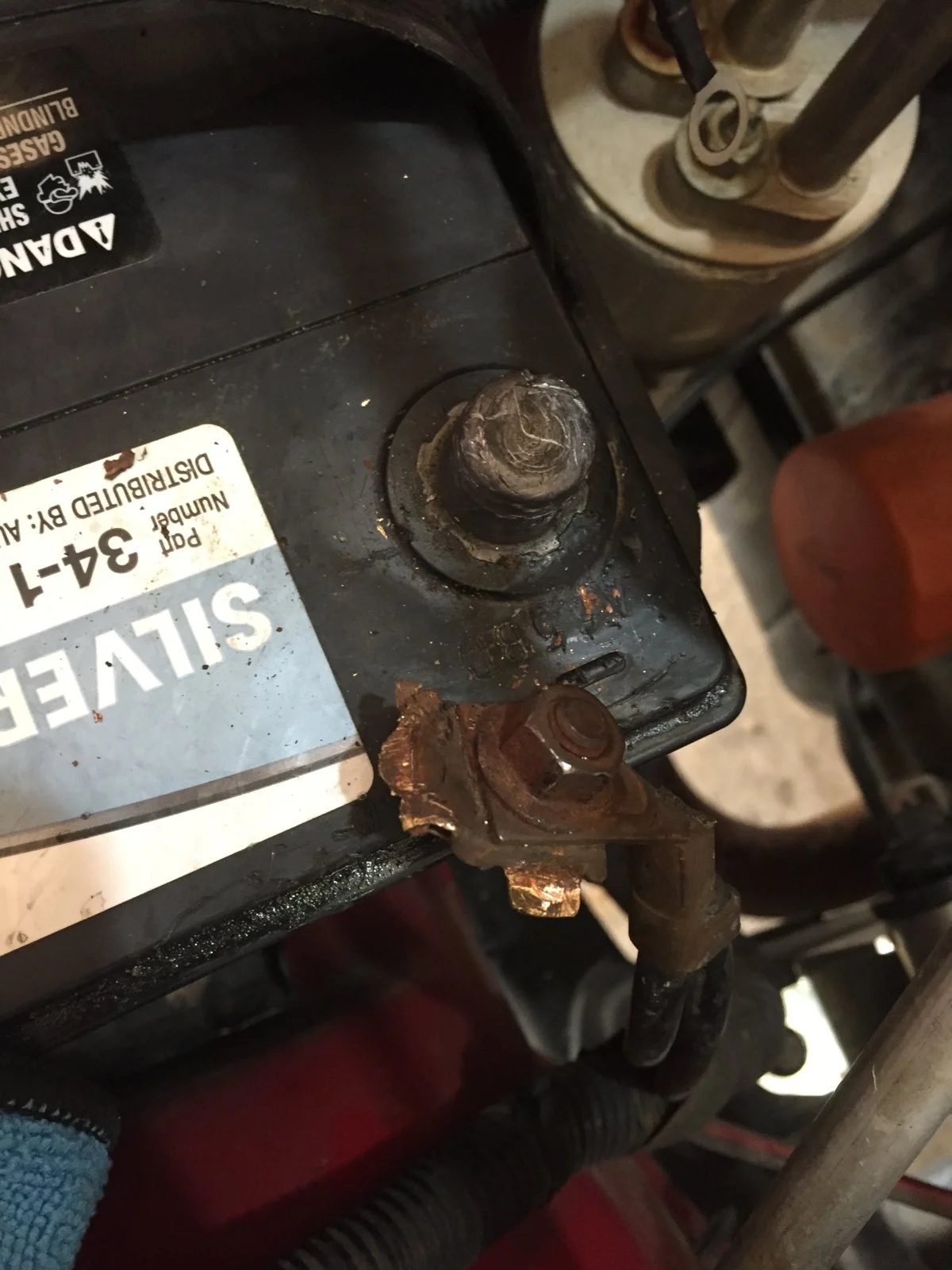

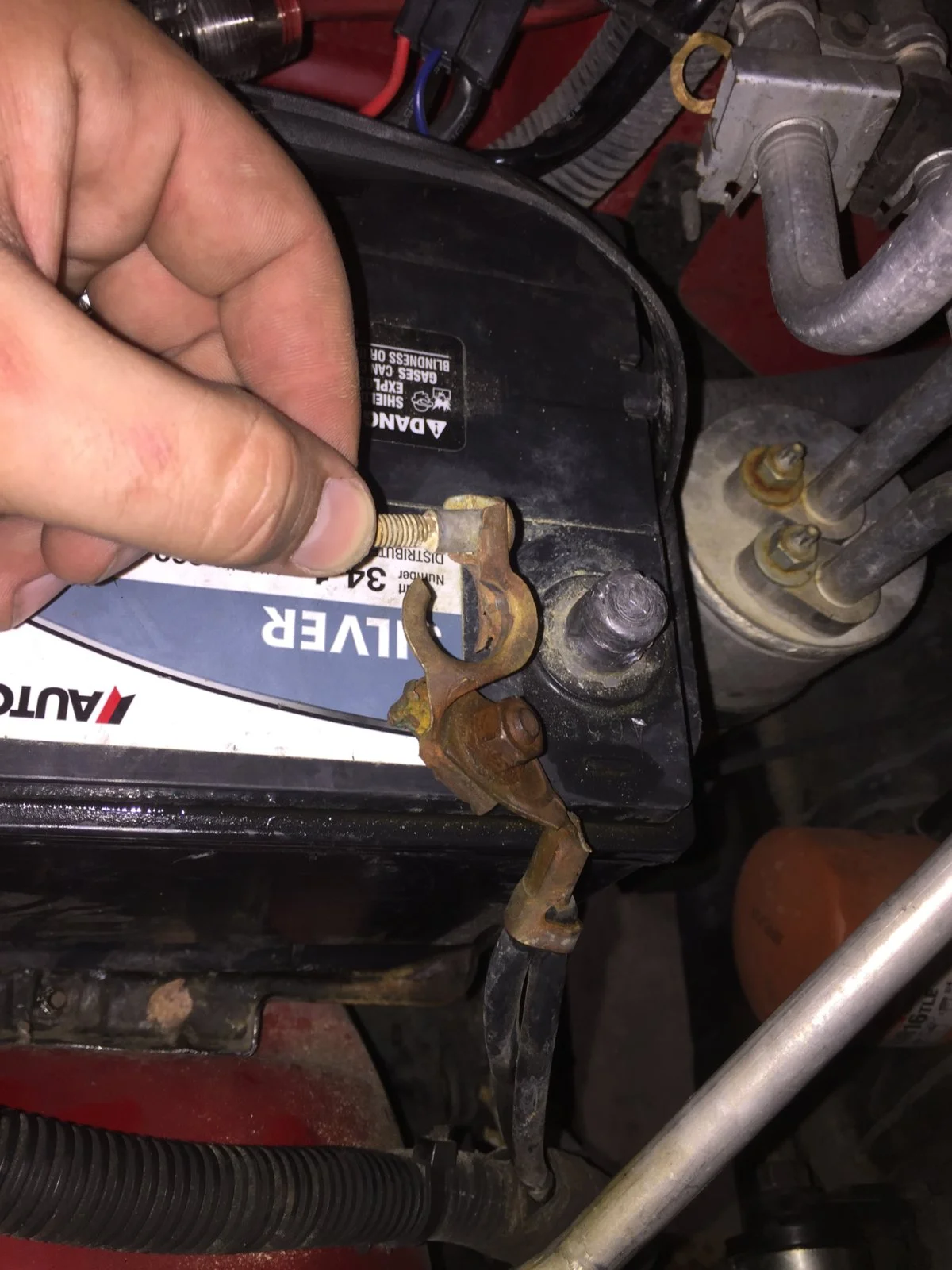

When I was working on the lights I noticed our negative battery terminal was shot. I went ahead and replaced that while I was at it. It really kicked my butt! It kept falling apart in my hands. I hit it with the PB blaster and the blow torch until it broke loose.

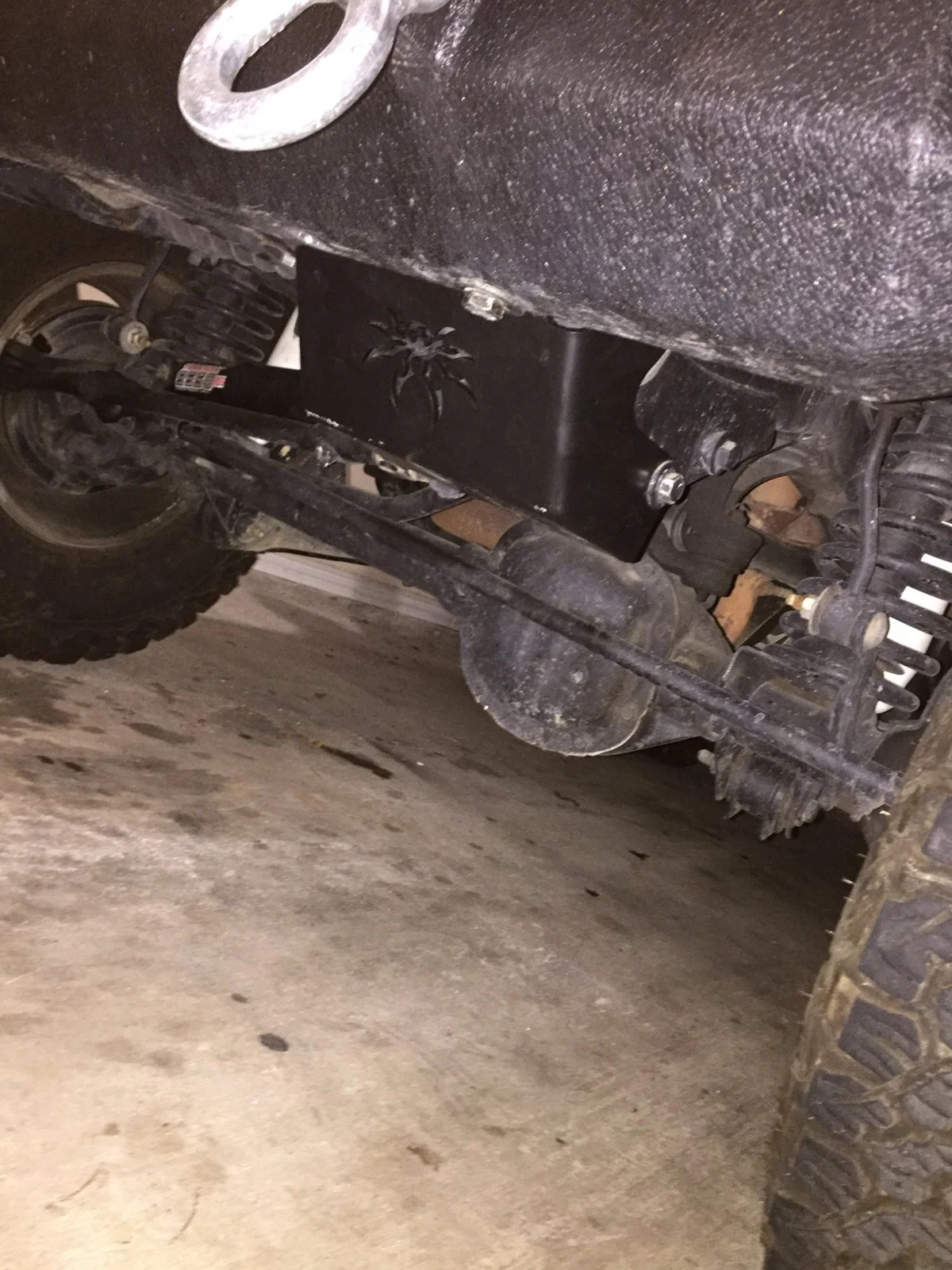

Last but not least I also installed the poison Spyder steering box skid plate. It's really stout and I like how it's universal for whatever bumper you are running. It's really stout and I have no fear of rocks hitting it now! Big things are coming this next week. More pics to come soon!
Looks awesome! But man, that negative battery terminal is indeed toast... WOW!
