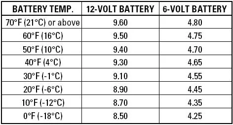

10.9v while under load from a load tester indicates a good battery. This chart indicates what minimum voltages are acceptable at what temperatures...

Thanks for that chart. I snagged a copy.

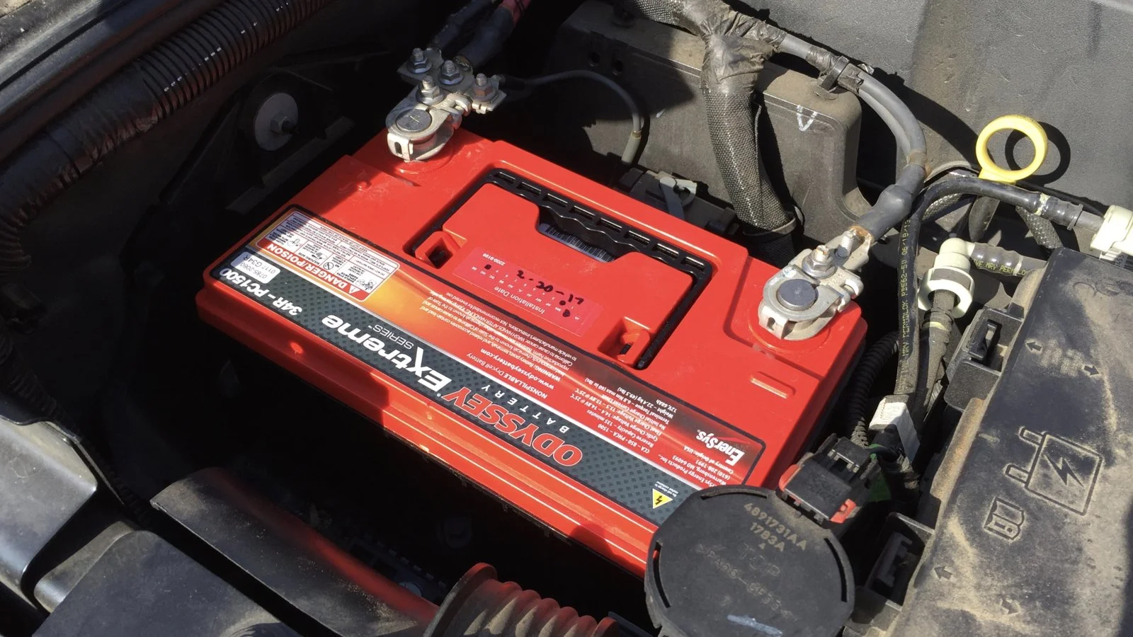

Pulled the factory battery, dropped in the Odyssey 34R-PC1500, clamped it down and hooked it up.
First turn of the key: BAM! Started up better than it ever did with the OEM battery. The stocker is 600 CCA and the Odyssey is 850 CCA. I turned the key and it was running. Great battery for a jeep with add-on things like a winch or lights and such. Glad I now have that upgrade ——- and glad that the JK starts up again.
Thanks to all for the help and ideas. The main lesson here was that the JK's CANBUS will not work at all with a mildly tweaked battery. If it is about to fail your JK will not go. Period. It simply will not send juice to anything on the vehicle. It is like you have no battery installed, save for some odd symptoms. This battery was fully charged and would start up the TJ, but it was dead to the JK's CANBUS. Go figure.

Here is the new (backwards) Odyssey in the JK. Nice batteries, these Odysseys...

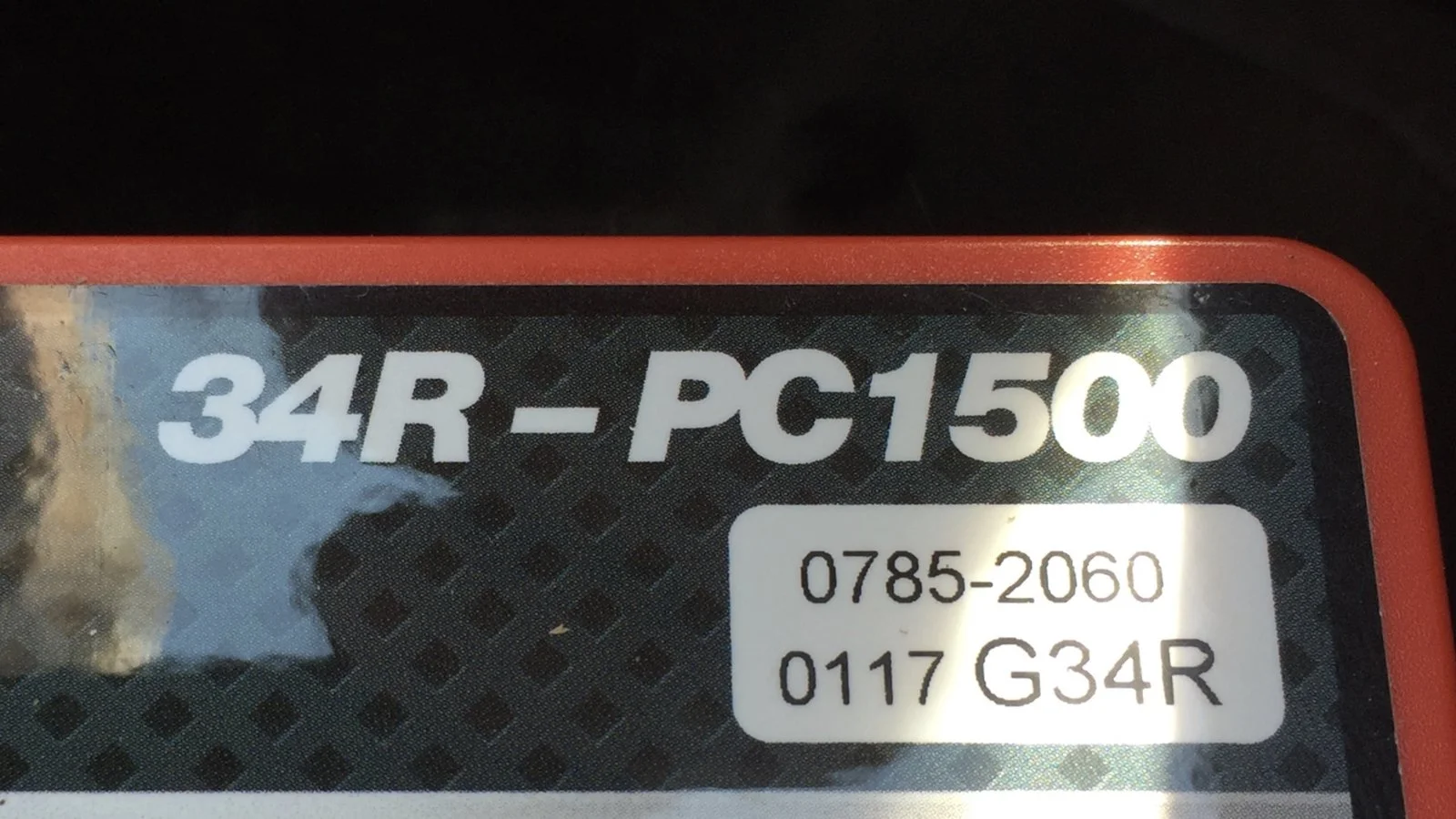

Here is the model number in case, like me, you also own a JK and want this upgrade. It is a fantastic battery on the TJ and I expect it to be a gem on the JK, too, moving from 600 CCA stock to 850 CCA. Spendy and HEAVY (50 lbs.) - It is worth it.
