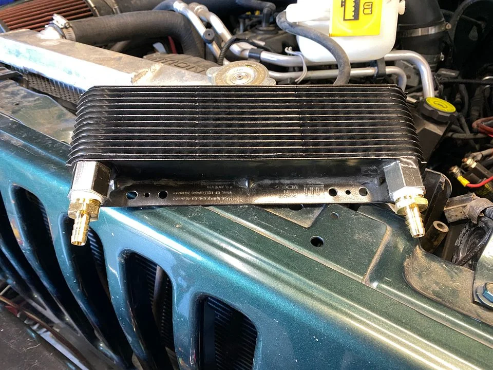

Hello all. Just to update from the last post, I did get the built jeep that was local to me. I've had a blast the last couple days playing with it, cleaning, and servicing it. I have a question regarding a tranny cooler. I know that most threads end up referencing the derale kit that is made for the tj. I already had a hayden 679 laying around for another vehicle, figured i would use it on the jeep. Searching led me to a couple posts with the 679, but not a lot of information about the install. I believe what I found most referenced a red tj. What is the "V" support bar in front of the condenser for? Can it be removed? Seems like it is in the way to add a cooler there, but people have done it so I'm wondering if they just took it out or not?
I also read chris's write up for plumbing the cooler. Just to verify, I would pull off the passenger side hose connection from the radiator (32rh), run hose from that point to the new cooler, lower connection when placed sideways, then from the top connection run a new hose to where the original hose went. This sound right?

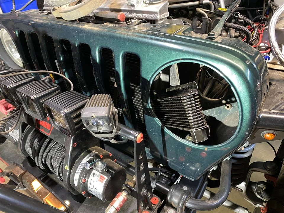

PSC makes a kit that mounts a single or dual cooler in place of the V-bar. You want some form of support there, as you don't want the grille (and radiator itself) to flex much. The plate bolts in place of the V-bar.
@mrblaine also uses a lot of higher-end Setrab coolers with great success. Much better product, but also like 4x the price tag of a Derale.

Thank you for the information! I have the radiator and condenser unbolted. I will leave the support bracket in there. Can a cooler then be mounted in front of the bracket? Can you zip tie the cooler to the bracket? Never installed one, and dont want to mess it up. Not sure if zip ties will put pressure on the plates/fins and damage them.

I don't know that I would use one on the 32RH, they are not as hard to cool as the 42RLE. I won't use anything but the Setrab on the 42 since they run way too hot.

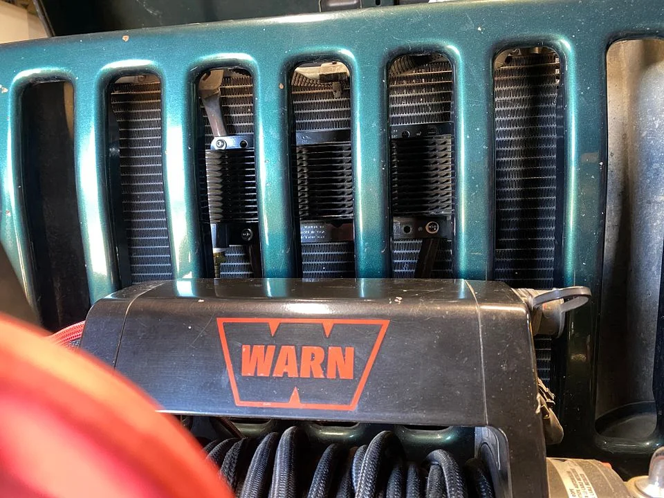

I was able to get it mounted. Used some padding in front of brace, then just used the plastic mount things that came with it. Holds really tight actually, doesnt move. The supplied hoses are too short though, so wasnt able to finish tonight. Does the 32rh have a temp readout that can be read by obd2? The PO was over at my house today talking more about his jeep. The tranny fluid is pretty new, and clean. He felt like he never had issues with heat in the tranny. Did the rubicon a couple times and other hard trails. Am I just wasting my time adding a cooler? I just want to keep it running good as long as possible.
There's no temperature sender in the 32RH, you'll need to install that on your own. Mounting the sender in the pan is the best way to go.
