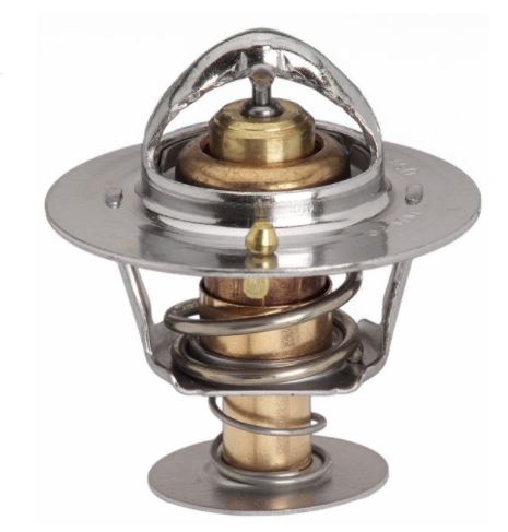

Did you position the new thermostat so its jiggle valve that lets air pass was positioned at the top? The brass gizmo on the flange this Stant thermostat is what allows air to pass through to assist the engine to eventually self-burp itself. If your thermostat doesn't have one, you can drill a 1/8" hole in the flange as close to the inside edge as possible, then mount it so the hole is at the very top. Eventually the cooling system will self-burp itself but doing this will speed up that process. Keep an eye on the coolant level to make sure it doesn't drop too much as the air leaves the system.
IDK if I did or not, I will remove and check. 👍🏻 The new thermostat is a Stant 195*.
