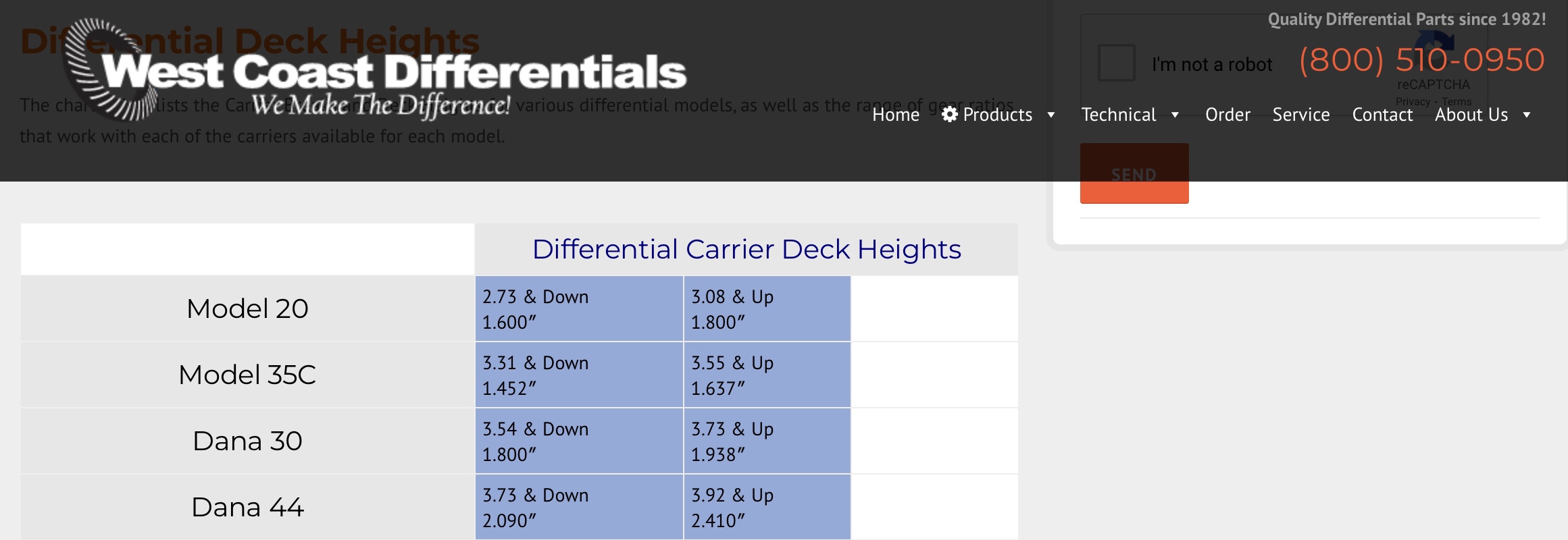

Jeep is on 31s with 3.73 gears. May move to 33s in the not too distant future. Carriers for my LSD front and rear only good up to 4.11. Thinking of regearing to 4.11 with the new motor. I've read mixed reviews on whether gears can be run taller when moving to a stroker.

Even with the 4.6, you will still want the proper gears for 33’s. With the 5 speed 4.88’s are recommended. I’m no expert but something doesn’t sound right about your carrier breaks. A Dana 30 is 3.73 and up. A 35 is 3.54 and up . So that means you can install 4.88’s. A Dana 44 is 3.92 and up but that can be fixed with thick cut gears I believe.
I'm going off of information I received/read more than a year ago.
For reference, I have a Dana 30 front, Dana 44 rear with Truetrac LSD front and rear. Should be factory splines for both. Are you saying I misunderstood or was mislead that I can't go deeper than 4.11 with my setup?
You can go to 5.38 in the rear with gears made for rubicon tj's. The front you'll need to change the carrier

You can go to 5.38 in the rear with gears made for rubicon tj's. The front you'll need to change the carrier.
This carrier replacement requirement is making me think going to 4.11 might be a better option. Especially with the added torque of the 4.6. But I also don't want to half ass this when I'm likely about to drop $15k on all the rest...

Regarding carrier breaks, here is a chart from west coast differential.
So if you are now at 3.73, you should be good to go up unless you have rear Dana 44.

See above. I've got 30 front and 44 rear. That means 4.11 is the lowest I can go?
The trutrac includes a carrier so you carriers aren’t stock. The carrier breaks are the same though. It would appear you’re stuck at 3.73 without a carrier change. Your 30 can go as high they go but the 44 is maxed out. Oh well, might as well add a rear e-locker to your list🙄
