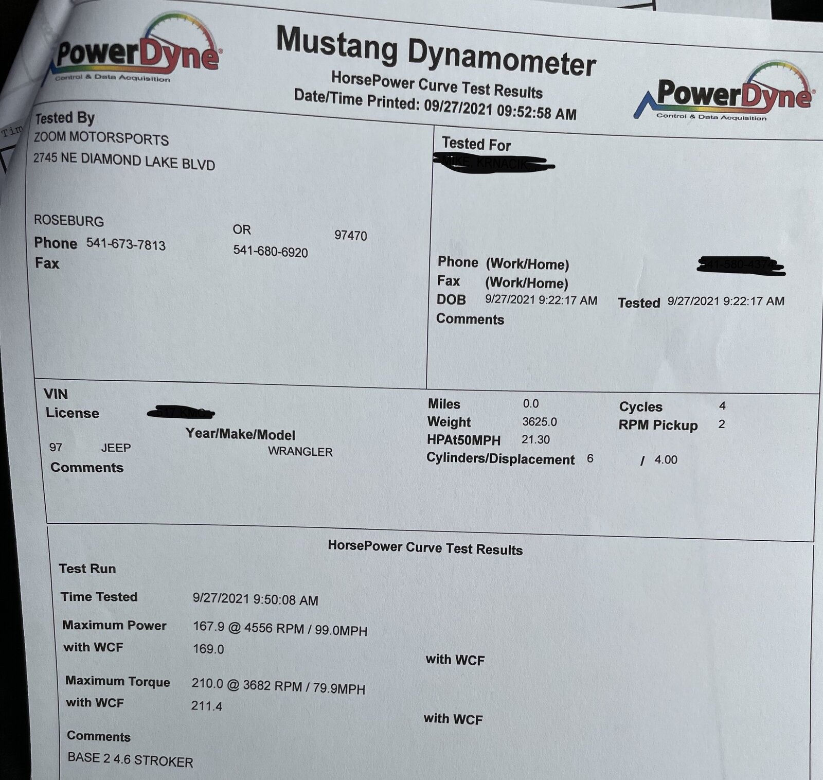

How much do you want to spend? Places like newcomer are making more power than a tj chassis can handle.
A mild stroker is going to make around 25% more power through the entire rpm range. And if you keep a stock top end,they aren't going to cost much more than rebuilding a 4.0l.
@Woodrow did a pretty good job of documenting before and after with his golen. They have a bigger cam and stock head if I'm not mistaken
