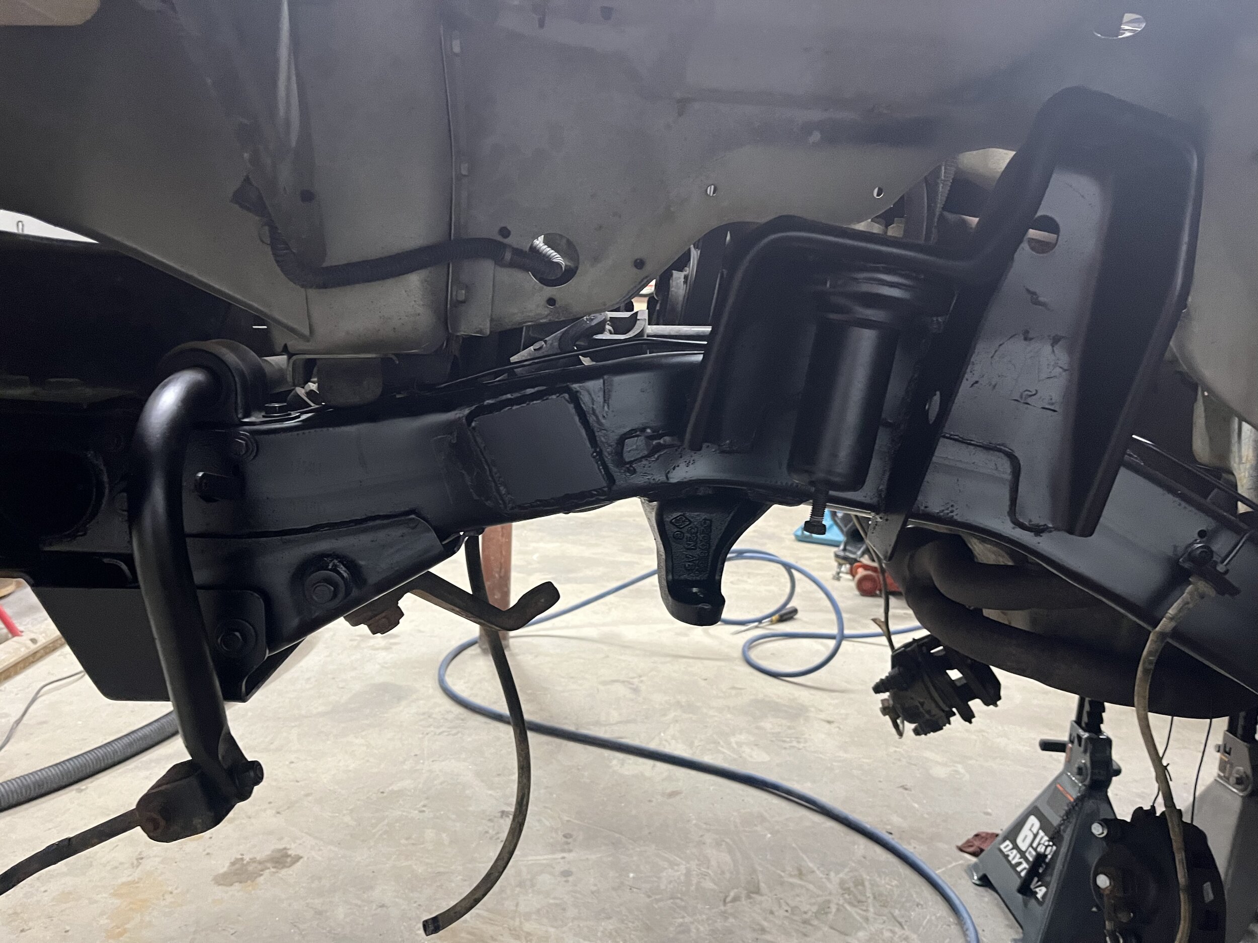

I was just giving a warning as I ended up with more work than anticipated when I pulled the old RC Mount off the frame.
I ended up playing both sides of the frame like this as the holes were fubared, was not happy as my frame was very clean til that point.

I ended up using going the Savvy/Rockjock route and it is very nice.
I also spy a dropped pitman arm...that frame sure looks nice though!!

Thanks, the drop pitman arm is gone now. The thing handled terribly. I lucked out with no rust or rot.
