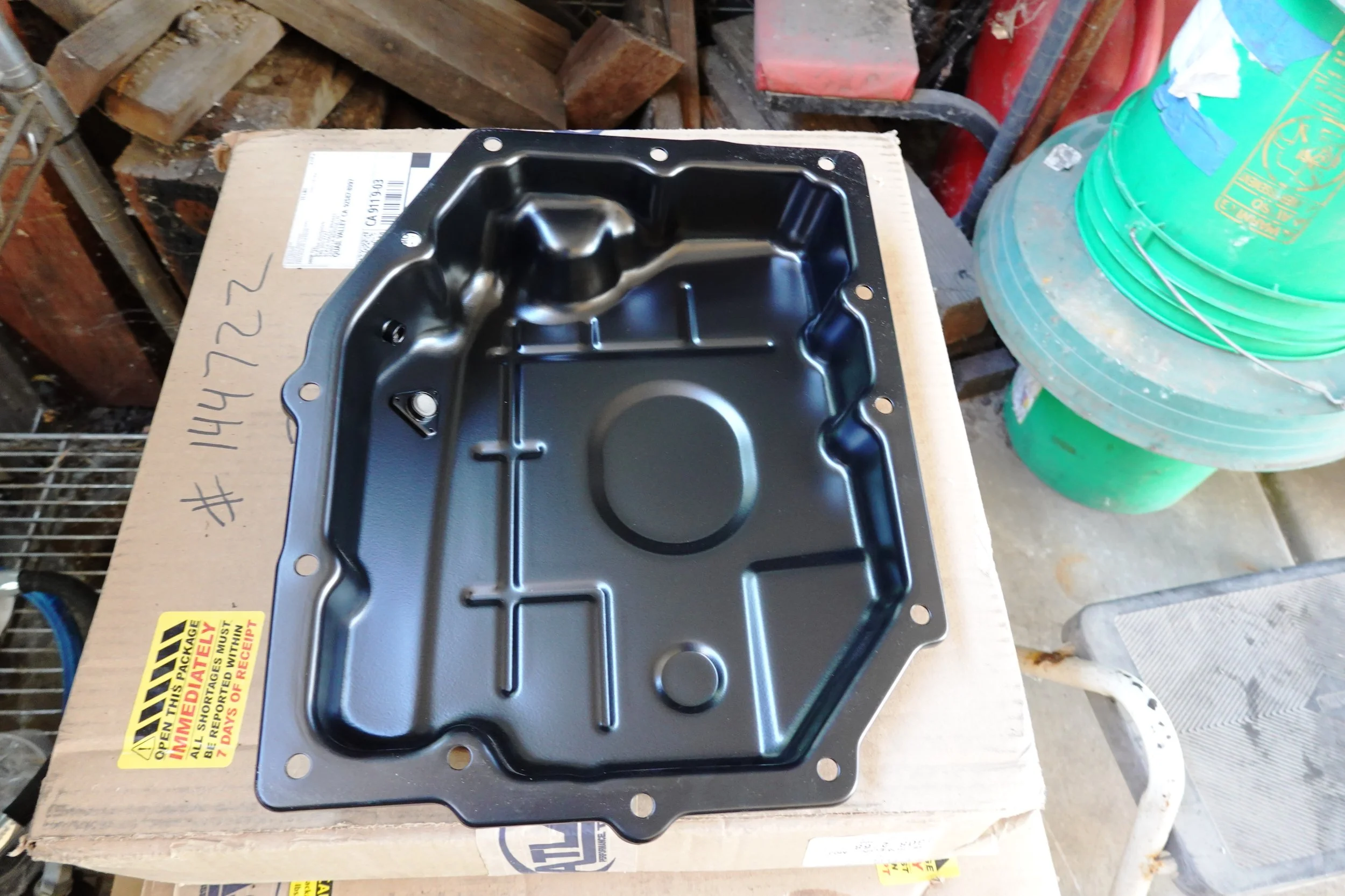

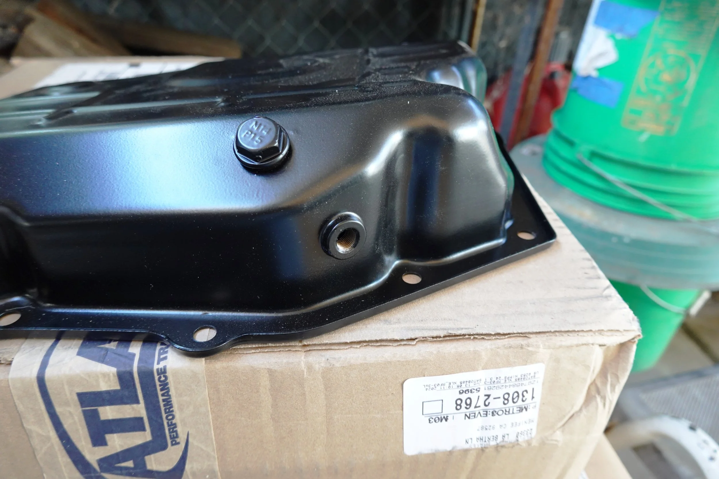

He fixed me up with a pan and bung- not installed yet
Had you opted for the deluxe version, it would have looked like this.

I'll do the brazed in sender bung for most anyone. Works out to about 50 bucks. 30 for the work, average 20 for shipping back to you. I don't acquire them, you send one to me. We don't paint, we just braze in the bung, chase the threads with a good tap, and put it back in the box it came in to ship back.

Sorta but not really in this case. It takes about 30 minutes start to finish. The SS weld in bungs are 5.20 each, silver solder and flux are about 2 bucks, plus packing and a shipping label. If we hurry, we make 40 bucks an hour which is barely wages. I do it mainly because very few that silver braze as well as I do are available to do it.
Also why I don't have them as a product. Once I buy the pans and stock them, there is no way they are leaving without being stripped and powdercoated. That would put the pan around 150 bucks shipped and I might make 30% on it.
