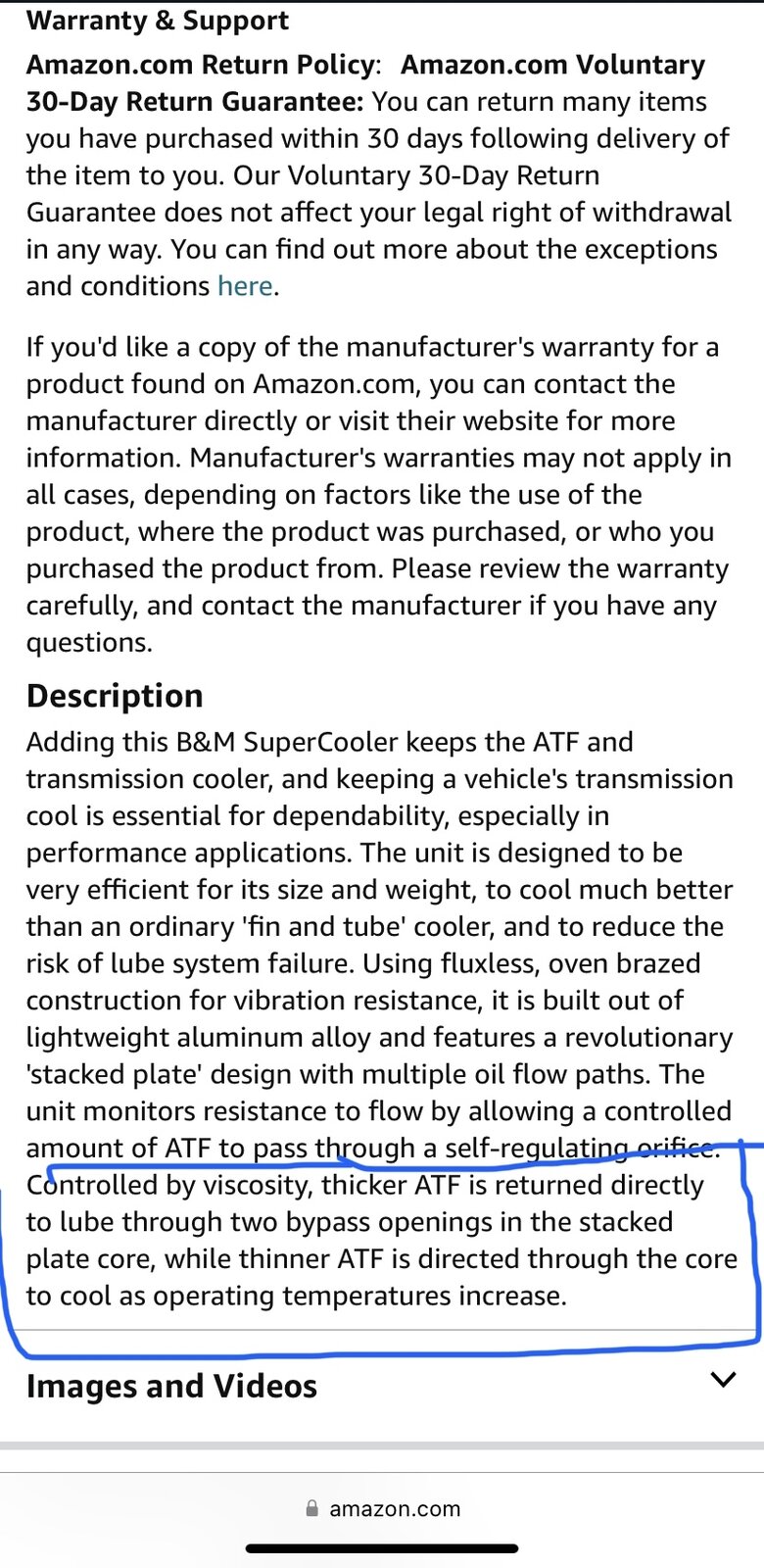

Reading the B&M section in blue, it seems they may have at least some what addressed that issue? What are your thoughts?
This was on Amazon for BM 70268
I was not aware of that feature that they have. Seems like a pretty cool thing.
I’ll probably give it a try!

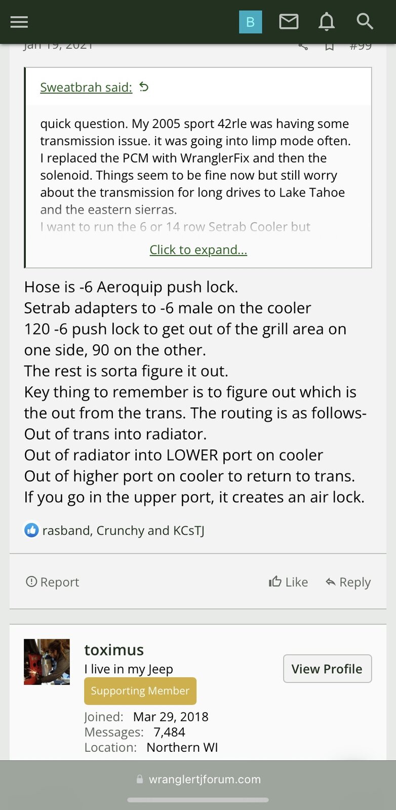

I have this screen shot from Blaine a while back describing how to not air lock when adding a transmission cooler.
Any idea if this applies to these type of coolers were inlet and outlet are both at the bottom?
