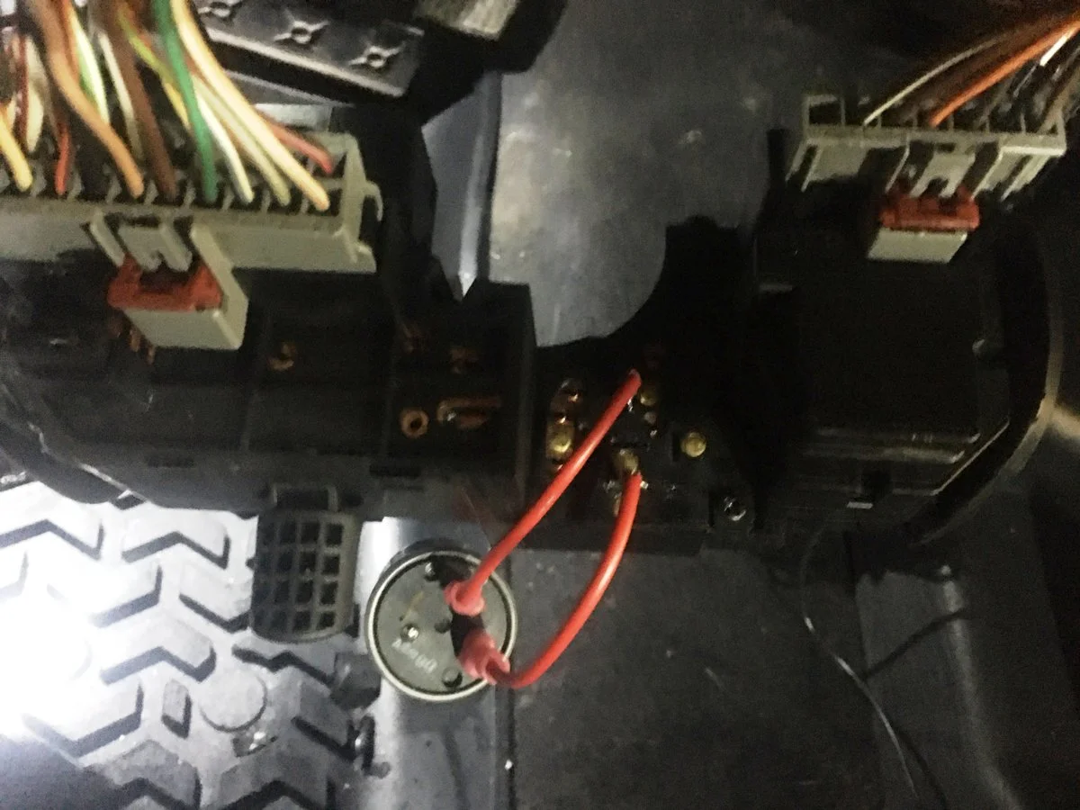

Thank you for the input but A buddy of mine came over with a Brilliant Idea! I still don't understand how or why it worked but it did. After trying 7 different OE Style Flasher Relay's, he plugged in an old school VW Bug Style flasher with a couple of jumpers and "Pow", they worked. I've re-done 50-60 TJ's and have never run into anything like this. Crazy.
