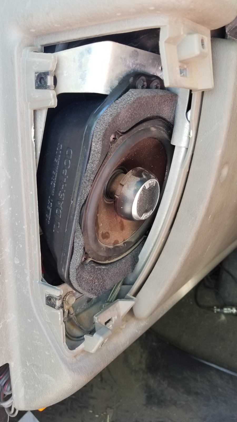

You may be able to fit them. The real problem is that half of your speaker is covered by the inside of the dash. FWIW, I have 5.25s in the dash, and part of them are covered by the dash as well.

FWiW, 5.25" Polks inside of Select Increments dash pods...

You can get a little bit more of the low end from a 6.5" and you'll easily get it out through the opening/grille, but the problem is that you're probably going to start fucking up your mids and highs. If you look at that previously-posted image, you can see that the outboard edge of that 5.25" is getting very close to the outside edge of the dash; this means that the only place for the speaker to expand is inboard. Thus, the central portion - and by default, the tweeter - is then pushed further and further toward/behind the inboard edge of the grille; depending on how the speaker is built, the grille can begin to occlude that area...and even if it doesn't, you still have the tweeter pointed at one of your knees. In other words, by stuffing the 6.5" you're making a bad location even worse.

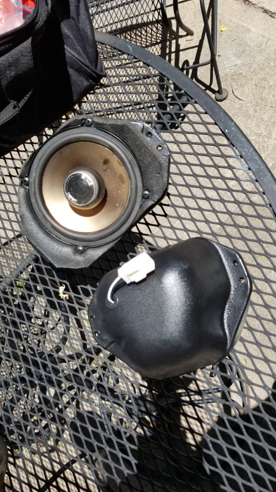

This is what I have but I made an adaptor I need these pods! I bet they help with sound quality.

I had the inexpensive foam baffles before (now the gasket material). They were a little better than nothing. However, the rigid pods added a noticable amount of volume and clarity that wasn't there before.

Search Amazon for Select Increments TJ dash pods. They are available for both the early and the late TJ. Adapter wiring is included.

Got them today and installed, love them! I can definitely tell the difference.
