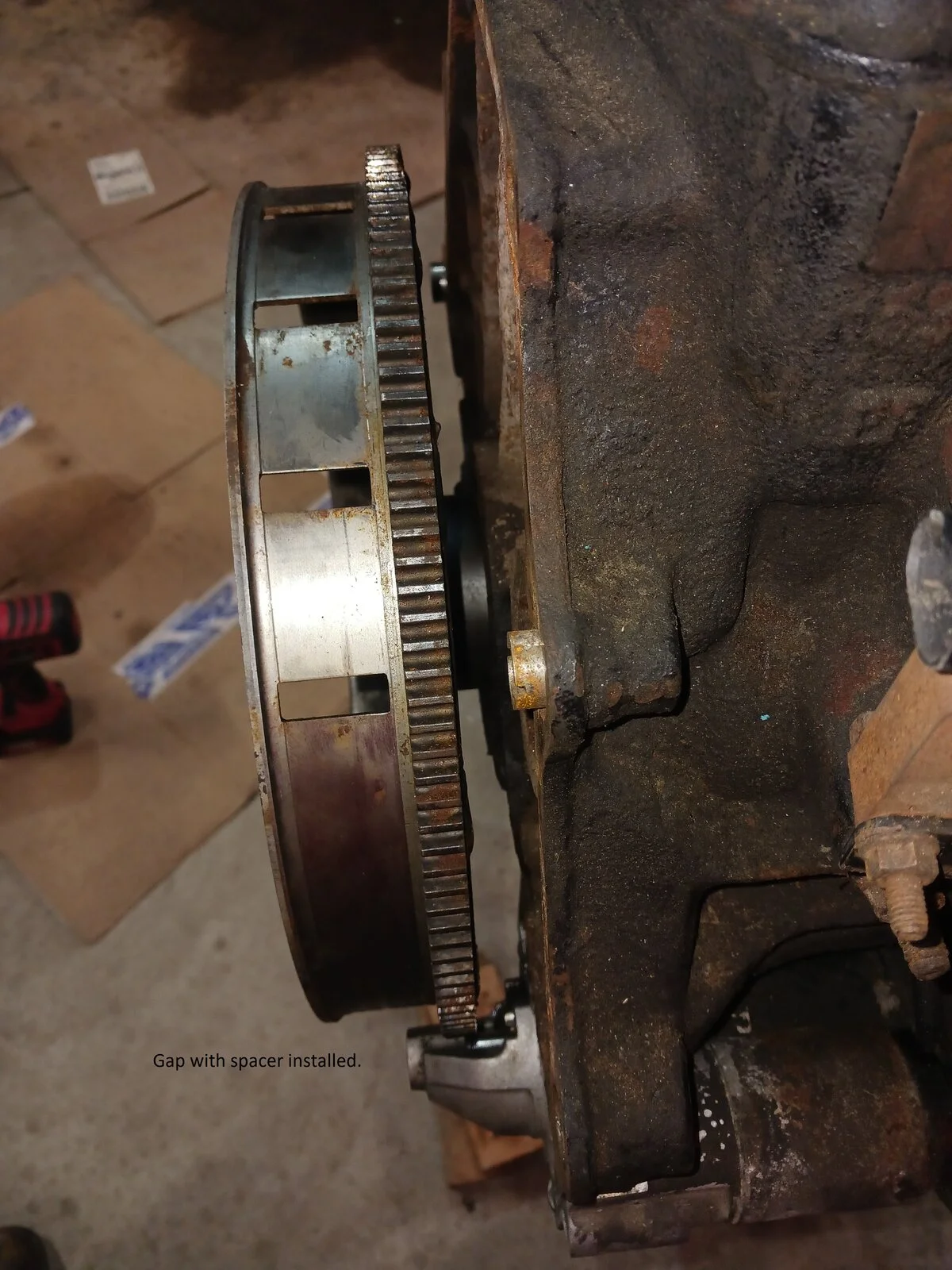

Engine had a busted piston skirt, so I'm attempting to install a different good engine that was mated to a manual transmission. Bare engines look identical. However, the engine will not mate to the transmission correctly. The torque convertor is all the way back aligned and mated to the pump flats. There is over 1/2 inch of spacing between the bolt flats on the torque convertor and the face of the bell housing when seated.
However, the torque convertor is pretty flush with the drive plate after mating the engine to the transmission. With all other engine swaps I've done, I've had to draw the torque convertor up to the drive plate with the bolts. Also, the engine binds up and won't turn by the crank bolt. Both engine to flywheel locating pins are present and are a very tight slip fit (<0.005).

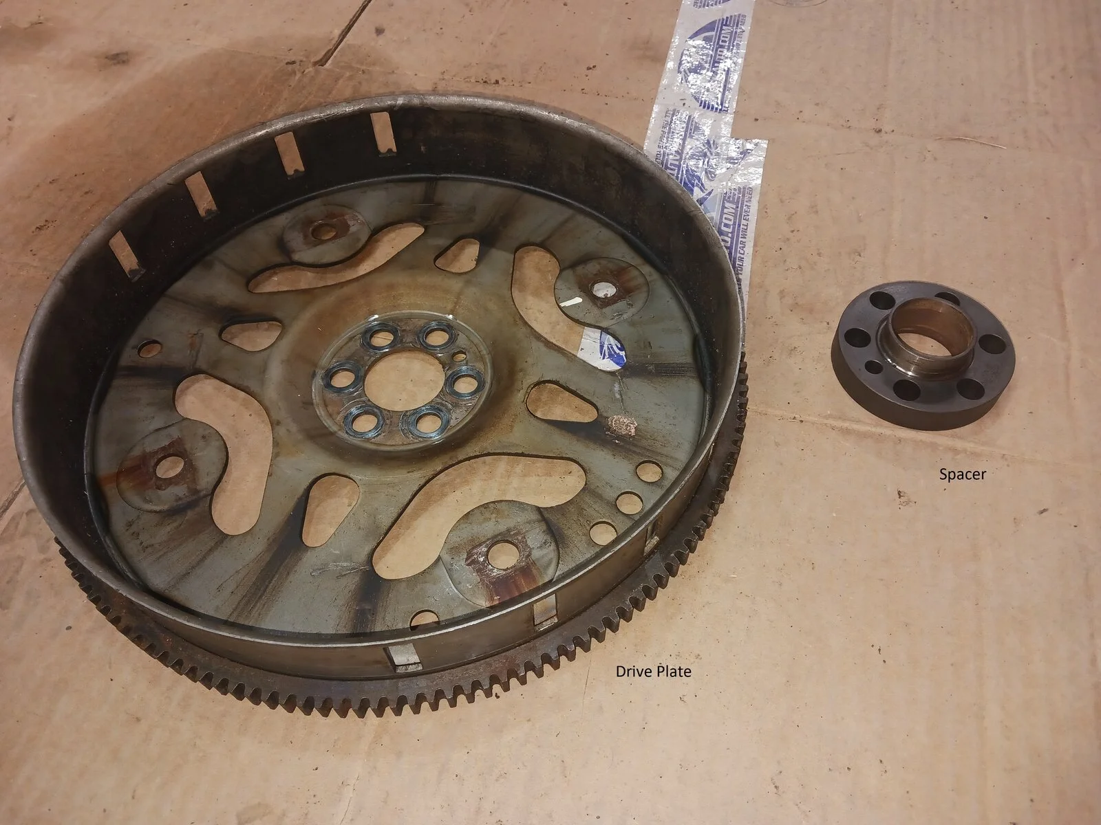

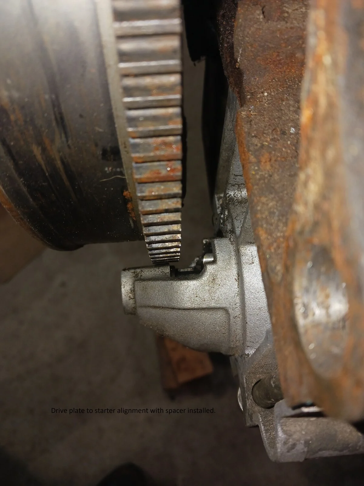

There is a 0.575" spacer (pictured) that goes in between the drive plate and the crank, and I believe this spacer to be too thick? The spacer cannot go between the drive plate and the torque convertor, as there would be space between the torque convertor bolt flats and the drive plate so that is ruled out. I cannot leave the spacer out, as the bolts bottom out, and the drive plate is awfully close to the engine block and might actually rub on the block and the starter. With the spacer installed, the starter only rides on the very edge of the drive plate teeth. It appears that a 0.375" spacer would solve all my problems.

The donor was also a 97 with a manual transmission. Same year, different transmission. The engines are exactly the same. I have measured all dimensions with a scale and calipers. The good engine was taken down to bare crank before adding the spacer.

Solved.
Spacer goes on the torque convertor side of the drive plate.
My drive plate was bent, causing nothing to fit together properly or make sense.
