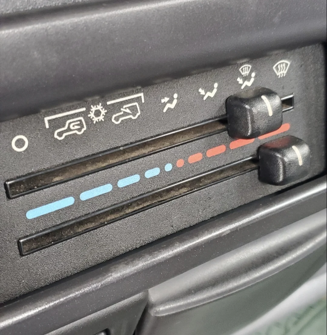

Hey, guys. I have a '97 TJ with the slider climate controls. The top slider is hard to move and the bottom slider is hard to move and doesn't move into the blue all the way. I just want to change the zone or temperature without worrying about snapping the slider off.
I have taken the dash apart and fixed the cable behind it but it is still not working the best.
Any tips on how to fix this?
