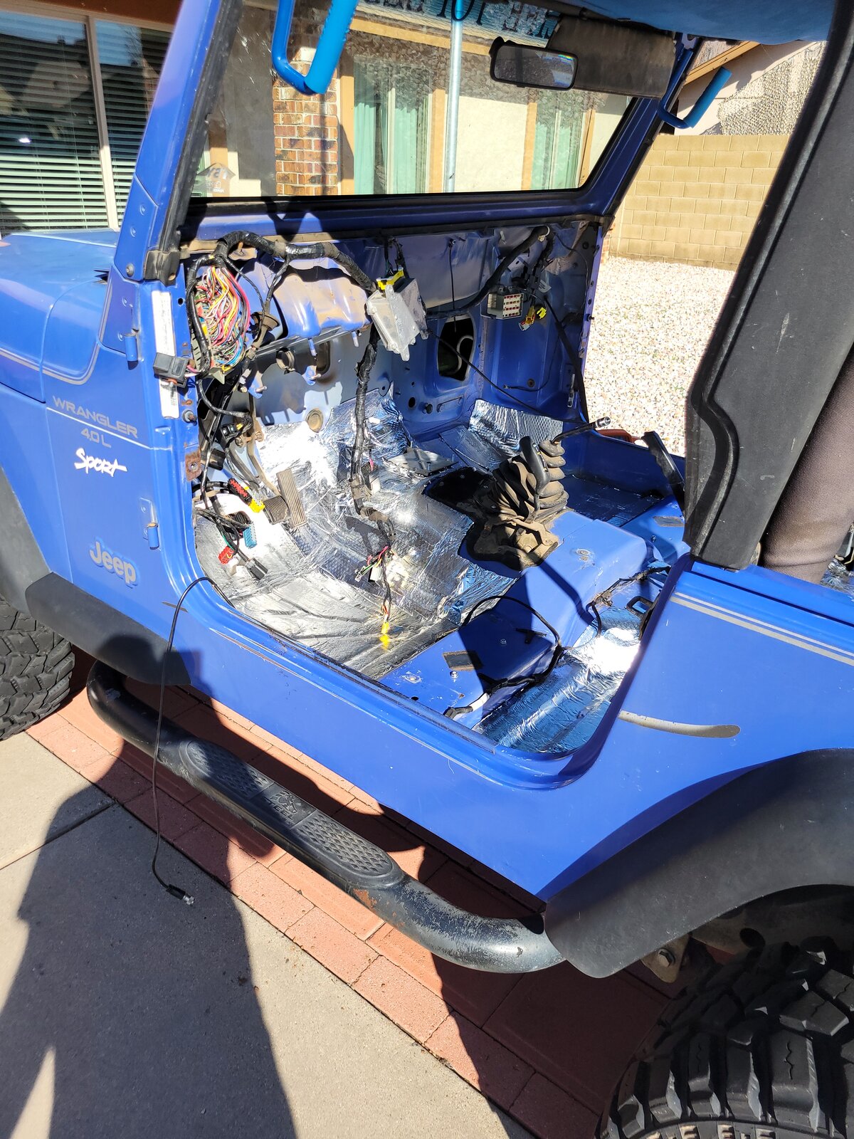

Day 2 part 1 ..... (of working on it)
I fell down the rabbit hole. I figured it was just as easy to do a few more things while I had it apart.
Early this week I went on a shopping spree. New carpets from stock interiors (hated the bedtred). 80mil Sound proofing from nocio. Now in the back of my head I'm thinking about sending the seats out for a refresh.
Still waiting for the replacement airbox. But I did do some research and the 97-98 air box /w AC sells for more than the 99-00. After completing the project I will post them if anyone is interested.
After a rainy Saturday I started the morning removing everything left from the inside. And gave it a pre clean before I started with final clean and sound proof installation currently on my union mandatory rest.
The green paint is self etching primer I did a couple years ago.

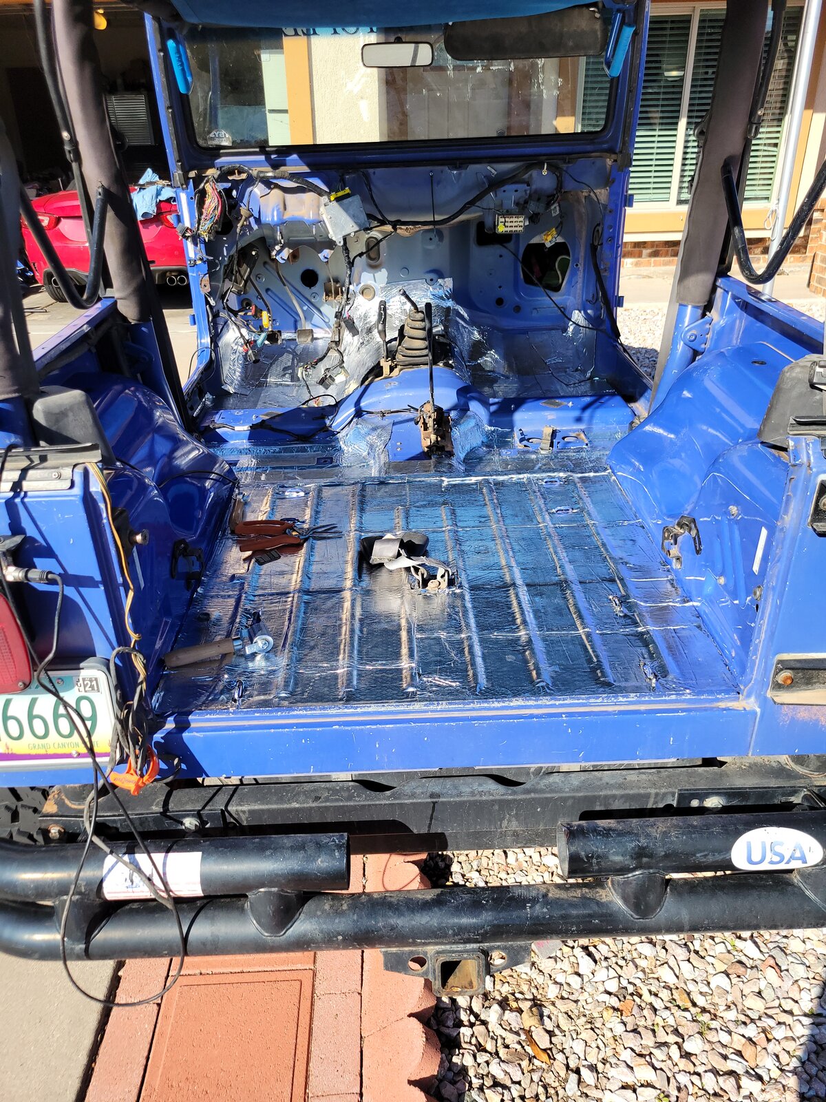

Day 2 part 2 ...... (end of shift)
Completely under estimated the amount of work required to install the sound board....... it sucks.... but I got a fair amount of it done.
Still have a lot of patches to do. I also want to reinstall the front seats to see how the rest will need to be cut.
Also have the wheel wells to complete

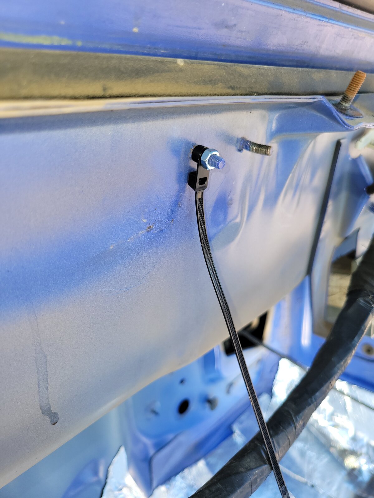

On a good note... I did come up with a solution to the wiring harness ties.
It's not how I would prefer to do it. But it works.
I just bought M5 nuts to screw on the studs and used nail on wire ties.
Hopefully tomorrow will be better for progress. I'm hopeful that I will get the carpet installed and the wiring secured. That way once the new airbox is here I can install it straight away.
Now to clean up and figure out what to do with the old bed tree flooring.

If it matters for future reference.
Home Depot has the double head zip ties like are used to hold the washer fluid line to the harness. Hellerman Tyton makes that stud mount zip ties but I can only find them for 1/4" studs for now on Amazon.
