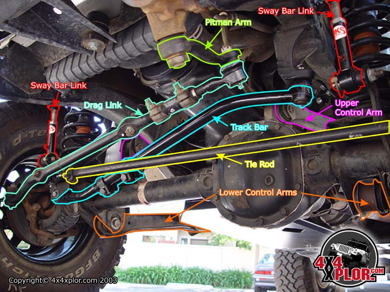

Then I saw the track bar and control arms and began pondering which end would be best to disconnect.
