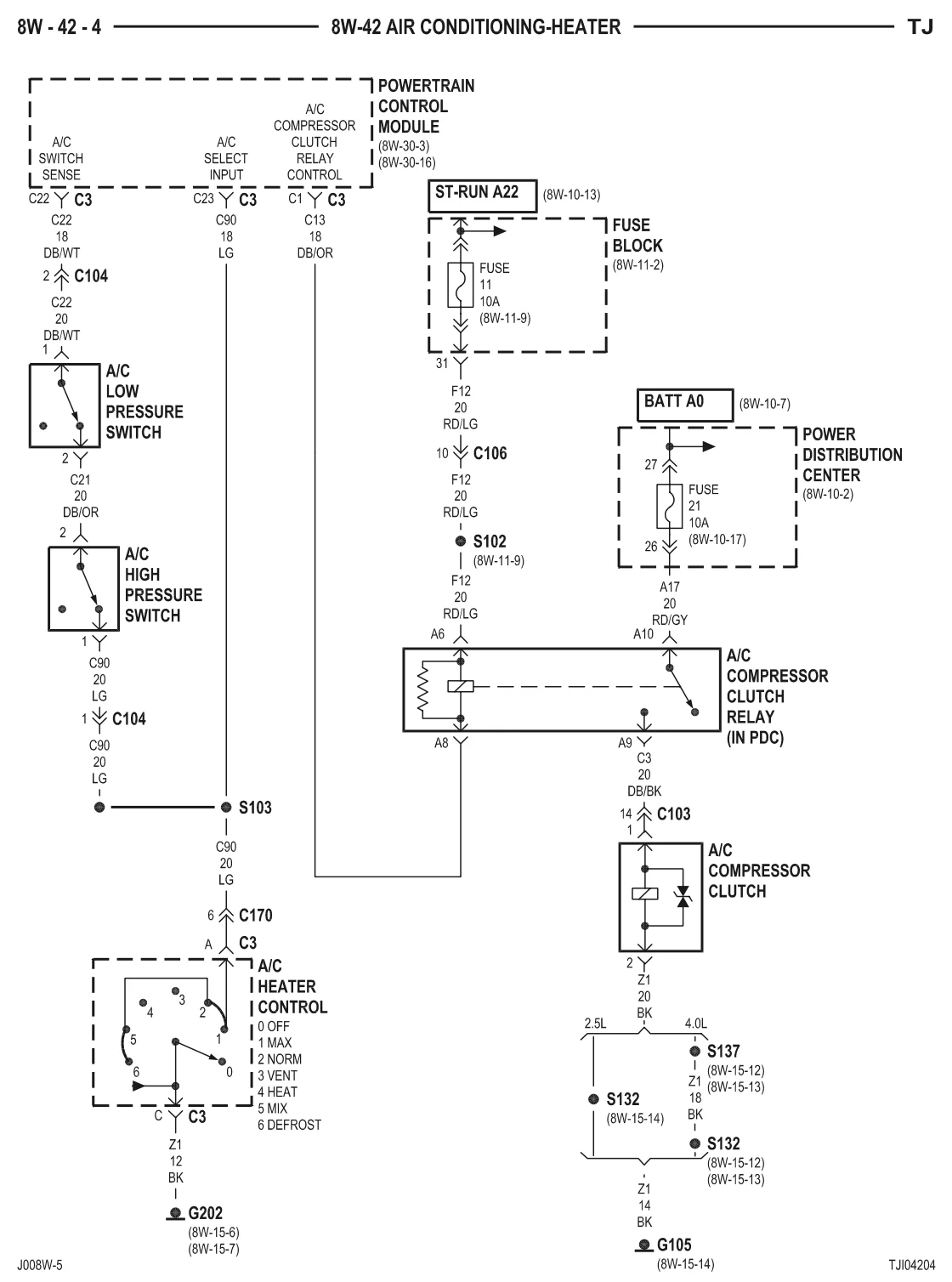

2000 TJ, we've done every diagnostic we can come up with, including following the troubleshooting guide in the FSM. Relay works, jumping the relay turns on the compressor, it blows cold so everything is good there. We've got continuity from the HVAC switch/computer/relay/hi&low pressure switches/etc. Finally stumbled into the fact that if we move the harness just the right way, we can make the compressor kick on. Specifically tugging on the low pressure switch pigtail where it joins into the main harness along the firewall makes it go on & off.

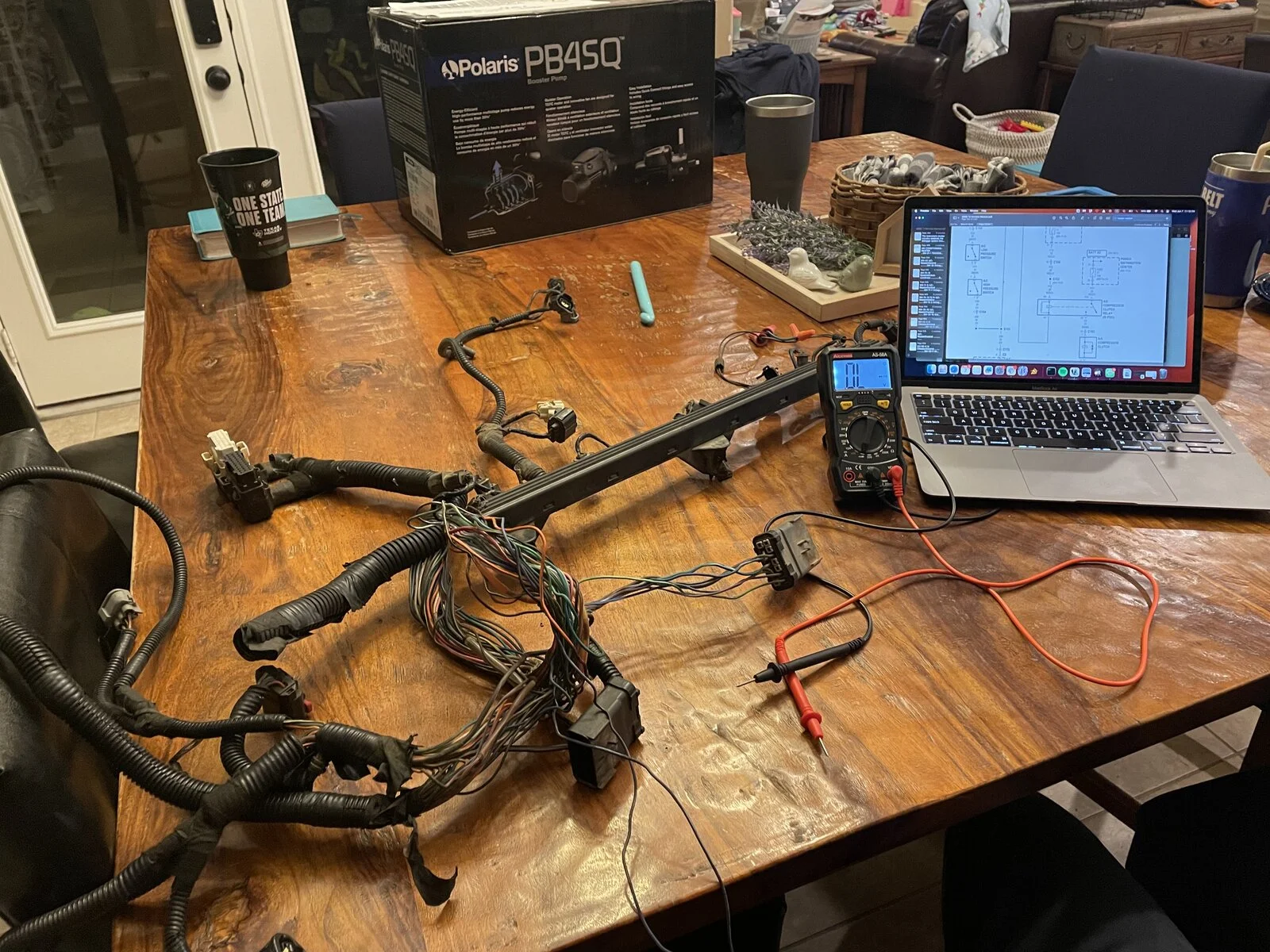

Now we've got the main part of the harness out of the jeep and torn apart, but I can't find any problematic wiring, at least on first pass visual inspection. I've had several harnesses out because of a suspected wiring problem and every time I've found multiple bare wires which were obviously the problem. I'm not intentionally neglecting anything but I've focused on the light green wire, which is the "a/c turn on wire" and the blue/white & blue/orange wires on the low pressure switch but haven't found anything yet.
I guess I'm looking for tips & tricks for finding a short...I'm normally really good at this but every challenge is unique.

so far haven't been able to find it, although it almost has to be isolated to about a 12" section of the harness. If I can't find it I may just replace the entire wire, although if that doesn't manage to fix it it's going to be extremely annoying to put the harness back in only to find it still not working.
Seems like a continuity test while tugging on that wire should reveal the issue but so far no luck.

there’s a short in there somewhere. I can’t find it. When it was in the jeep, pulling on the low pressure pigtail would cause the compressor to kick on. Low pressure switch consists of the blue/orange & blue/white wires. I can tug & push & twist the harness but I can’t make it break continuity on those wires.
The other wire that factors in is the light green wire which is essentially the “turn on” wire. I can’t make it break continuity either, from the big gray plug all the way to the high pressure switch.
There is a splice, but it’s not in the section of the harness I have here on the table. It’s in the section that runs along the top of the firewall and goes over to the gray PCM connector. That section of harness is factory zip tied and all out of harms way, I don’t know how it could’ve been degraded, but I can’t find it in this section.

I'm all about a more efficient approach. So take a probe and stick it in the cavity I think is the problem, and then ground it. Test light to battery, and the other side to Which pin on the relay are you thinking? Because the circuit I believe is the problem doesn't go through the relay. My (current & potentially flawed) understanding is that the A/C Select Input tells the PCM that you want the A/C on, and then the A/C Switch Sense tells the PCM if it's ok to turn on, and if both conditions are met it will fire the A/C Relay Control. The section of harness that I'm tugging on to get it to work is the Low Pressure switch, which isn't part of the relay circuit except through the PCM.

99.99% I was going to need to remove the harness to actually be able to repair whatever I find, and I've reached the point where I would rather disassemble stuff than fight with it and end up doing a lousy job.
Forget the relay then. Everything is unplugged, so pick one side of the leg to shoot power through and the other side to ground so all you’re doing is making a loop. You’re turning the unplugged wire into a ground so a test light will light.
For instance, put power to C104 and ground C170. Then get to wiggling, tapping, stretching, etc. When the light flickers or goes out, you’re onto something. If that doesn’t work, put power to C170 and ground C3/C23. Rinse and repeat.
Don’t use an LED test light. Use an incandescent bulb. Either a test light or rig up a headlight. You want to load the circuit. Multimeter continuity checks will get you into trouble, because a wire with all but one broken stand will pass a multimeter continuity check, but the light bulb won’t light because that one strand can’t carry enough current.
Also, don’t jam your test light into any female terminals. Based on your previous posts, I doubt you have any jumper wire sets. You’ll need to either backprobe or something. You’re going to need to rig this up. Don’t spread these terminals or you’ll hate your life.

Thanks, that technique makes sense I hadn’t considered putting power through the unplugged harness.
And I’m not sure what made you think I was a Neanderthal, but I do have the right sorts of test probes to not damage the connectors and back probe when necessary.
Update: since we already had the harness out, I went through it with a fine tooth comb but couldn't find anything wrong in the harness. In the interest of making progress we put the harness back in for more integration tests, and lo and behold, A/C worked 100%. I hate it when you don't really do anything to fix a problem, because deep down I know it's not fixed. But it's his wife's jeep so for the time being she's satisfied that she has A/C as it's starting to get balls hot here.
