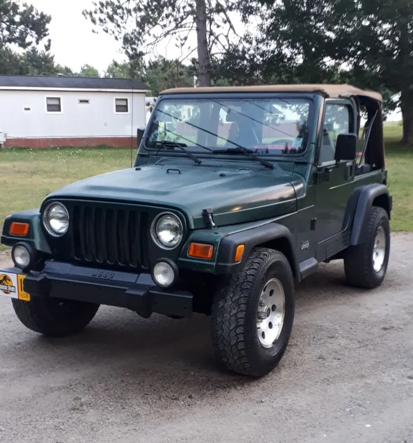

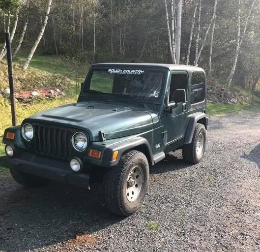

I bought my 2000 Jeep TJ in July, it's a 5-speed with the 4.0. It has a 2" lift (maybe?), it had a Rough Country sticker on the windshield and it has 31's with no rub so I'm guessing at 2". That's really the only mod done to the Jeep other than the Ford rims. It came with a hard top and a soft top that is worse for wear, but it worked fine enough for this summer.
So here's what I'm starting with the day I bought it.

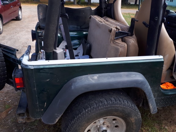

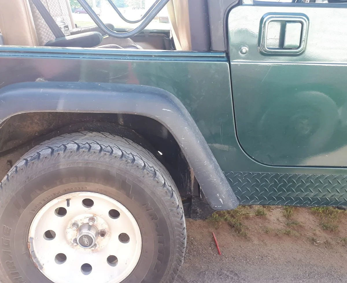

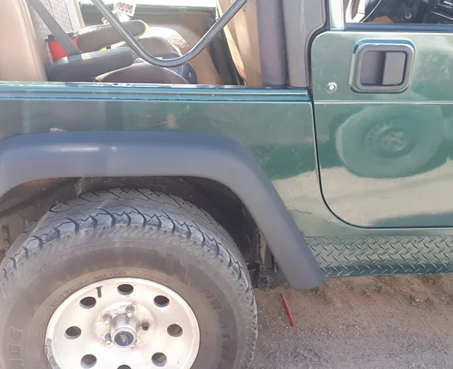

The fender flares were gross so they got redone. I used Matte Camo Black and it turned out pretty good IMO. I also bought a can of color match paint and sprayed the black diamond plating to match.

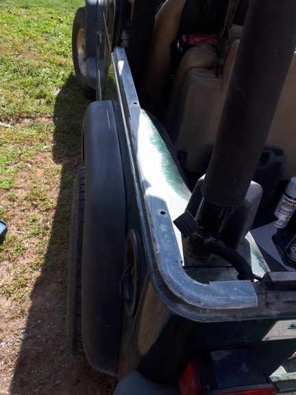

Before on the flares
After

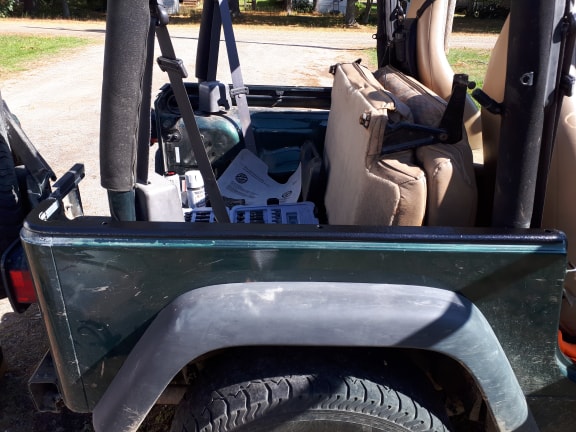

This was the last time it was cleaned up with the ragged soft top before putting the hard top on.
I also re-dyed the padding for my roll bar covers. My picture for this is absolutely terrible so I apologise. The padding is still dirty from the last trip out but it gives you a good idea of the contrast between old and re-dyed.

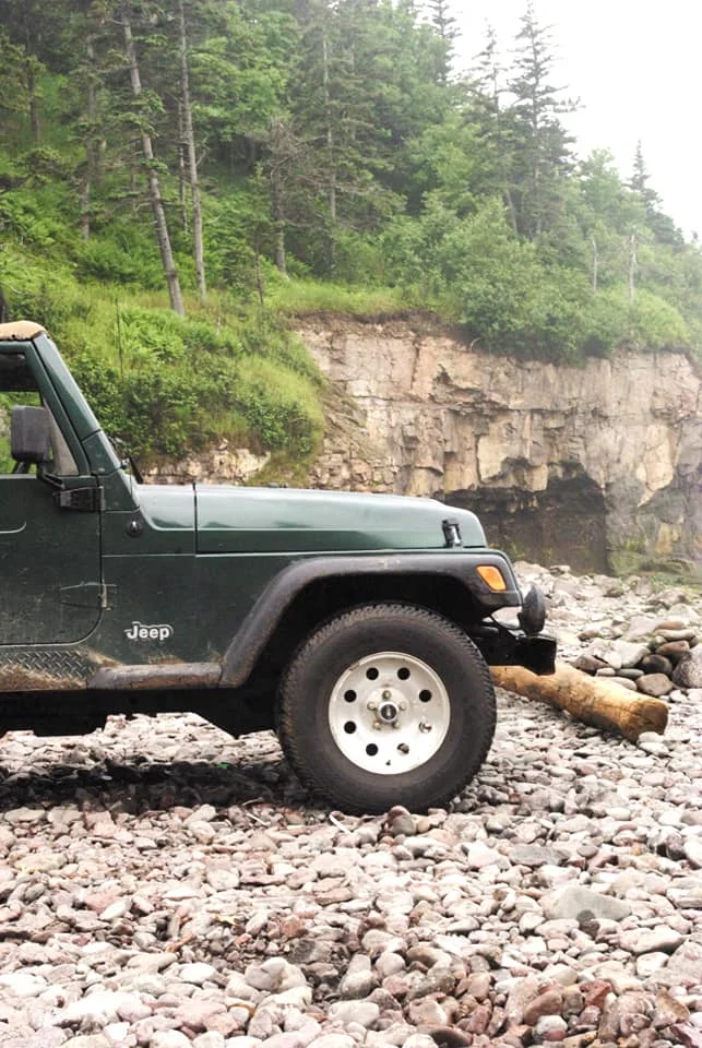

Here are just some random pictures of it taken over the summer
This was my first 2+hr drive in the Jeep and the first time using it for anything lol
View attachment 113768View attachment 113769

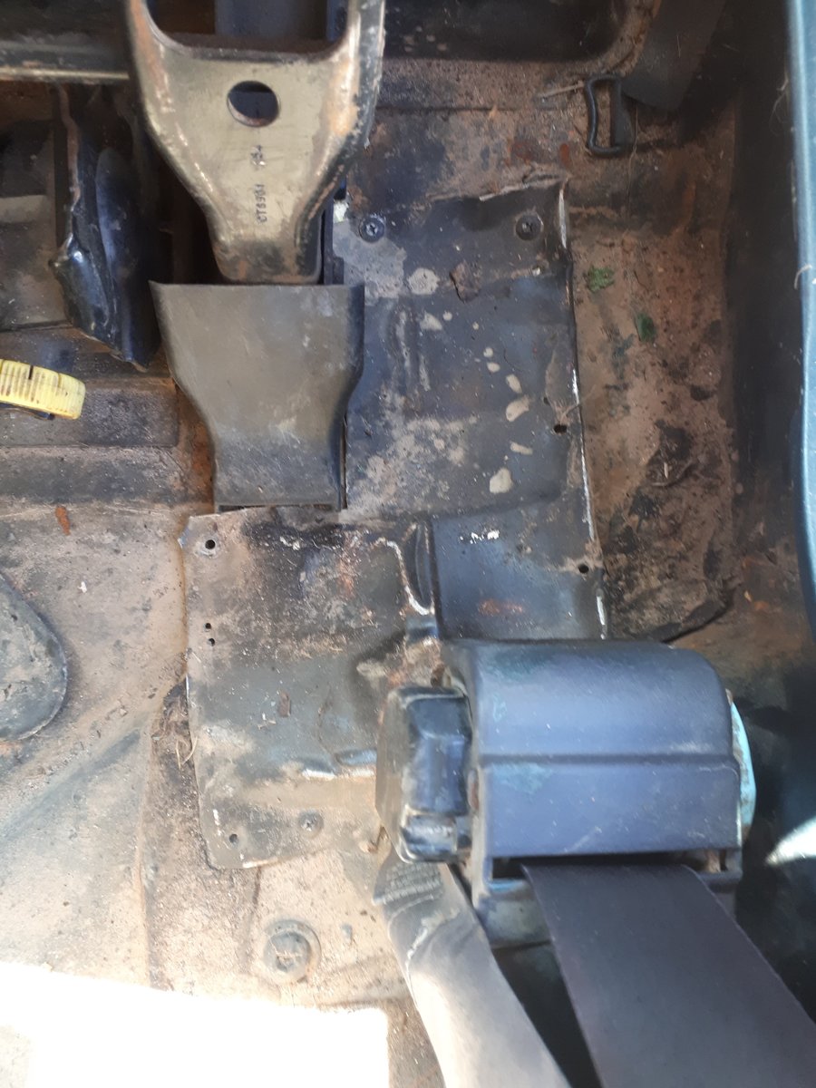

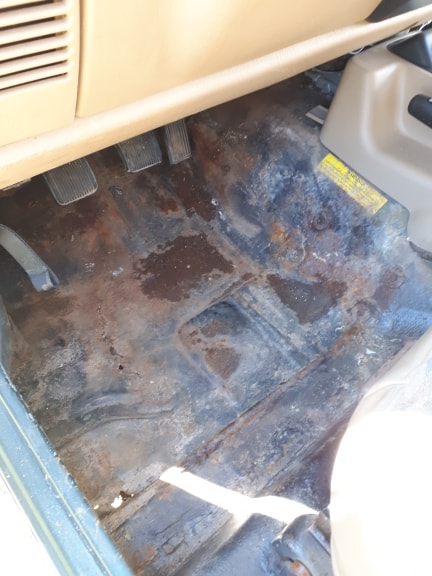

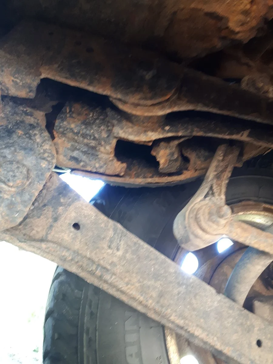

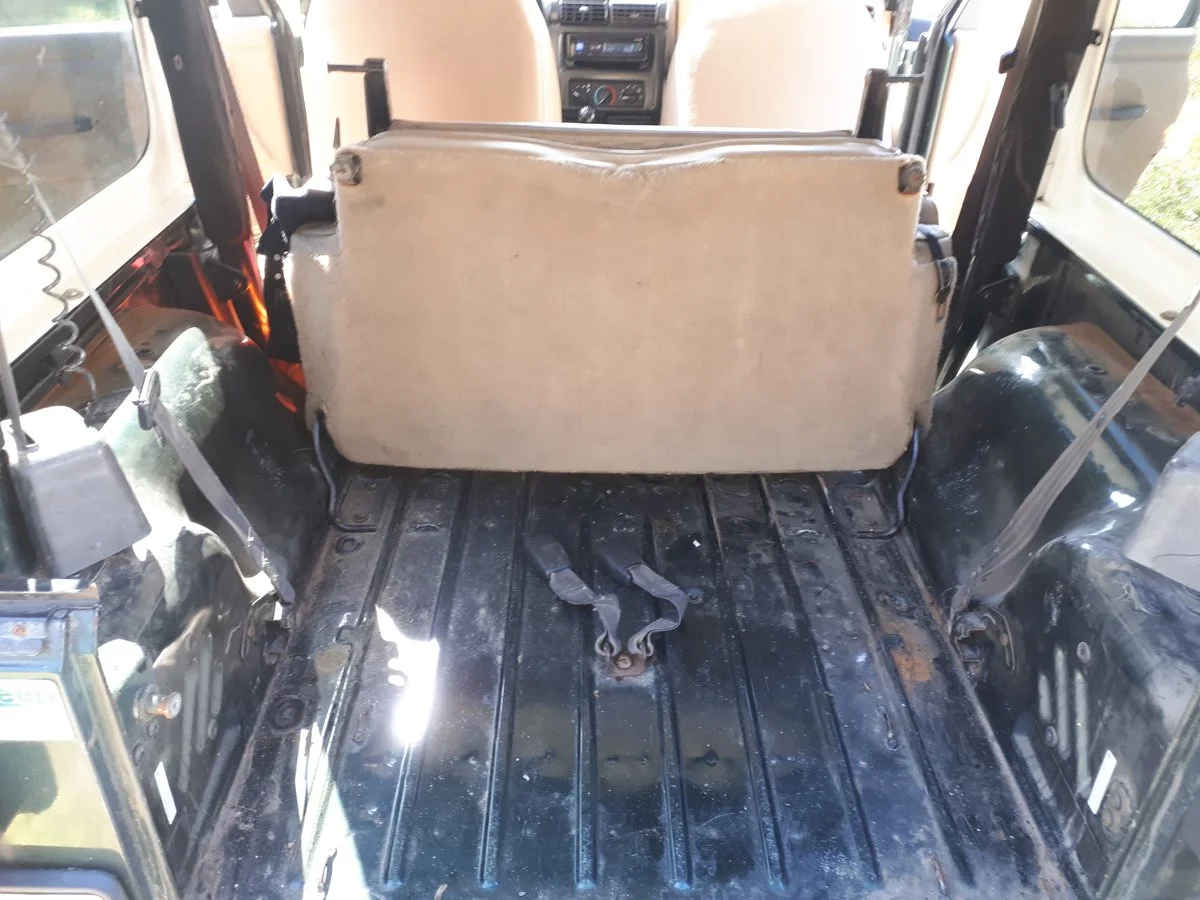

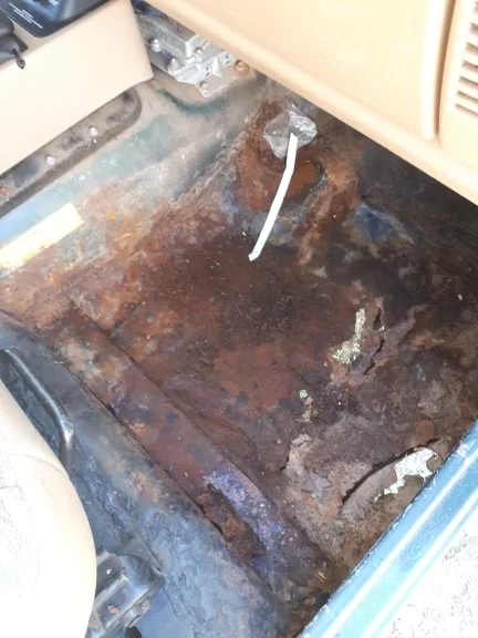

Got a start today on everyones favorite, rust repair!! I took the carpets out to get a good look at what I'm dealing with.
And oh my lanta is it worse than I thought. I knew of a couple holes on the passenger side, and a body mount. Well that would've been nice lol
This is the passenger side and it's about what I was expecting
Drivers side is about what I was expecting, still no worries
The first annoyance, a previous owners idea of patching a floor :rolleyes: Ive got nothing against using rivets to put in a patch, but this is not how it's done.

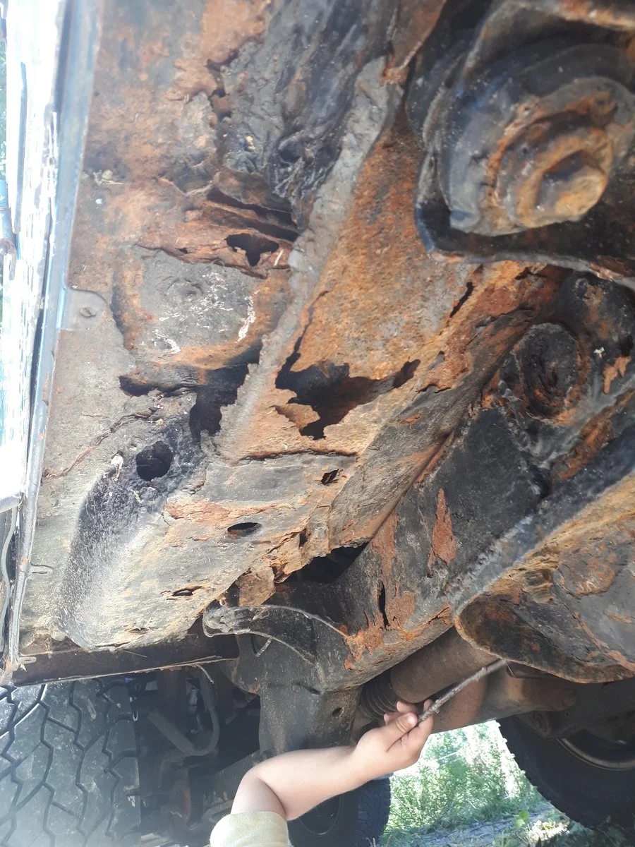

And this is where I started wanting to cry a lil bit lol Turns out the drivers side underneath is by far the nastiest spot. Also a shout out to my 5yr old helper today. He tells me sticks work great to see if stuff is broken lol
And of course one final blow just to really send it all home lol
But hey the rear is pretty solid other than some surface rust I can hit with some sandpaper and primer. So that's a silver lining, I guess? lol
But I guess that's what happens when I vehicle lives it's life next to the ocean and spends every winter driving on roads covered in salt.

I'm doing chemo treatments rn and still off work so full floor pans are not in the budget, Right now the plan is to seperate the tub from the frame and cut out and replace the rust on the floor, the frame will go off to a guy in town who does amazing framework, then we'll put them back together.
Then I want to spray the entire tub with a bedliner or something similar, then some sound deadending, and while the carpets are out I'll steam clean them and re-dye them with the same stuff I used for my roll bar covers

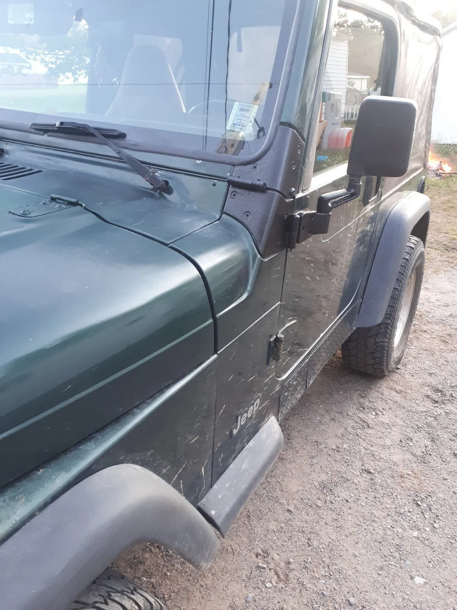

Tomorrow she's getting put up for the week and the floor and frame tackled, so today I'm doing some of the small annoying stuff I've wanted to take care of for a while.
Mainly all the chipped paint and annoying surface rust.

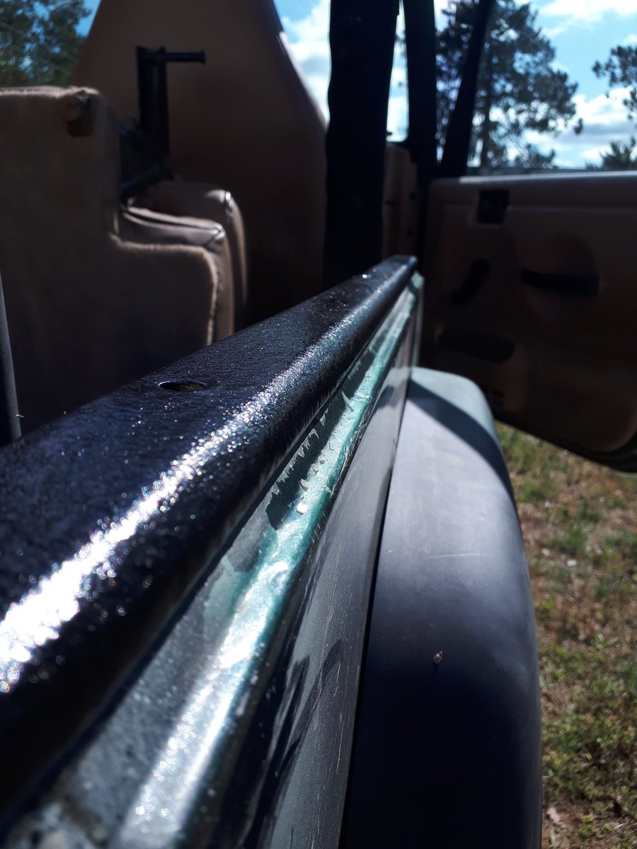

First was the lip around the tub where the hard top sits. I didn't want to just use paint that will chip and scrape off again so I decided to grind it down and then cover it with rocker guard so it would have something a little more durable. And I can always color match over top of it if I choose to.
After the grinding and hand sanding I added 2 coats of Rustoleum primer.
And you really only need 1 coat of rocker guard cause this stuff is so thick and messy. But if you wanted that extra protection or for it to have a more textured look you could add a second.
**I will add!!!* If you're crazy like me and decide to use this stuff be careful because when it's wet it will run really easy and can drip down onto the body!**
It was a toss up between spray on bed liner or rocker guard and I picked the rocker guard just because I've used it before, and I know it works well with color matched paint, whereas I wasn't sure how the paint would stick to something more like a bedliner.
I still have the mirrors and a few hinges to do, and I'll do pretty much the same process with them. They seem to be extra prone to paint flaking. Mind you my clear coat is wrecked so that probably plays a part in it.

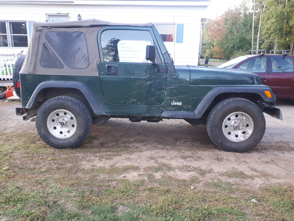

I also traded my hard top for a soft top in really good shape! My hard top had a crack in the plastic at the front on the corner, and the back window was replaced with black pexiglass and was also cracked and held together with black tape. And my personal preference is always a soft top so it was a win in my books! It's not the same spice color as my last one, it's more of a light brown.
Everything is reassembled and good to go. I'm curious to see how the rocker guard holds up.
I left the windshield brackets black for now but color matched the hood hinges.
And the new soft top installed
