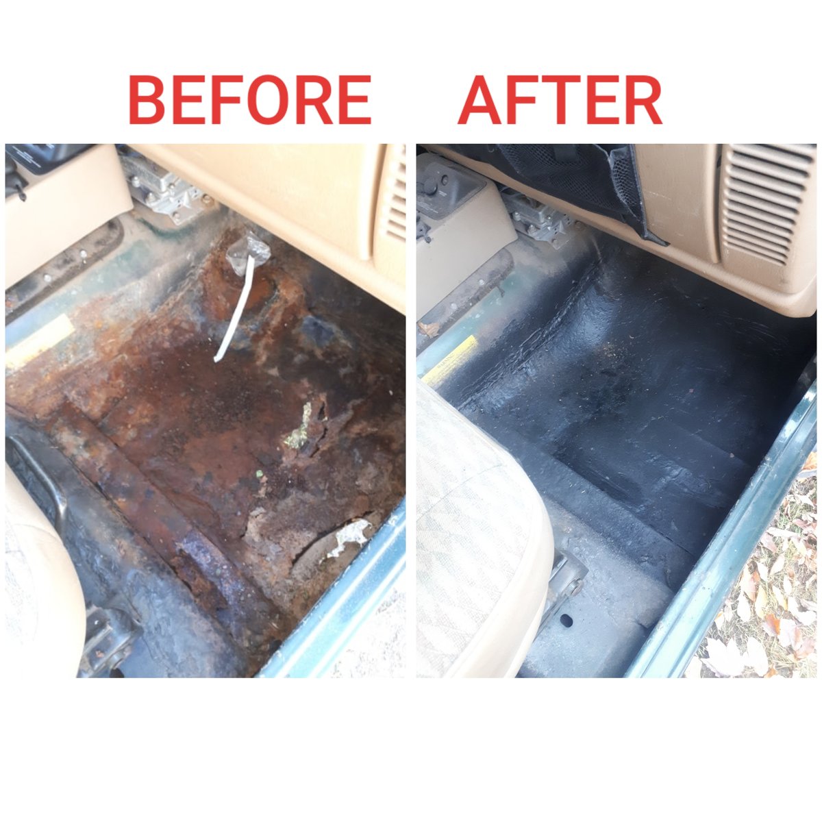

Everyones favorite kind of update, a no picture update!!
The Jeep is still in the garage, the frame and body mounts are done and the passenger side floor is finished. I had a couple days in the hospital this week so a huge shout out to my buddy who tackled the floor for me this week.
No surprise but once he started cutting, as you can imagine there wasn't much left to weld to and in the end he basically rebuilt the entire passenger side floor from scratch and he did an amazing job!
I'll get some pictures in a day or two once we bring it home, but I'm just excited to see a light at the end of the tunnel and I can start working on some more of the fun aspects of the Jeep.
Plus ya know being water tight and not having to worry about my Jeep disintegrating beneath my feet is a HUGE weight off my shoulders lol
