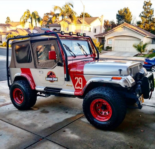

Like the title says, I want to build a Jurassic Park inspired overland/adventure rig out of my Jeep.
These are my inspirations for the kind of look I'm going for in the end.
It might not be everyones taste, but seeing Jurassic Park as a kid is what made me fall in love with Jeeps so, here I am lol

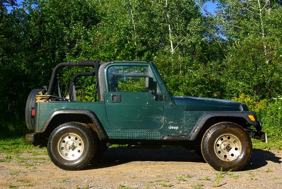

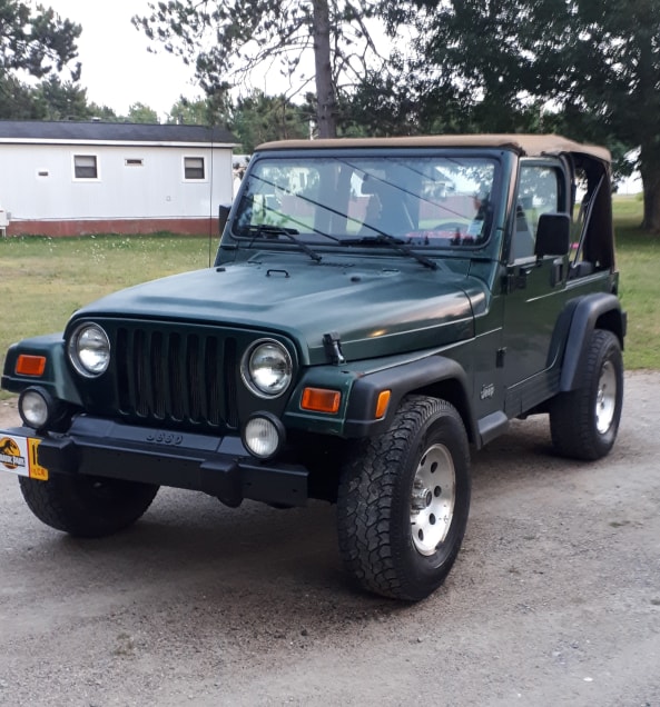

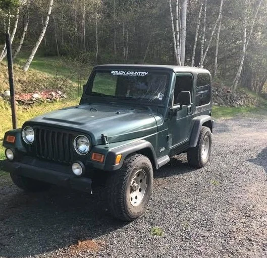

I bought my 2000 Jeep TJ in July, it's a 5-speed with the 4.0. It has a 2" lift (maybe?), it had a Rough Country sticker on the windshield and it has 31's with no rub so I'm guessing at 2". That's really the only mod done to the Jeep other than the Ford rims. It came with a hard top and a soft top that is worse for wear, but it worked fine enough for this summer.
So here's what I'm starting with the day I bought it.
I really haven't done a whole lot with it since I bought it. I've been off work for medical reasons so I took the summer to just enjoy the Jeep as it was while doing a couple minor things just to keep the itch scratched a little lol

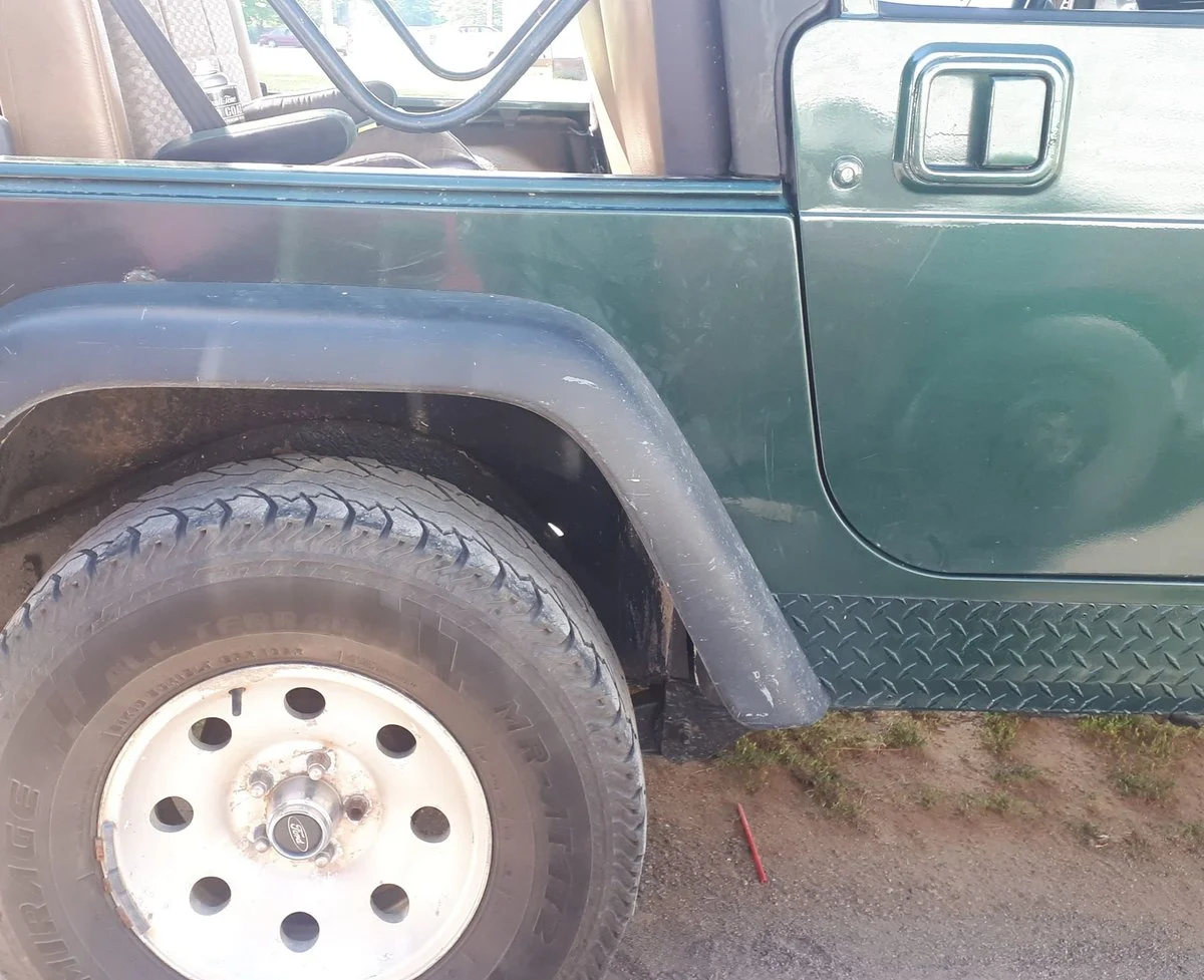

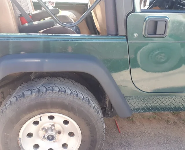

The fender flares were gross so they got redone. I used Matte Camo Black and it turned out pretty good IMO. I also bought a can of color match paint and sprayed the black diamond plating to match.
Before on the flares
After

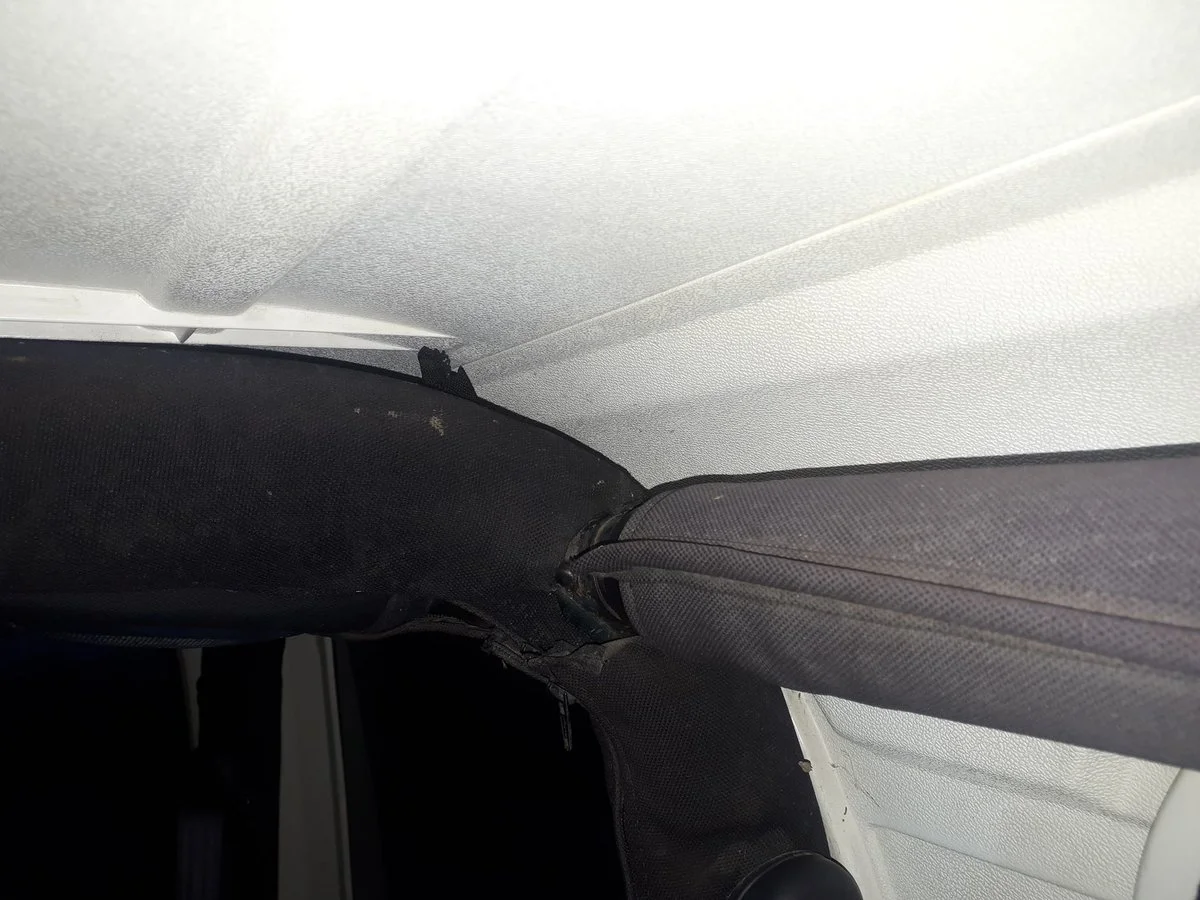

This was the last time it was cleaned up with the ragged soft top before putting the hard top on.

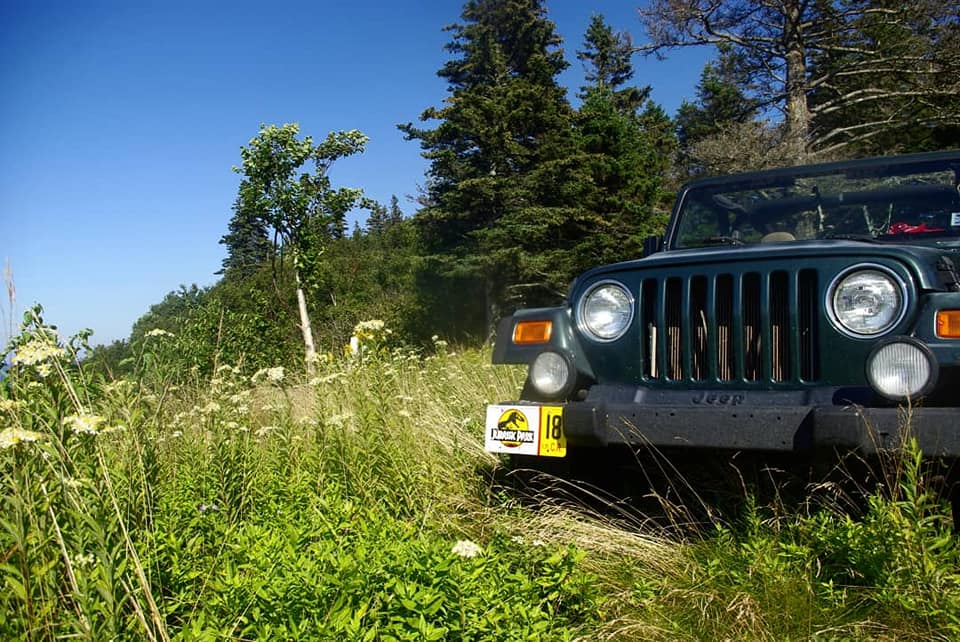

Here are just some random pictures of it taken over the summer
This was my first 2+hr drive in the Jeep and the first time using it for anything lol

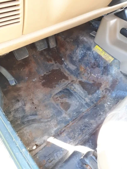

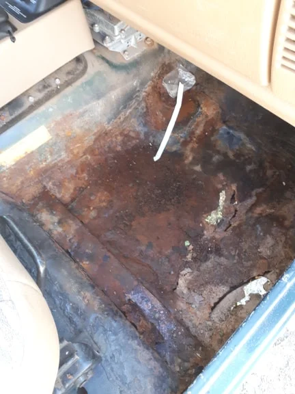

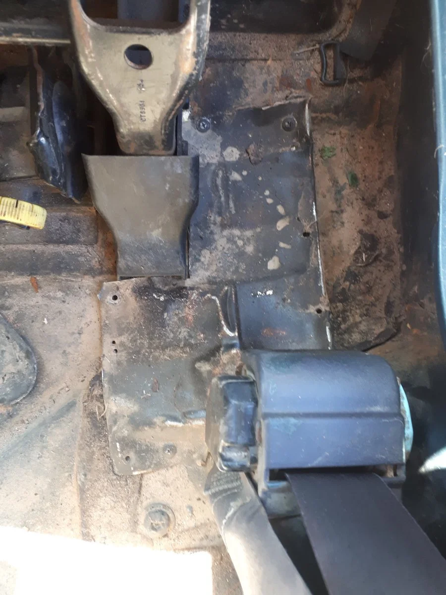

Got a start today on everyones favorite, rust repair!! I took the carpets out to get a good look at what I'm dealing with.

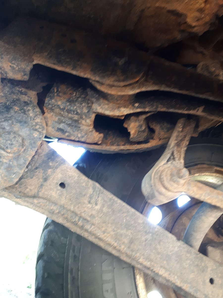

And oh my lanta is it worse than I thought. I knew of a couple holes on the passenger side, and a body mount. Well that would've been nice lol
This is the passenger side and it's about what I was expecting
Drivers side is about what I was expecting, still no worries
The first annoyance, a previous owners idea of patching a floor :rolleyes: Ive got nothing against using rivets to put in a patch, but this is not how it's done.

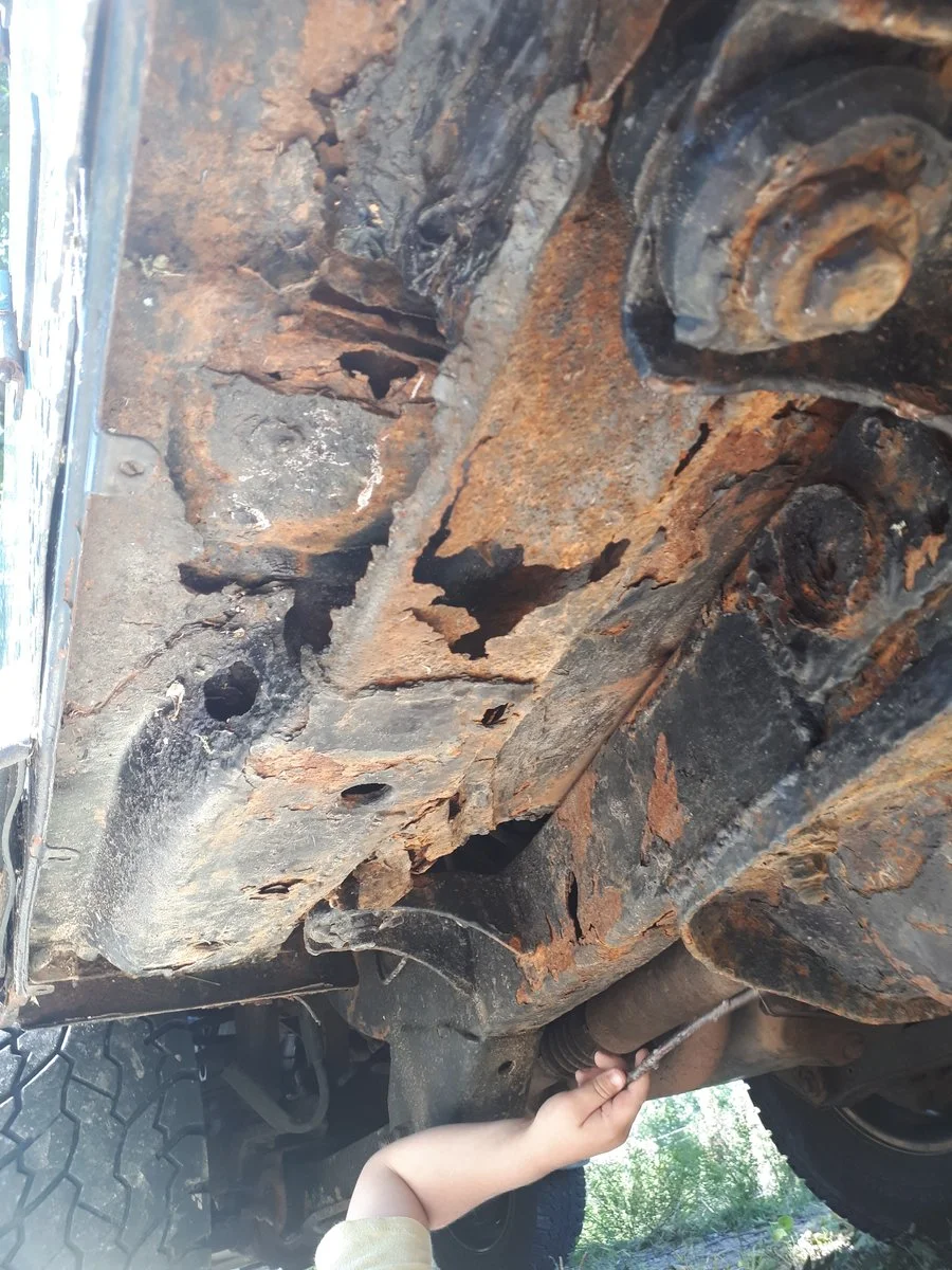

And this is where I started wanting to cry a lil bit lol Turns out the drivers side underneath is by far the nastiest spot. Also a shout out to my 5yr old helper today. He tells me sticks work great to see if stuff is broken lol
And of course one final blow just to really send it all home lol

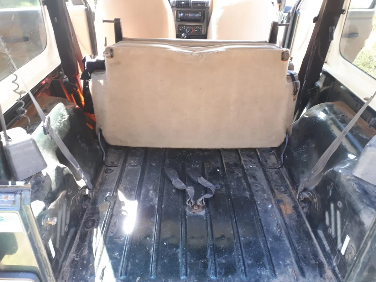

But hey the rear is pretty solid other than some surface rust I can hit with some sandpaper and primer. So that's a silver lining, I guess? lol
But I guess that's what happens when I vehicle lives it's life next to the ocean and spends every winter driving on roads covered in salt.
I know for a lot of people this would be enough to cut their losses and toss it all. Buuuut that's not really an option for me, I've brought worse back from the dead and I'm not looking to put this baby in Sema, solid, water tight, and rust free is all I need.
So the game plan:
I'm doing chemo treatments rn and still off work so full floor pans are not in the budget, Right now the plan is to seperate the tub from the frame and cut out and replace the rust on the floor, the frame will go off to a guy in town who does amazing framework, then we'll put them back together.
Then I want to spray the entire tub with a bedliner or something similar, then some sound deadending, and while the carpets are out I'll steam clean them and re-dye them with the same stuff I used for my roll bar covers
It worked great on the roll bar covers so hopefully I'll have good results with the carpet as well.
Wish me luck!! lol

I’m right there with you on Jurassic Park. I absolutely love those YJs. I was so stoked when I saw it in Jurassic Wold too.
Hi, neighbour!
haha Howdy fellow maritimer!!
I’m excited to see yours, I ran across this one last year when registering my car. More inspiration :)
I love seeing a TJ with this scheme more than I do the YJ's. Blasphemy to the JP die hards but still lol
What flares are those? They're huge! I thought about going to the deep rivet style flares but not sure how it would look with the JP look.

It's gonna be a huge job for sure but I dunno, maybe its the way I was raised or the area but the floor doesn't worry me one bit. That's an easy fix, stressful, annoying, and still a lot of work, but pretty straight forward as far I'm concerned. Make it solid and water tight for the winter, and then budget permitting replaced with new floor pans next summer. But we all grew up fixing our own gear and doing our own work after destroying our off road rigs. Motor and transmission swaps were just considered getting ready for the weekend haha
The frame damage is the only part that really worries me, my line of thinking right now for the arches is to cut out that entire section and weld new in. But my knowledge when it comes to frame work and structure is diddly so that might not even be a viable option. There's 1 gfuy here in town that everyone goes to for framework, he's specializes in frame work and metal fabrication and his shop has been opened for longer than most people can remember so hopefully he'll be able to sort me out.

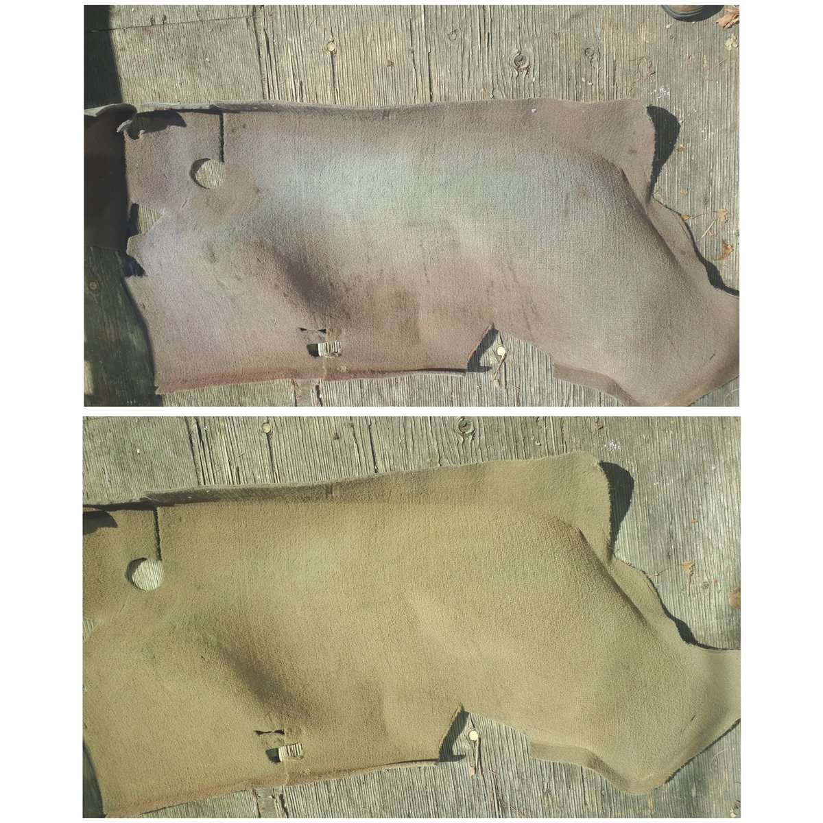

A lazy Saturday means lazy projects.

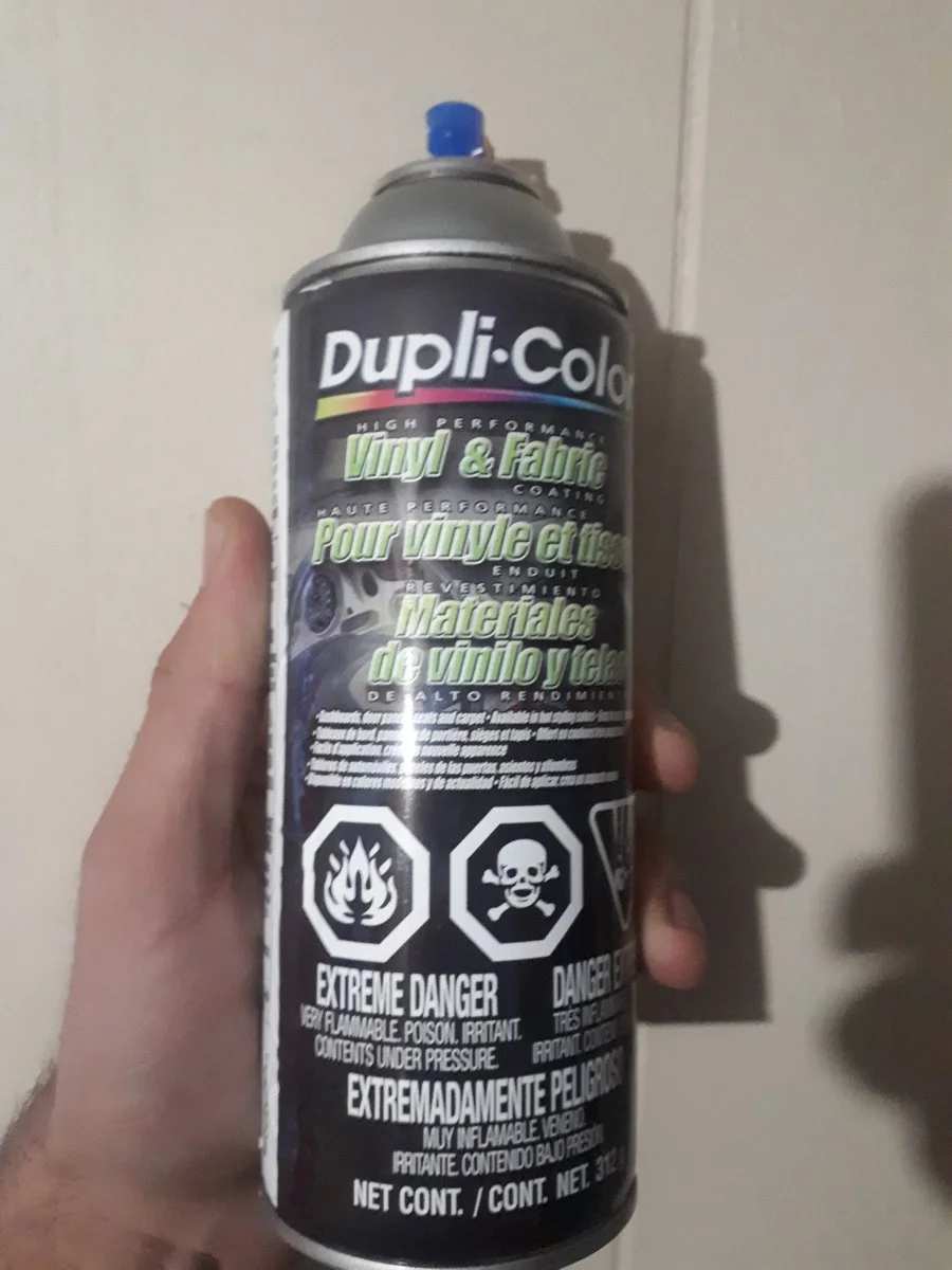

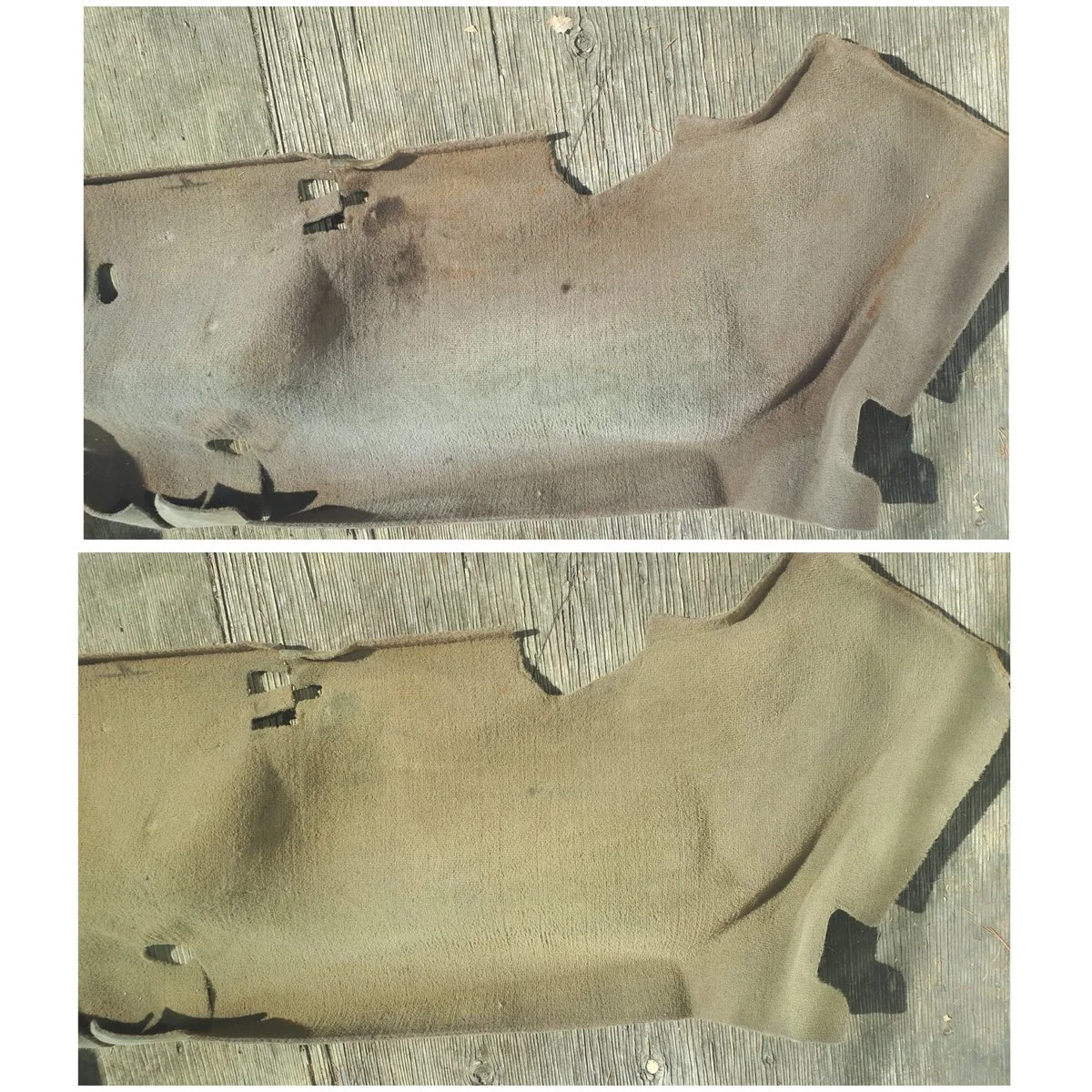

Decided to clean and get the first coat of dye on the carpets while they're out.
There's probably a proper way of doing this but I just soaked the carpet sections in a tub of water and Dawn dish soap for a few hours, and then scrubbed them inside the tub, took them out and then rinsed and dried.
Before
After next to some of the original carpet before they got dyed.
Now I'll just let them dry and then go back out and apply another light coat and call it 'good enough' for the day.

The only things I've done lately are replace the hard top bolts, and I finished getting the interior carpet dyed and ready to go back in.
Really pleased with the Dupli Color fabric paint. I'm sure there are some guys with sticks up their butts that it isnt the factory color match but IMO its a great way to bring some life back to your carpets without breaking the bank.
