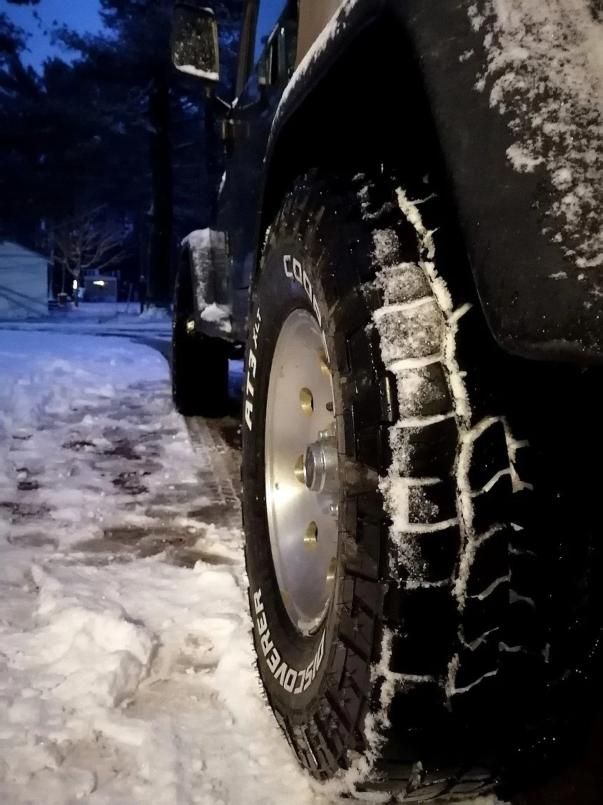

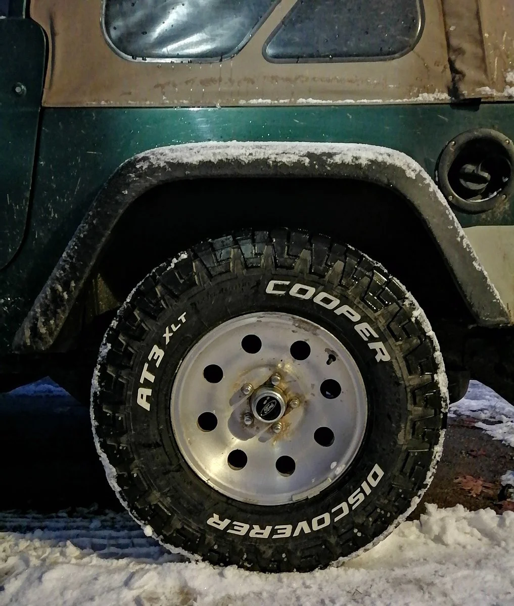

I really only have good things to say about these tires so far.
I'm really impressed with how they ride and how much noise was reduced just by putting and it hits the smaller bumps and cracks in the road amazing. We have't gotten much for snow yet so we'll see how they do then, but for now I'm happy I went with them.

Can't go wrong with either Cooper or General in my opinion. Hell, I have both for my TJ. A set of Grabber X3's, and a set of Cooper winter tires.
I'm really pleased with them!

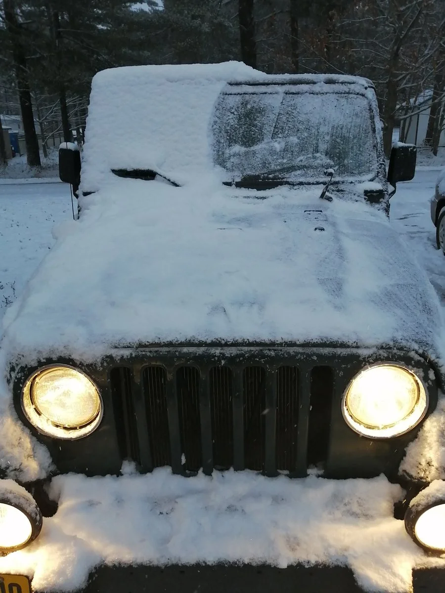

Got to deal with our first real amount of snow here today.....Yay 🙃 🙃
But it did give me a chance to test out the Coopers in some real weather and so far no complaints whatsoever.
They'll do a fine job of helping me not die this winter 👍

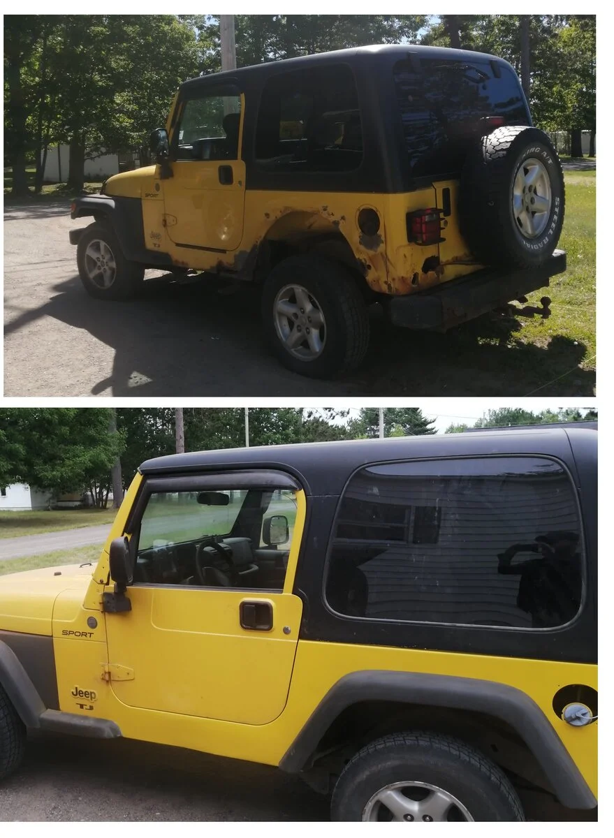

I picked up this yellow 04 TJ with the idea of using it for parts, but it's turned into the new base for this project, the frame and running gear is in amazing shape, the P/O put all new brakes and exhaust on it 2 months ago, hard top and an extra soft top, all the missing trim pieces and other little things I was missing, and it just goes down the road so quiet and smooth.
A lot of stuff has been swapped over so far but I'm still in the process of stripping the yellow Jeep down and replacing parts and pieces with ones from the green Jeep.

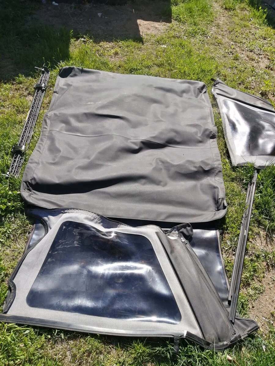

Can anyone help with what type of soft top I have here?
It's the spare soft top that came with the yellow Jeep but it's quite a bit different than the one I already own. I have no idea what it's suppose to look like or if I even have all the hardware pieces for it.

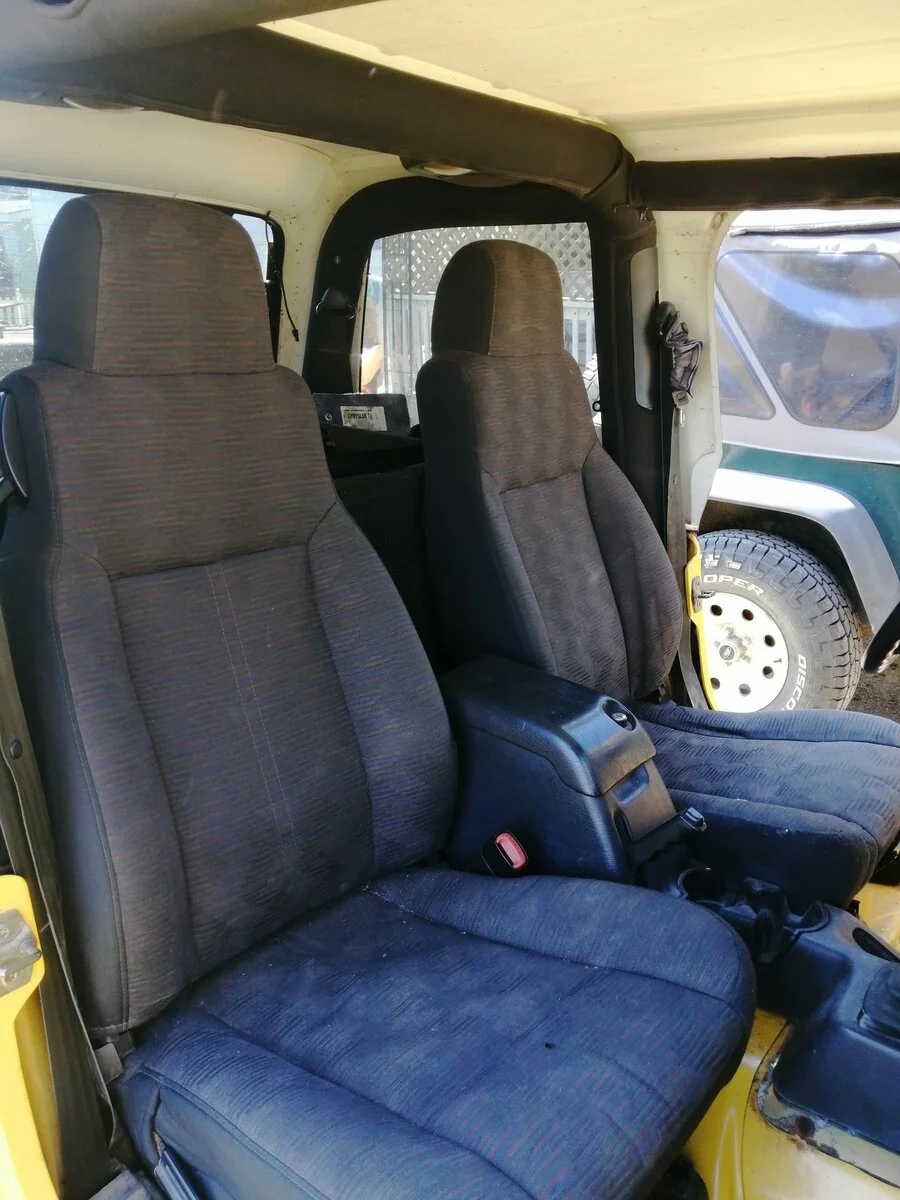

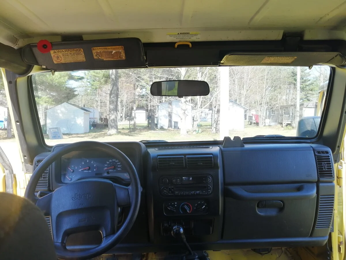

Also just for reference I'll throw up a few more pictures of the yellow beast to show what I'm working with.
I now have the added bonus of a factory subwoofer in the center console and all the missing interior trim pieces.
I like the dark interior quite a bit, but I also really like the tan, so I'm thinking about swapping/mixing and matching some of the interior to give it a 2-tone look kinda in line with the YJ Sahara look that I'm after.

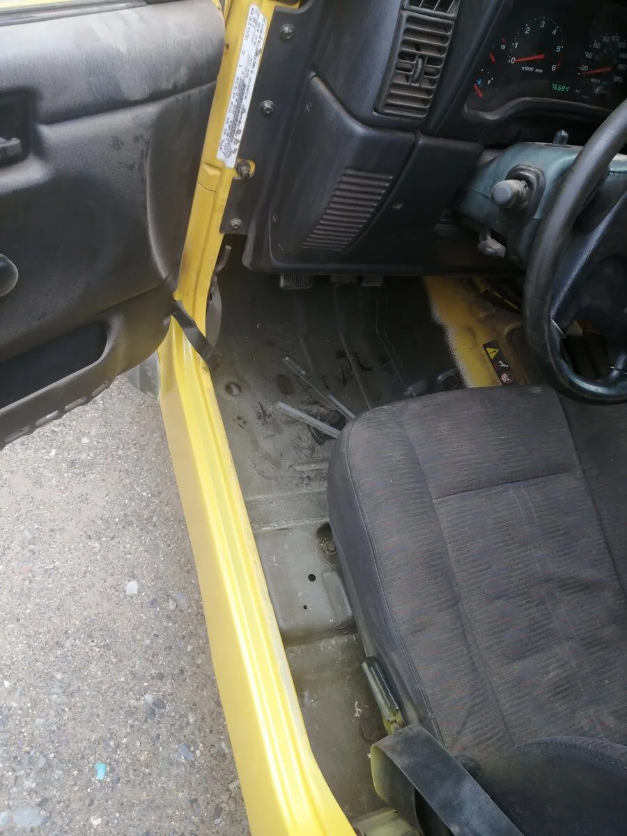

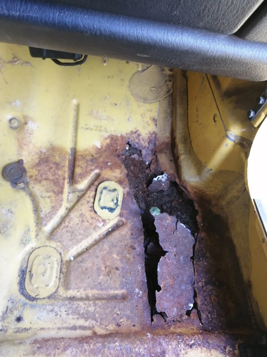

Other than that the biggest issue to address is the passenger side floor, which is by far the worst spot on the entire Jeep....BUT, luckily I know a handsome fella who just happens to have an extra floor pan already in his possession (It's me).
Once I get the floor pan in this week I'll be sanding and grinding and wire wheeling the frame and underneath and then hit it with some paint to bring it back to life and take some steps to make it last as long as possible.

It resembles one of the frameless soft tops. There's a couple different manufactures, hard to say which one from the pic.

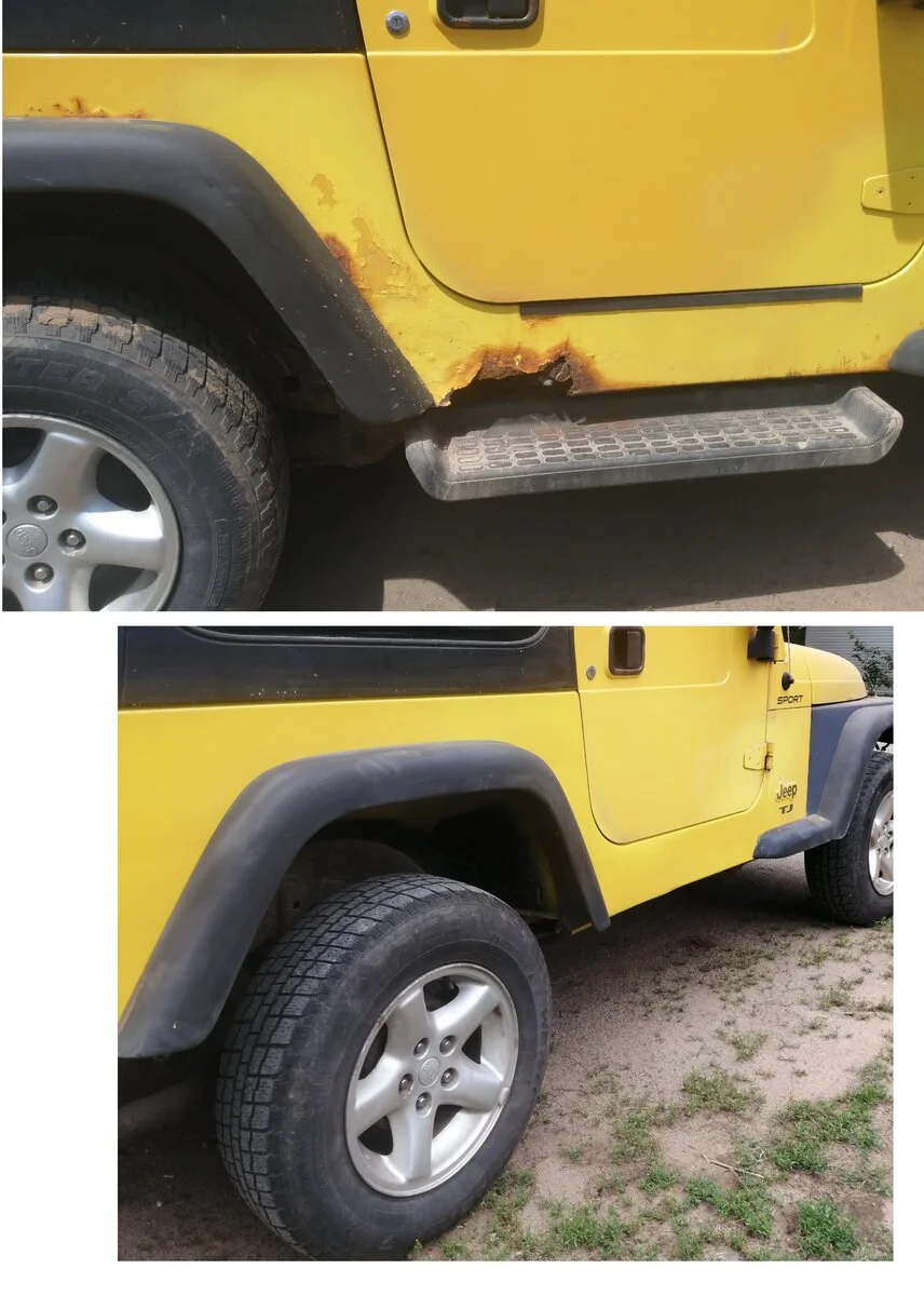

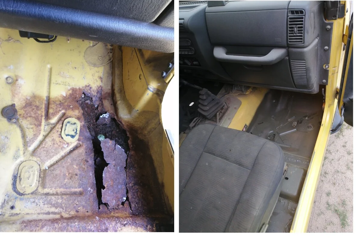

Yellow Jeep is dropped off to have the floor and bodywork done on it.
The prep work revealed a lot that that I would've rather not see lol But Everything is done and prepped to go, it's as stripped as it's getting for what needs to be done.
The worst spots I circled here in this picture, I got KINDA lucky that it's a lot of surface rust, and since I'm gearing up for a full paint job, it's not too devastating to the project, and if things take a turn for the worse, I still have the green Jeep use for replacement panels if need be, which I don't think there will be.
The next time I see this horrid beast it will have about $600 worth of new panels and metal into it.

Looks like a Bestop Trektop. https://www.bestop.com/jeep/2003/wrangler/trektop-soft-top/sub-model/exc-unlimited/. There is an install instruction manual PDF link on the page
This is super helpful thanks! I'm going to try to figure out if I'm missing any hardware today and I might end up using the top instead of selling it.
