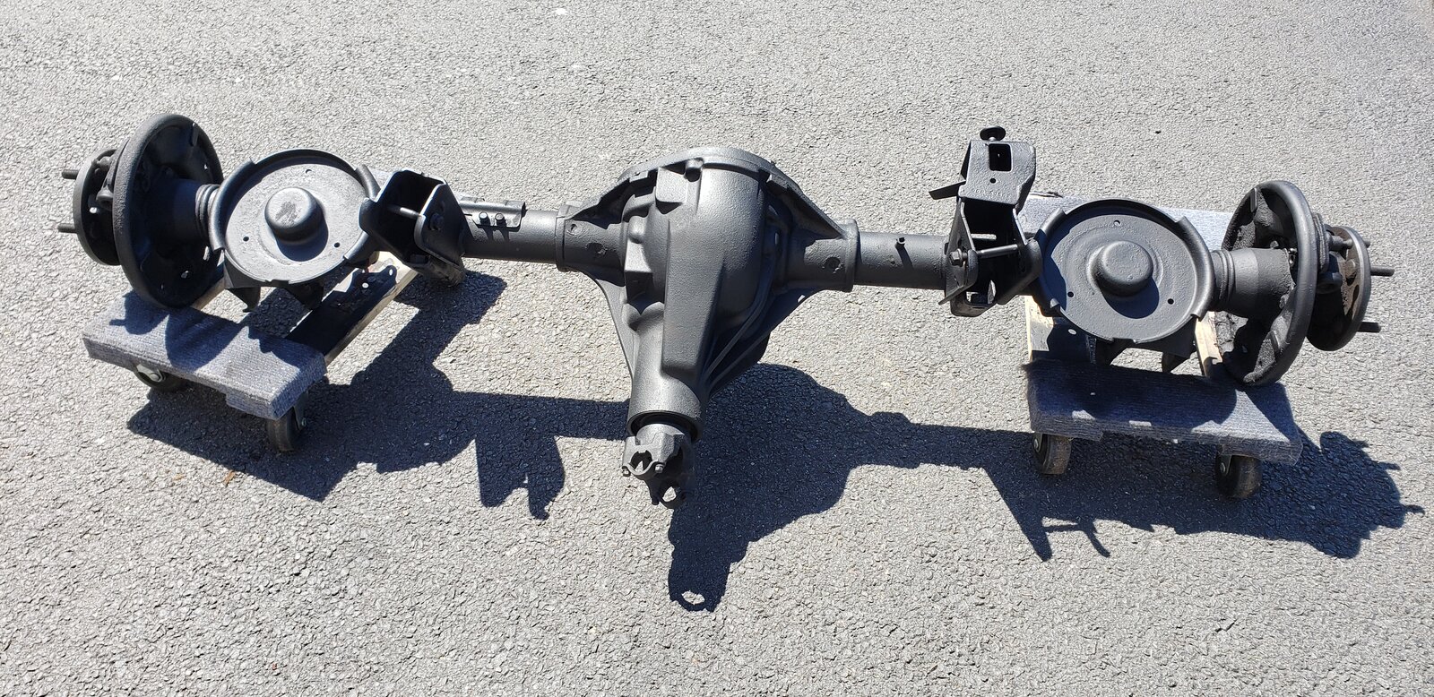

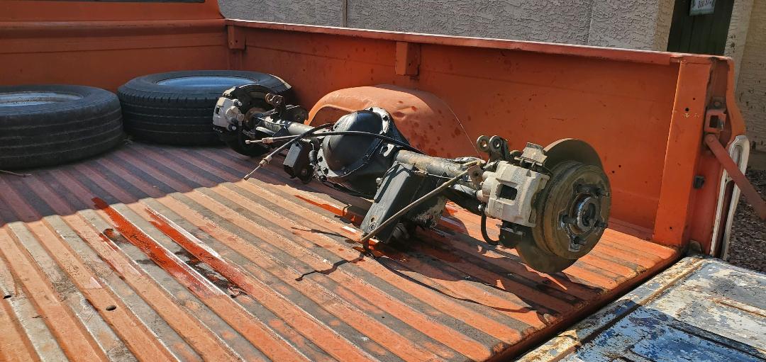

Picked up a spare factory 3.73 geared Dana 44. It was a bit of a impulse buy, but I rarely see them for sale anymore and this one came of a stock jeep that wasn't abused. All the brackets are straight, the bottom of the housing isn't worn, and it only had surface rust.
My original thought is that I'll regear and add an Eaton to this one, then swap over the disc brakes. That way I can take my time and keep the Jeep mobile. We'll see if that ends up happening or not.

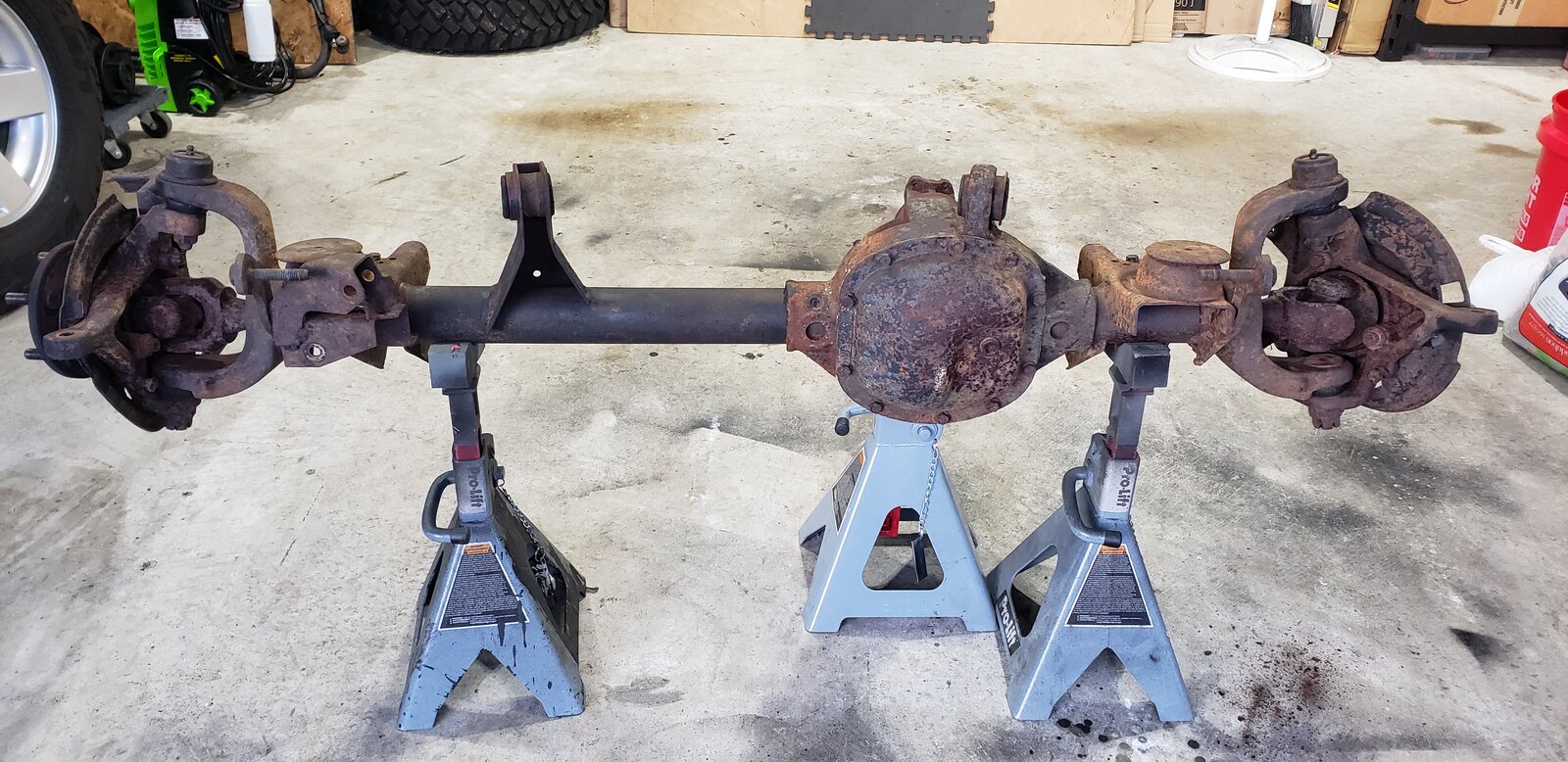

Mine looked like this. :(

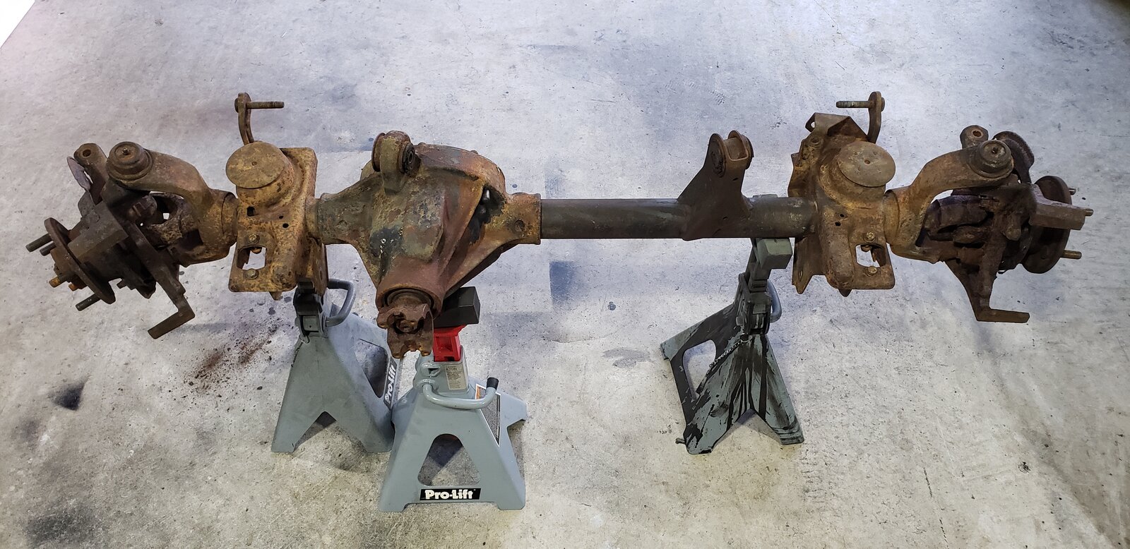

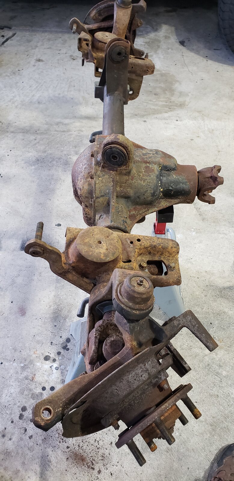

The donor vehicle was a stock Cherokee. While the housing has some surface rust it doesn't appear to have been abused or ever touched. The first step is to disassemble and inspect the housing.
Is that a homemade raised track bar bracket?
Correct. I have a RockJock one to go on when I get my tummy tuck done. For right now, it works fine.

Reinforced passenger side upper control arm mount —> Do tell more. Are you just boxing in the mount?

For the upper control arm mount I'm just planning to weld in a Barnes plate. Thanks for the reminder on reinforcing the stock swaybar brackets for the SwayLoc. I had completely forgotten about that conversation!

If you're going to flip the tie rod, you aren't going to reinforce the sway bar mounts anyway if you're using the BMB brackets. But strengthening that TB area is a good idea. When I pulled my axles for my recent build, it seemed like the metal there was in need of reinforcement (just looked thin) - and then I found the thread I posted that I had bookmarked previously for myself.

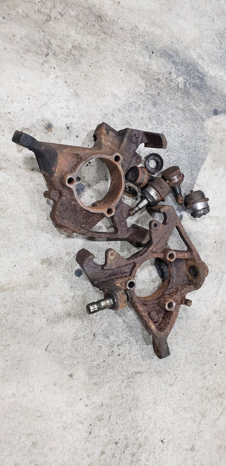

What a PIA! It took me 2 hours to remove just the ball joints. The bottoms were seized and it took heat and a BFH to finally get them out. One ball joint stud seized in the knuckle. I really wish I could watch someone that knows what they are doing remove ball joints. Maybe that way I wouldn't feel like such an idiot when I'm doing them. 😟
On the plus side, they were stock!
