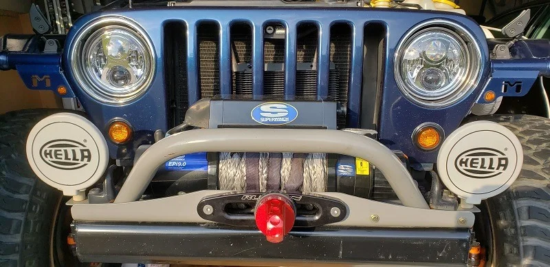

After serving me faithfully for almost 5 years, the UCF aluminum front frame width bumper is now gone.
UCF Aluminum Frame Width Bumper

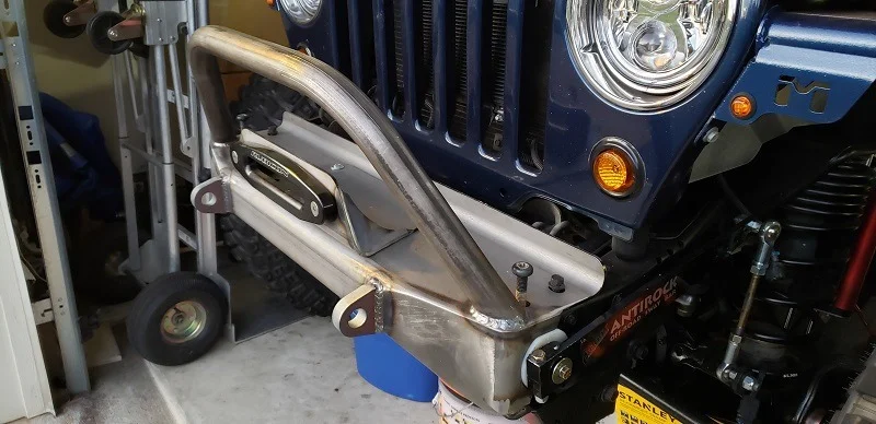

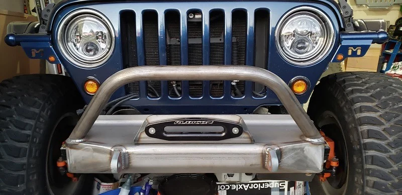

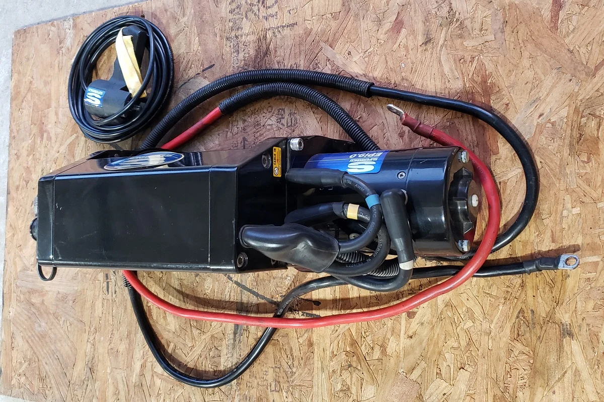

I've mocked up the replacement, a steel UCF Ultra-High Clearance front bumper. I loved the old aluminum bumper, which weighed in at 24lbs, including the bumper, aluminum winch plate and steel hoop. The new steel bumper weighs in at 43lbs, adding 19lbs back on the nose, but gives me the following:
  • D-ring mounts - The old bumper didn't have these and used the factory tow hooks
  • More room for my winch - The old bumper hoop hit against my Superwinch EPI9.0 so tight that I could get a cover on it securely, causing me to lose two covers (This was a trivial, but annoying)
  • Approximately 2.0" improvement on the approach angle - The Ultra-High Clearance bumper only works with setups that remove the factory swaybar, e.g. Currie Antirock. Using this configuration, the bumper is pushed in approximately 2.0" closer to the grill. The first top factory bumper bolt hole, i.e. the outermost, is no longer used. The second factory bumper mount hole is used in conjunction with the outermost factory swaybar mount hole. This gives two frame tie in points up top, along with the factory bottom frame bolt.
I won't be able to do the actual paint and install until after the holidays, because there's a PSC steering kit sitting in my garage that has to go on first!

You're correct, there is no aluminum option for the Ultra high-clearance bumper. Without options, it weighs around 29 lbs. I went with the d-ring mounts, hoop and fairlead mount, which made the bumper weigh a little under 43 lbs. I ran a UCF aluminum bumper before this one and was very happy with it. However, it had some shortcomings which I outlined in post #6.
The Savvy bumper has a very good reputation and I looked at it originally. However, I preferred a frame width bumper, which it is not. Others can jump in, but my guess would be that if you add up the options on the Savvy bumper it would weigh somewhere around 24 to 26 lbs. Assuming the lighter side, this makes the difference between the UCF steel and Savvy aluminum approximately 19 lbs.
In the end, it depends on what's important to you. If you're looking at frame width bumpers, the Motobilt one is also very nice. Several folks on here run them and they seem to be a very well made alternative.

I bought a warn m8000 and a raised winch plate to fit on my random front bumper(from previous owner), I have a fairlead and a raised winch plate, would i need the fairlead mount if I went with the UCF ultra high clearance front bumper, and what about raised winch plate? It also says I cant use the factory sway bar, id need something like an antirock, I have disconnects but I dont know if that will work.
If you use the factory swaybar, the UCF Ultra High-Clearance bumper won't work. You need to eliminate it and run something like the Antirock. Also, you wouldn't need a winch plate, because the bumper is the winch plate. Lastly, I'm guessing your fairlead mount would work, but it's best to call UCF. Based on what you're saying, it's sounding like this isn't the bumper for you, unless you're planning on installing an antirock, which I'm a big believer in!
