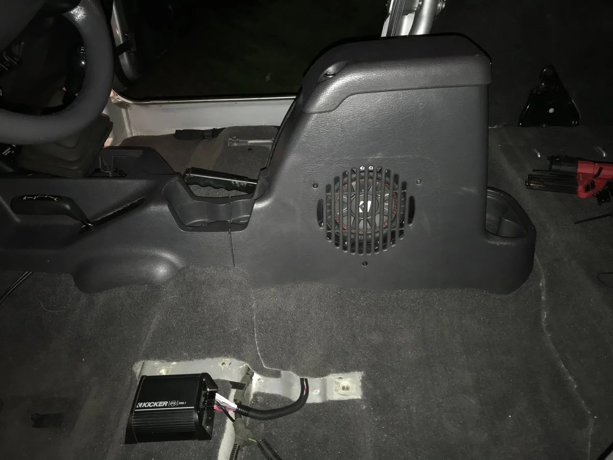

Here’s a picture of my subwoofer setup. Hidden neatly under the seat.

Did you have to fabricate a new mount for the sub to install it in the center console?

I hid the subwoofer amplifier (200 watts RMS at 4 ohms) behind my instrument cluster. I'll see if I can find the photo. I used the same console sub.
