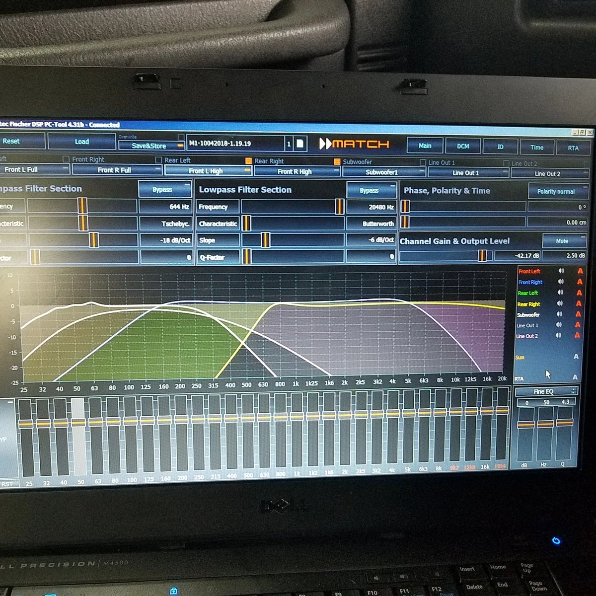

That's exactly why I'm using Tang Band wide band drivers on the A pillars playing from 320hz and up, and Dayton 5.25" woofers in the dash playing from 80-640hz, which I have sealed up around the mounting surface for much better bass. The vocals and high frequencies are nice and high above the dash. The weird overlap between 320-640hz is something the DSP does in my Kicker amp. I was skeptical of it, but it sounds nice, and doesn't sound over lapped at all.
Very Nice! You are the exception. No one else even mentioned crossover tuning - just throw some speakers in! The overlap might look weird on paper, but I bet it flattens out in reality.

In my case I have a fully active 7 speaker set-up controlled by DSP, a very fun DSP.
