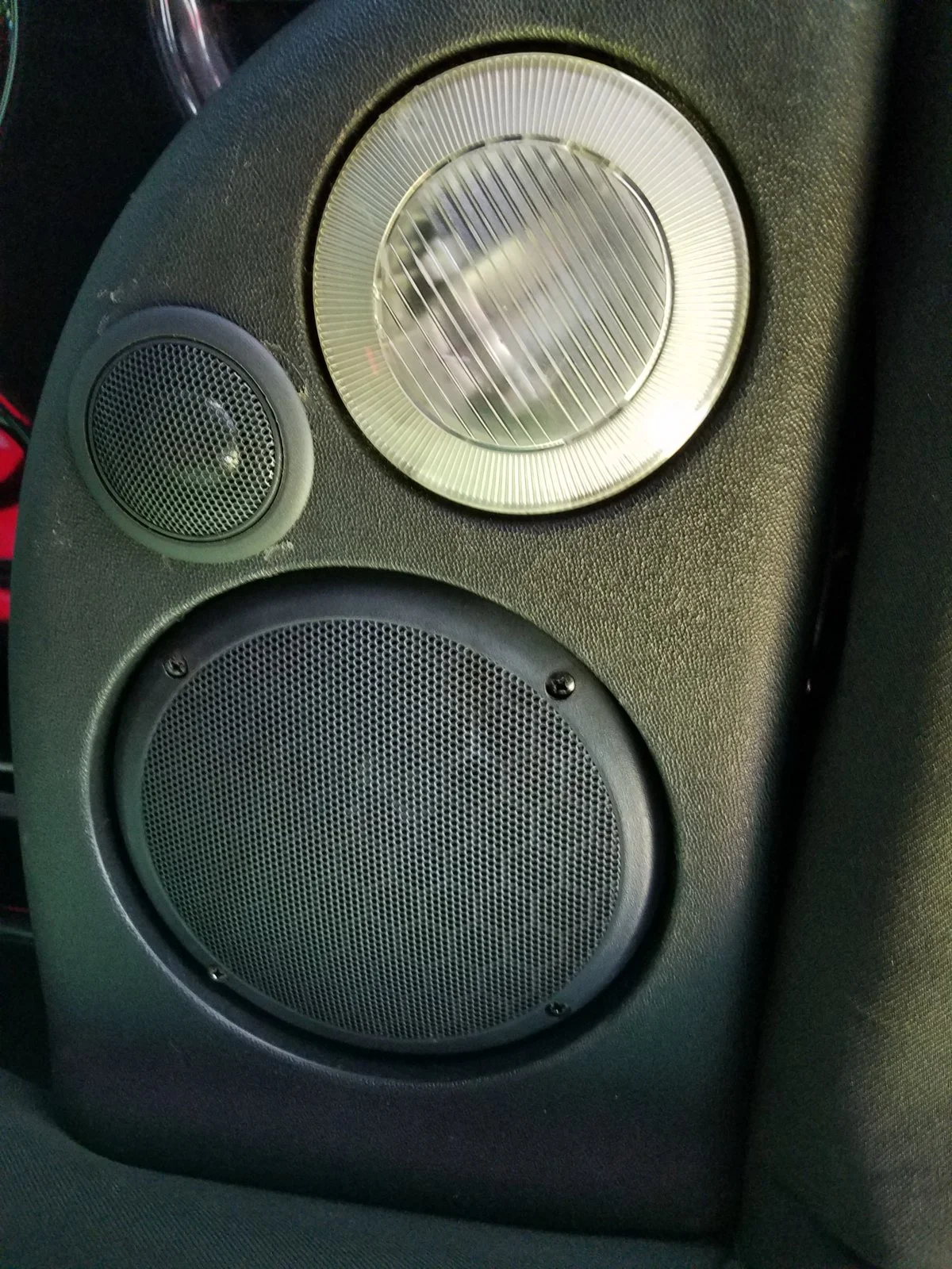

If you're considering upgrading your audio system, 2 suggestions I would make would be; upgrade the center dash to a 2 din and put in a touch screen head unit. Some may argue that this goes against what a Jeep / TJ should be, but I really like the ability to have a back up camera. I run a 35 inch spare mounted on a swing gate in the back. So rear visibility is not the greatest. Depending on your phone and the head unit you get, you can access apps and navigation from the head unit. Next suggestion would be to upgrade the front speakers to 5.25 inch component speakers. You can get brackets that allow you to switch the 6x9 speakers to 5.25 inch. Then mount the tweeters up on the dash. This will help you get better mids and highs.
