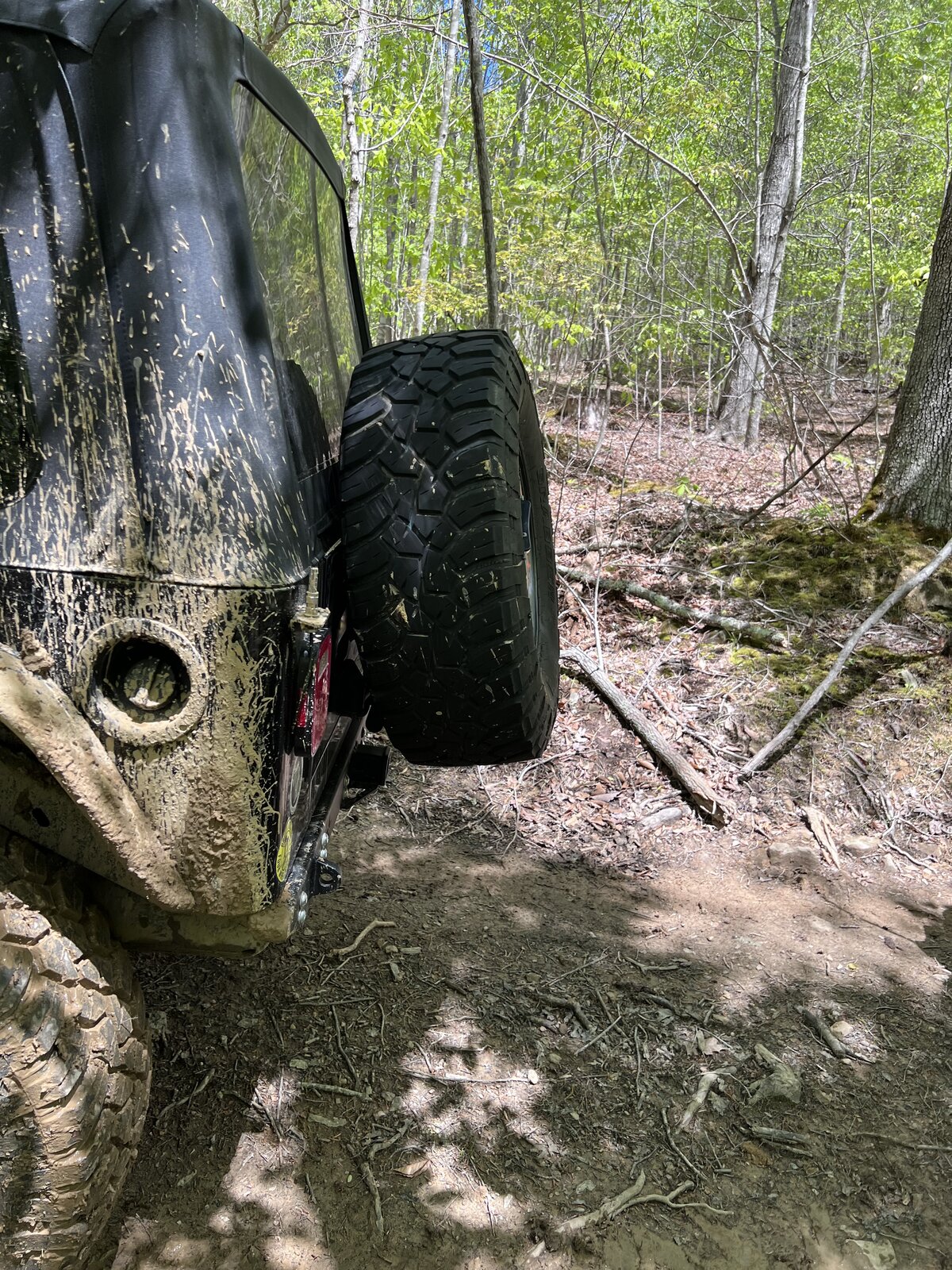

I also bent my tire carrier, dropping off a ledge. Everything is so tight to the rear, it took the full force of the Jeep coming down on it.

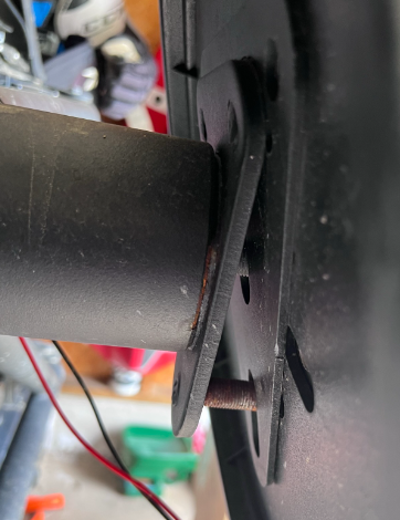

I mentioned that I bent my tire carrier on the last wheelin trip to Kentucky...Finally had some time to further investigate and found this...
Looks like the mounting plate twisted...and I didn't have a third lug nut on, so that is what allowed the tire to pull away from the carrier. Not sure if that saved my tailgate, or if it wouldn't have bent if the lug nut was there. Either way, I'll be fixing it. I may make a new plate with the proper pattern for my wheels (5x5) so I don't have to use an adapter...but then again...that extra adapter saved my bacon when I had one fail.
