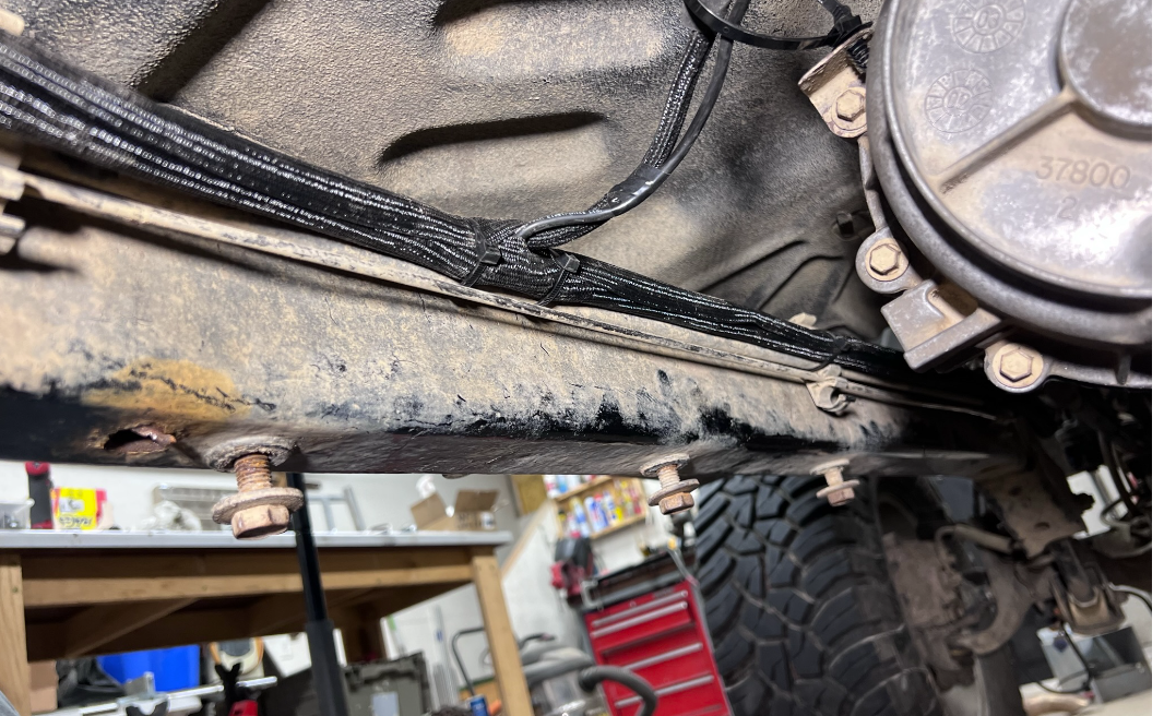

Building the harness
All loomed and tied up nicely

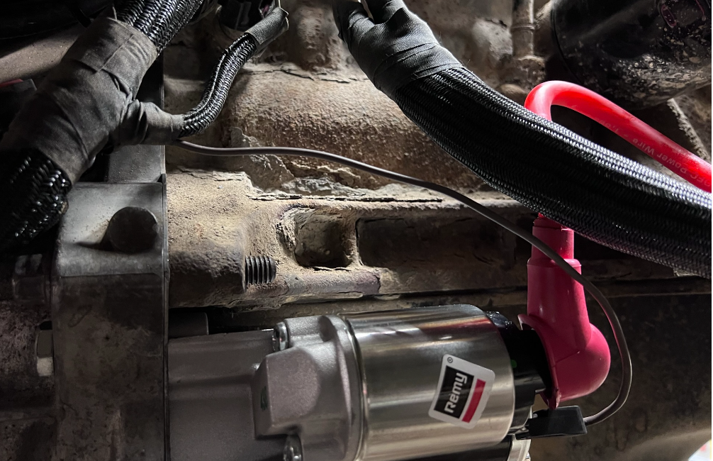

Got my starter installed too. I need to go get some different bolts, but these will work temporarily. Once is a touch too short and one is a touch too long.
This part of the project take SO much time. I even had to make a couple brackets to hold the wire for my temp sensor. One little Z-bend bracket to give it a good mount near the temp probe. Needed a Z-bend to clear the stiffening rib of the transmission pan. Then I used a small flat one with two holes to route the signal wire up to the tunnel where I decided to pass that wire through the insulation of the floor shifter plate. Those dumb brackets probably took me an hour to make (including paint).

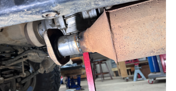

Last couple days I've been working on electrical and exhaust. Electrical in I'm wiring independent switches to my front and rear lockers. But because I'm a weirdo...I'm also keeping the dash indicators and I have lighted switches that will turn on with the headlights and indicate when they are "on." However, since the Rubicon uses Negative logic through the PCM to control the lockers, the switches don't work the way you expect them to...they work backward (+ goes to the negative poles of the switch). No biggie, right? Well...when you have an switch that had LED indicators, polarity is important. I dicked around with the switches for FAR too long, but I did finally get it figured out. I'll maybe post a "how-to" in the future. It turned out to be pretty easy, but I made it much more difficult forgetting that part about negative logic. I also ruined a circuit board in one of my switches in the process, so I'm waiting on another one...Education is expensive (or Stupid Tax).
The next challenge was installing my exhaust. I was running a MagnaFlow. It was in decent shape, but not great. I know it was leaking at the muffler/tailpipe joint, I had already welded the canister seam once, and I was ready for a change. It sounded nice, but it never really fit that well. So, I ordered a tailpipe and muffler from Walker. Got the Quietflow muffler...and its about 22.5" long. With my tummy tuck, the muffler needs to be about 20" long to miss the upper control arm mount. So, after trying LOTS of different ways to make it fit, I decided to modify my cat pipe and take the two inches out of it.
I wrapped one wrap of 2" wide masking tape on it and got to cutting!
Mocked up with a 2 1/4 ID Exhaust connector
Welded the first piece on
And finally welded it in the Jeep. This was very challenging, but I got it done. The welds aren't pretty, especially around the top of the tube where I was trying to get my torch in to the area between the exhaust and the tub.
Happy to report that the Muffler fits pretty well now, and I shouldn't have any issues with it clunking against the upper control arm mount.

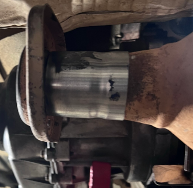

Finally I removed about an inch and a half of the hanger to get the Cat and muffler spaced a bit further away from the tub after the skid plate is mounted. This is the second one I've done and for a shitty as the frame welds are on the jeep, they the exhaust hanger to transmission mount RIGHT. Fully welded and deeply penetrated. They are a giant pain to cut off.
The removed piece
and all stuck back together
That was the last big project I have to complete. My welds are cooling and I'm heading in for a bourbon and relax. I should be driving this week. I may take Friday off to finish it up. I haven't taken a day off since Thanksgiving...so I think I'm due!

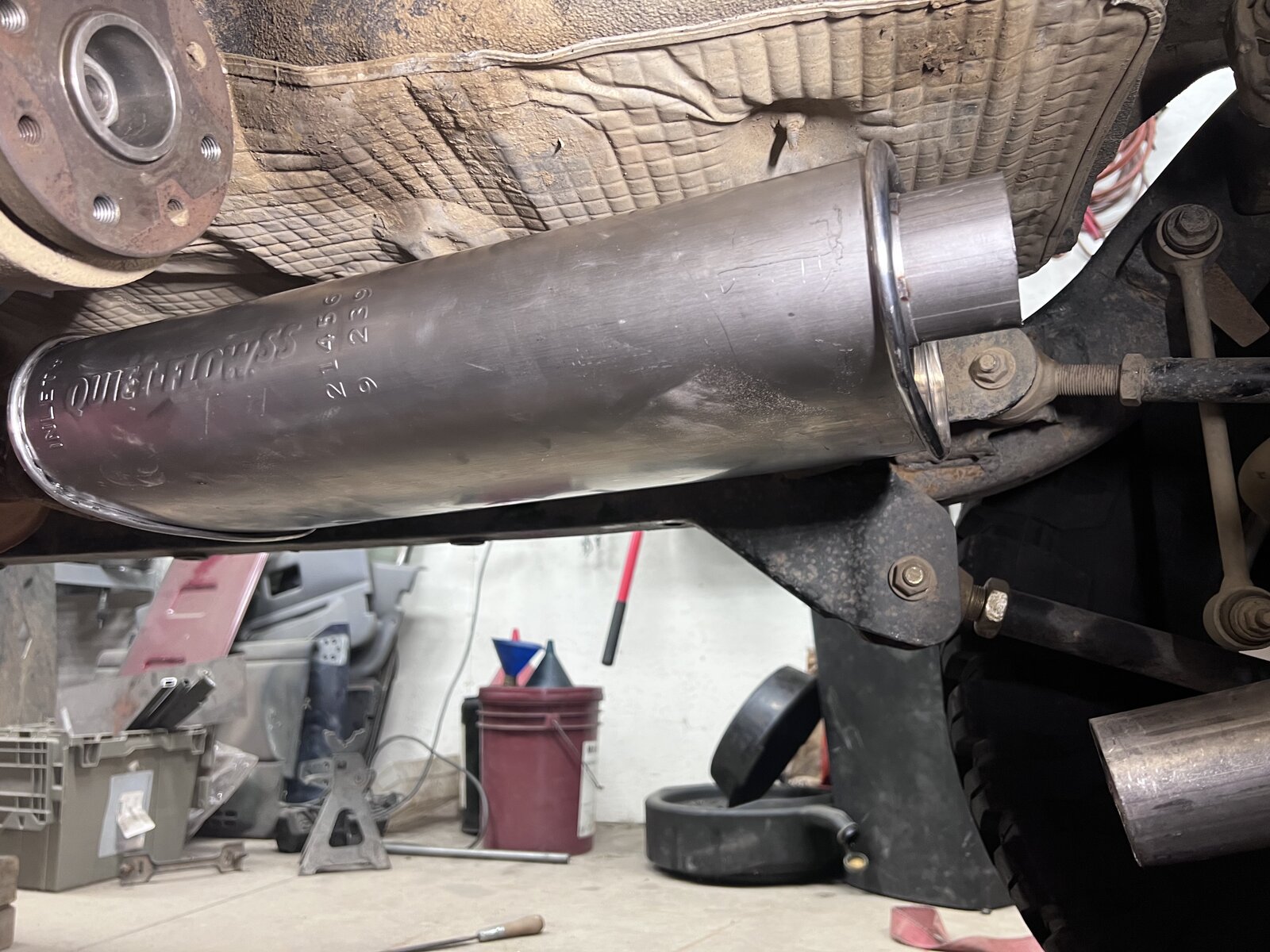

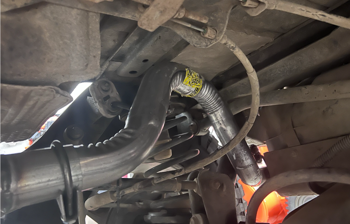

Got my muffler mounted up tonight. Pretty happy with how it turned out. First time welding exhaust tubing. Here is the clearance I gained on the rear uca mount. The muffler was into that bolt, HARD, before the modification.
And since mods beget mods, I will need to cut and move my tailpipe hangers to match the muffler’s new position.

I love the picture of the distance between the hanger and the muffler. I can identify with that. 🤣

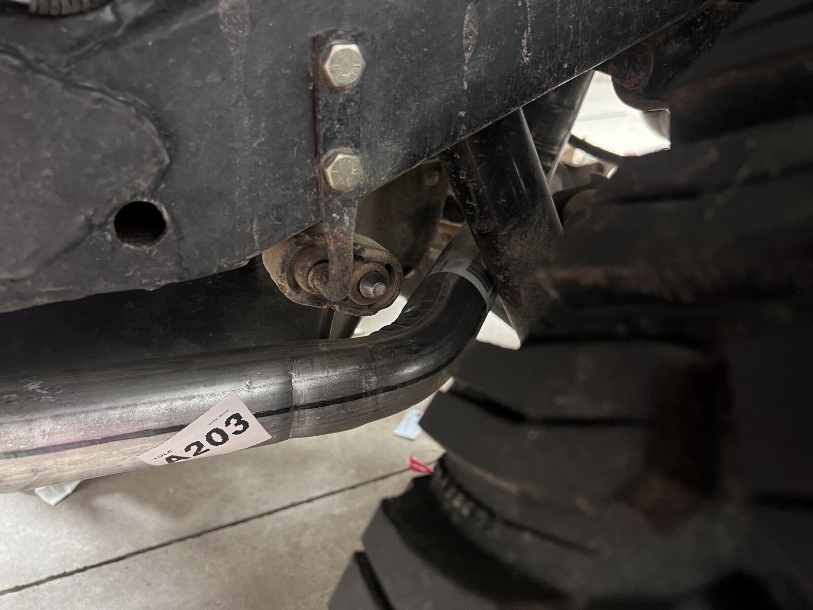

I kinda miss the days when a "bolt on" mod was actually bolt on. I have, oh, I don't know, 5 hours, into fitting this stupid exhaust. 5 HOURS!!! For a factory replacement, non-performance, crinkle wall bend exhaust system. Its done though, and it did come out well. I have clearance everywhere I need it and its hanging from its hangers pretty nicely.
Since I can't stand the look of the crinkle wall bends, I cut the downturn off with a standard slash cut. Hopefully it doesn't cook my fuel tank skid. If it does, I'll buy a turndown tip to bolt on. I even managed to get some clearance between the shock body and the tailpipe...which is something I've actually never had. My shocks have always rubbed the tailpipe.

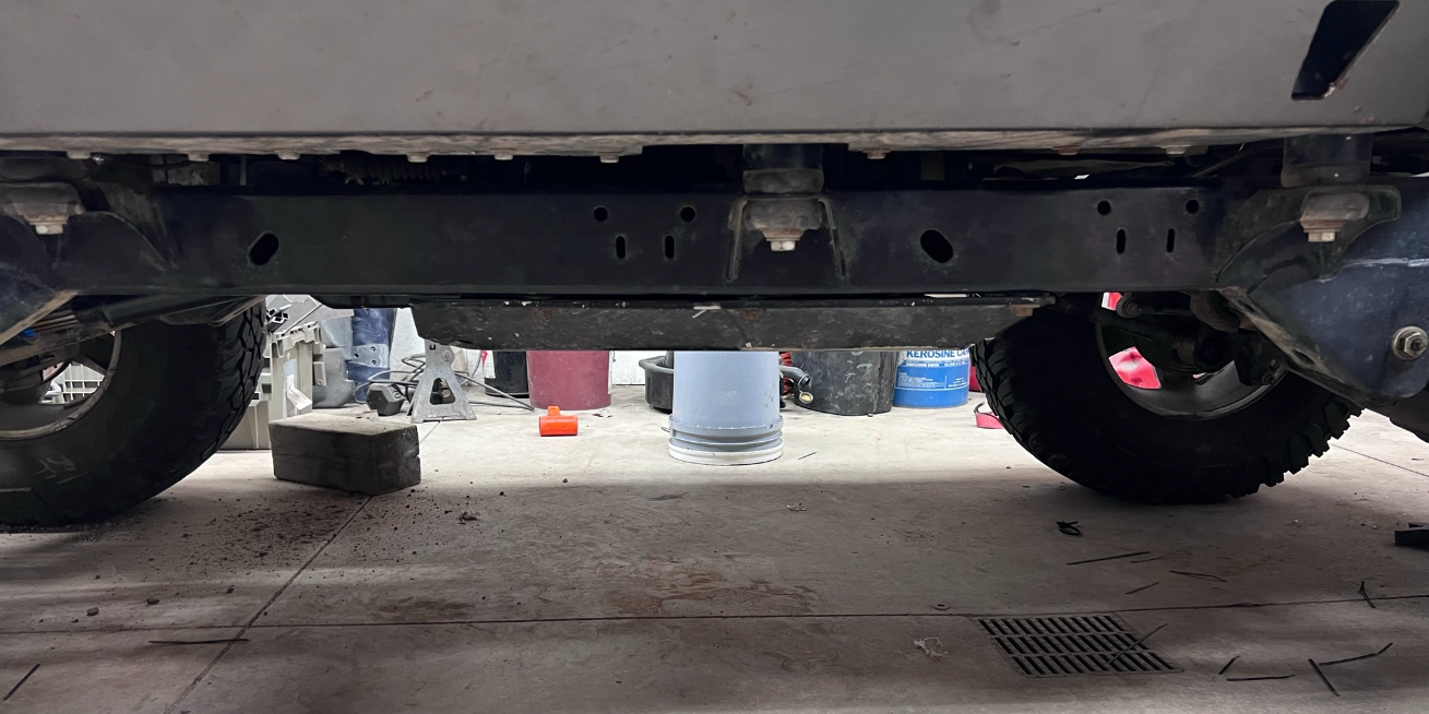

And, for the first time in two and a half months...The transmission is supported by the skid and not a jack stand!
Everything underneath is tied up, Driveshafts are in. I have a few electrical things to finish (the never ending switch saga, radio re-install, new horns, and giving all the connectors from my relocated locker pumps a place to live). I should be test driving this weekend, assuming the weather isn't total dogshit (like it is right now).

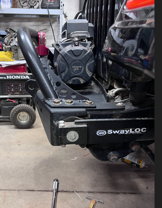

Here are the parts I got from Send Cut Send. Great response and I got exactly what I designed. It was less than a week and pretty reasonably priced as well.
Bolted them down on the bumper and tacked up the Barnes Bull bar. Can't beat it for the 40 or so dollars that it cost
https://barnes4wd.com/products/miter-cut-diy-bull-bar?_pos=1&_sid=d7717f57c&_ss=r
It has, in my opinion, the perfect angle height and spread for a TJ. It just plain fits. The ONLY thing I didn't care for is that it appears that they miter cut the tube ends before they bent it and that caused some difficulty for me. You can see the gap in the second picture that I filled with my welder. With the WRG safety thimble fairlead, I had to make sure there was clearance between the bar and the thimble to make everything work together. I think I would almost prefer the Old Viking tube mount for a thimble. I may work on something like that.
This weekend, I worked on painting it. Used my favorite paint for exterior trim type stuff (Rustoleum Spray bedliner) and got it cleaned up. Here it is, all mounted with fresh hardware
I'm really happy with how this turned out. Been looking for something like this for a while and was contemplating buying some DOM and trying to bend it myself (I have a friend with a bender). This was WAY easier.

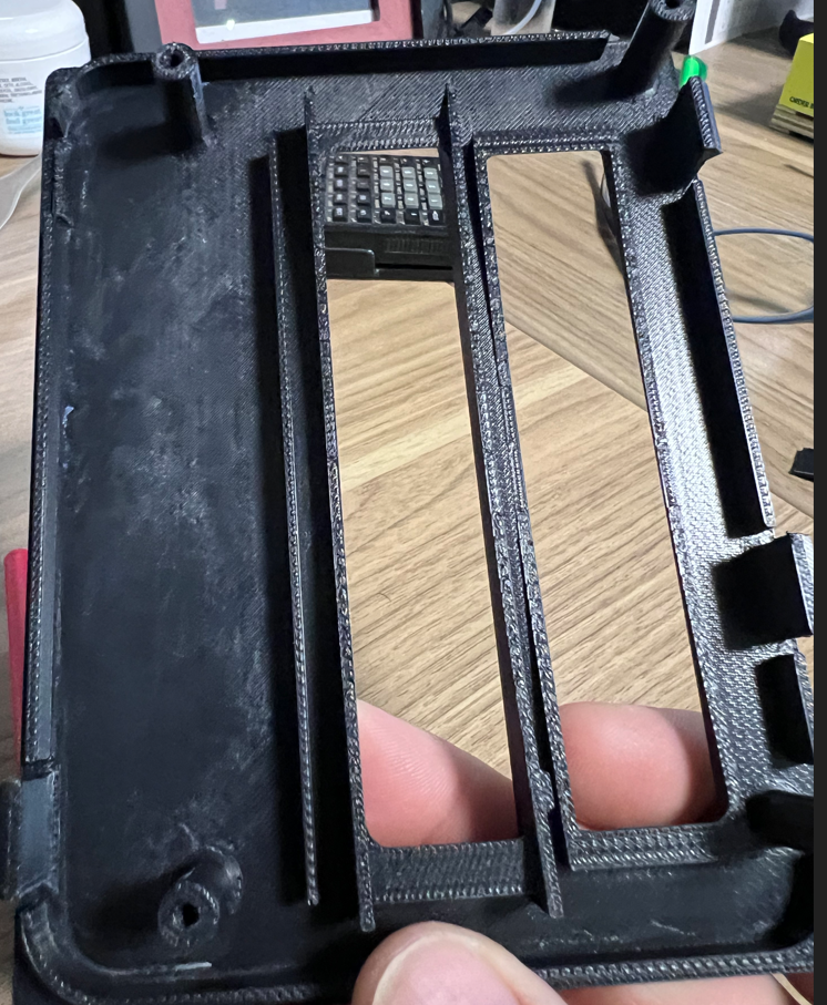

The other project I've been working on has been the shifter trim plate for the Auto. The one I got with my transmission fit VERY loosely and had a broken tab...Then Another one broke. These dumb things are like 135 dollars on ebay, if you can find em. I figured I had all the pieces and parts, I just needed some tabs...so I took it all apart and made a 3d Printed trim cover that I can screw the rest of the assembly to.
Here it is, fresh out of the printer
I worked it a little bit with sandpaper and bondo to get it nice and smooth, then painted it to kinda match the original (smooth around the cutouts and textured everywhere else. This also turned out very well. My sheen doesn't match exactly, but its close enough for me. I used satin finish black paint on the cutouts and the bedliner for the rest of it. Here is how it compares to the original
Close up to show texture of bedliner. The original is on top

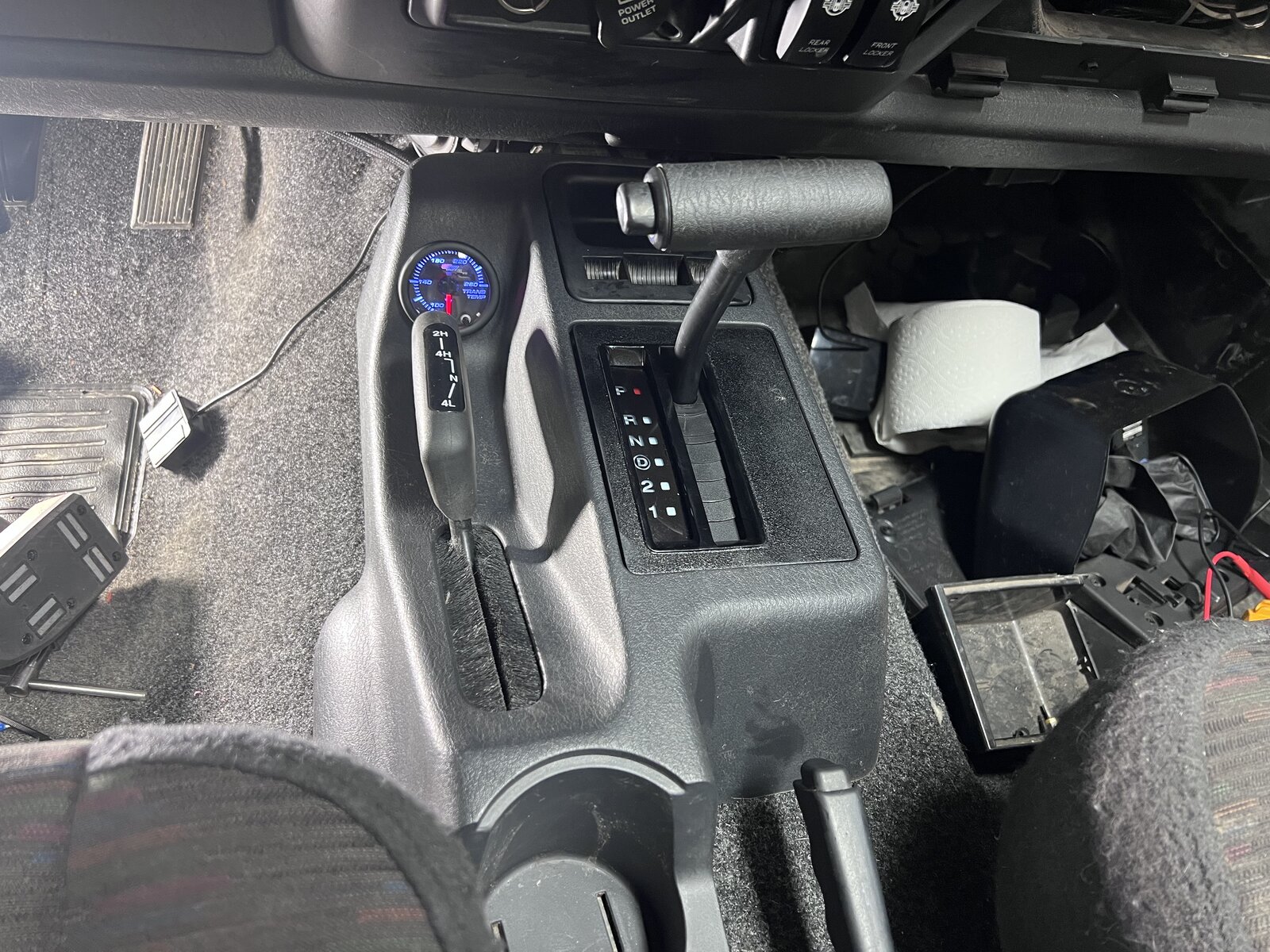

Fully assembled and installed in the center console. This also turned out VERY well. There are a couple revisions I need to make to the model and printing process, but I may make these available to people who need them.
