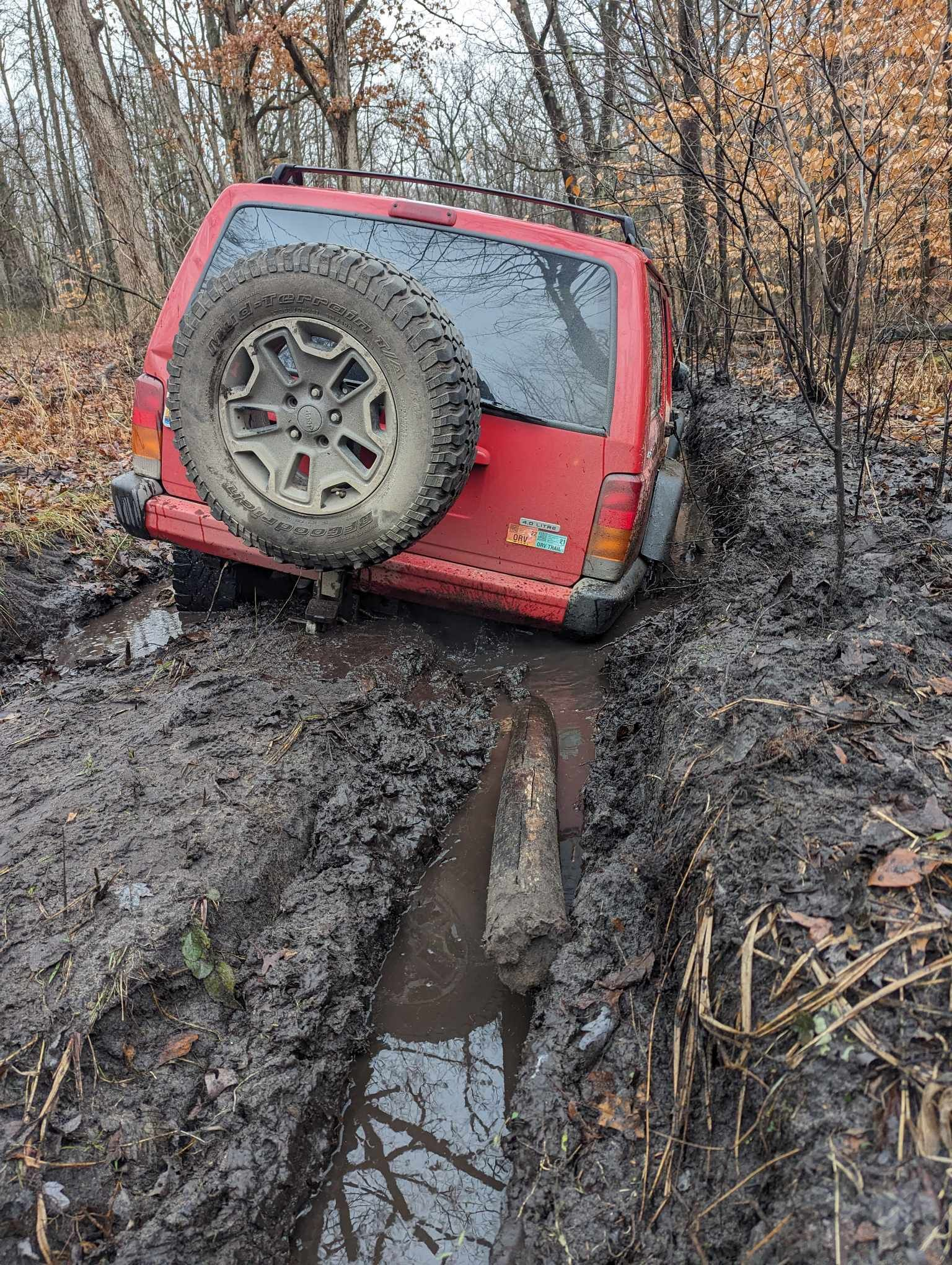

Got out in the woods again today to pre run a trail run I'm leading with my 4x4 club in a few weeks. Had a pretty good time, got the jeep muddy, again. Buddy of mine that pre-ran with me BURIED his jeep in an optional road bypass
We winched him out and then he had to bail his Jeep out!

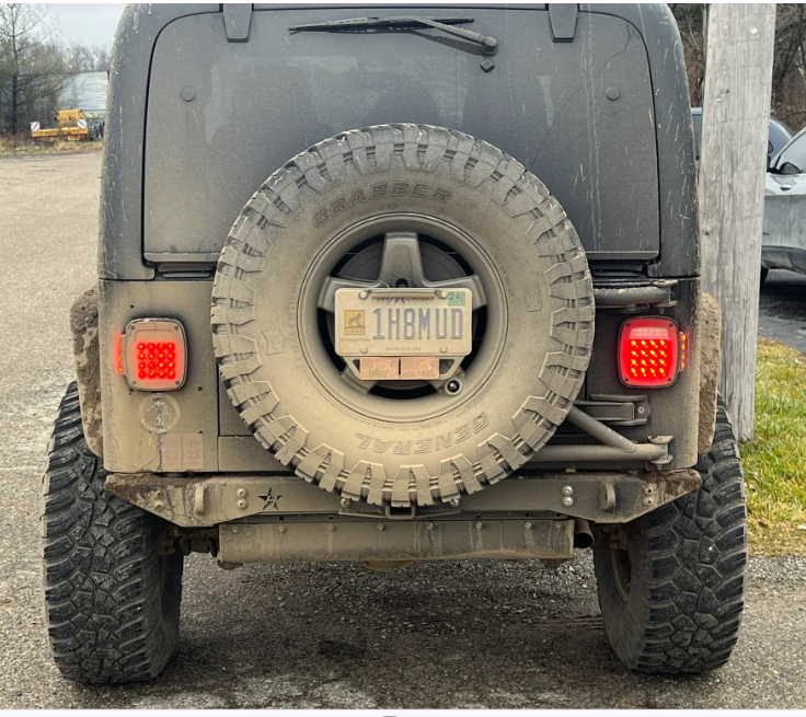

And, in case any one is wondering, the new BMB tail lights are Bright enough to see through the mud
Off...with a muddy Tail light
And Brake lights ON
And Brake lights ON
I think you and the XJ buddy need to swap number plates 😂

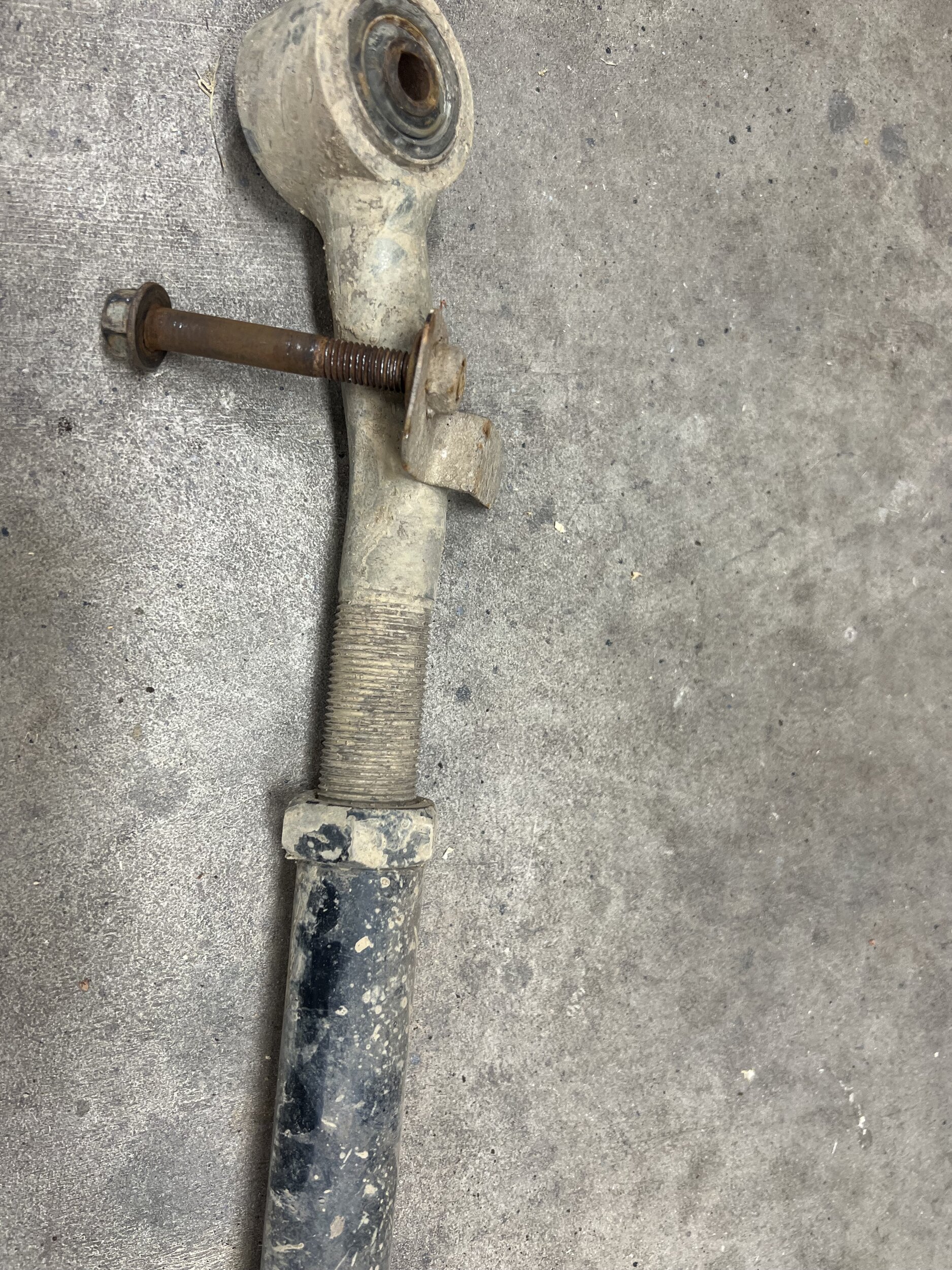

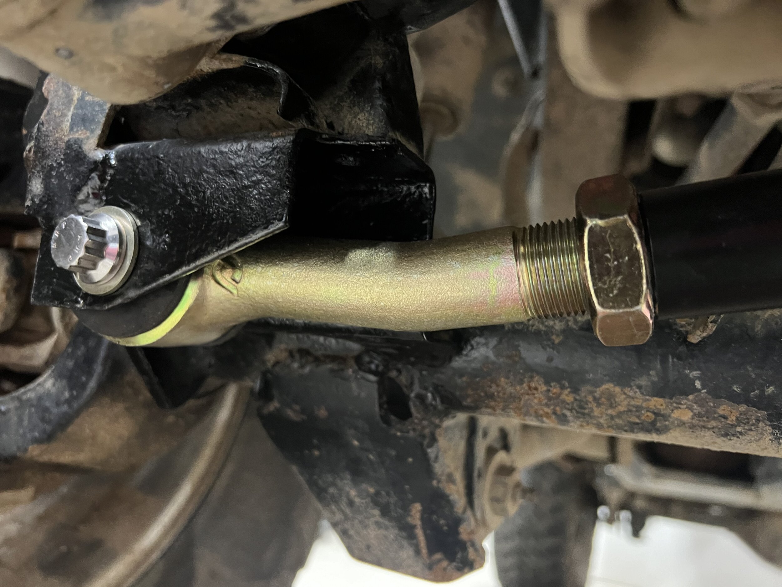

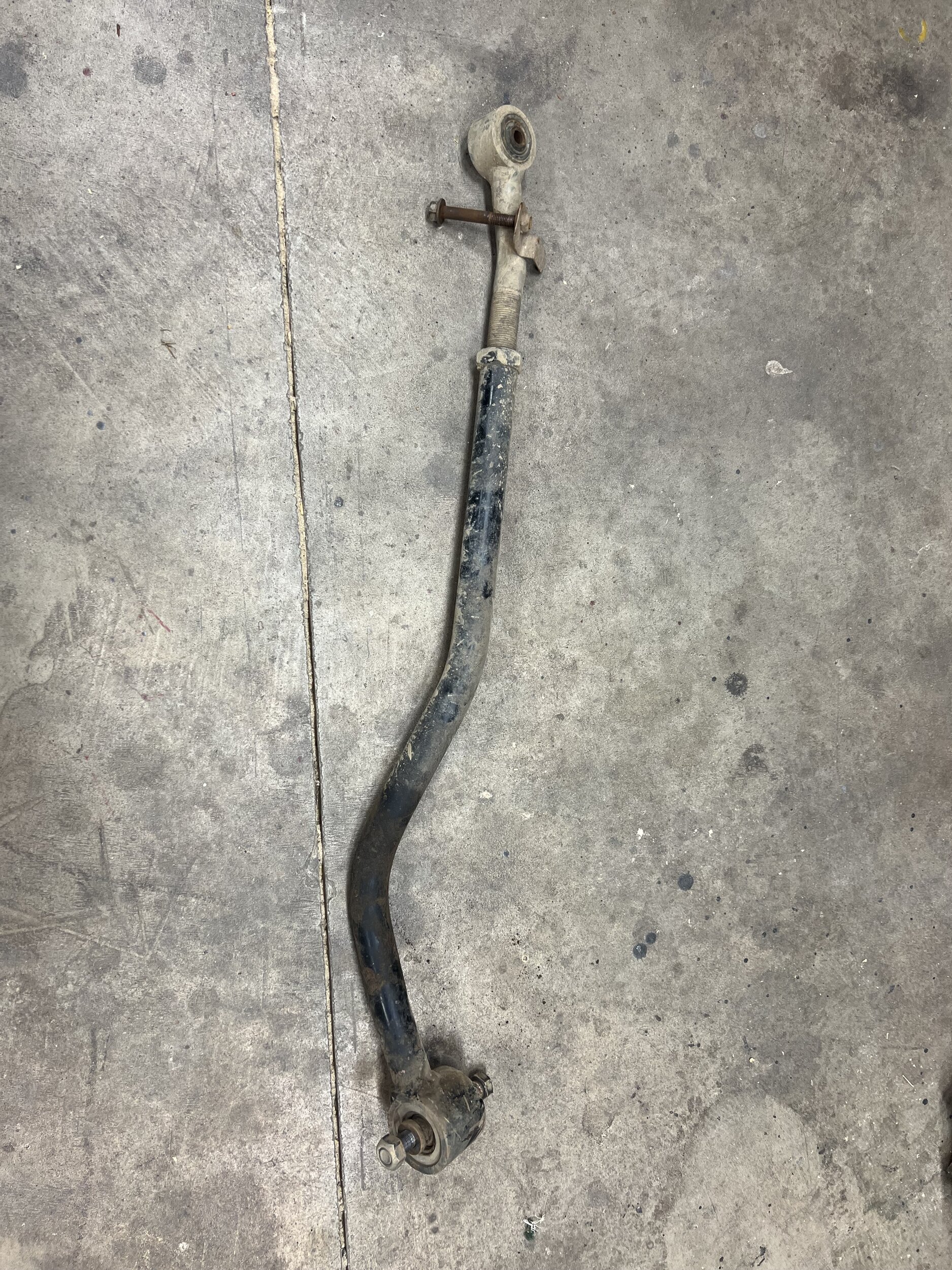

Been a long time since I’ve installed any new parts on the ol' girl. Fixed that today. I should have done this a while ago, finally replaced my 0-2” lift JKS track bar with a RockJock designed for 4” of lift.
I bent the axle side of the JKS twice…once spun my steering wheel about 90 degrees. After I straightened it out, I bent it again, and the steering wheel was about 15 degrees off. Only thing I can think of is that the axle side had too much thread showing, even though the lock nut was always tight. I just don’t think JKS’s rod end was strong enough for the use I was subjecting it to.
The old one:
New:
Even treated her to one of Blaine’s nice 1/2” hardened stainless track bar bolts…
Here is the difference in the length of the heavy bar between JKS and Rock Jock. Additionally, the Rock Jock end is forged and the JKS is a bent piece of steel.
Finished up by doing a quick alignment and recentered the steering wheel.
The old one:
New:
The JKS is a good bar for what it is, but similarly I had to swap over to the Currie for strength and a bit more clearance around the diff. Given the choice, this is an easy "buy once" recommendation that is too easy to ignore.
Yeah, The clearance thing is hard to see unless you have the two side by side. I've seen them in pictures, but holding them next to one another, you can see the diff clearance "bump" bent into the Rock Jock Bar is longer than the JKS bar. Plus we've all seen the way they offset the bar forward on the joint barrel to provide a touch more clearance around the spreader bosses.

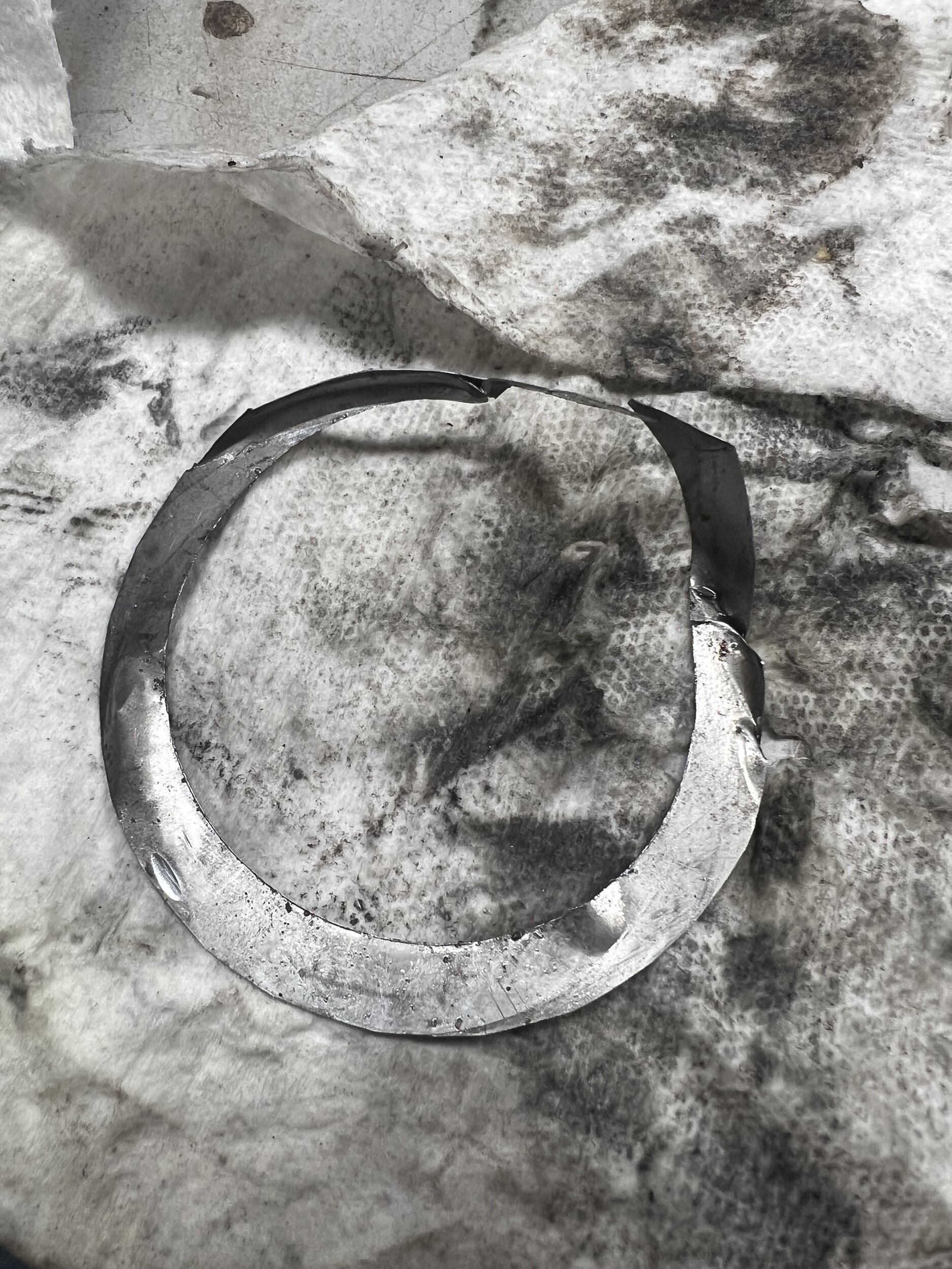

When doing so, the diff came out very hard and I lost track of my shims. I’ll have to go back to my notes and rebuild the side stacks. I also found one that was mangled…hard to see, but it’s the shim on the left side in the pic of the diff.
Anyway, I got the seal replaced and most everything cleaned up. Still need to get any sand and dirt off the diff, but the tubes, housing and ball joint pockets are clean.
Got the diff back in. Got my backlash set back to 0.007” and it’s tight. Here is the shim that I found mangled
It must have gotten wrinkled when I drove them in the first time…I really dislike the outboard carrier shims. I didn’t see any other damage.. the bearing cup on that side did have a funny wear pattern in it.
