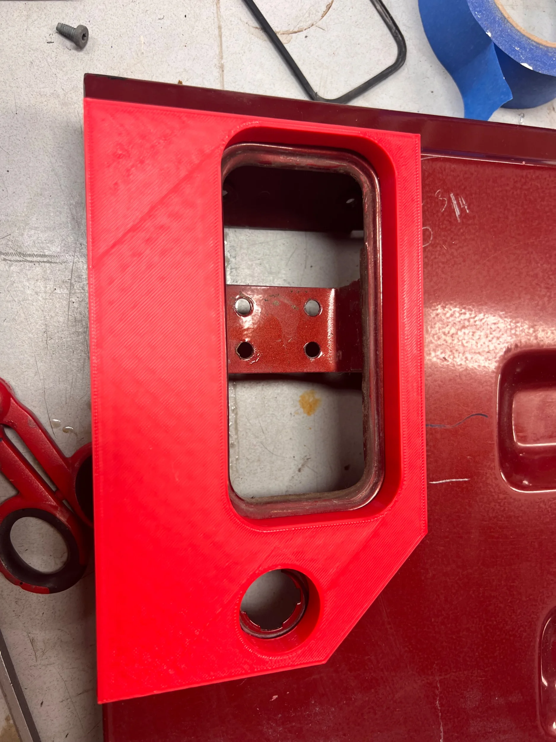

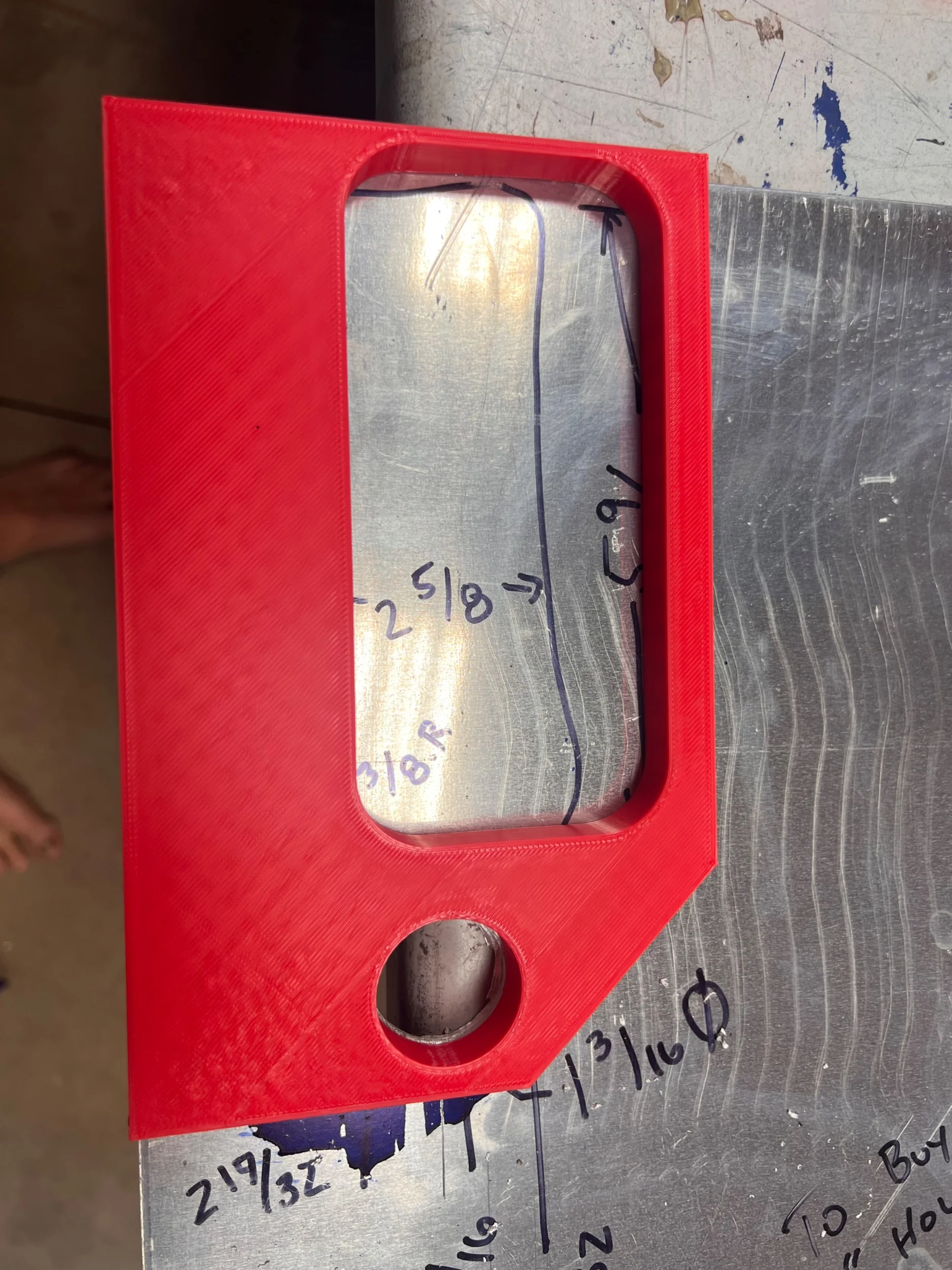

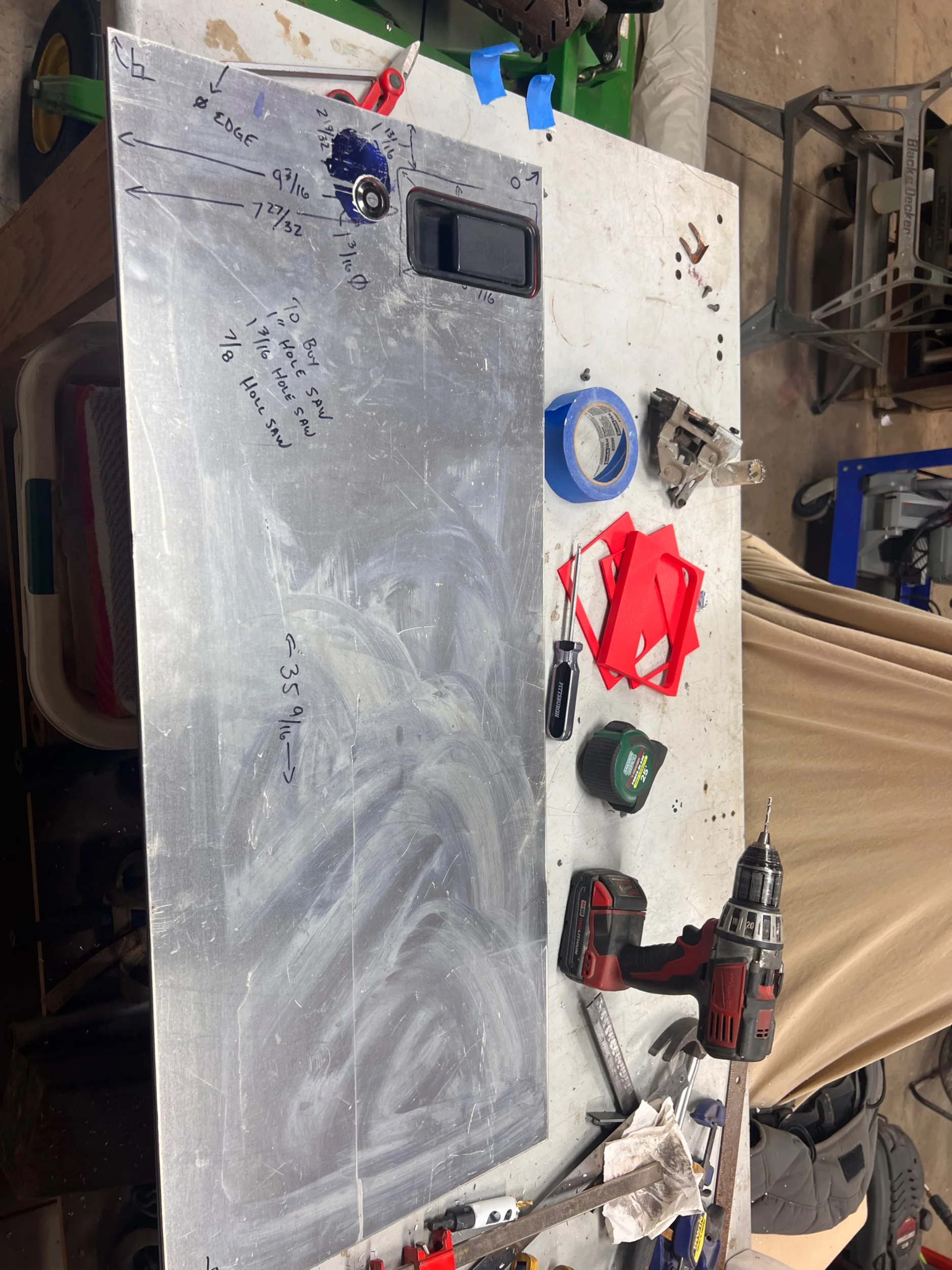

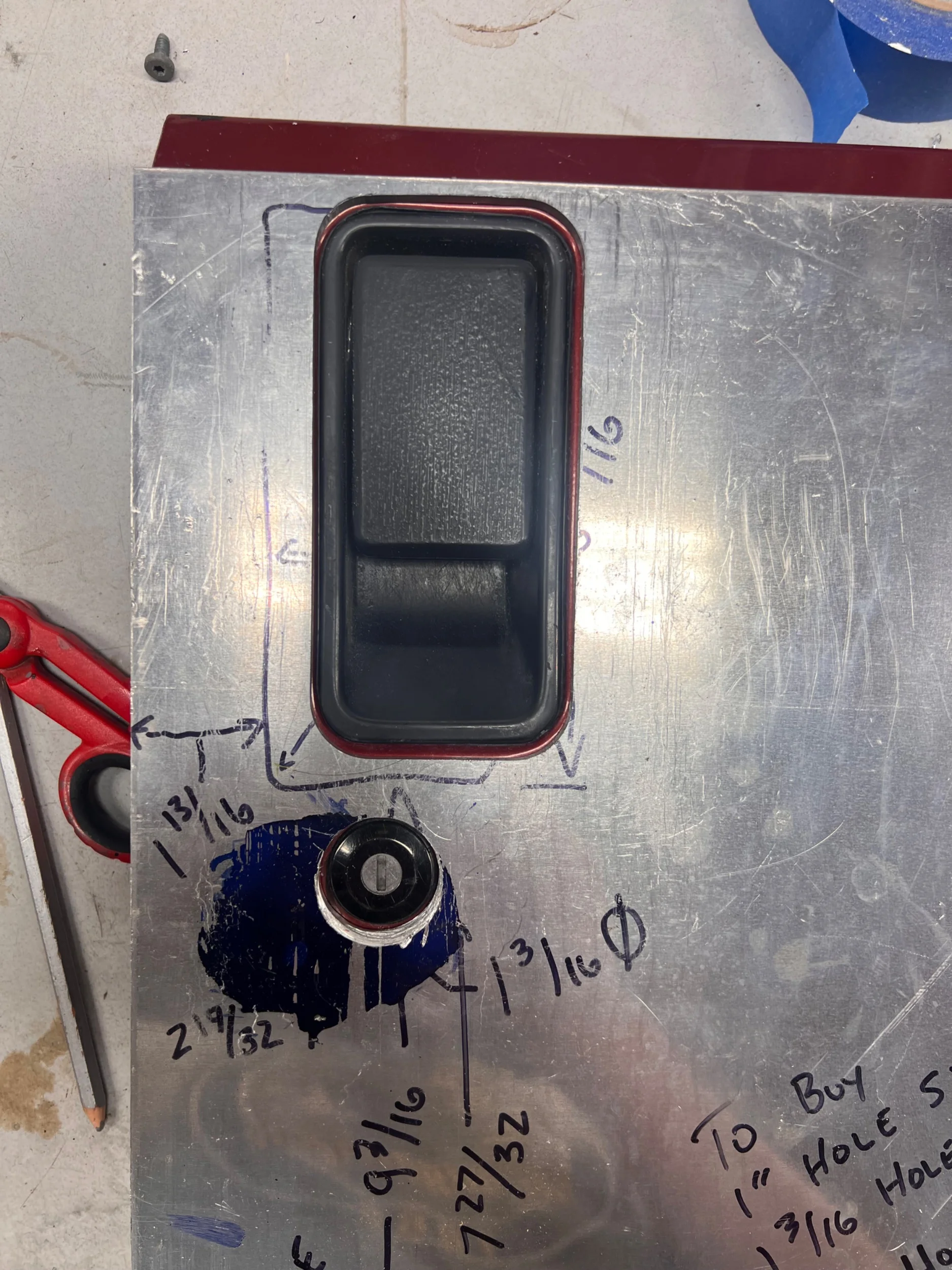

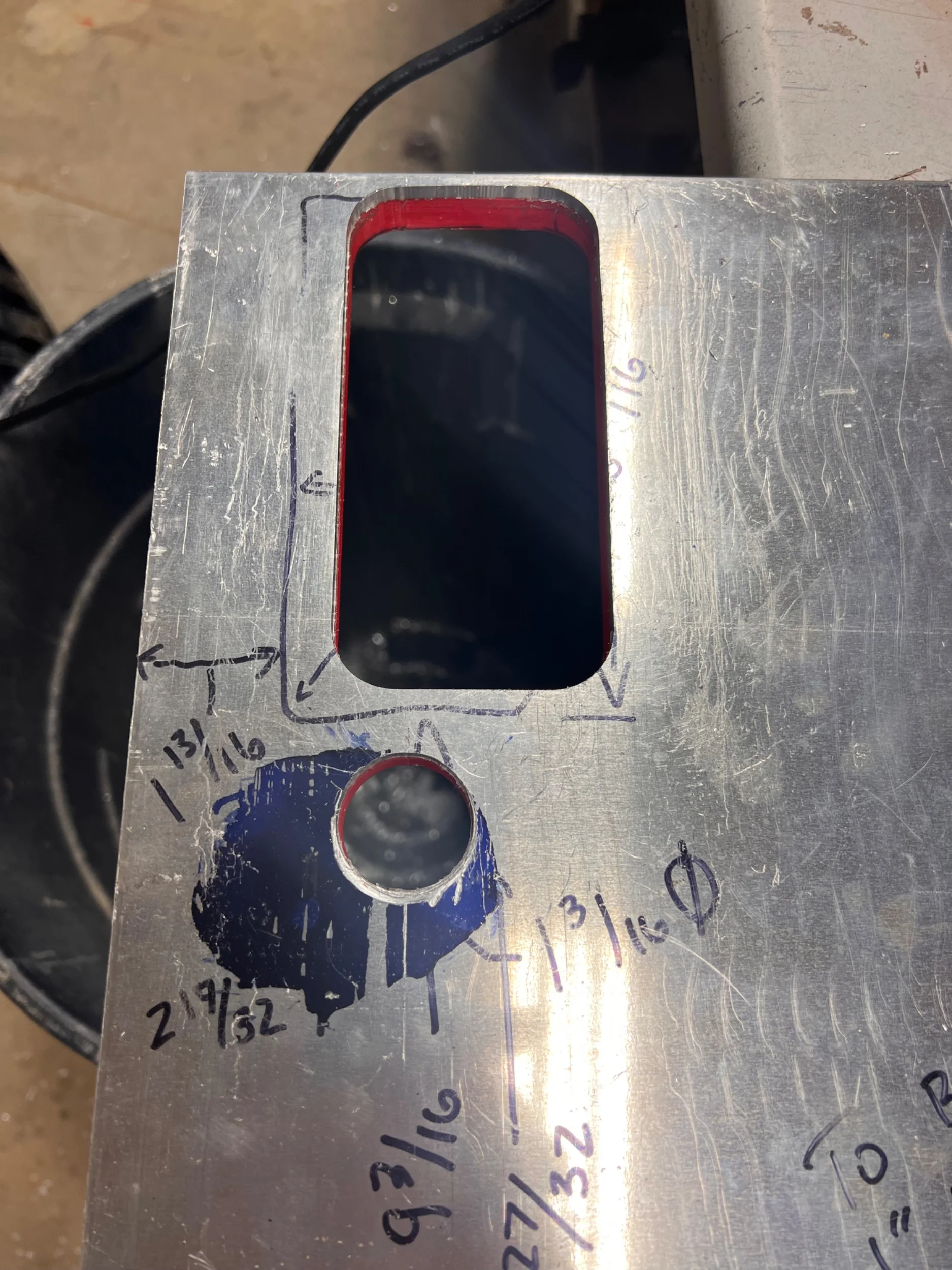

Another little project I’ve been picking away at here and there is tailgate armor. I’ve had the aluminum for a bit now and been ciphering a way to make the openings clean. I’m not great with the hand tools, and the shop is too busy for me to interrupt with a little personal project like this. I settled on using my 3d printer to make a template that I can follow with a patterning bit in my router. Took a few tries to get the radio and locations correct, but it’s a LOT cheaper to print this template multiple times vs making 5 or 6 tailgate panels, lol.
I made a “zero” corner and lined everything up off that.
Next step is to cut an undersize opening close to the correct position, then use my router and pattern to true up the edge. Then I’ll size the aluminum on my table saw (or maybe use the router again) and drill for mounting screws.

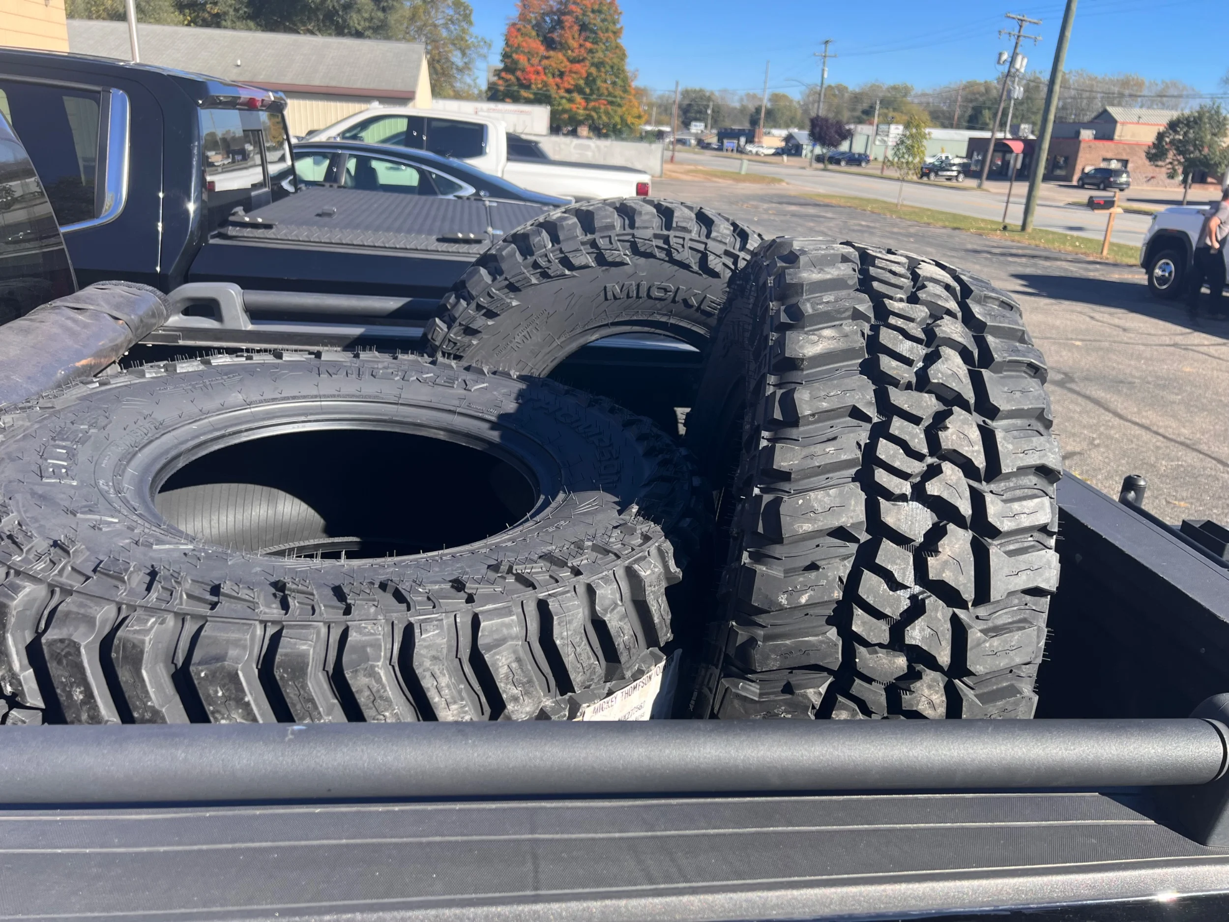

Oh! Tires showed up today too!
I made a “zero” corner and lined everything up off that. View attachment 564365View attachment 564366View attachment 564367
Oh! Tires showed up today too!View attachment 564368

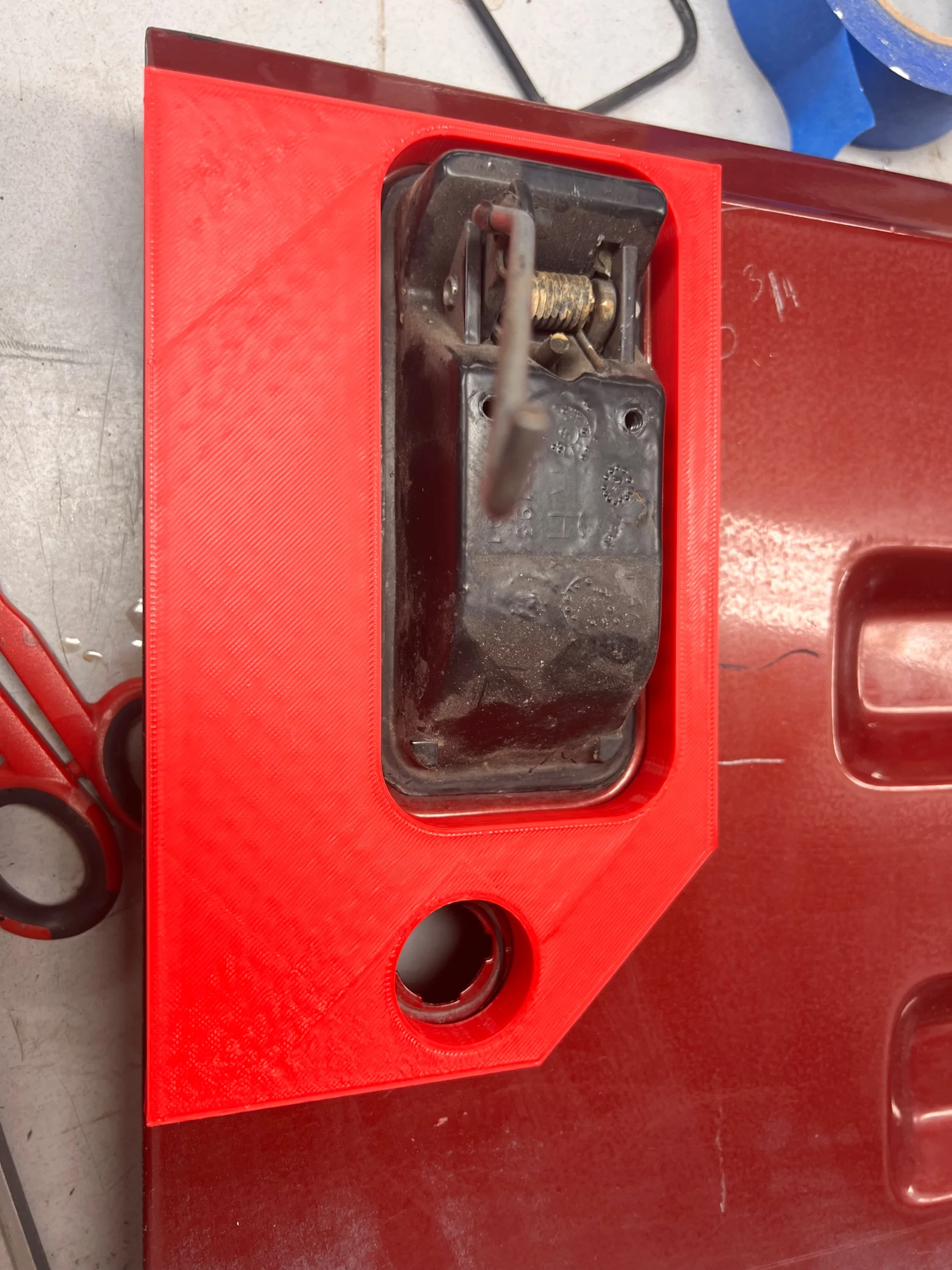

Had to try the template, and I think it worked pretty well. My initial hole for the lock cylinder was just ever so slightly off and scuffed the lower edge of the hole, which sucks, but overall it’s pretty good. I’ll throw a small round over or chamfer on the edges and it will disappear.
