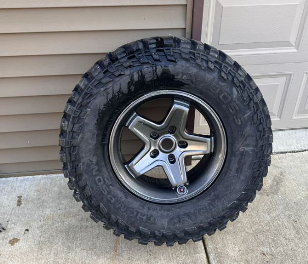

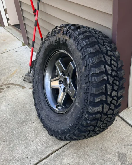

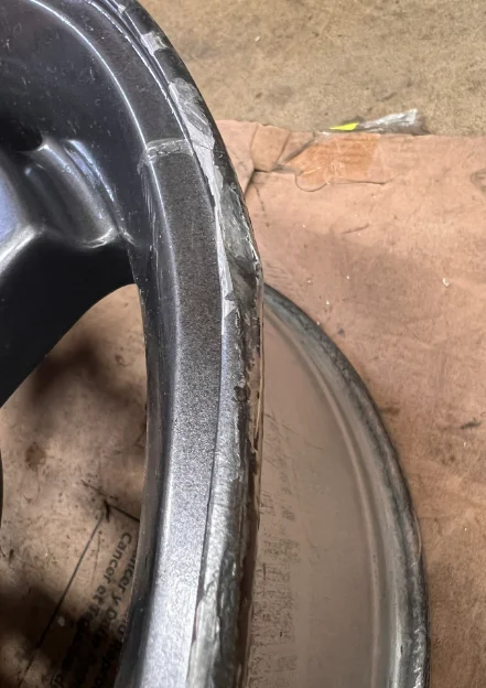

Started installing Tires this weekend. Doing it myself, since I want to make sure the beads get cleaned (they are a mess) and I have to rotate wheels and tires around so I have my best wheels in my new tires, and the worst of the generals on as a spare. Didn't feel like explaining that 12 times to a tire shop...so here we are. The first one was pretty hard...but I got it done. Second one took me about an hour to removed from the Jeep, Dismount the old tire vaccum out balance beads, remount the new tires, pour in balance beads and install on the Jeep. I got a LOT quicker.
However, I found some concerning wear on the drinker's side front tire. The Outside of the tire is worn quite a bit more than the inside is. I also found a bad unit bearing. May be related...maybe not. The plan right now is to get the unit bearing fixed and take it to an alignment shop for some measurements. More to come on that. Tires LOOK really good though, LOL.
What do you get with a good quality level vertical on the wms?assuming your toe is in spec and the wheel straight?You should be able to see if the axle is bent.
Are those aev wheels? They look good.
Yes to AEV wheels. Haven’t pull the front end apart to really do any investigation yet.

Finished up mounting my new tires today. Its not a terrible job, little bit of a fight, but its not difficult. I may invest in a manual changer, or convince a couple buddies to throw in with me for a used powered machine. Doing it myself let me clean up the bead seating surface in my wheels really well. I also found some damage on one of my wheels, now rotated into my Spare.

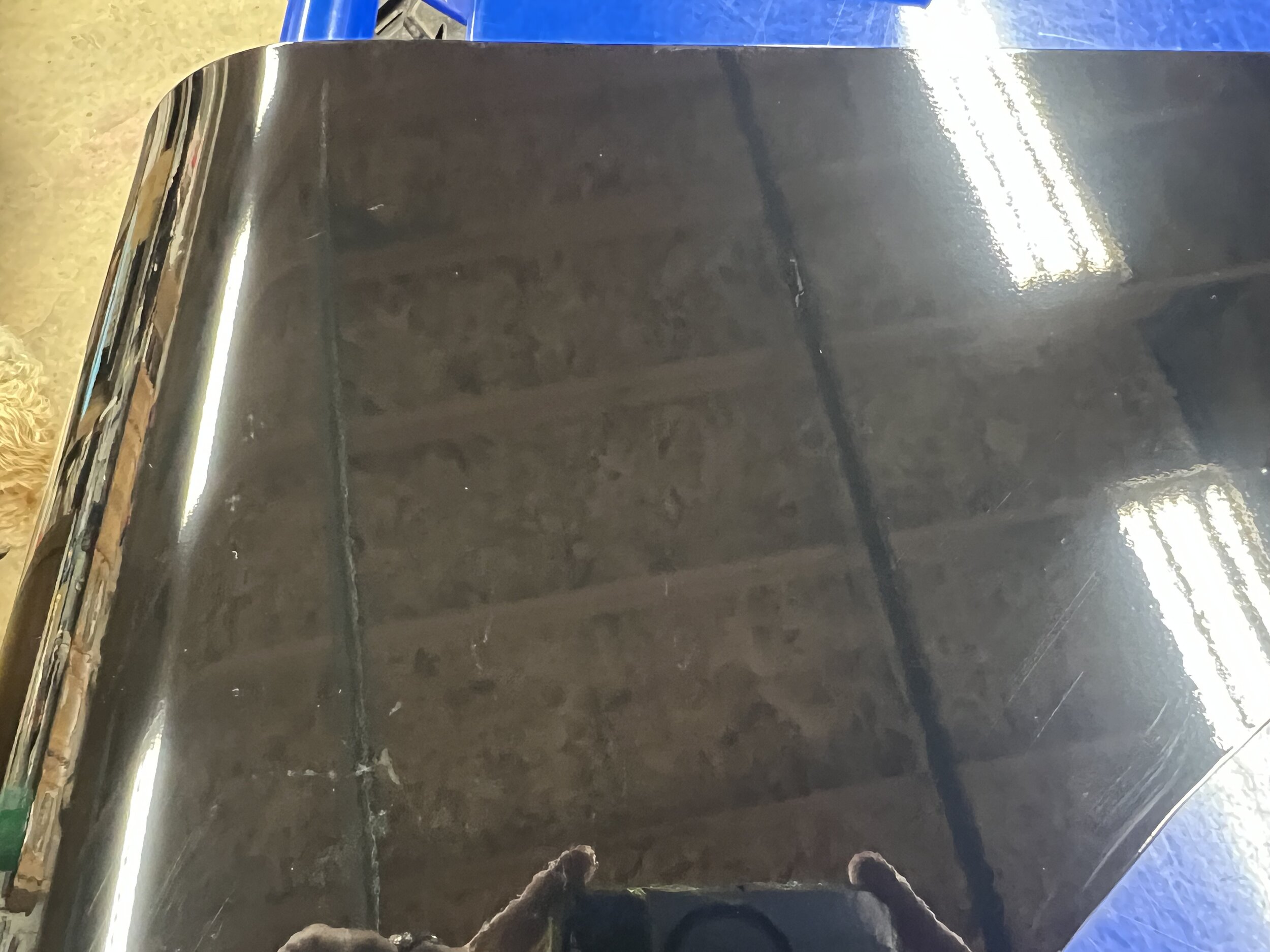

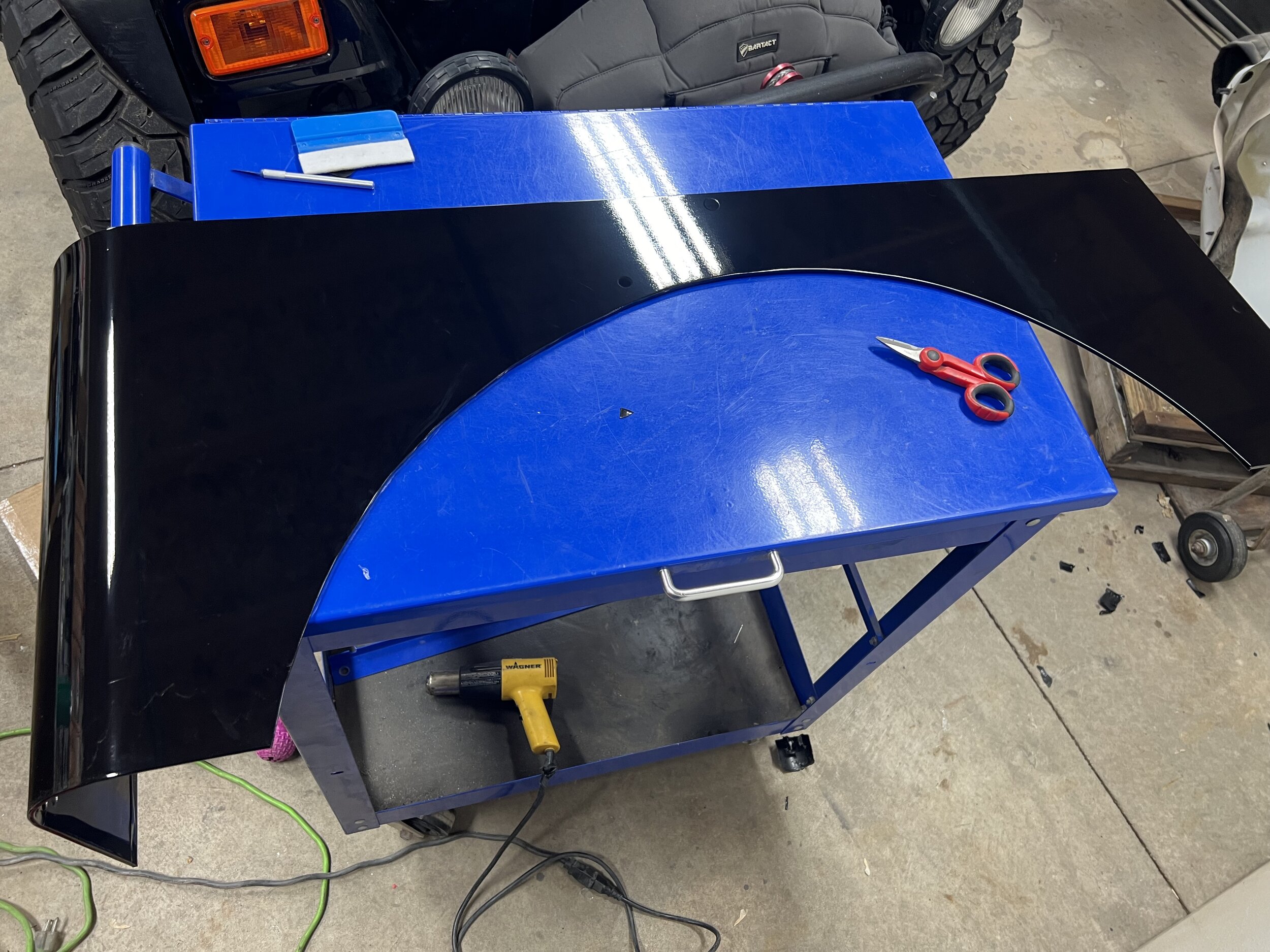

I wrapped my armor tonight. I don’t know if I’d do the whole vehicle with a wrap, but it was very satisfying and easy to get a nice, shiny surface on my new armor.
Mike, this looks great!
What wrap did you use for this? Did you choose one specifically that's more resistant to scratches? How has it held up thru the few trips it's seen?
When you installed the fasteners, did that try to twist or peel the wrap that was under or near the fastener head? Any tips in this department?

I used some Vivid stuff on Amazon. Nothing specific for toughness, more because it was cheap and offered in the sizes I needed.
https://www.amazon.com/gp/product/B09H3L7FLL/?tag=wranglerorg-20
Its holding up pretty well...A couple scratches but not terrible. I did have a couple "twist bubbles" under my screw heads. I tried to minimize them by cutting the majority of the film away from the countersink. There are a couple small wrinkles...but you have to look REALLY closely to see them.
I did end up sanding and priming the aluminum, just to keep it from oxidizing under the film and causing the film to loose adhesion to the armor. So Far, So Good.

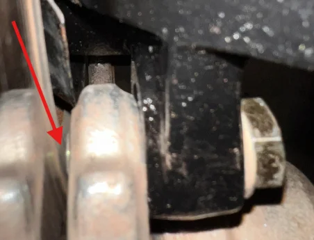

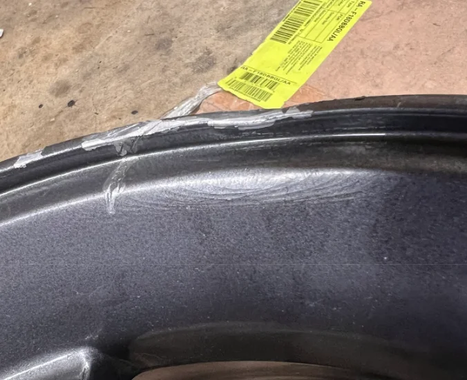

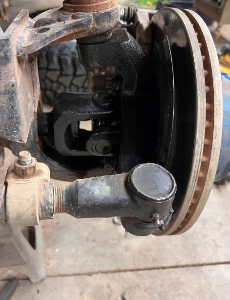

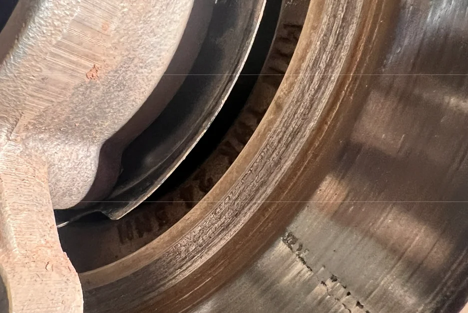

Finally got some time this weekend to work on the Jeep again. I had the front end completely torn apart this time. Good news is I found the source of my rubbing/scratching sound. The bad news is that it was because I was dumb and didn't pay attention to how my brakes were going together...
When I changed my wheel bearings, obviously you need to pull the brakes. Since I have the BBK from Black Magic, that means you pull a caliper AND a saddle to get the rotor off. Well, when I put it back together, I forgot one of the parts of the instructions, and that is to pay attention to the saddle bolts and make sure they don't poke through too far and touch the rotor. When I installed the kit the first time, I put two washer on one of the bolts to prevent that. I remember it being on the bottom. This time, I put it on the top...Because I forgot about the possibility of bolt rub and just thought I doubled them up because I was out of the "thicker" washers that were on the other bolt. Sometimes, I do that when the washer has to bridge a bigger than standard opening (like on the 15/16 brake kit with the figure 8 shaped hole).
It was immediately apparent what was wrong when I pulled it apart. No harm, no foul, since those heavy grooves are outside the swept area of the pads. I had put the doubled up washer on the top bolt, and the bottom bolt was poked through too far and rubbing on the caliper.
I also took the opportunity to fix a couple other niggling little things up front and make one pretty big upgrade.

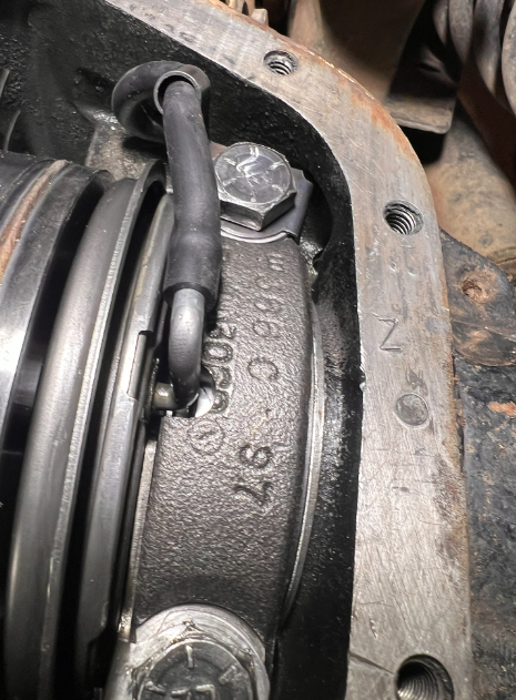

The first was my front locker. Its been a bit finicky to engage since I installed gears. I've checked a LOT of things that I thought might weaken the engagement of the plates, to no avail. Talking with a few others, I've gotten it narrowed down to either worn locking plates (which is basically a death sentence for the factory locker) or possibly low preload in the housing...apparently they can flex? So, since the other option is pull the carrier and replace it with an ARB, I thought I would increase the preload a bit. I borrowed a case spreader and added 0.005" a side to the carrier bearing preload. Directionally, I believe this is correct, since I was able to remove the Diff by hand. It didn't fall out, but it wasn't really tight in there either. I also noticed that I was getting just a tiny amount of leakage from the factory air tube. Only when I touched it, which tells me the original, 20 year old rubber line was starting to lose compliance. I replaced that as well with some 5/32 vacuum line I have. Finally, I looked at the routing of that line, and where the factory clamp goes.
Its very close to the plate that shifts over to engage the locker. In fact, if the clamp is not aligned correctly, I believe it may cause the airline to drag on the plate, slowing down the system.
I also rewired my locker sensor. I noticed that was torn apart a while ago. It got smashed under some articulation last time I was at an offroad part. I went through my stash of parts and found some new connector bodies, spliced in some new wire, and Viola!, my dash light works again. No pics and totally unnecessary, but I wanted to fix it.

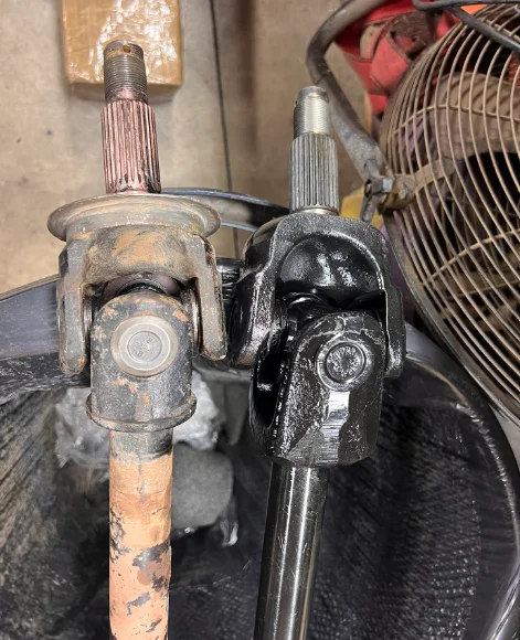

And, for the upgrade...I got my hands on a set of Revolution Big joint axle shafts. I had some Chromoly shafts up front from G2, but I had already broken one of them (when my Diff seized) and the pass side splines fit like garbage on the unit bearing. Here is a 1350 joint axle shaft next to the Factory 5-760x joint size axle
In order to install them, I had to shorten the passenger side axle by about an 1/8" (I guess this is pretty common?) and I turned the heads of the three bolts that hold the unit bearings down from about 1.100" to 0.75." Otherwise the flange of the bolt interferes with the Yokes on the axle.
Its all back together again, with a fresh coat of black paint on most everything outside the inner C's.
I even have clearance from the saddle bolts to the rotor!

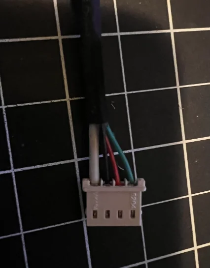

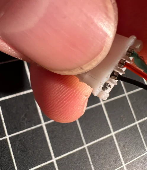

Another little TLC project complete. I have a Soundstream Picasso Nano 4.1 Amp in the Jeep, mounted under the steering column. Its not the best amp in the world, but its a compact lil thing and it sounds good enough for me, in the Jeep. Since its so compact, Soundstream used little Molex connectors for the RCA connectors, the Remote Turn on, and the remote bass control knob. A shortly after I installed it, the locking tab on the connector to the remote knob broke. SInce the remote knob is mounted to a pretty square box, I was able to just use a piece of electrical tape to secure the wire. Well, at the beginning of this year, the remote turn on wire broke off the little molex connector, right at the terminal. I pulled the terminal out and soldered the wire back on. On my last big trip in the Jeep...the remote turn on wire broke again. Lots of vibration and a solder joint didn't mix.
This time, I decide to fix it correctly. I scoured the 'net for a replacement harness. Doesn't exist. Soundstream doesn't offer it, not on ebay, etc. I have a bit of experience with electrical terminals and how to find them, and what I lack in experience (a lot!) I make up for in sheer obstinance. I found a number on the connector body that plugs into the amp (5264) and started hunting Google with that. I found out that its a Molex mini-SPOX series. Once I got that, I was able to search out the part number on Molex, come up with the proper terminals and build my shopping list. Got the parts at Mouser.com Its like McMaster Carr for electrical stuff. They are a little on the expensive side, but you can buy in "eachs" instead of 1000 pieces rolls, like a lot of terminals are sold and they have almost everything.
If you have one of these amps, the connector body is a Molex 50-37-5043 and the terminals for 22-28 AWG wire is Molex 08-70-1040. The remote bass adjust side is a pretty simple RJ12 connector (which are available anywhere). You'll also need open barrel terminal crimping pliers for the molex stuff (I used a universal set that I picked up a while ago for weatherpacks) and another special set of crimping pliers for the RJ12 connector body.
Anyway, I rebuilt the harness this afternoon but not before it got to dark to work on the Jeep. Pics of the finished product. I added a piece of heatshrink to reinforce the connection too.
