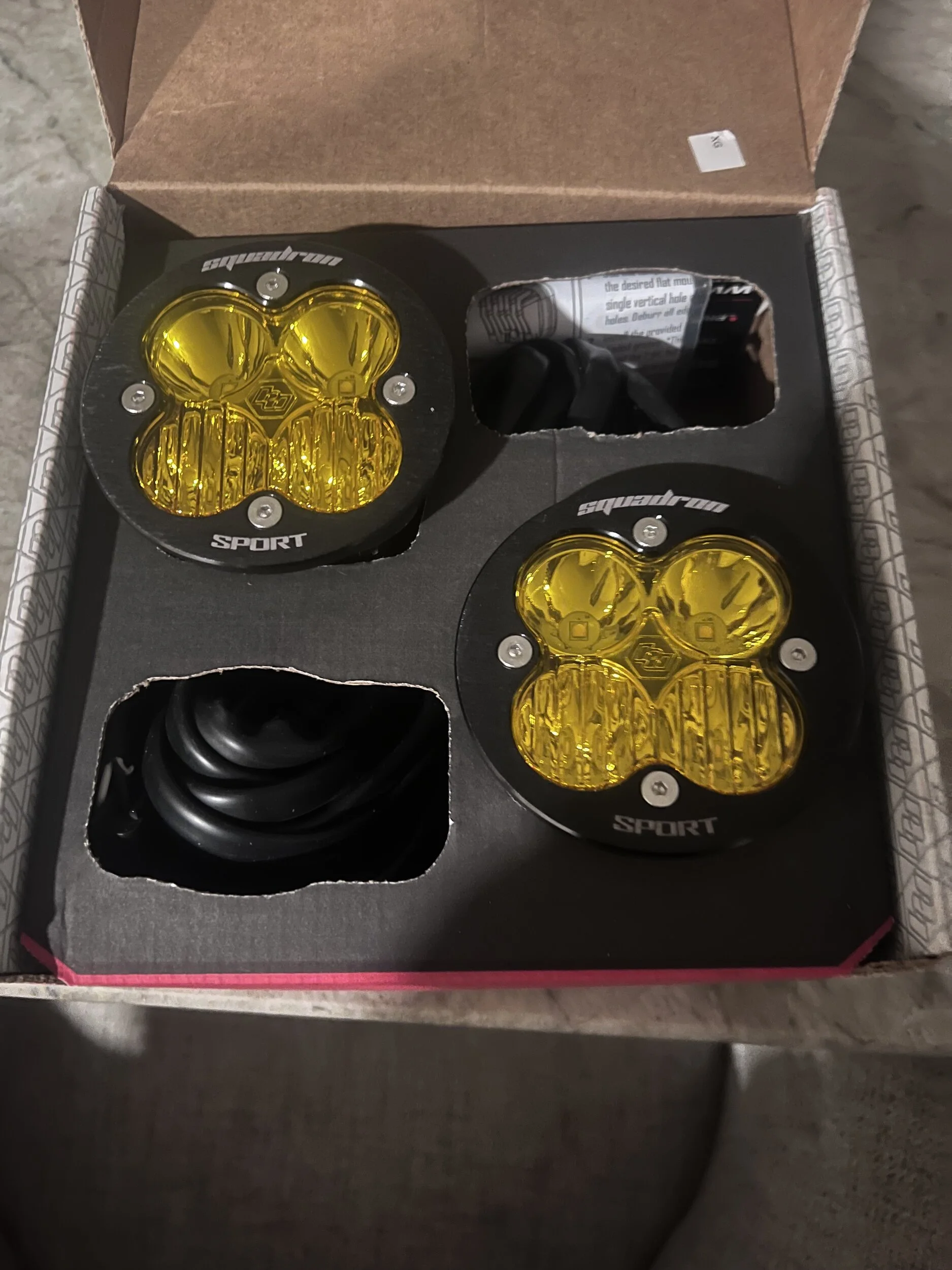

Yours truly managed to snag a set of Baja design squadron sports. Amber lens with the combo LEDs. I was kinda late getting my ticket called, but they were still there. For some reason, I don’t think people knew what they were, tho I did get a couple side eyes from the folks that did, lol.

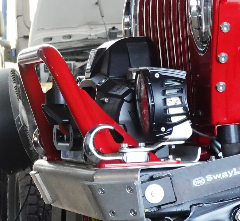

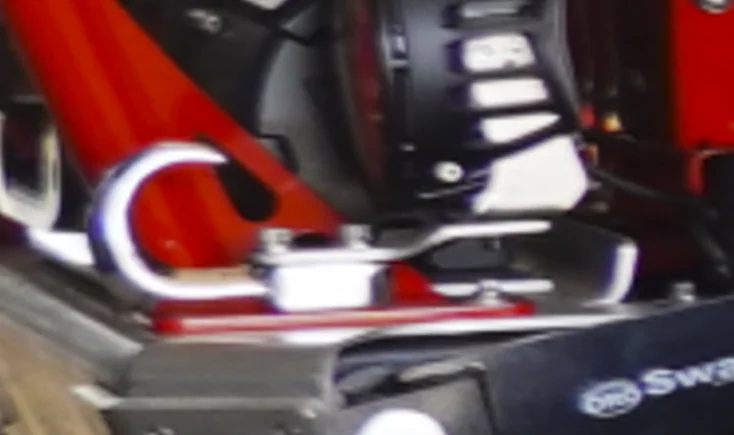

Couple weeks ago, I noticed a crack in one of my fog light mounting brackets. I made these a couple years ago, trying to copy Savvy's design, but using material I had on hand. The material wasn't thick enough, and the fog light bouncing around on it fatigued the steel and caused a break.
I saw a picture of a build that @mrblaine did and he made a very simple aluminum mount for fog lights. I thought maybe I should copy that one instead...So I found some aluminum plate in my box of scrap metal and go to work.
This is the inspiration.

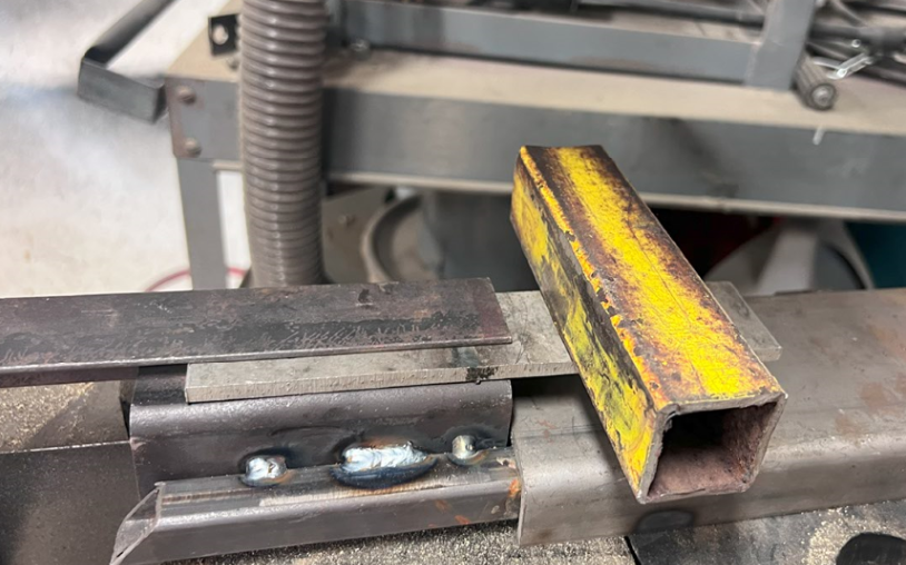

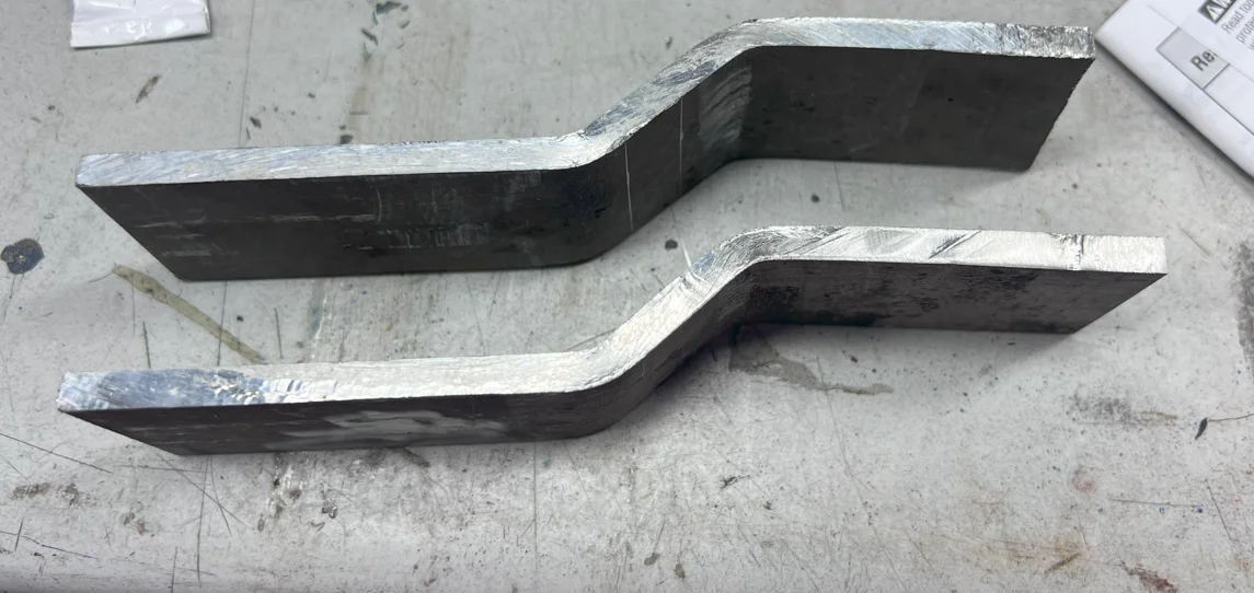

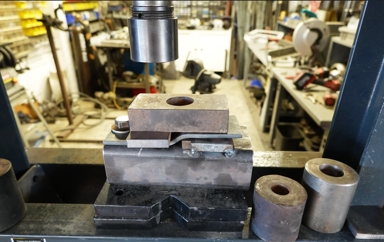

I kludged together a bend fixture...

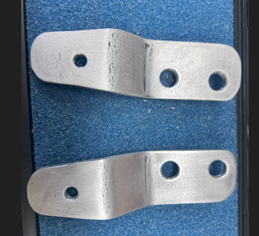

And I bent up some 1-3/4" wide strips of 6061.
Did some shaping and some sanding. I need to do some hand sanding still, this was just a quick hit with 150 grit on my palm sander. I'll get the bends cleaned up, then "brush" the finish with a scotch brite pad. And yes, I know the bumper bolt holes are off center...Needed to bias it one direction for clearance to the bull bar.
For now, I'm still running the factory fogs with yellow bulbs. Eventually, I'll probably round out my lighting with another set of Squadrons up front.

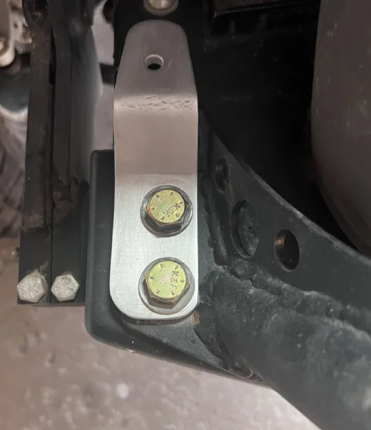

I found that pic I said I'd look for. I mocked them up in mild steel first before I did the final out of stainless.
I didn't have the front to back space that the longer offset on 6061 bends needed.
Nice fab work, Mike.
Finally had some time and energy to do a little (very little) work on the Jeep tonight. We launched a new ERP at work Aug 1 and for the last 6 months its been kicking my butt, especially for the last 6 weeks. Its mostly up and running now, but there are still lots of questions, and being the head of the project, they all come to me for triage.

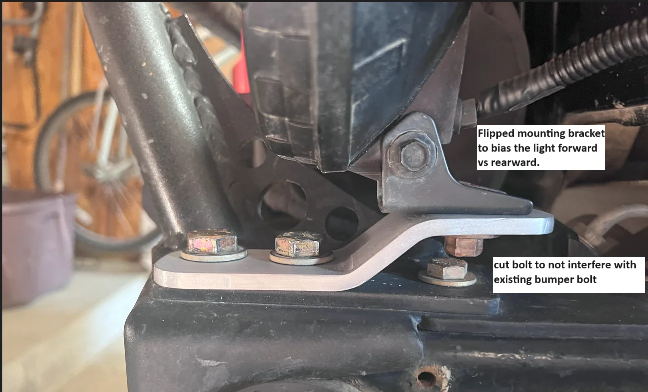

Anyway, I finished up the new fog light mounts. As per usual, I got excited and started working before I really understood my design envelope, so I had to do some modification. Nothing major, just cutting a couple bolts down for length and flipping a couple brackets around to make the lights fit forward enough to not crash into my fenders.
Some pictures...
Installed with the bumper bolts. I should probably go get some a bit longer, since now I'm going through a 1/4" of aluminum and two 3/16" pieces of steel.
And here are the mods...
And the end result (also shows I need to wash my Jeep!)
Overall, I'm pretty happy with how this little project turned out. We'll see if the aluminum lasts. You can see some crazing or cracks in the bends in my first picture. I'll probably look for a couple pieces of scrap stainless to re-create them in the future...but for now, they will work. This ain't California, after all!

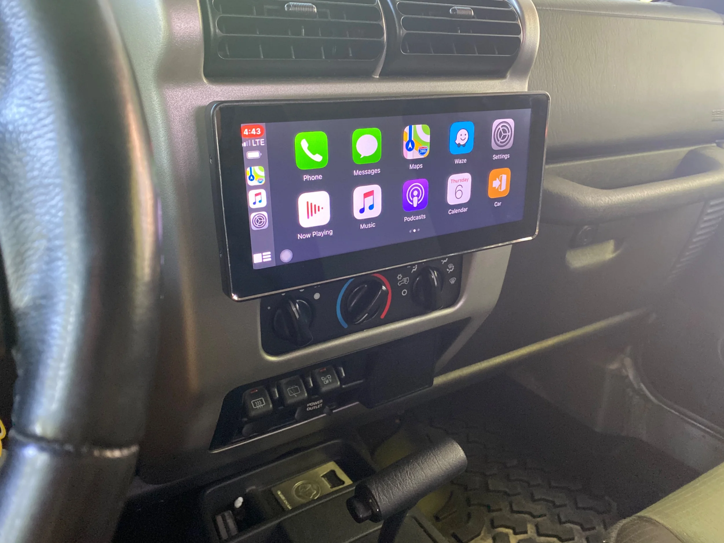

Another little project completed. This one was a little bigger than making a couple brackets for auxiliary lights. I've had my eye on an Android Radio for a while. Having Nav available in dash, while I use my phone for other things is appealing to me. Another reason for the change was when I changed to GMRS, I pulled my CB stuff out. It didn't work that well and was kinda in the way. I also pulled the XM radio antenna, since screw them. I had a lot of "extra" crap in the cockpit that needed to come out. I picked up a Joying Radio from @MikeE024 a couple months ago and finally had the time and energy to do the install. Along with the new head unit, I bought a new phone mount from BulletPoint.

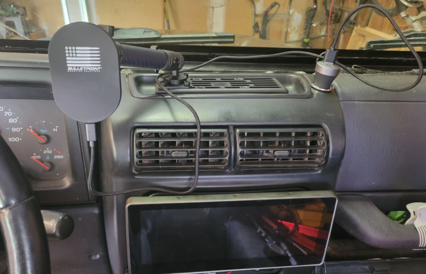

So, Out with the old Kenwood head unit. It was a decent media player, but the buttons were SO small. The Joying was pretty easy to install, its all standard car stereo stuff. Couple differences are it has a LOT more connections in the back vs the Kenwood. Make sure you include a USB cable in the Special USB port (OTG)... It also only has a single channel sub output, vs the dual channel that my Kenwood had. No biggie, a 6 dollar adapter from AutoZone made it all play nice.

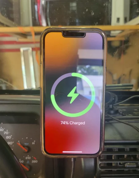

A couple other things of note. I bought the magsafe mount/charger from bullet point and I can't stand having cables run all over my car. So, I installed a 12V power outlet right up top on the center stack. This is wired into the 12V power port in the lower dash. Its always hot, so I can charge while my Jeep is off. Was a little bit of a hassle to get in...Had to heat up the vent supports and bend a little bit of clearance into it to make room for the body of the adapter.
And with the Joying mounted up and turned on...Wireless Car play is such a nice feature...I don't even have that in my Daily, which is a 2017!

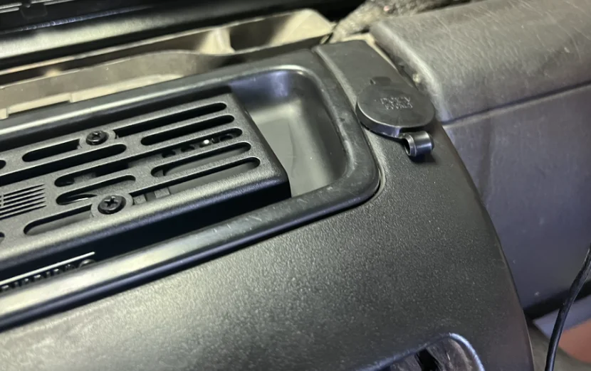

Got the Bulletpoint setup installed too...
That is just the cord that comes with the mount. I'll get something much shorter, and get a power adapter that is more flush to clean up that mess.
But...Wireless Charging! Just slap it up there and it stays put. no clamps, arms, spring loaded anything to deal with.

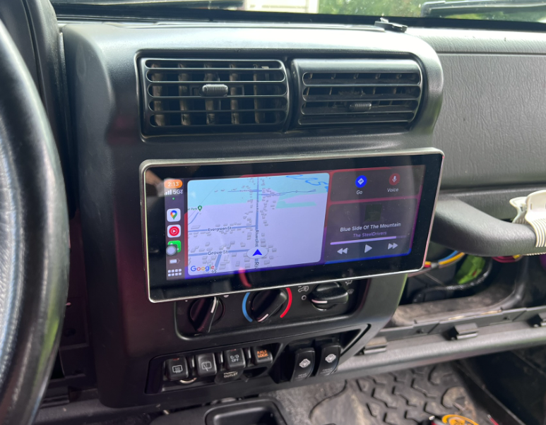

OK...So how does the Joying work? Its actually pretty nice so far. When I first turned it on, I was a little disappointed with the bass output. Like so many others, I have a Soundstream Picasso nano 5 channel amp to drive (4) 5-1/4 speakers and that 6-7/8 or so Kicker sub in the center console. A few messages back and forth with @MikeE024 to make sure I wasn't missing anything (lots of after sales service, Thanks Mike!), and it just was kinda flat. I had it sounding decent, but not great and not nearly the amount of bass I was used to.
I decided to look into a firmware update and Joying had one. They install through USB though...and I didn't include that. So, I had to pull the radio back out, to put the USB extension wire back in (to the wrong port). Back and forth we go, and I finally got the USB extension into the correct port on the back of the radio and it found the update. Finished installation and it transformed the radio. The update included a new EQ app and better control over the low level outputs. The bump is back, baby! 🤣 Speaking of the EQ, the built in cross-overs are pretty good. I was able to dial it in far more easily than I could the Kenwood and keep the right frequencies going to the right speakers. Its crispy clean sounding now.
The only negative with something like this is that it blocks the view of the HVAC controls. Not manipulation, but just line of sight for me. There is room behind the radio, and the faceplate is real close to being able to fit flush to the center bezel. I might have to get creative with my 3d Printer...but that is another project for another time. It also doesn't have any physical buttons, but Mike included a wireless controller that uses self adhesive tape to control output, so I'm using that. It would also work with Steering wheel controls, so that is another possible project, if I get a Grand Cherokee wheel and the multiplexer.
I don’t know about the Joying. I’ve looked at it, but never gotten over the receiver not being “in dash.” I keep thinking about a DDin receiver, but can’t find any I like that aren’t $1200+.
I’m happy with my phone mount, and it’s similarly placed. I have 2” of charging cord hanging out the dash to plug the phone in, but MagSafe would be nice too. Nice work. Glad you found the Joying update. Definitely worth restoring the “bump.”
I’m happy with my phone mount, and it’s similarly placed. I have 2” of charging cord hanging out the dash to plug the phone in, but MagSafe would be nice too. Nice work. Glad you found the Joyong update. Definitely worth restoring the “bump.”
Joying makes a double din as well. I think they are about 500 bucks

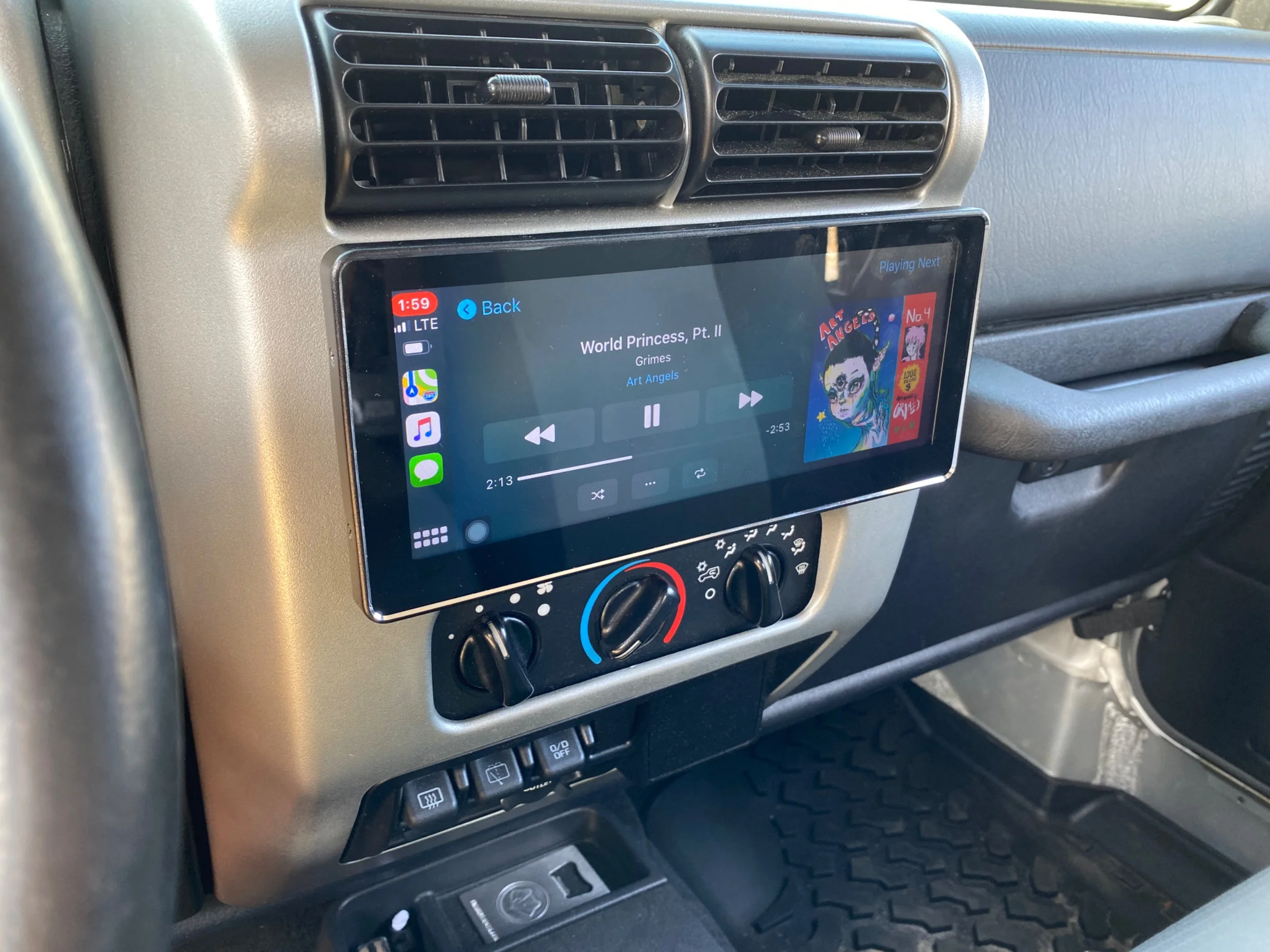

Looks great.

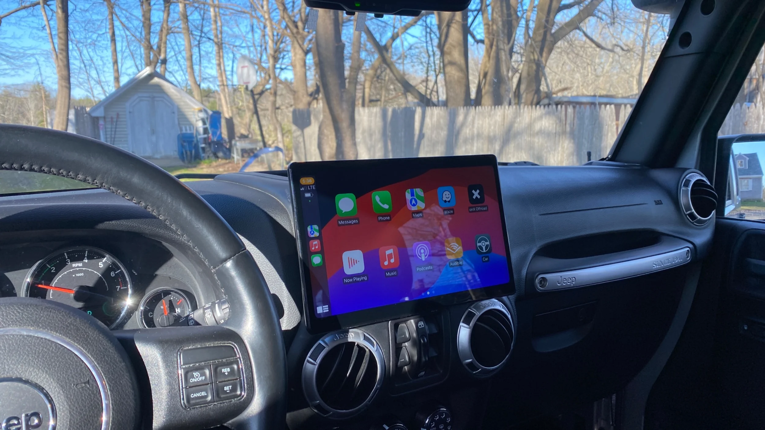

Have you adjusted the clips on the back of the screen as far down as possible? You just need a small Philips head screw driver. When I ran that one I was able to shift the screen up to just clear below the vents but just above the line of sight on the HVAC controls.
Before:
After:
I’m running their 11.3” in my JKU. I had to do the same adjustment of the clips on the back to move the screen up above the vents. But I really like the Joying stuff… It’s hard to find the level of quality they have for the price in a lot of the other manufacturers.
Before:
After:
I’ll take a look. I had to order a new set of clips anyway…some ham fisted hammer mechanic got all jiggy with it and broke a couple, lol.

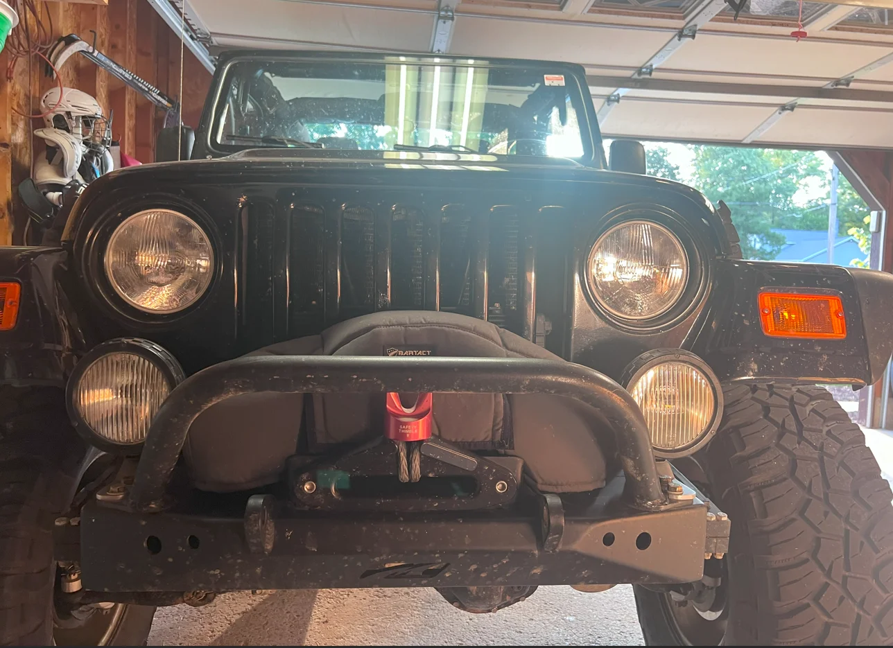

Just got back home after a week long trip that ended up being a LOT more camping than I thought it would. Living out of a wrangler for a week is Tough Sledding. I'll do a regional write up on my trip to cover the "off-road" aspects of it, but thought I would add a couple pics here of my poor jeep and make a list of things than need addressing in the very near future. TL:DR...Being on dusty, rocky, washboarded dirt roads and paved roads that are rougher than that for a week and not having good shocks is HARD on stuff.
First, the nicest Pic of my Jeep that I took all week.

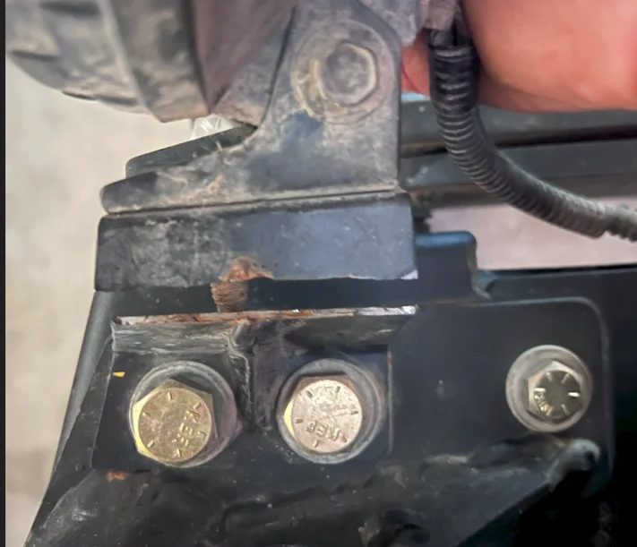

Seventh, I need to look at my grill body mount. I noticed yesterday that the Left front fender was moving along with the hood in time to the out of balance tire. Makes me think that the bolt might have backed out (not the first time) and my front end is kinda bouncing around.
