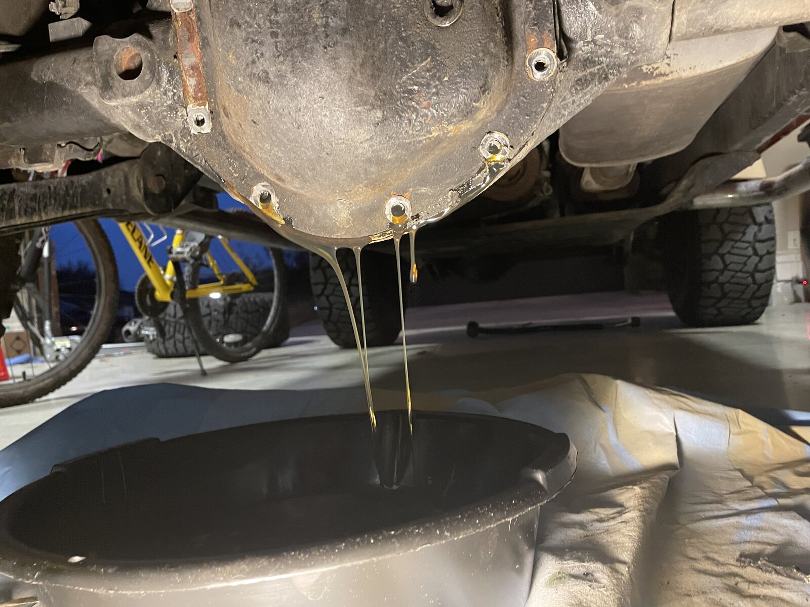

Also the gear oil was of indeterminate age, so I figured I could handle that.
I bought Mopar gear oil, with the LSD additive for the rear, and the Mopar silicone gasket. Probably the most expensive way, but again I'm going by the (FSM) book at least for my first go-round. There was quite a bit of silver glitter in the initial gush of oil though...
And no leaks at the end! Very gratifying.

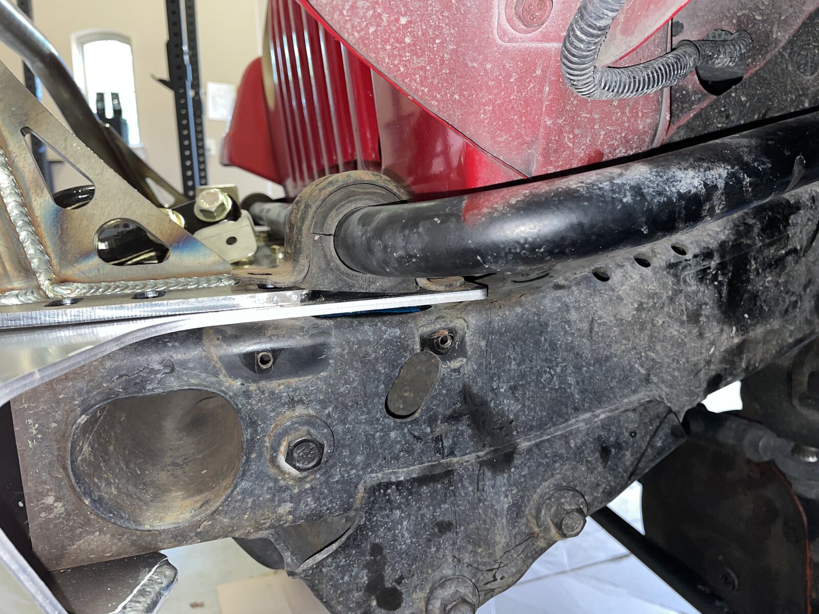

The front bumper was a different hassle. I must be the only one using the stock sway bar with the Savvy front bumper. Install was a breeze until I realized that the antisway bar bushing bracket was sitting 1/4" higher at its front bolt than the rear, since the front side was sitting on the 1/4" steel of the winch hoop.
It didn't seem like a good idea to leave the bushing unsupported like that, so I bought some steel plate at Lowe's and cut a rectangular piece to support the bushing and rear of the bracket.
Ahhh, all nice and flat and supported:
That aluminum and steel added 1/2" to the front of the sway bar and flattened the angle a bit. Should I lengthen the JKS disconnects a 1/2"? Nah...

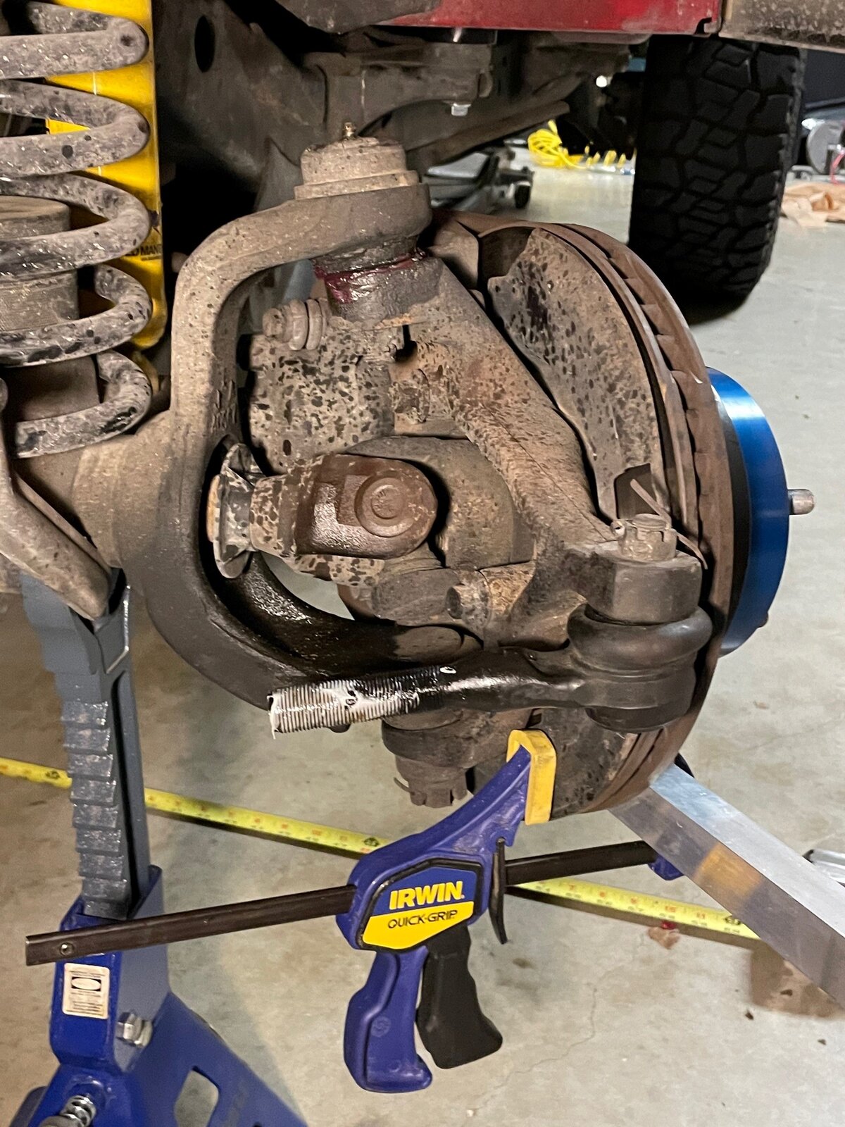

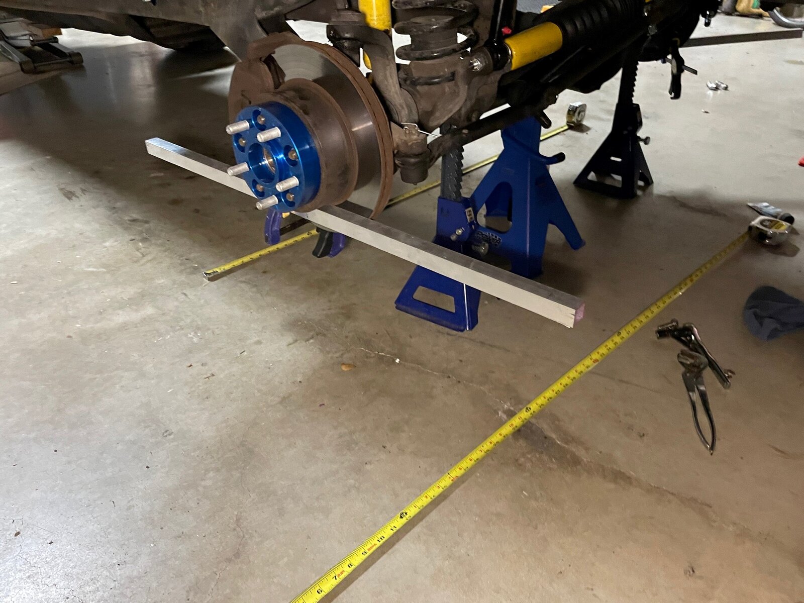

Since it seemed have a bit of wandering and maybe a touch of bump steer (and since my steering wheel was off 10 degrees), I figured I'd better recheck the toe-in alignment. I'd done that a couple months ago and haven't hit any curbs. I did some spend a little time on the rocks in a dry creek bed to test the sway bar disconnects.
In any case, the toe-in was measuring barely 1/16" at the 33" tire diameter, but I couldn't shorten the tie rod any further. It would loosen easily but was basically frozen when I tried to shorten it. So I removed the tie rod completely and did see some rust and debris in the threads. I blasted Liquid Wrench into both ends of the tie rod, then blew everything out with compressed air. A fair bit of junk came out and when I reinstalled the tie-rod (with a bit of anti-seize) I was able to get the appropriate length.
The DIY alignment thread by @Jerry Bransford is awesome and one of many I found highly useful.
https://wranglertjforum.com/threads/how-to-align-your-jeep-wrangler-tj.85/
The steering seems better and the wheel is straighter without having to adjust the drag link.
