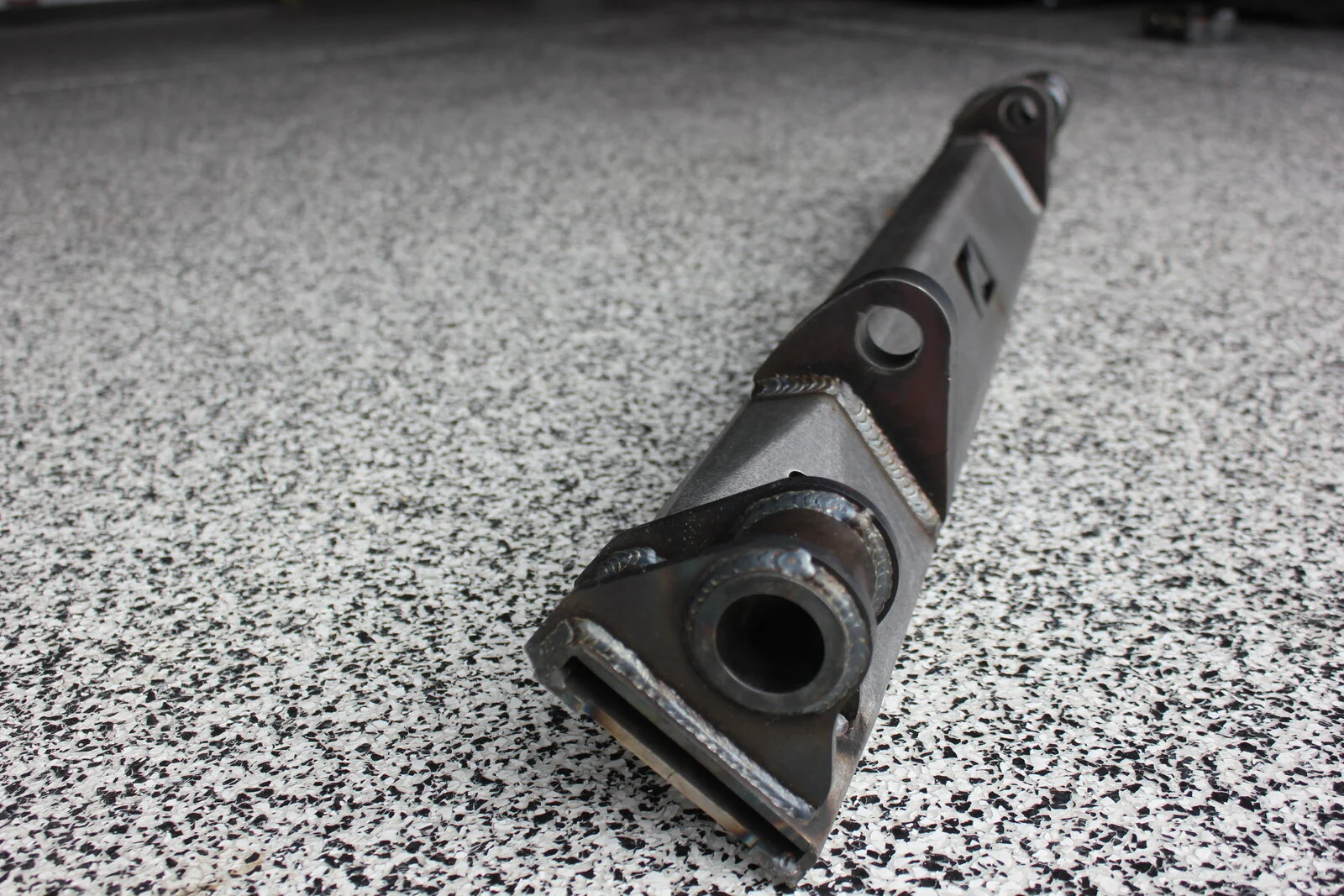

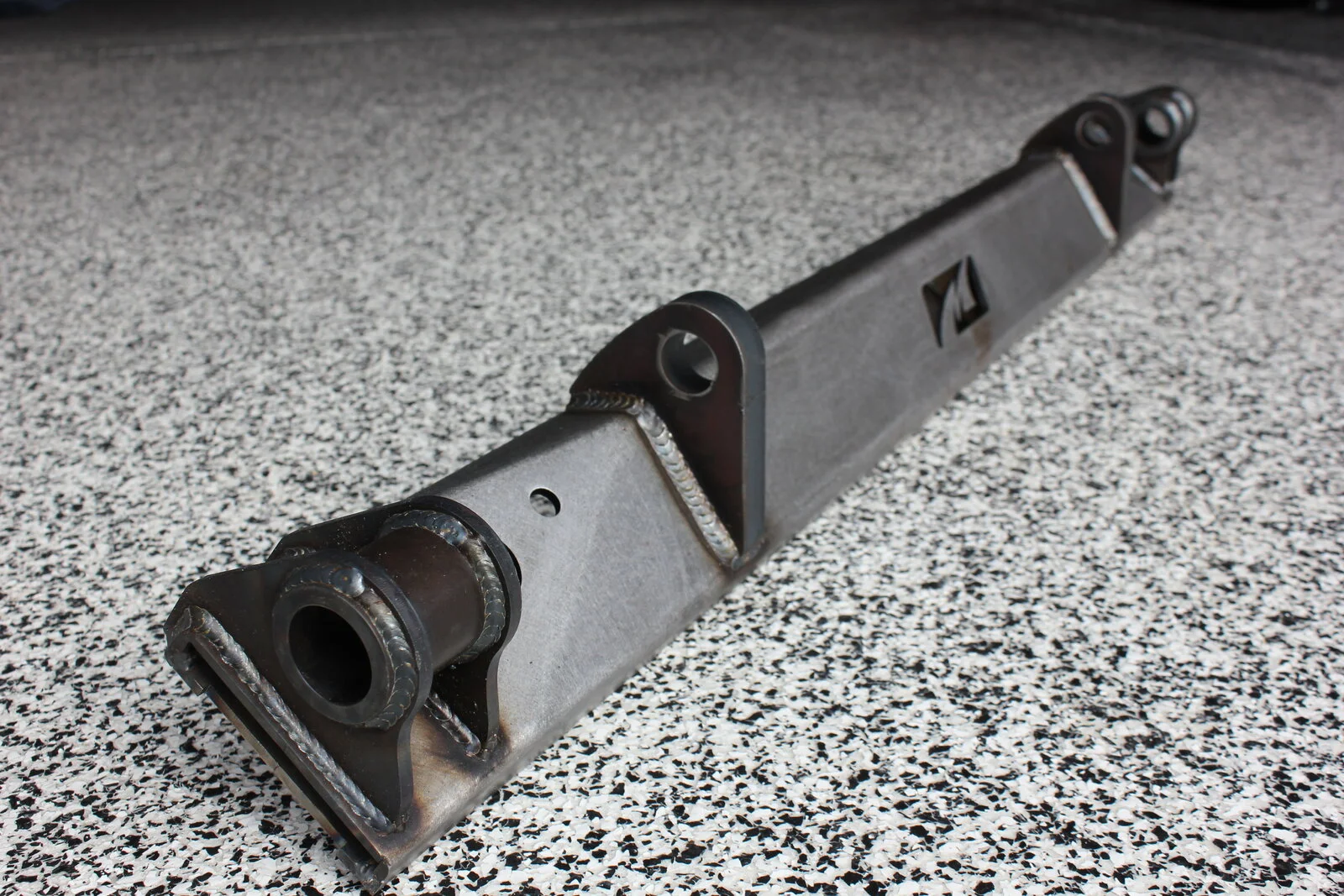

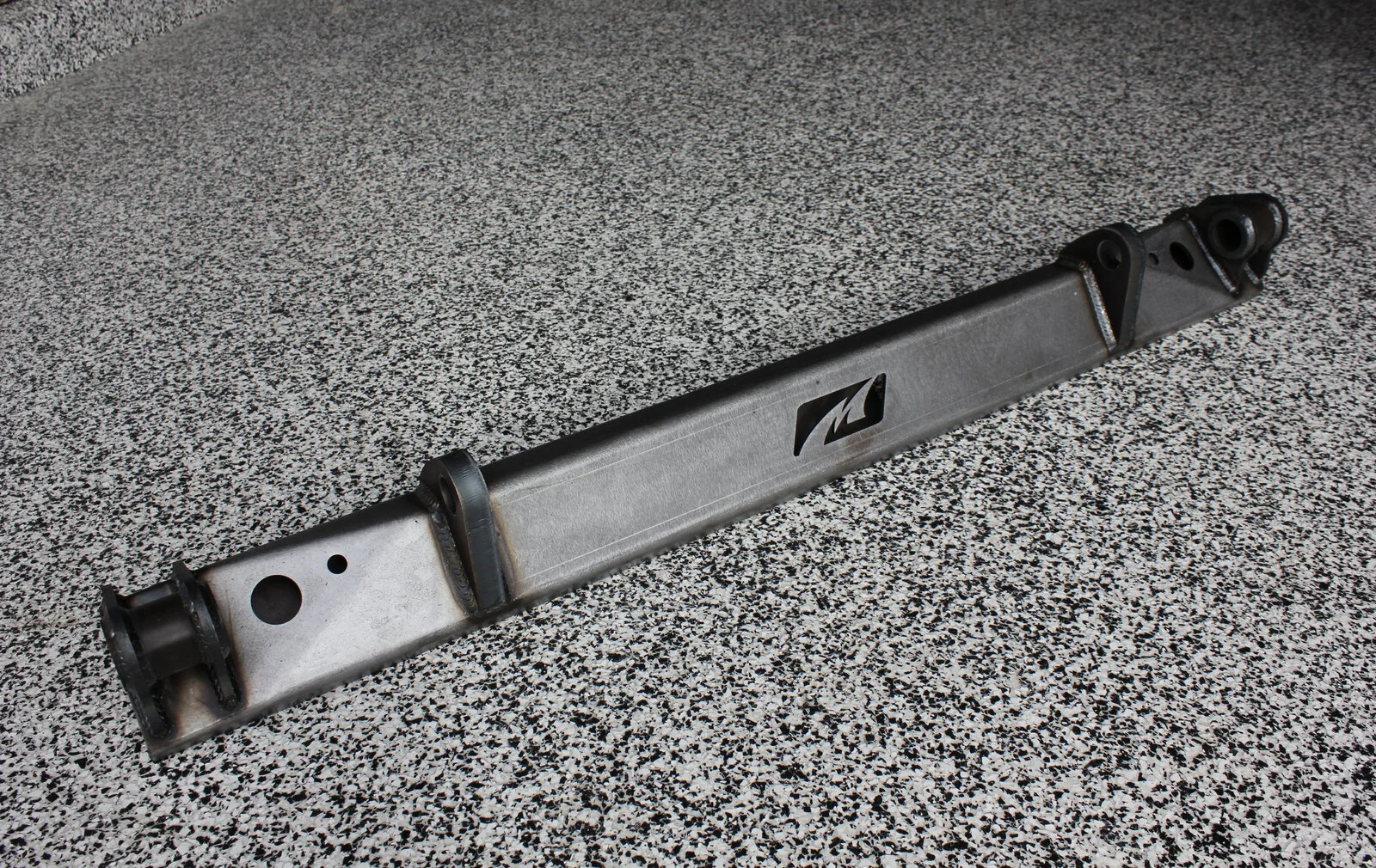

A few parts to stretch the rear arrived today from Motobilt. A rear weld on bumper with recovery points and leaf spring shackle hangers, frame tie ins, and rear shackles.
I waited until their black Friday sale which shaved a little over $60 off of it.
The motobilt stretch “kit” will be welded to the most rear part of the frame. There is a factory crossmember there which can be removed if so desired. I will likely remove it and replace it with some DOM tube, if space allows, then have the rear kit welded on.
The kit comes with frame tie ins that are welded in place on each outside frame rails.
The kit stretches the rear a full 6 inches with XJ springs or 4 inches dependent upon the case of certain offset springs that Jeep has used under other models. I have some doubts that I will be able to run a full 6 inches of stretch while still using a under tub fuel tank, even with the stretch tank I purchased from Genright. Time will tell and I will find out during mock up, with the goal of getting the Spidertrax axle as far back as I possible can while keeping the tank under there.
https://motobilt.com/collections/jeep-yj-87-96/products/jeep-yj-wheelbase-stretch-kit

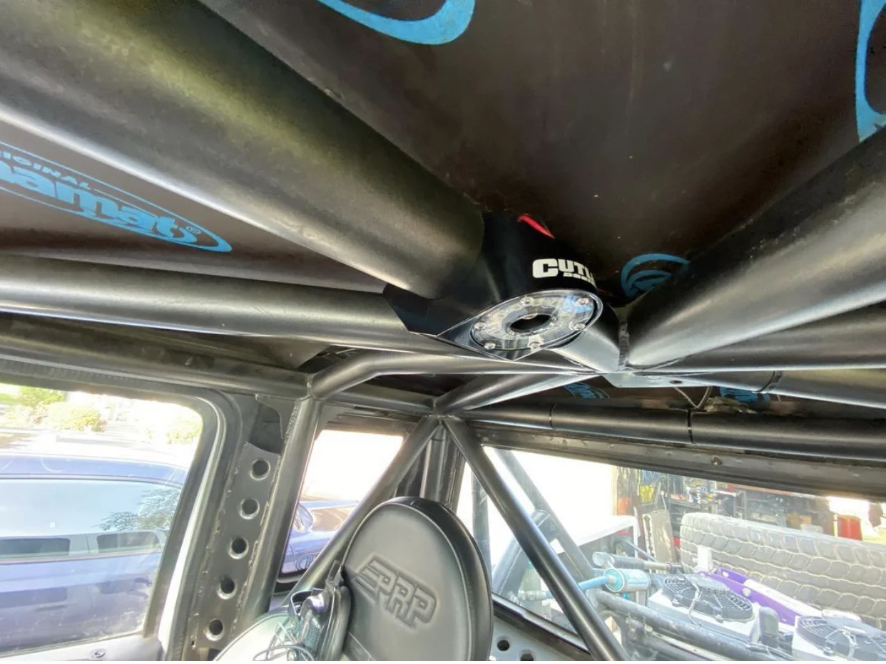

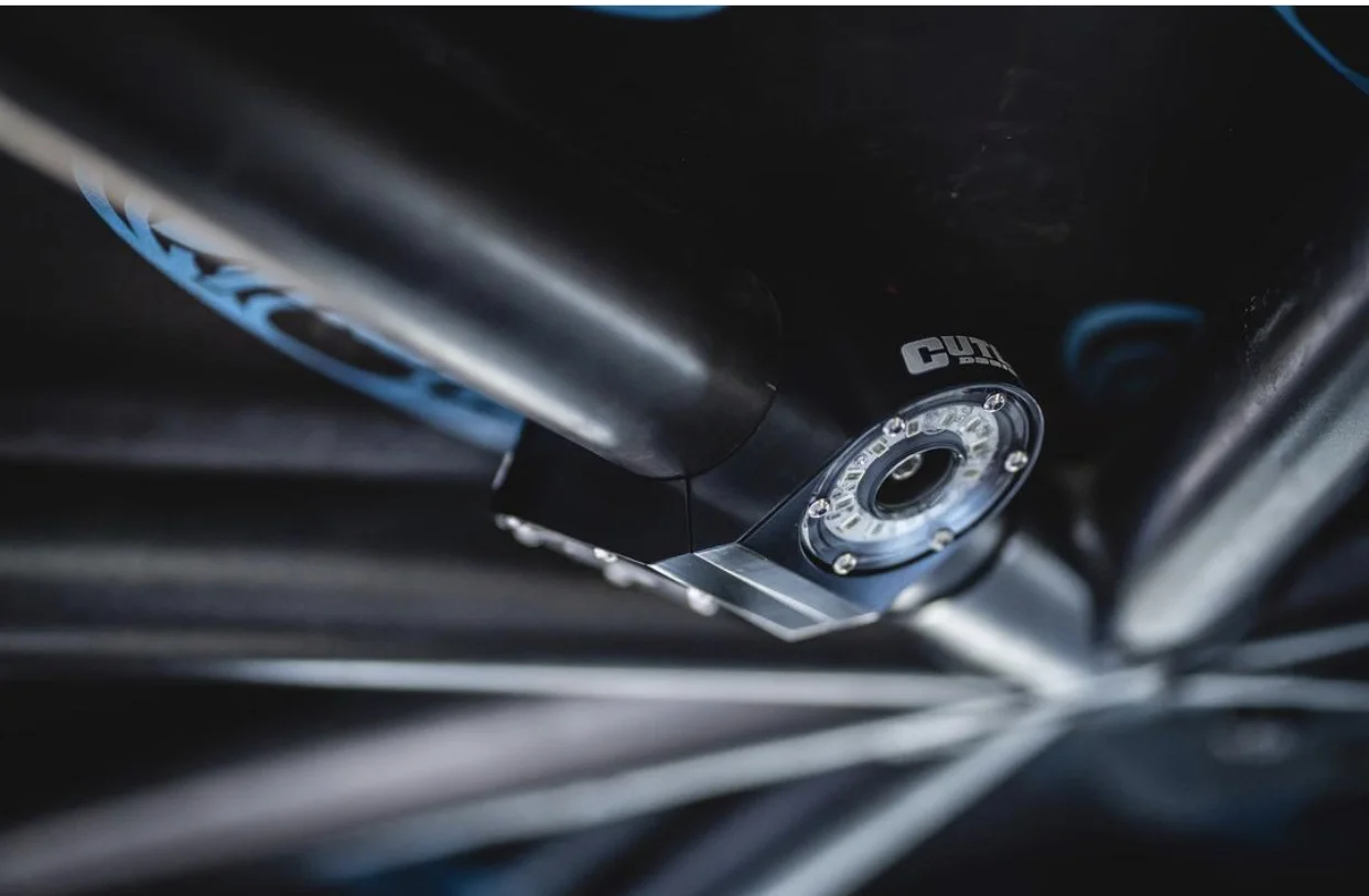

I have gotten several inquires about the KC Cyclones dome light mount. Here are the details.
https://cutlessdesigns.com/store.Offered for 2”, 1.75”, and 1.5” tubes. The newest ones will be anodized gloss black as seen in some of the photos for a really clean finish.
As mentioned earlier in this thread they are 6061 Aluminum and new orders will be finished in gloss black vs the grey anodized version that I have.

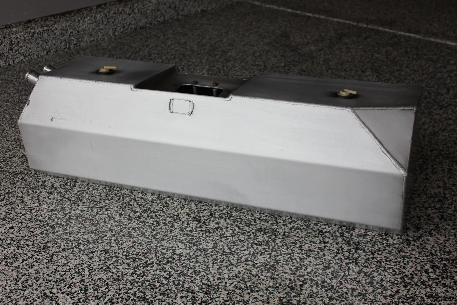

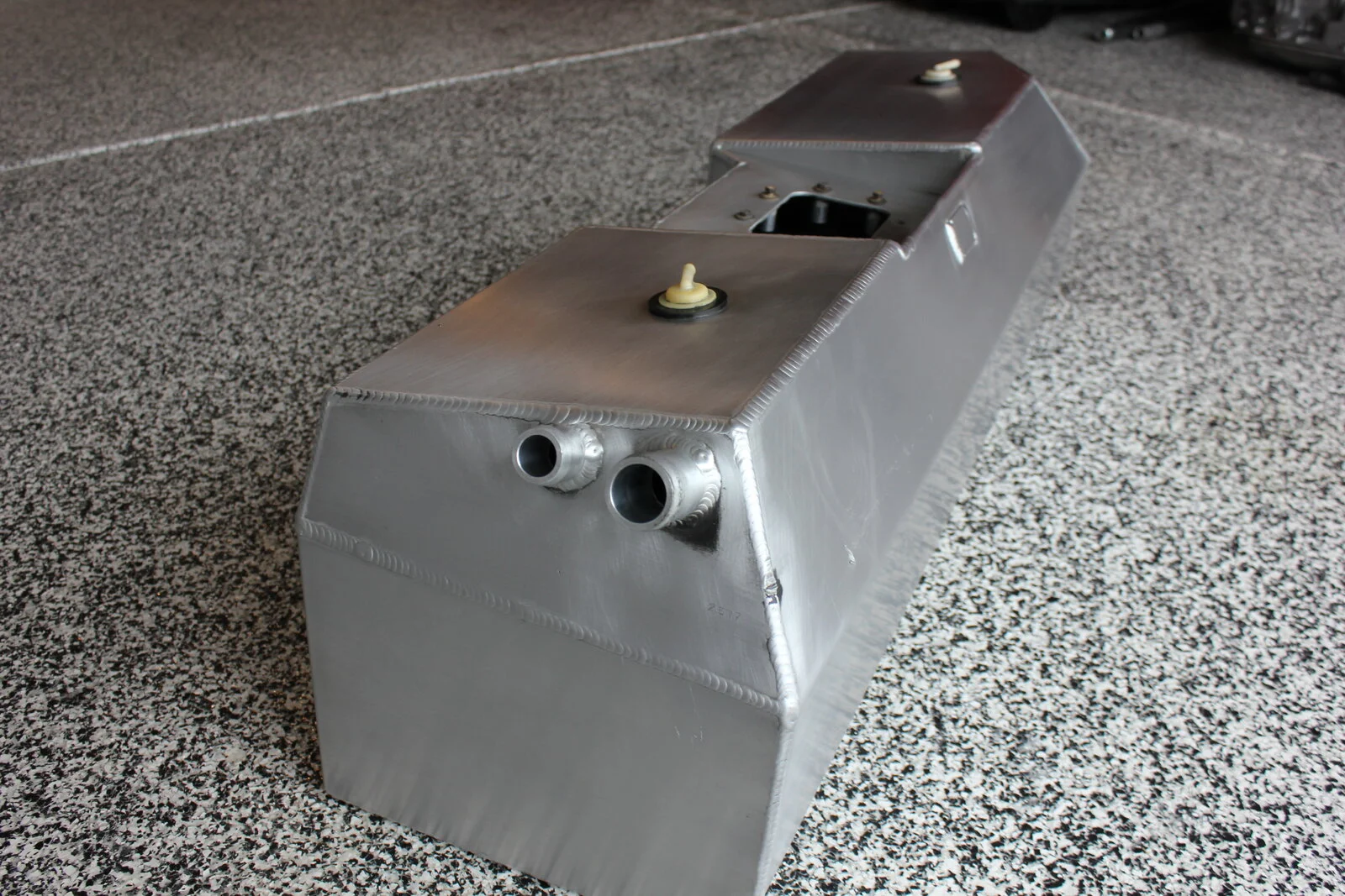

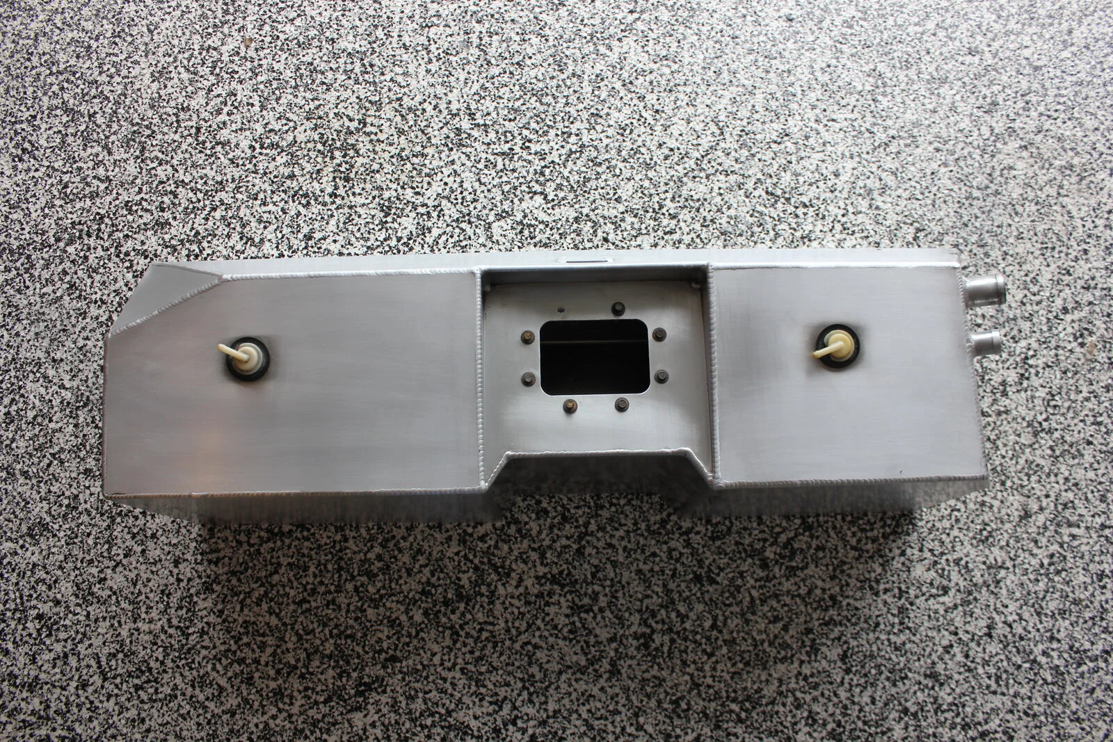

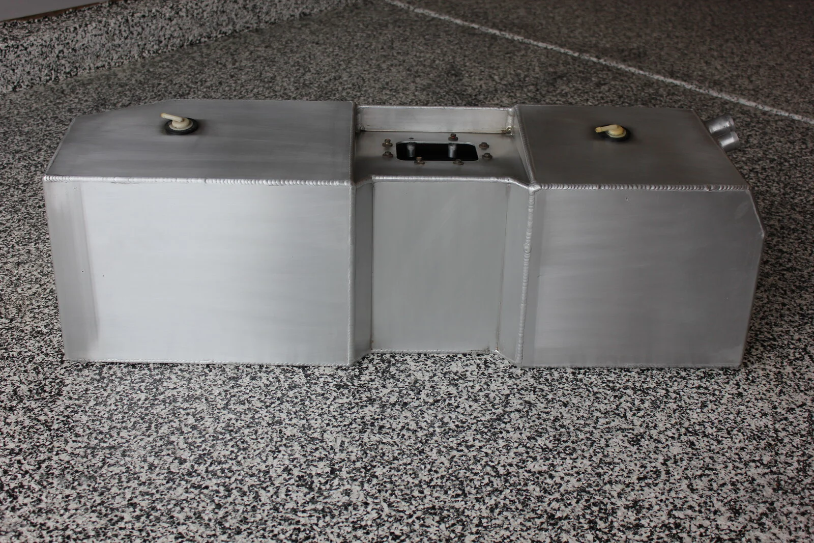

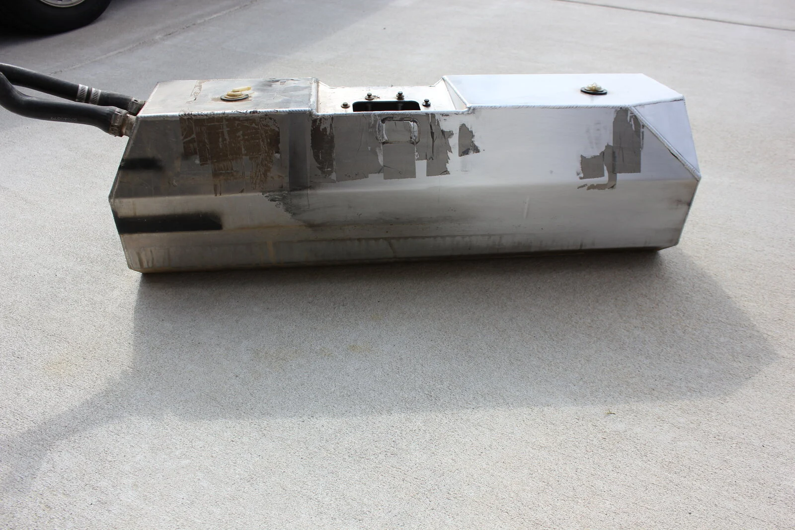

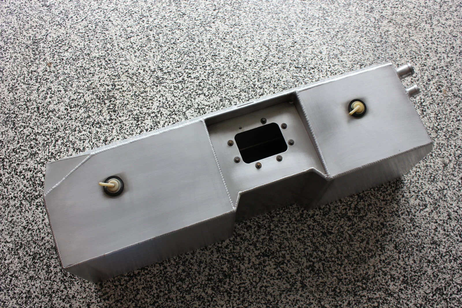

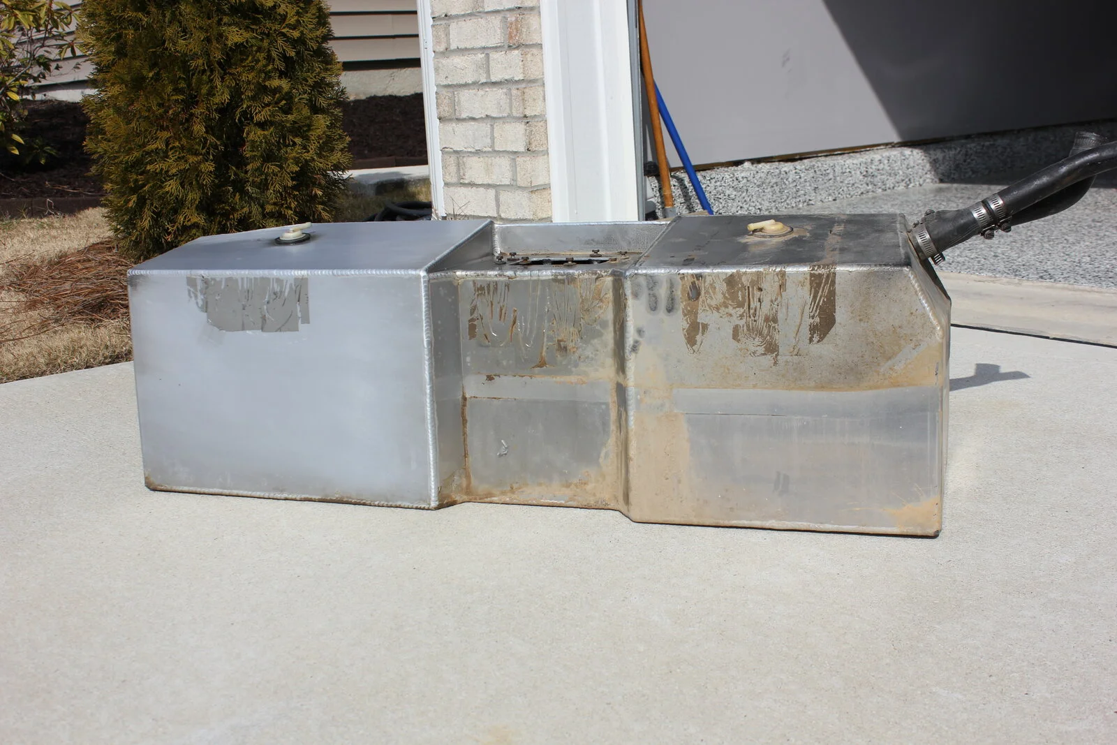

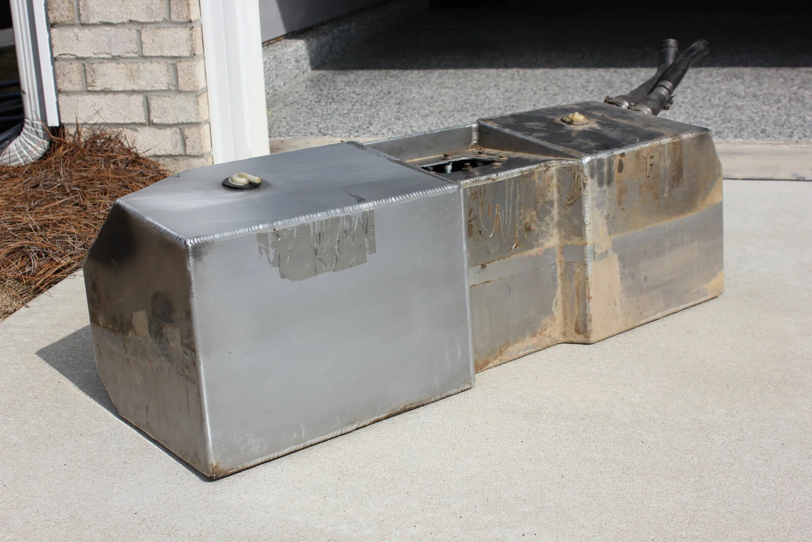

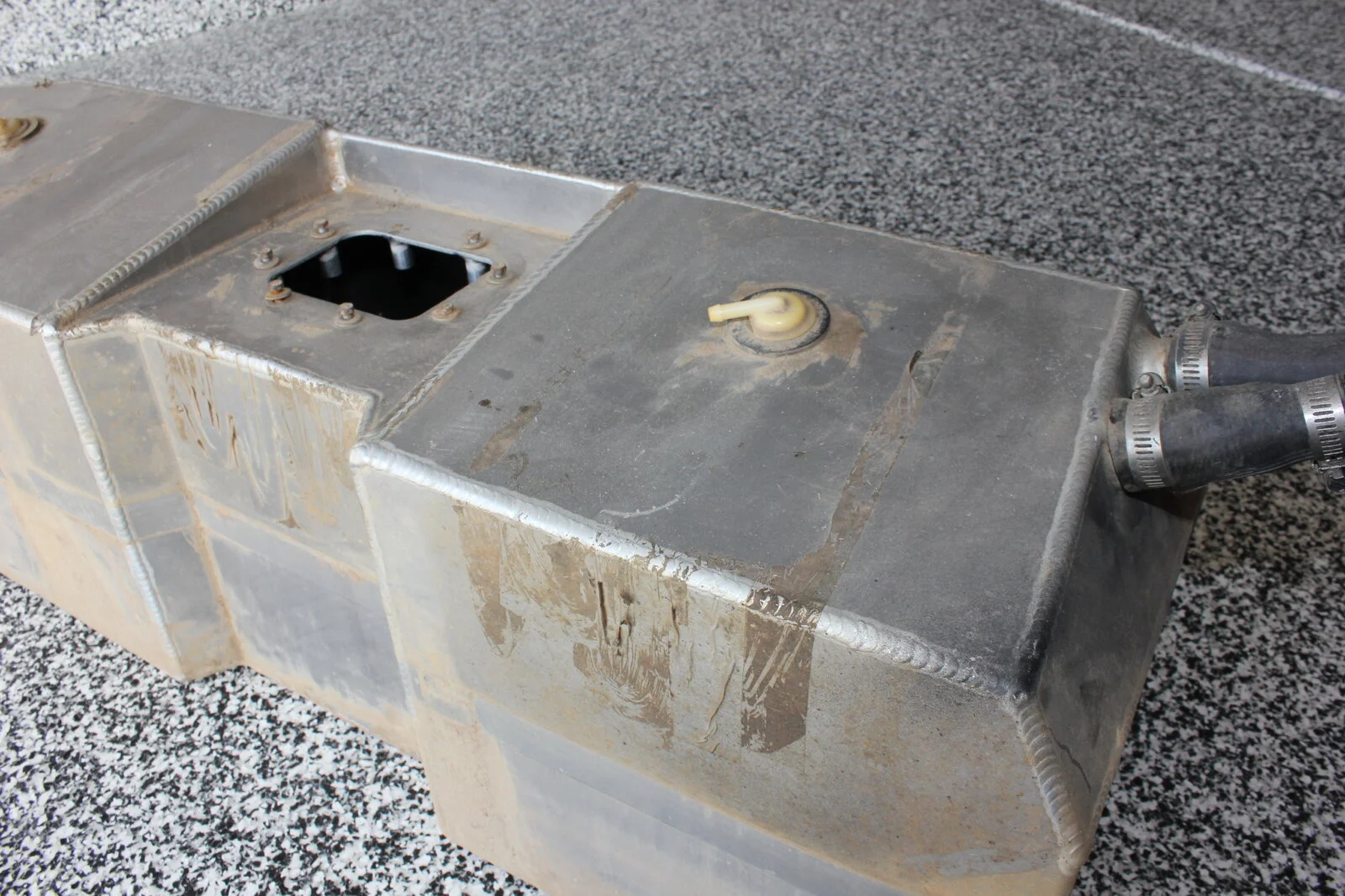

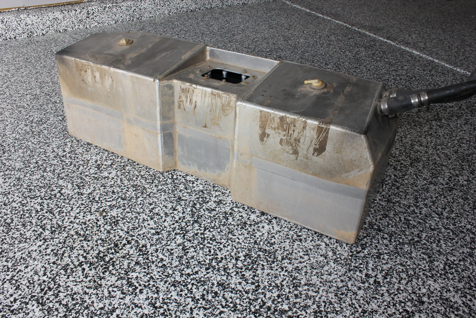

Started the cleaning process yesterday on one of my GenRight stretch tanks that I never cleaned. The tank was purchased used and has a bunch of spray paint on it and adhesive from some kind of tape that's been baked on.
Using ScotchBrite, WD-40, and a some elbow grease to achieve a clean brushed finish.
The photos below were taken after about 30 mins of work. I have some of work ahead of me tomorrow.
Being that your rear 10 inch axle will be HP, I think you be able to make it work with the tank underneath and the drivetrain you will be using. And only 4 inches of stretch.
Your rear driveshaft may be sort of short due to the 4L80, but will not have much angle on it with the HP. I had a Currie HP 9" 16 years ago in my old YJ. Even spring over i had minimal angle. It was nice.
Oh, and excellent clean work!
Reactions: Fouledplugs
That’s my goal. I wouldn't hesitate on having a custom stretch tank built if push comes to shove. Although, I’m confident that I can make the older GenRight tank work without issue.
The now discontinued GenRight GST-4005 allows for a 7” stretch using a Dana 44 and a 6” stretch with a Dana 60. With the Spidertrax housing I should be able to get in the 7” range ...if required.
