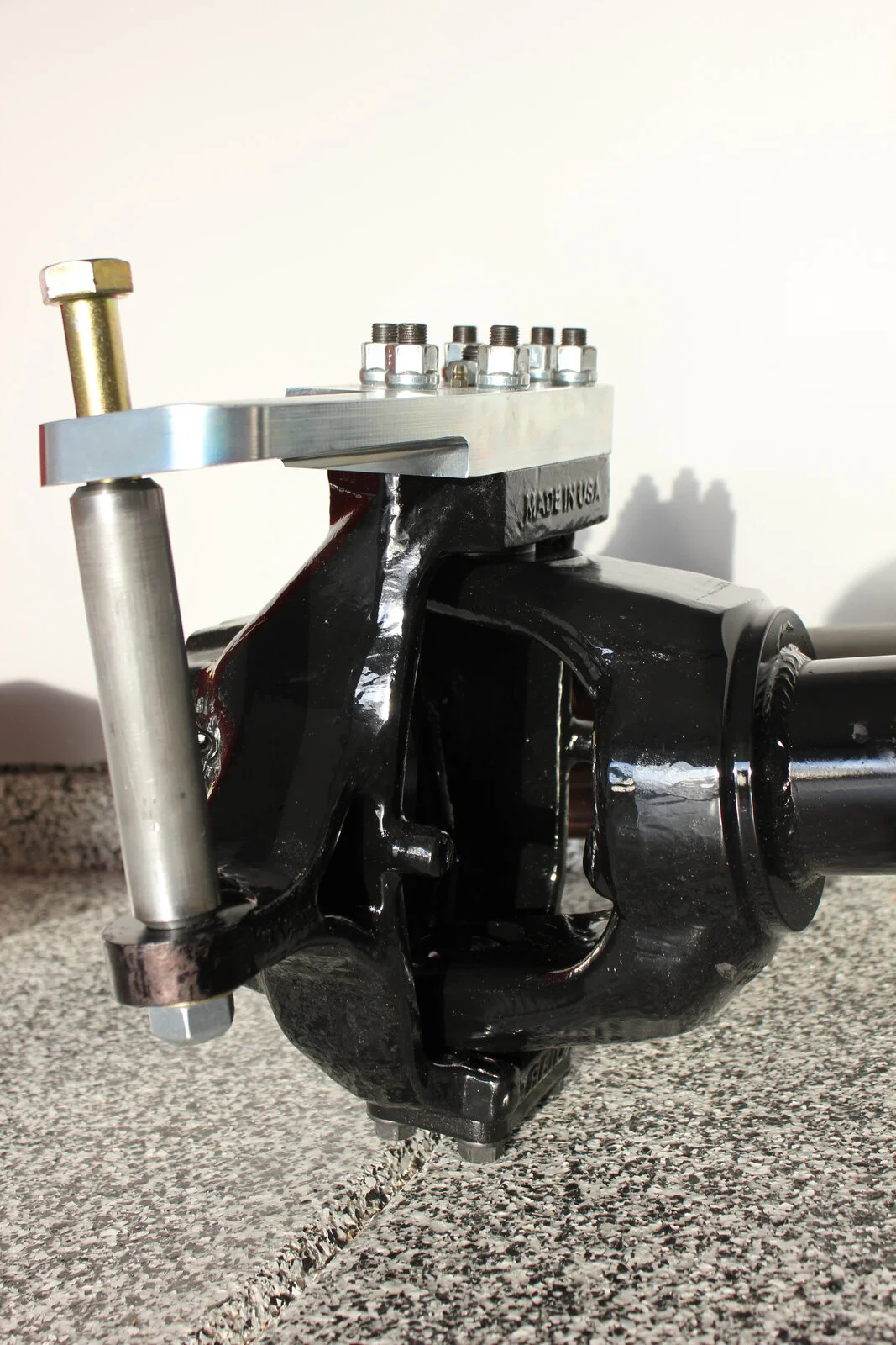

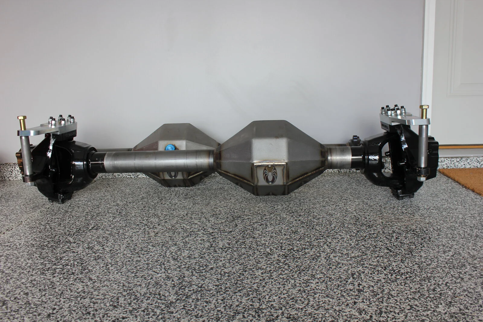

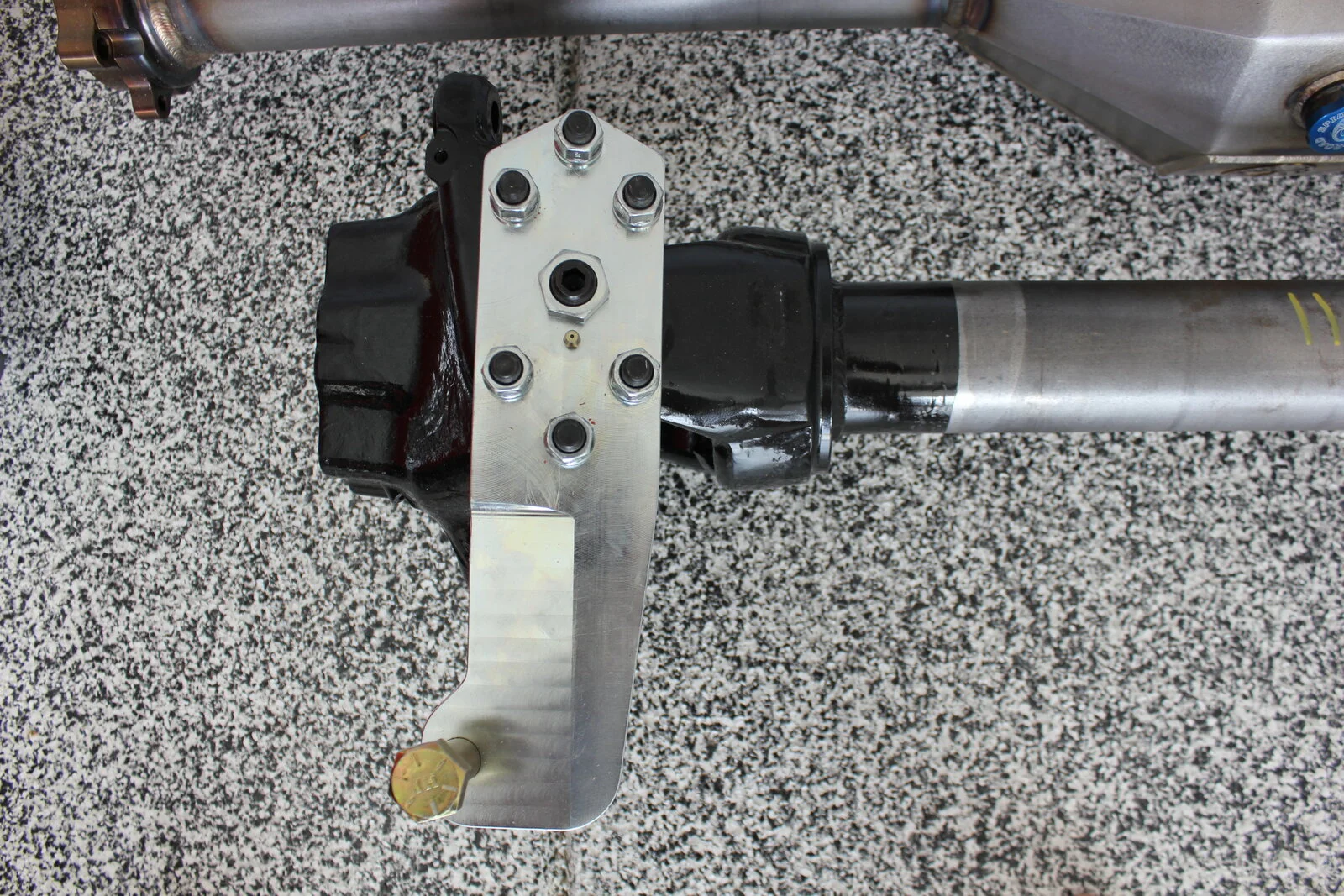

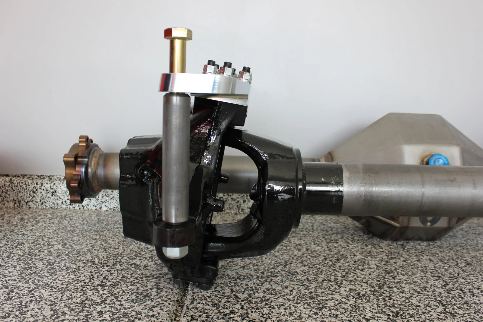

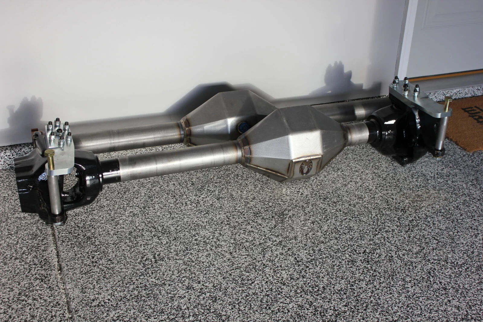

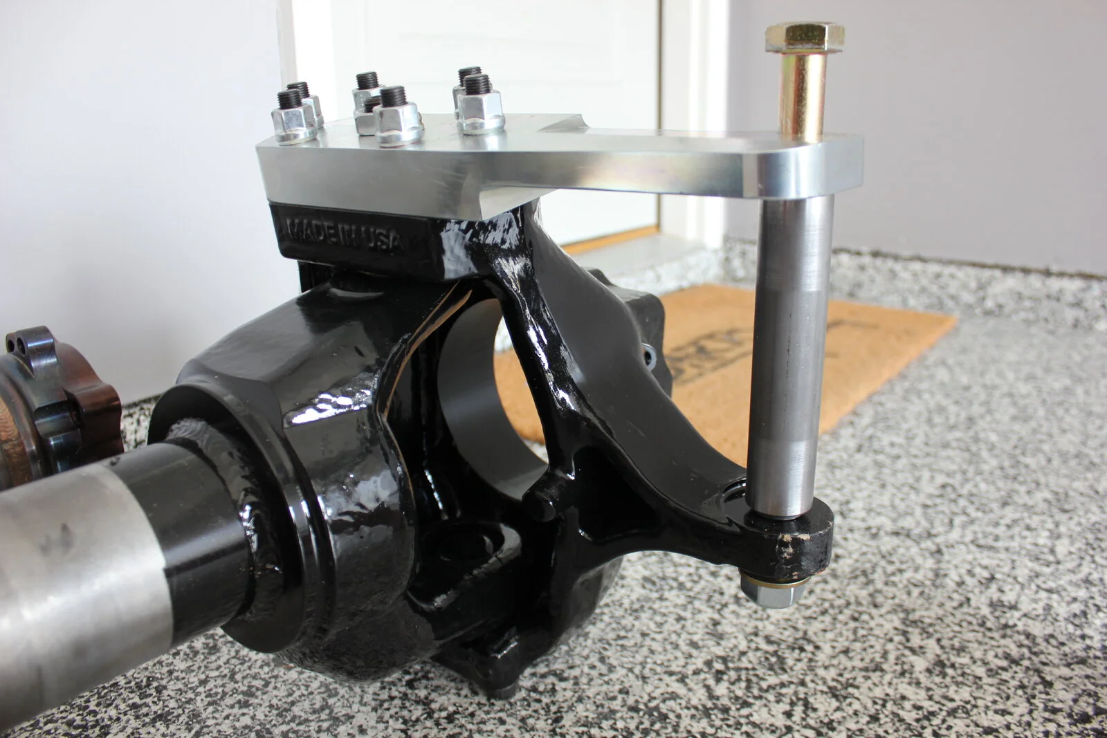

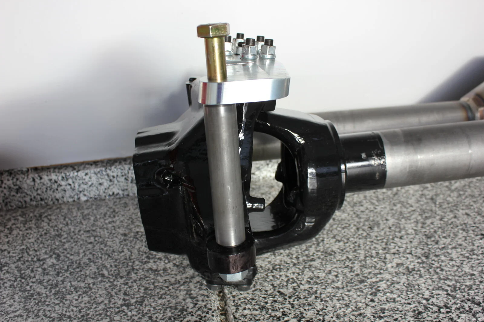

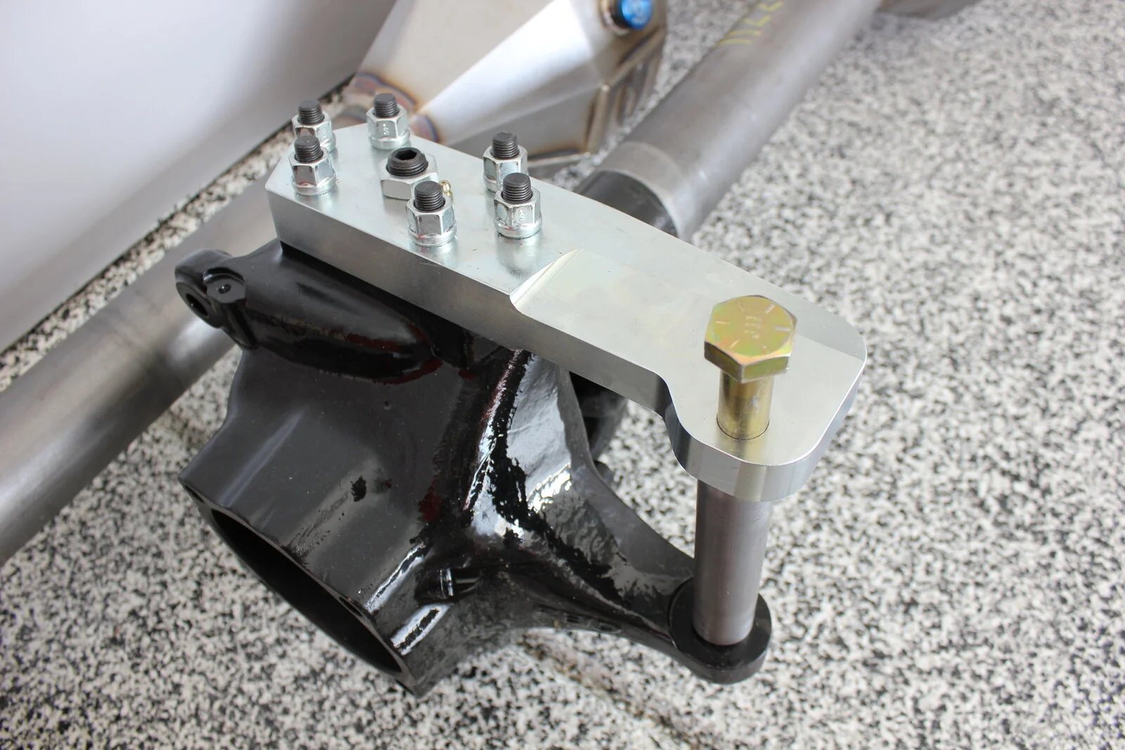

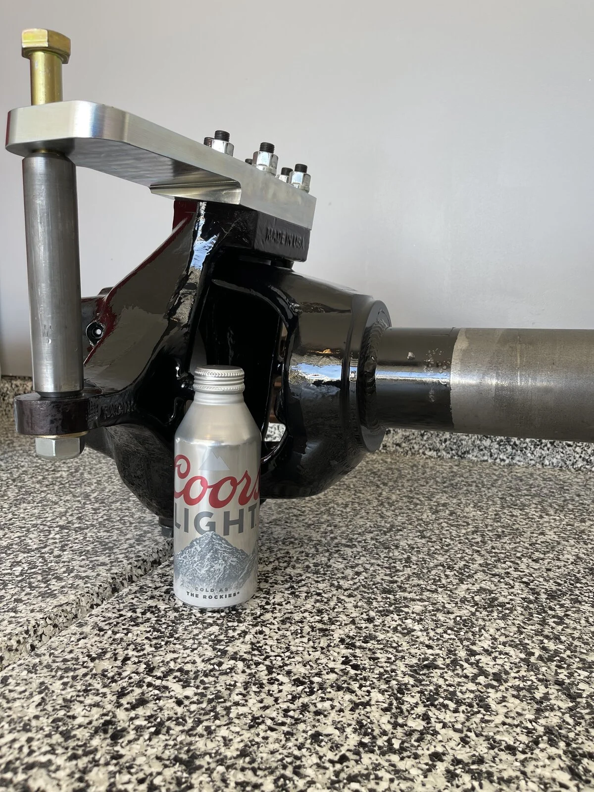

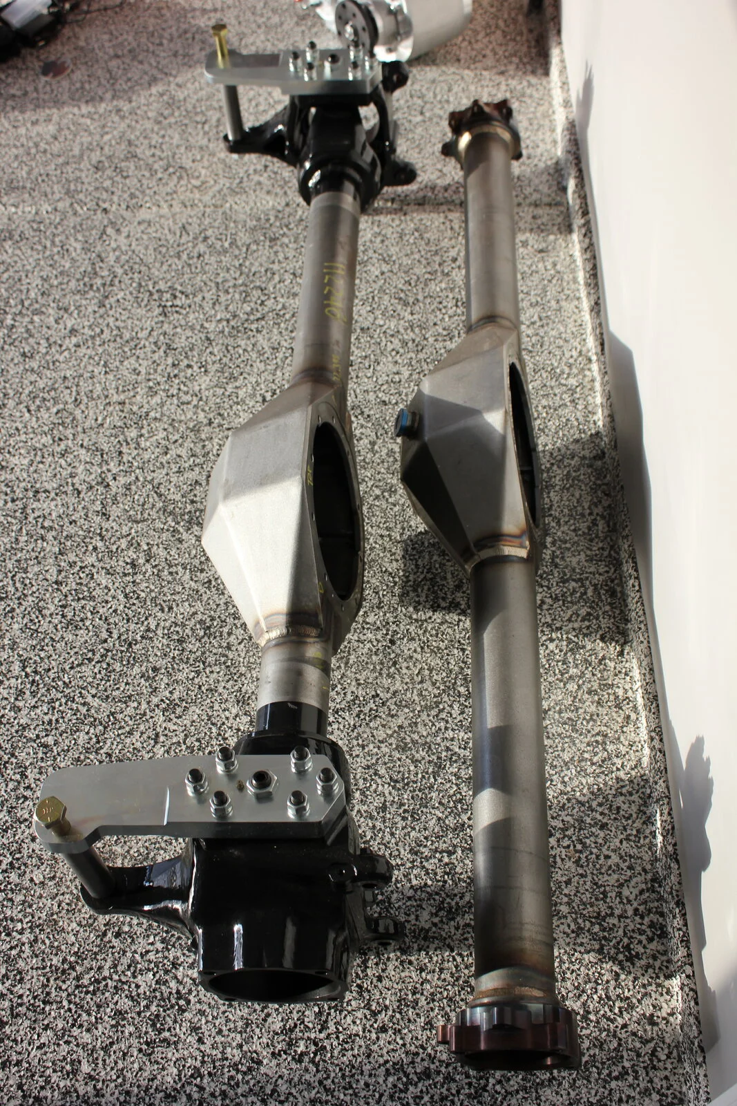

Got the front axle finally done and back in the garage.
- Spidertrax pro series 4130 chromoly 3.5” housing
- Reid Racing 3.5” Super Kingpin Inner knuckles (C’s)
- Reid Racing Super Kingpin outer knuckles
- Setup for double shear steering
- Driver drop
- 69.5” WMS
- 79 Ford Dana 60 Specs
Couldnt stand the orange paint that Reid’s come with, so painted them black.
Will utilize 05-12 factory Ford Superduty brake calipers and rotors, 8x6.5 unit bearings, locking hub, and a 1480 or 1550 u-joint.
- Driver drop
- 69.5” WMS
View attachment 294034View attachment 294035View attachment 294036View attachment 294037View attachment 294038View attachment 294039View attachment 294040View attachment 294041View attachment 294042

Flanges front and back - nice touch. That’s what I run. I find it so much easier to swap a driveshaft with those.
And for me, it‘s part of what lets me carry one driveshaft as a spare for both the front and the rear.
