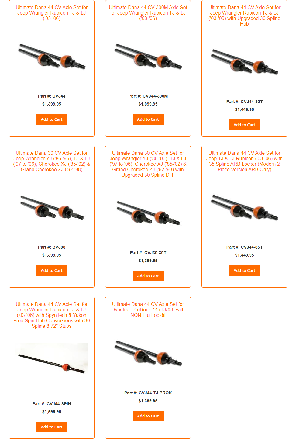

Looks like there is Revolution discovery ,Yukon, USA standard gear, and ten factory.... anyone have a preference one over the other ?
Looks like rcv 27 spline are same price are they as strong as chromoly?
Stronger. But just know some people complain about them clicking when used on a DD. They are stronger because you're eliminating the u-joint for a CV joint.
I'm not finding 27 spline RCV shaft...
I'm use to clicking my aussie lunchbox locker clicks alot everytime I turn nothing new to me although half the time I can't hear it because music is turned up
Chromoly looks like anywhere from 1200 to 1500
Rcv is 1400..... may just go for rcvs I've been reading through form sections trying to determine what's best for my application which is mild/ rocky trails and alot of highway travel
