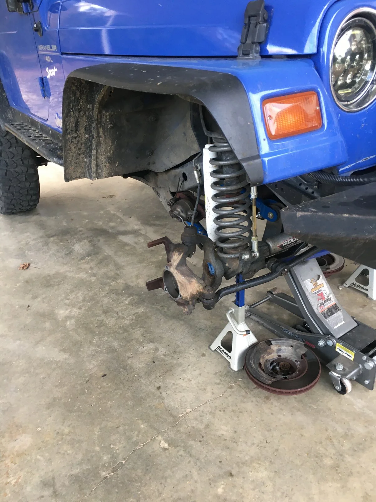

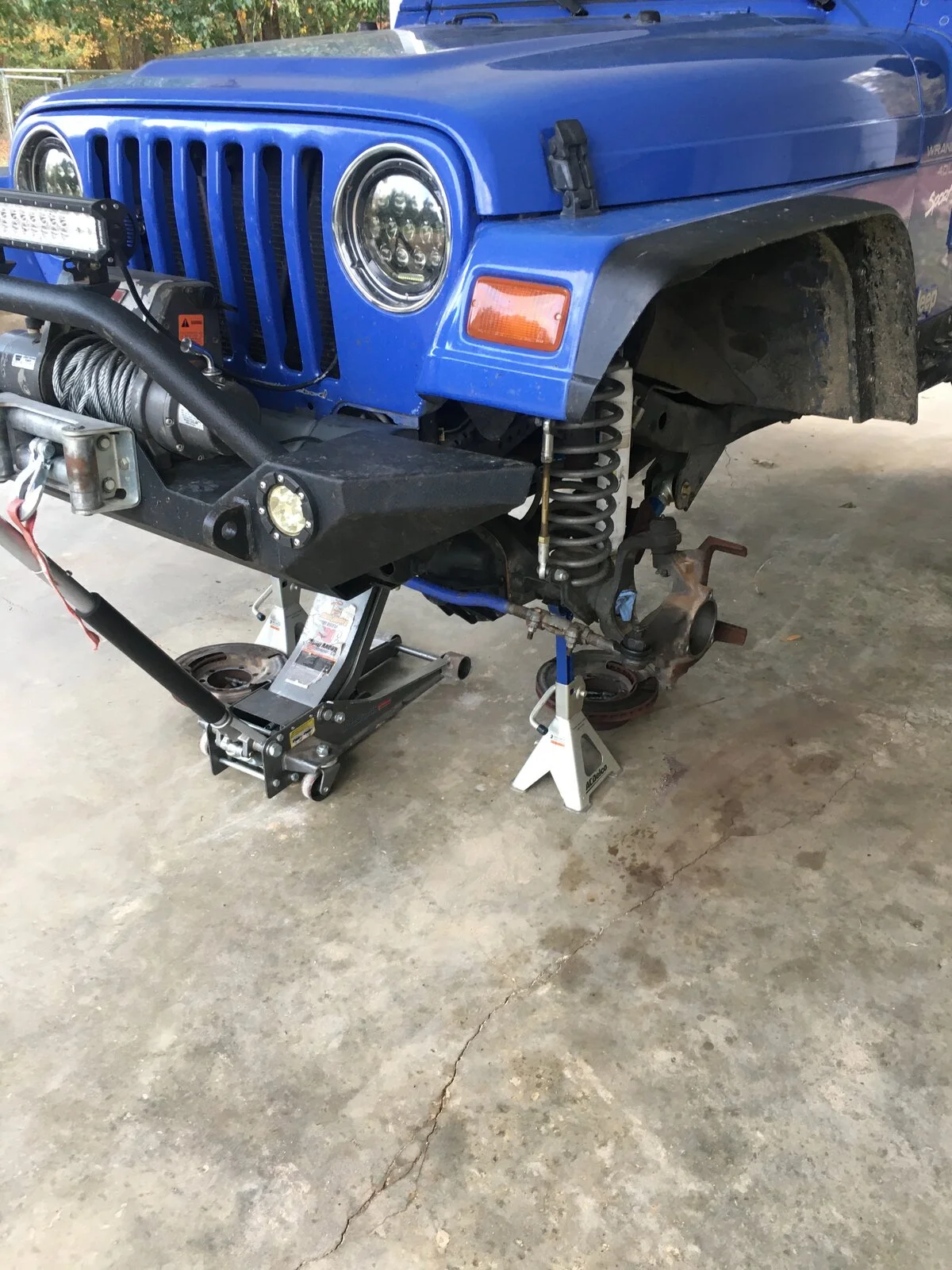

Would it be a good idea to replace my Dana 30 axle shafts with chromoly?
When I installed my powertrax no slip locker I ended up doing inner axle seals, u joints, ball joints, wheel bearing hubs, and a ZJ tie rod....”since I have it all apart/while I’m in there”
Smart man. My ball joints seem to be in excellent shape. They probably are not to expensive. Maybe I should.

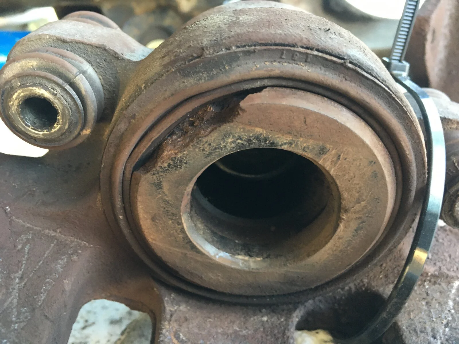

mrblaine, the donut in one of my calipers has a chip missing out of it. It is not leaking, Do I need to replace the roter? Thanks
Dorman has them.

just a little follow up , I finnished the project. new axles are in and the jeep is rolling great. Ill go back and make sure all the bolt are torqued properly AGAIN . after 25 to 50 miles. I did not install any outter tube seals but i did swap the dust covers from the old axle to the new ones. The tube seal are still under review. Im glad i did the project , because I really learned a lot and I know it was doen properly. ANd yes i read every direction I could . if you have any question please ask away. thanks for your help !!
