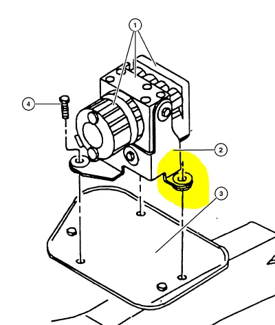

Has anyone had success sourcing replacement grommets and the metal sleeve inserts for the ABS pump-to-tray mounts?
They seem like fairly standard isolation grommets at first glance, but I haven’t been able to find a close match on McMaster, Grainger, Amazon, or eBay.
For reference, the bracket is about 1/8" thick with a main mounting hole around 7/8". It seems like a typical rubber grommet designed for 1/8" sheet metal and a 7/8" hole should work, but the issue is the metal sleeve—its purpose is to keep the bolt threads from cutting into and wearing out the rubber over time.
I could live without the integrated washer-style flange on the sleeve if needed and just use a separate washer instead.
