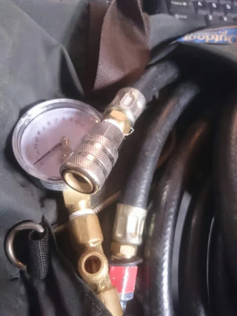

I have a setup that connects all four with quick connects so I can air down all at once and equalize pressure. I use a gas line gauge to set the low pressure, 0-15psi. Then I can use the same system to air up everything at once. Part of the system allows me to connect two tires. It all packs down into a small-ish bag. Not having to set each tire pressure saves allot of time and it's nice because you can do all four up and down hands off.
