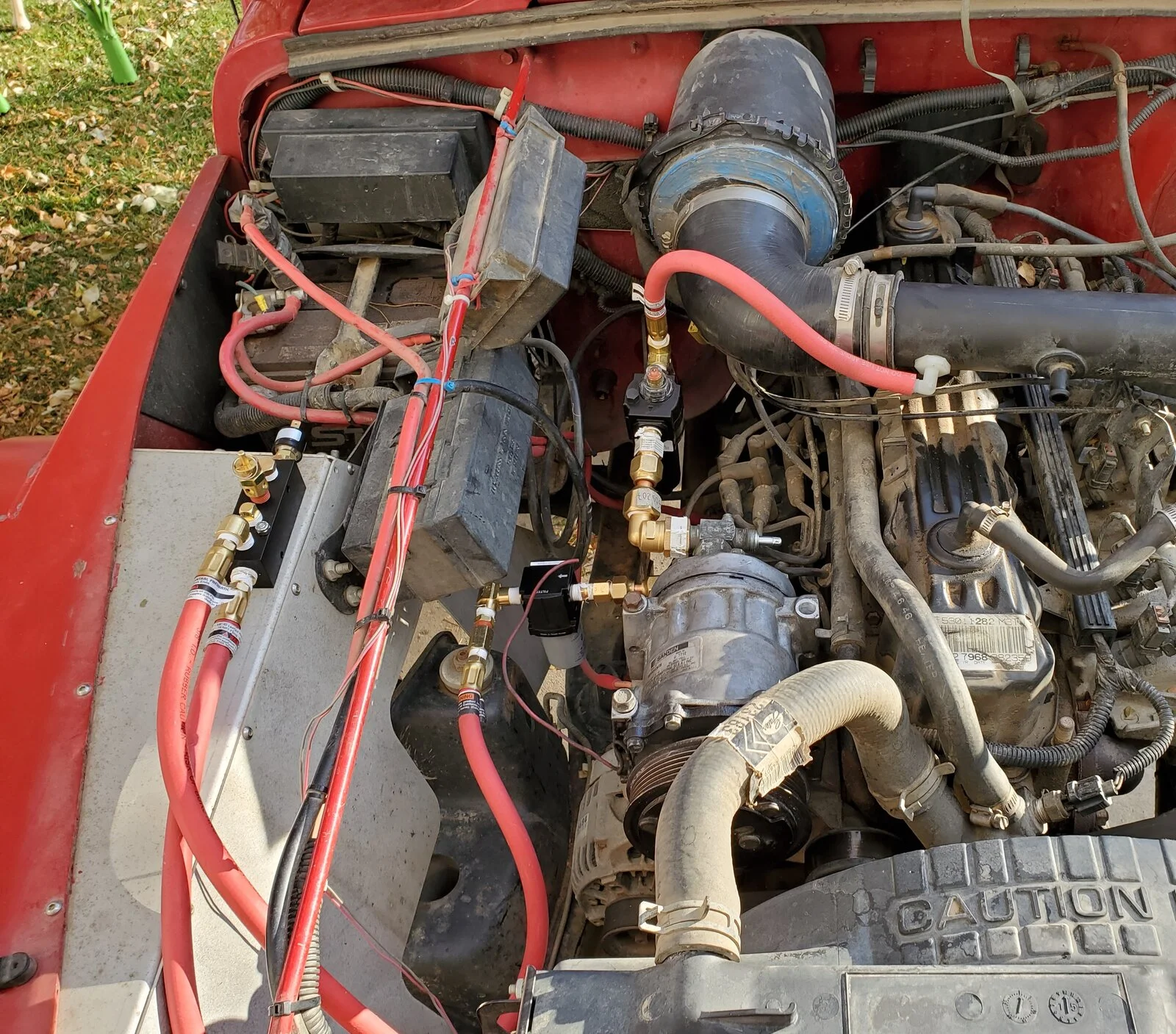

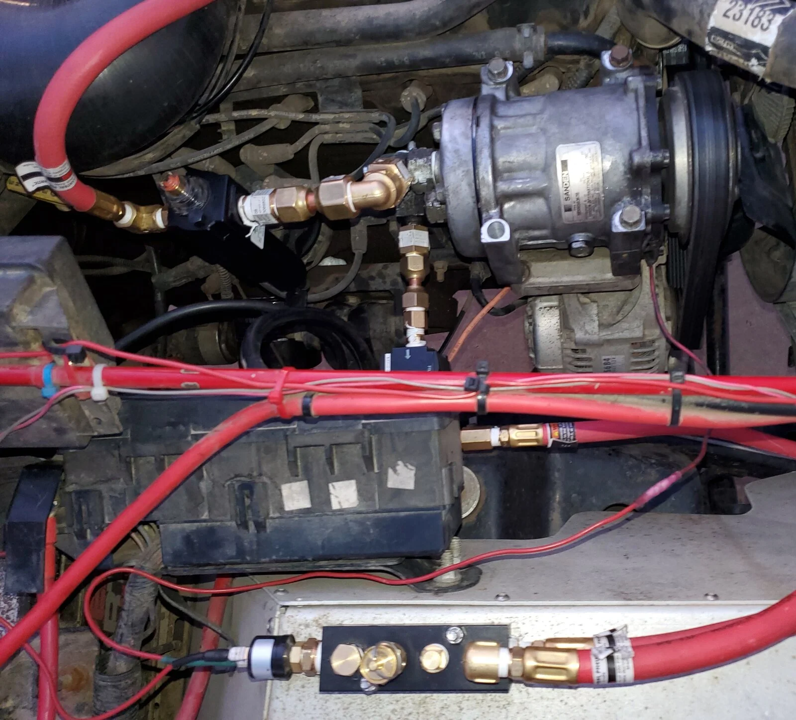

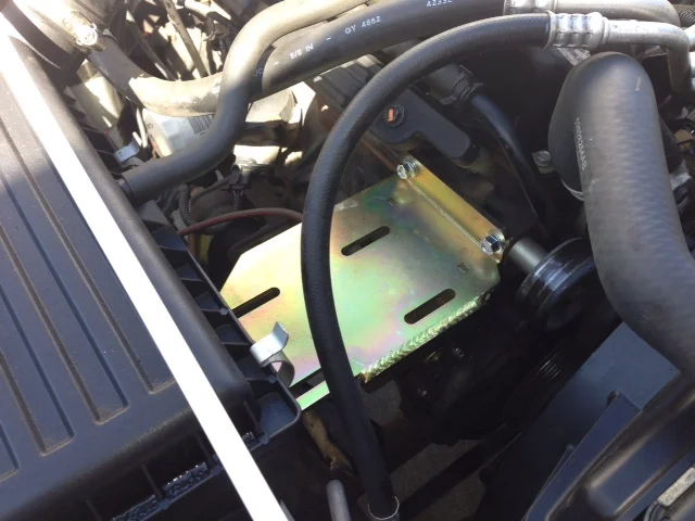

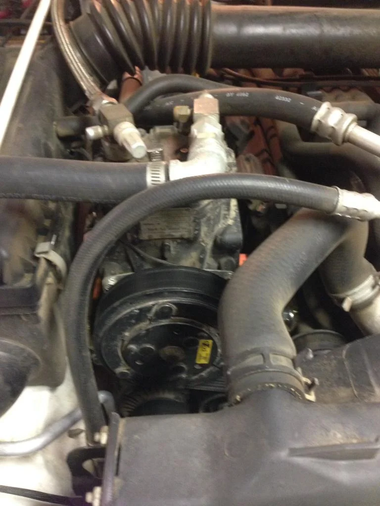

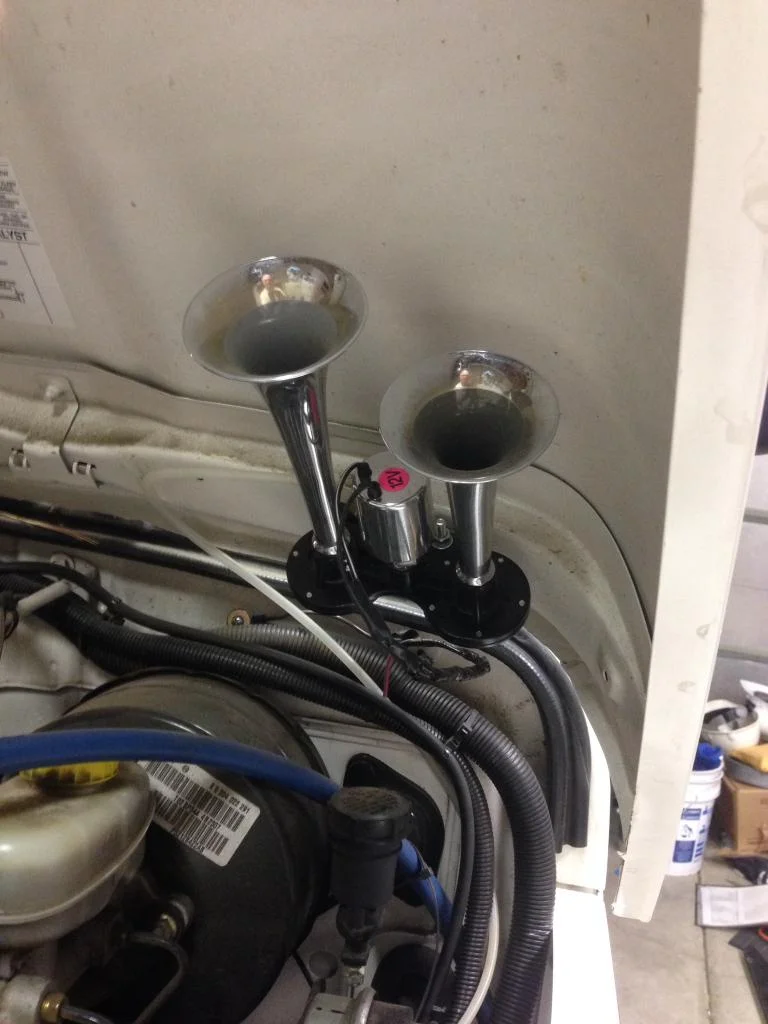

No you don't loose your AC, I have the York system and my Factory AC and horns. I have quick disconnect fittings at the front and rear of my jeep

Their kits are designed to work with or without factory A/C. It mounts where the alternator is and lowers the alternator underneath it. It does not replace the factory A/C compressor, nor does it bolt there.
So if you have factory A/C, you can run it and the belt driven air compressor at the same time. If you don’t have factory A/C, you can still retrofit it with this kit installed.
The difference in the A/C and no A/C kits is simply the length of the belt provided.

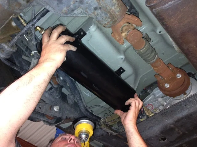

The kit does not come with a tank. For filling tires, you really don’t need one. If you’re running air tools, horns, or an AiRock suspension (or anything where the instantaneous draw can exceed the output of the compressor), then you can add a tank.
I believe a 2.5 gallon Viair tank fits to the left of the rear driveshaft on the underside of the tub.

Thanks, I may go this route. Love the QD's front n back. What air tank did you use?
It's a 2-1/2 Gallon but I can't remember where I bought it from. Not sure if you really need it or not. I can say that the air coming from a york is very hot, I had to switch out my rubber hose for a SS braided Hose for the first few feet
