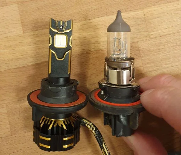

The standard JK H13 Halogen (right) and the Auxbeam LED.
BTW typical Halogens are about 1000 lumens in low beam, so the LEDs should be a lot brighter. Even though the LDs are rated at 25,000 lumens per pair, each bulb won't be 12.5 times brighter than the Halogen its replacing though, for a number of reasons having to do with how lumens are measured and how LED bulbs work; Auxbeam says these bulbs are 6 1/2 times brighter than standard Halogens.

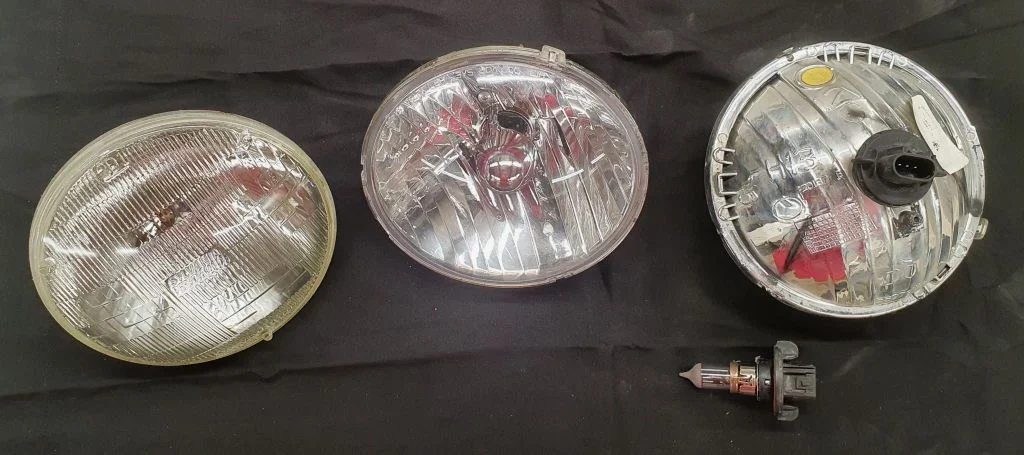

TJ's have sealed beam Halogen headlights that don't accept separate bulbs but that's easily changed - this photo shows a sealed beam (left) and a JK H13 housing (center and right). The JK housing is a direct replacement for the sealed beam in the TJ and since it accepts separate H13 bulbs, it's a way to swap the LEDs into the TJ.

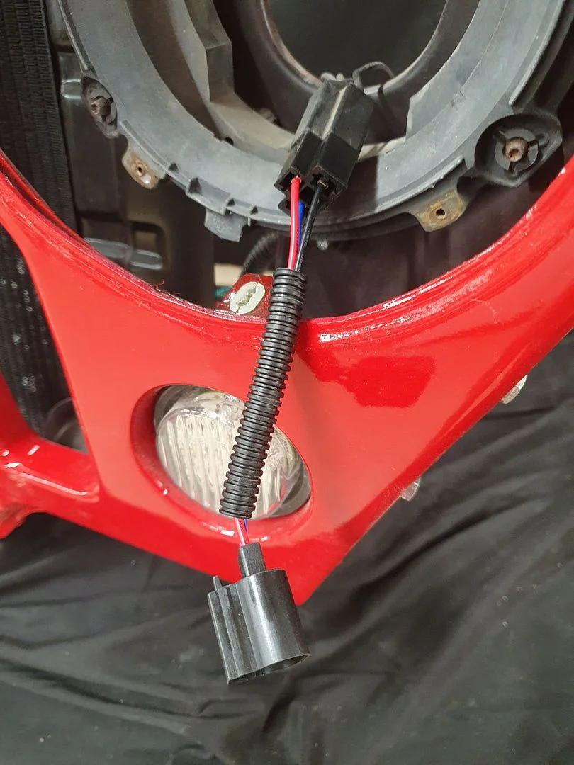

The swap is easy - remove the headlight trim (Torx T20), then remove the headlight retainer ring (T15), plug in an H4-H13 adapter for each light, put a bulb in the housing and plug the wiring adapter into it and install the H13 housing in the reverse order of removal.
H4 to H13 adapters are available in many places, including eBay:

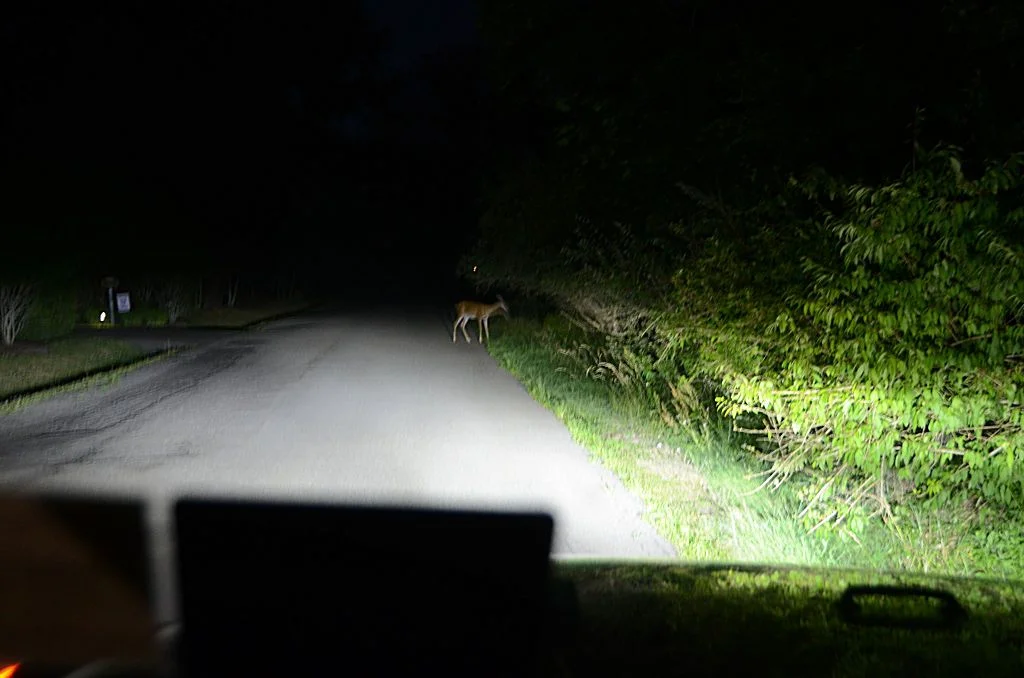

I installed these bulbs in mk JKU a while back and here's the result. The camera is set to manual aperture and shutter speed so all three photos are comparable. Left to right: stock headlights, LED on drivers side/stock on passenger, and both LEDs installed.
One of the reasons I wanted to upgrade... deer are rampant around here...

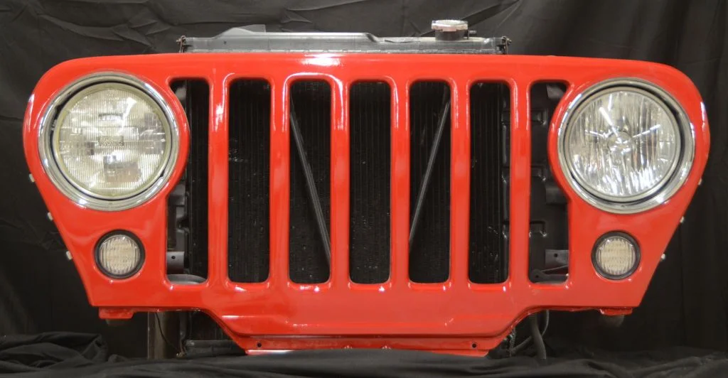

Compared to the TJ's sealed beam:

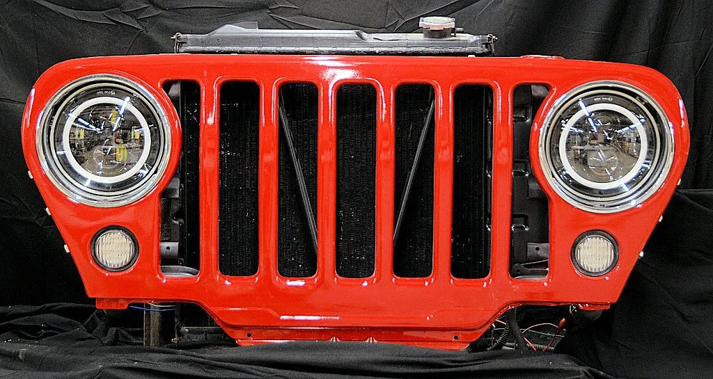

The QP005972s installed in a (custom) TJ grille:

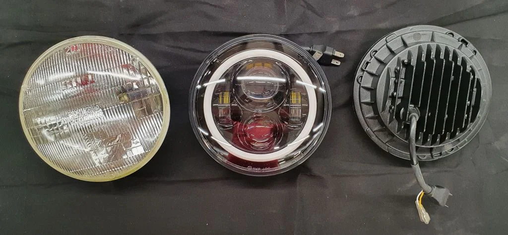

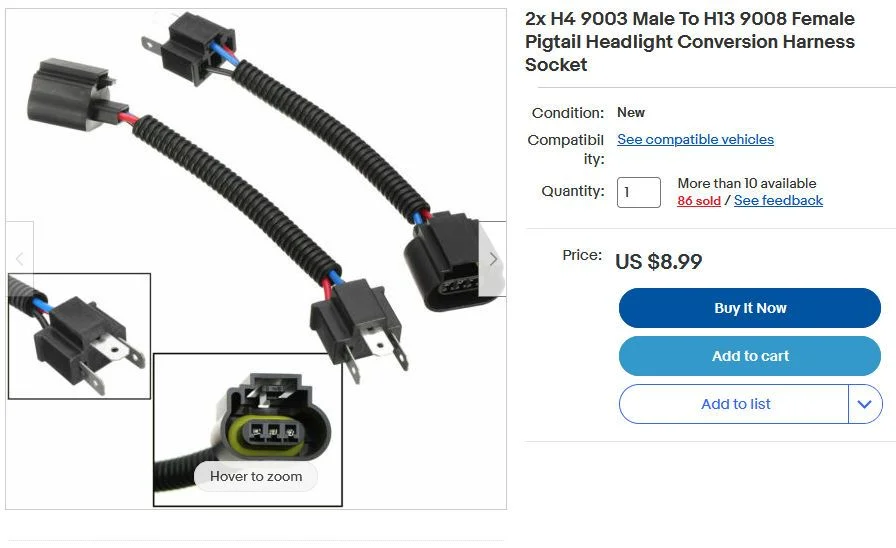

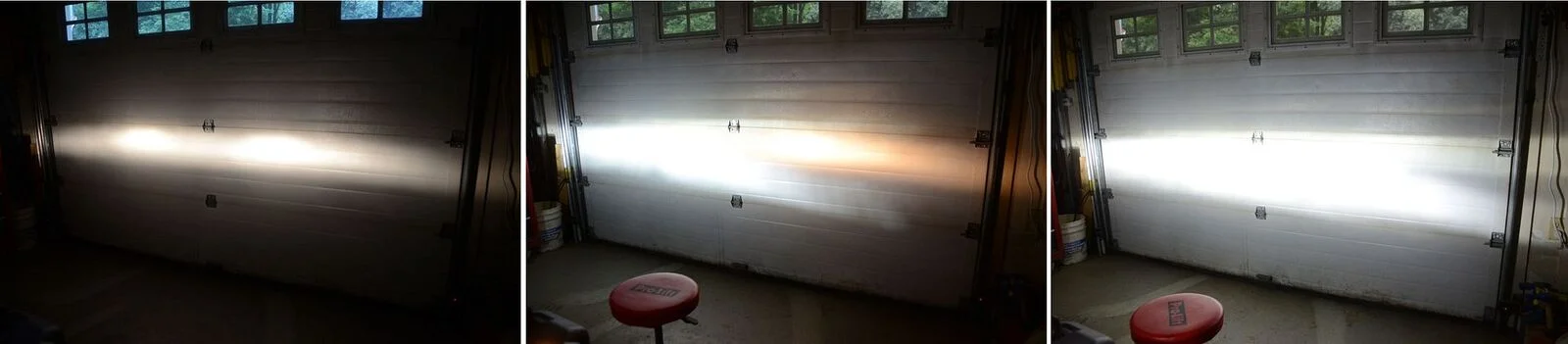

In this photo, the original sealed beam is on the left and the JK H13 housing is on the right. For people who want better lighting but want to retain a stock look, this is a great way to go. JK headlight housings are available on eBay and often on Craigslist because so many JK owners swap halo lights and other non-factory looking lights for their stock H13s.

The Auxbeam QP005972 (https://auxbeam.com/products/spu00208) lights include a separate DRL and turn signal functions in a “halo” around the perimeter of the housing. The halo component can be seen in the LED in the center of the photo above. Sharing the DRL component of these lights is the turn signal function - the halo is white and when the turn signal is activated the halo turns yellow.

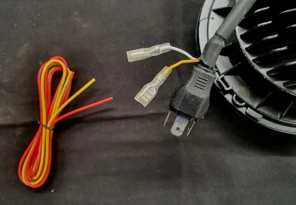

This photo shows the wiring connections on the LED. The white wire is the DRL, the yellow wire is the turn signal and the three pins on the H4 plug are (left to right) ground, low beam and high beam.
Auxbeam provides some extra wire for connecting the DRLs and turn signals but not the spade connectors. Oh well.
If the DRL function is desired, there are several ways to wire it, each with different operations:
- If the white wire is connected to a switched circuit the DRLs will be illuminated whenever the vehicle ignition switch is on.
- If the white wire is connected to the parking light circuit, the DRLs will be illuminated whenever the parking lights or headlights are switched on.
- The white wire could be connected to a switch so they could be turned on or off at will.

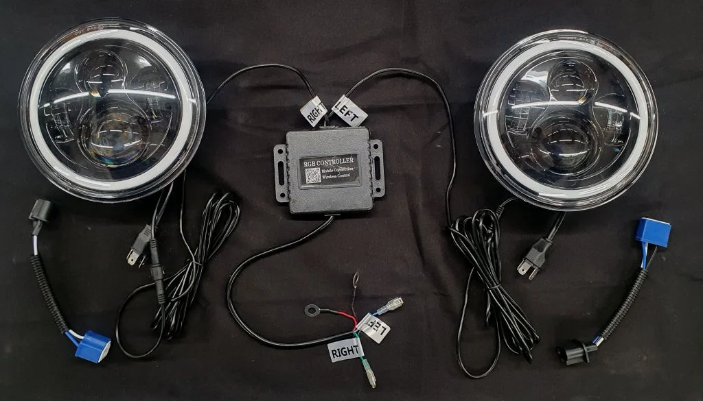

The Auxbeam QP000081 (https://auxbeam.com/products/qp000081) 7” LED headlights have rotating LED halos with Bluetooth RGB control – the halo ring on these consists of RGB LEDs that can be set to any color and has animation controlled by the smartphone that can add a rotating effect to the halo.
This photo shows the wiring harness for the QP000081 light kit. There’s a male H4 plug attached to each light and that plugs into the female H4 plug in the vehicle.
In the center of the photo is the Bluetooth/RGB controller which needs to be mounted somewhere convenient in the vehicle, typically in the engine compartment. There are wires which run from the controller to each of the headlights, and these control the RGB halo functions.
At the bottom center of the photo are 4 connections – the red and black wires get connected to 12v and ground, to provide power to the Bluetooth module. The wires labeled “left” and “right” control the turn signal function of the halos in the same way as the halo lights described earlier do, and should be connected in the same was as described for those lights.

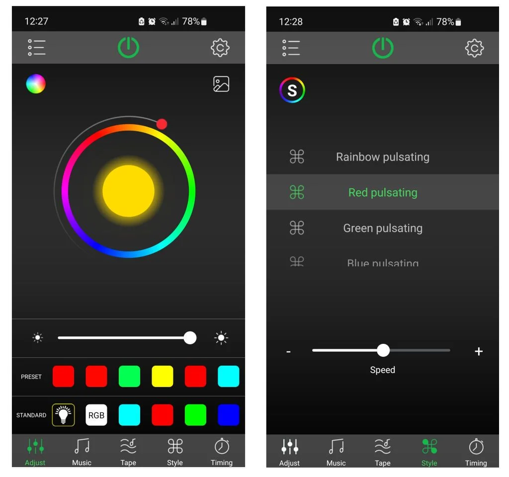

The smartphone app is available at the Apple store for IOS and the Google store for Android and it's called "Happy Lighting".
The screen on the left is the color screen – the color wheel can be tapped anywhere to select the color of the halo, or presets below the color ring can be selected. The screen on the right is the animation control, and the animation effect and color can be selected from a scrolling list in the center of the screen. The speed of the animation can also be selected.
The app has other features, such as syncronizing the animation to music, but I wasn't able to figure out that feature of the app.
