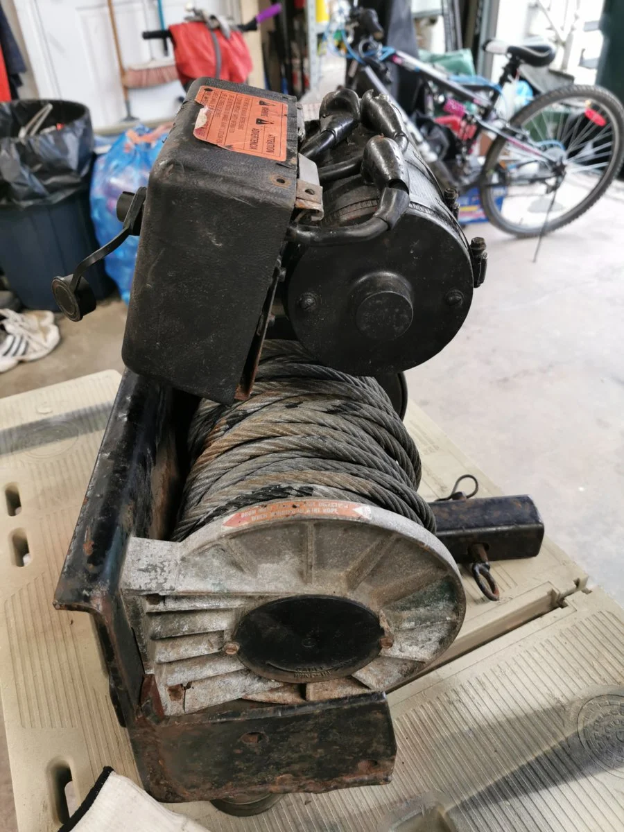

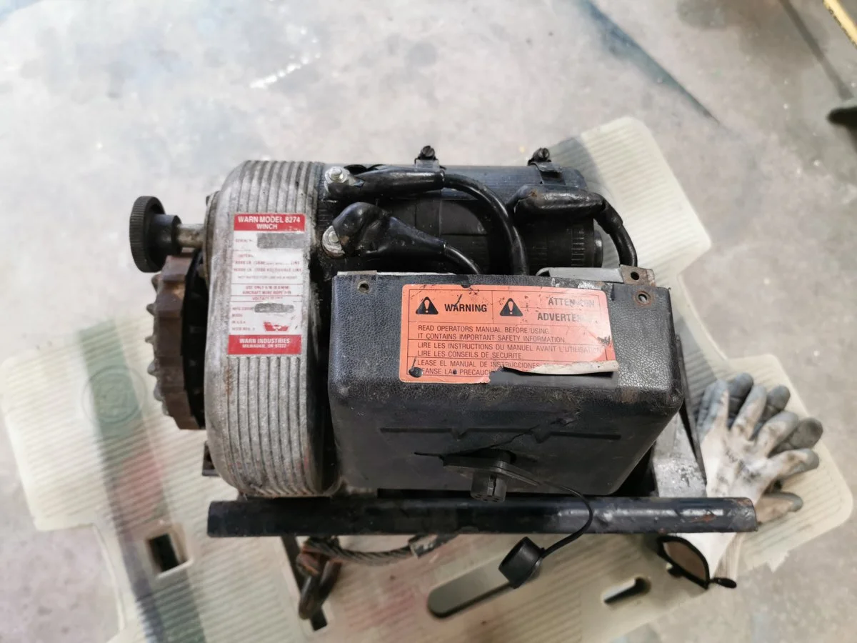

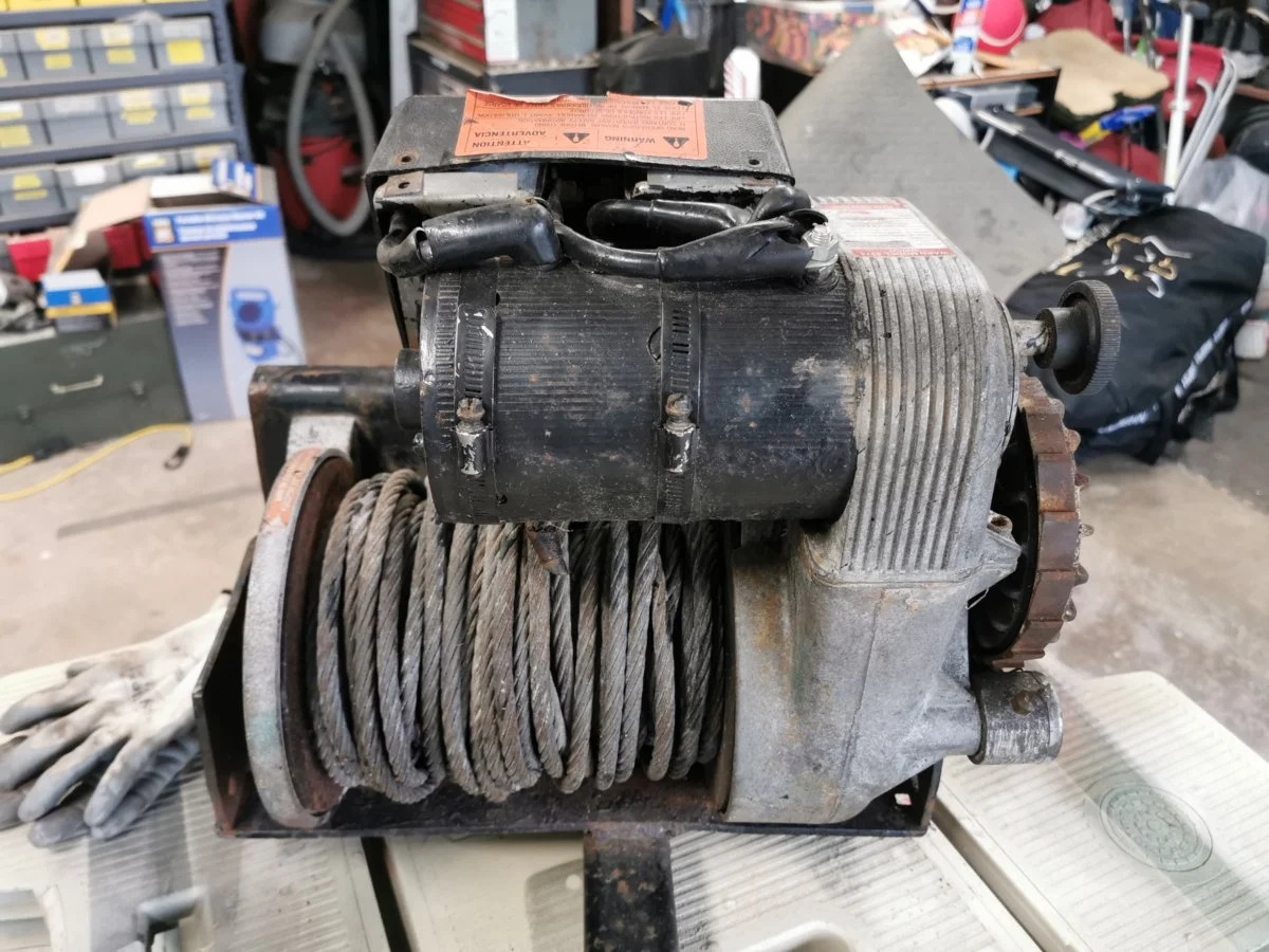

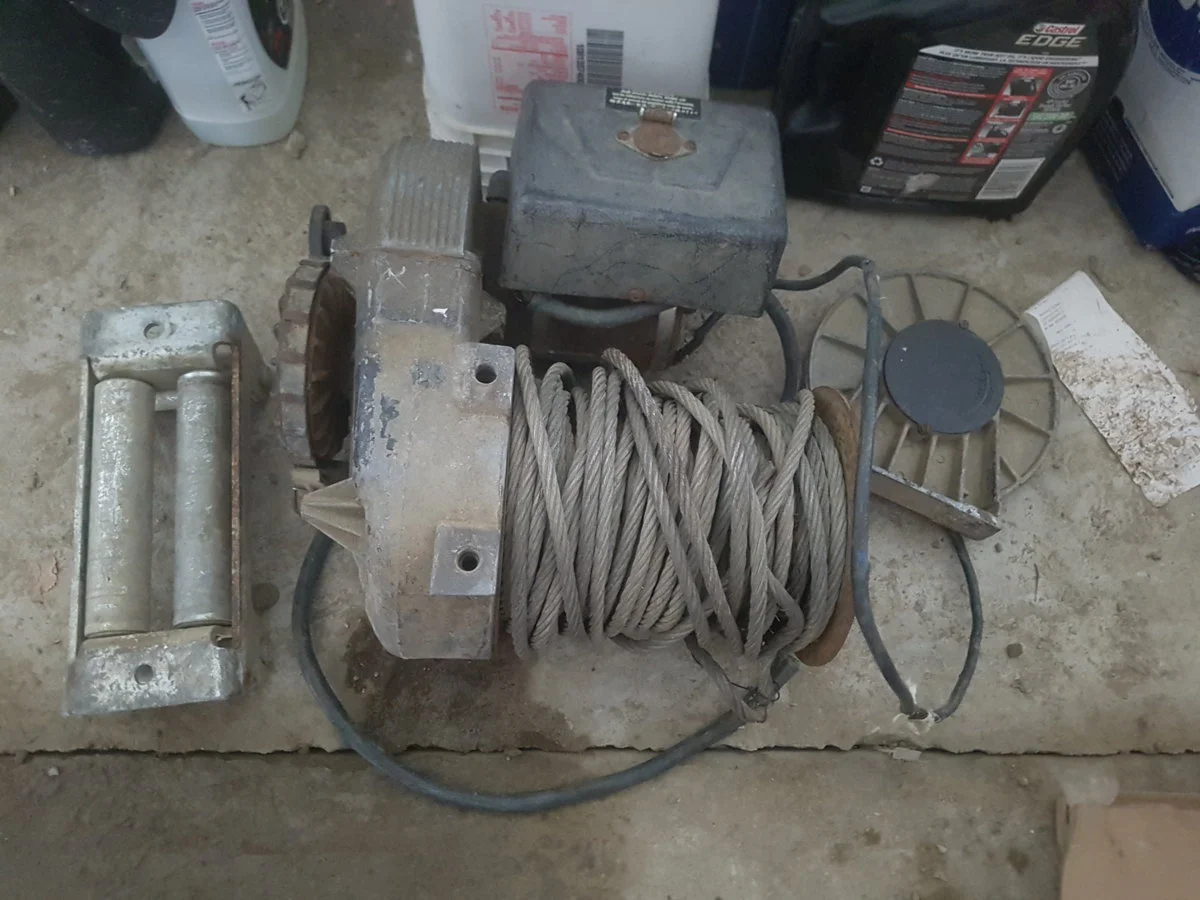

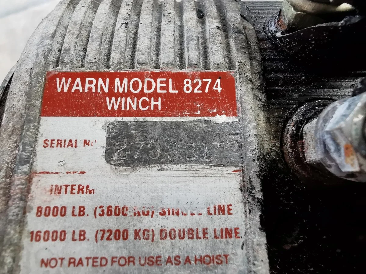

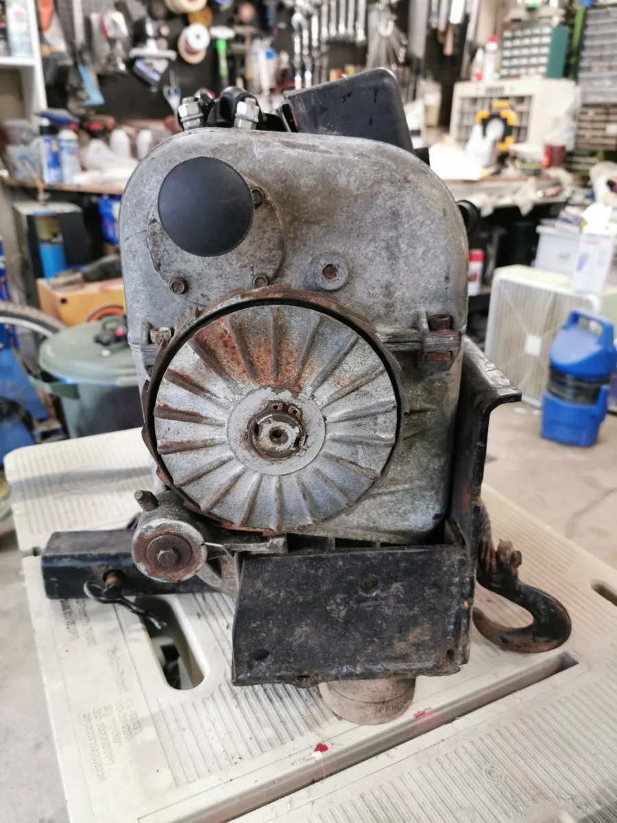

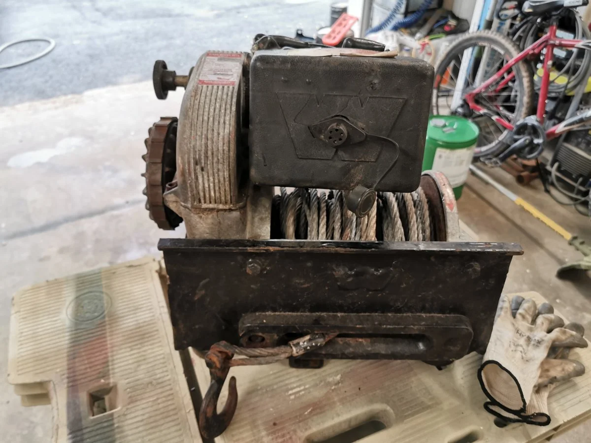

Speaking of used winches, I picked up an 8274 yesterday. It needs a new lower housing (got dropped off the back of a truck, or the PO broke it trying to remove one of the mount bolts), but everything else seems in good order
View attachment 100643View attachment 100644View attachment 100645View attachment 100646View attachment 100647View attachment 100648View attachment 100649
Be careful where you buy the replacement lower casing from and make sure they have a good return policy. I have read some forum posts where people complain about the newer castings having less precision than the old and it not mating properly to the older casings.
Thanks for the heads up! I was able to find one from a local guy that collects them and fixes and sells them.

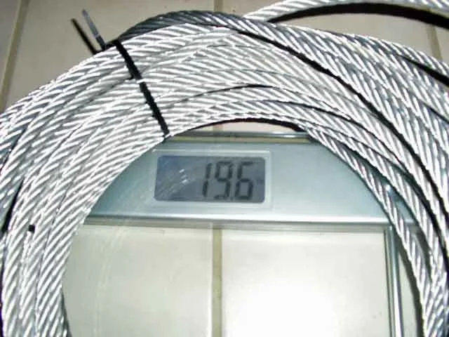

125' of 5/16" wire rope is right at 24.5 lbs. My 100' of 5/16" wire rope weighed just under 20 lbs. 125' of 3/8" synthetic is 4.25 lbs.
For just the ropes there is a 20 lb. difference between the original 125' of 5/16" and 125' of 3/8" synthetic.
Hmm sure felt heavier when I took it off. Apparently I'm just weak. ;)
