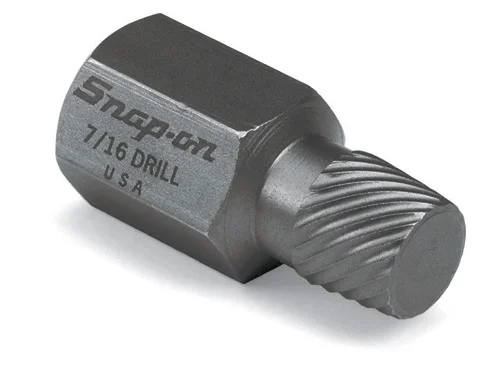

Another option is to use a GOOD set of easy outs. My preference is snap on.
