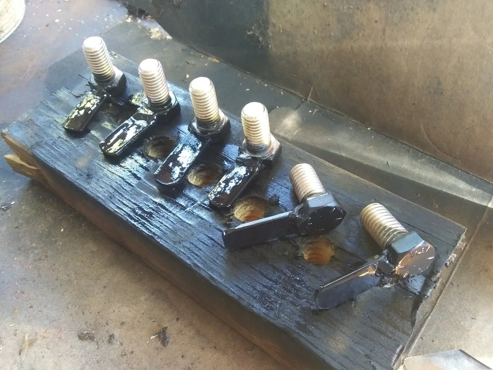

After you knock them out of there - If you have a welder you can make some flag bolts and drop them down from inside the frame. Fish them through the holes with some wire and the flag will keep them from spinning when you tighten the nut from outside. It's the easy and cheap way to deal with it if you don't want to mess with nutserts but it's not as clean of an installation.
